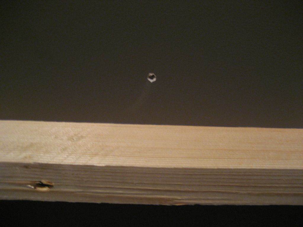

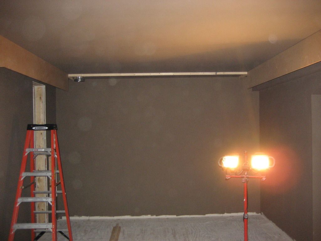

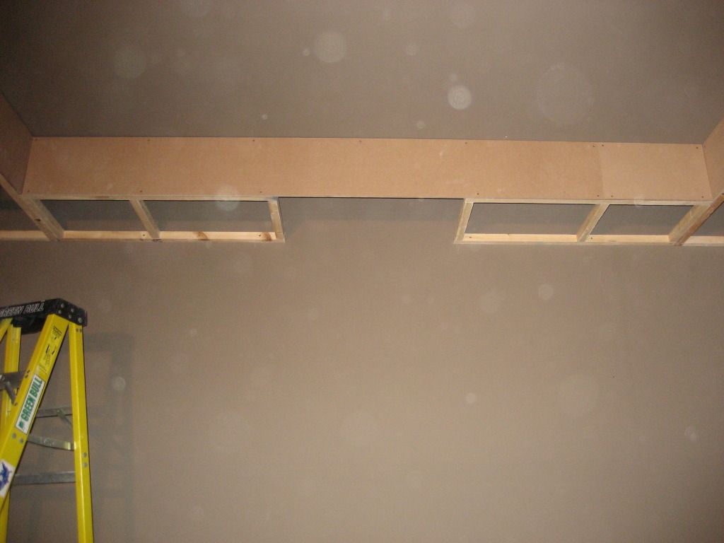

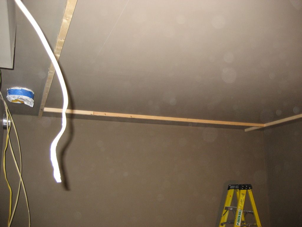

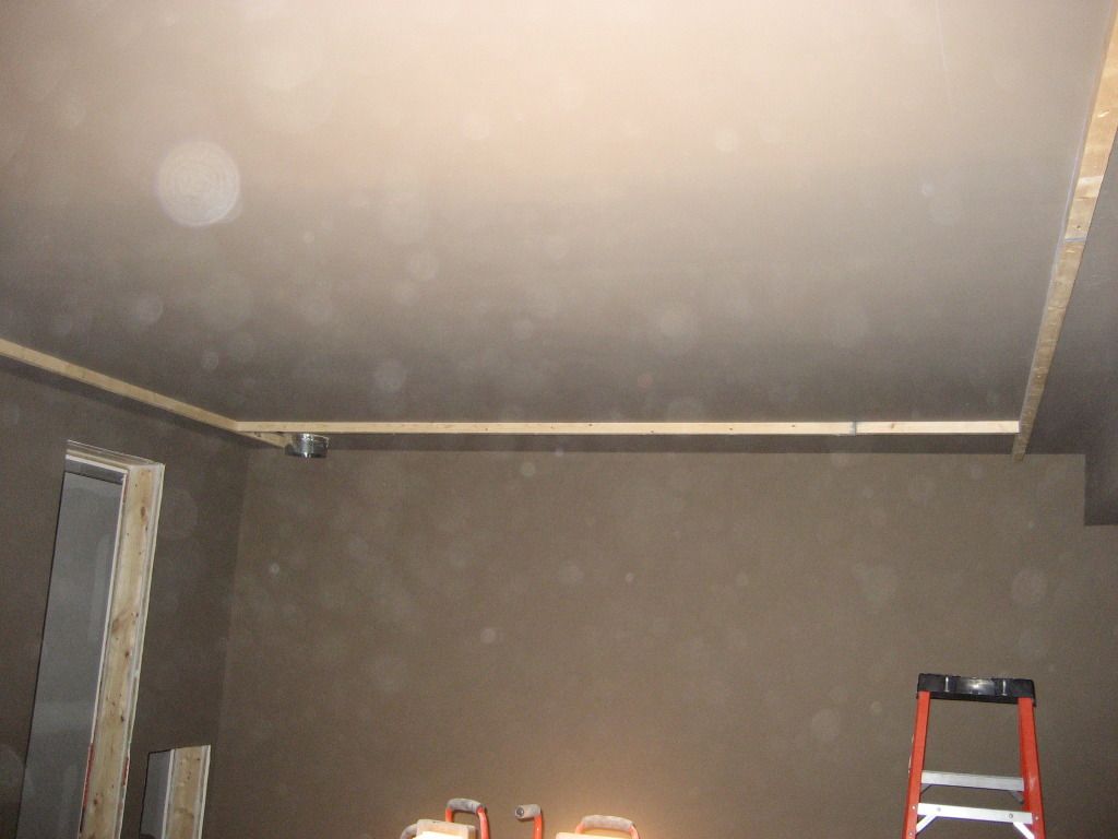

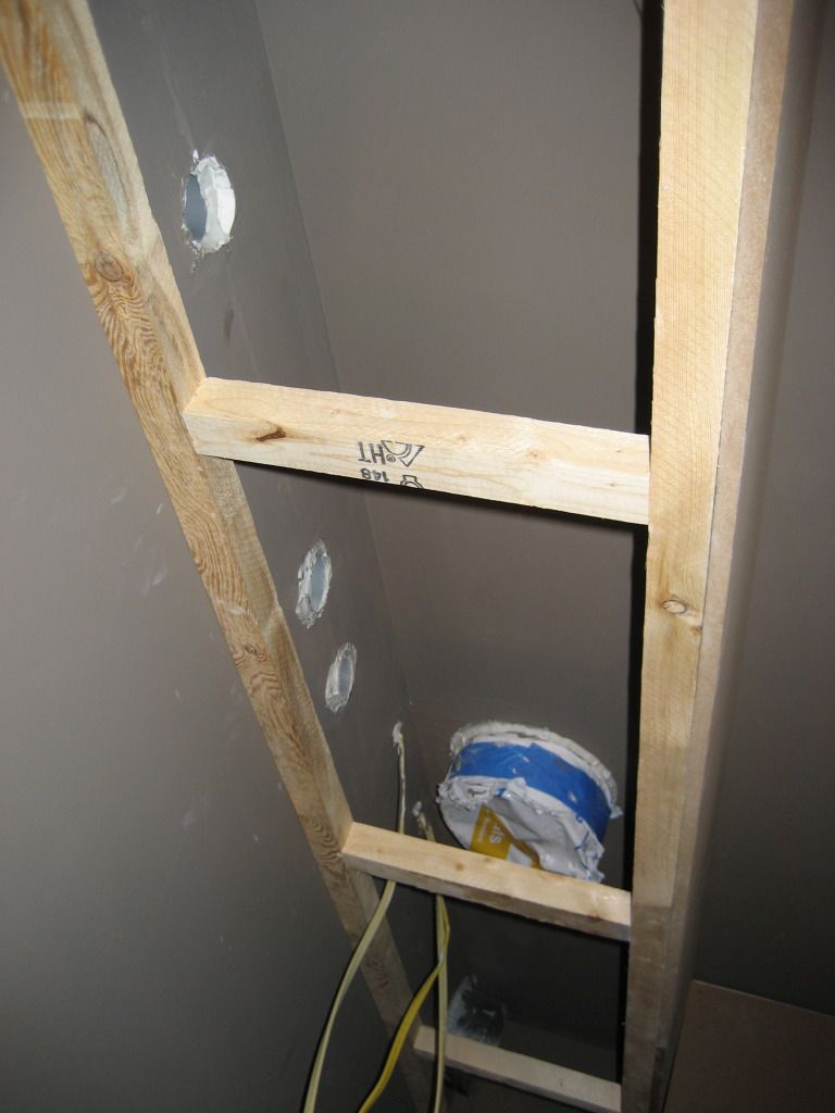

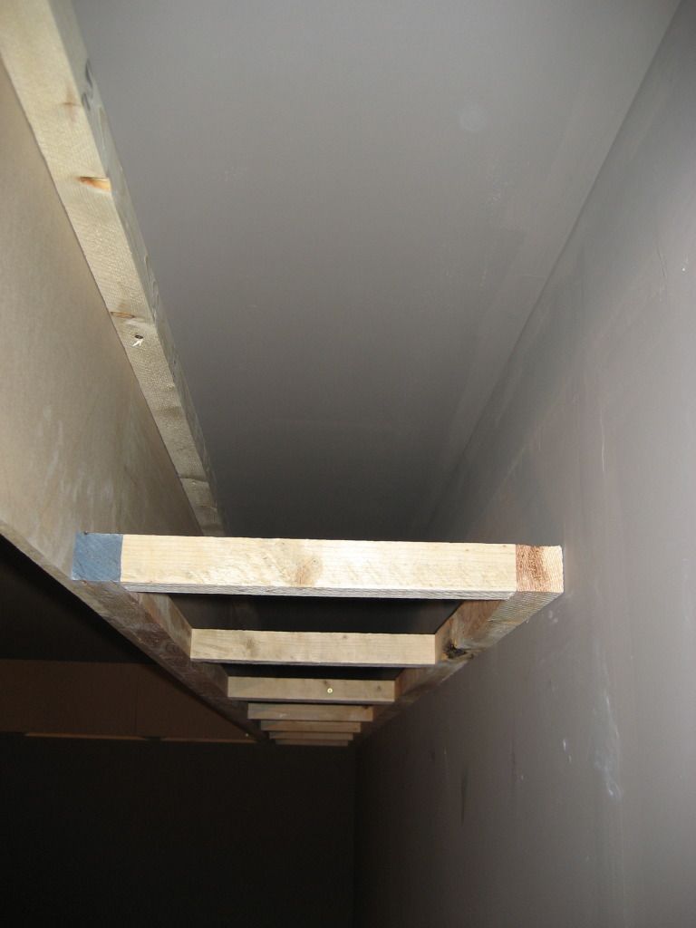

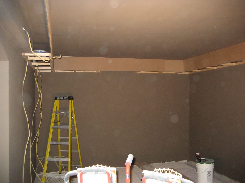

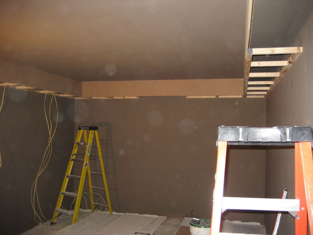

Weekend update.
Started the soffit work today. Pretty slow going as I spent a lot of time looking 5 steps ahead trying to make sure that I wasn't missing something or putting something up that may be in the way of another step. So on with the pics...
Started with some 2x2's attached to the ceiling.
Then started hanging 1/2" MDF from the 2x2's.
A couple of casualties like this.
Got the back portion of the room complete.
The hole in the middle will be filled with a vent box for the rear dead vent return.
A shot of the various ducts and conduit in the soffit.
And a shot of the ladder structure in the soffit.

His results are really nice. I added an extra inch of depth to my soffit to account for a future star ceiling. I am leaning towards a FOSI style instead of the painted. Would like to experiment with rigid foam as a base instead of using heavy MDF. All of this will come well after the room is functional and I have completed the rest of the basement.
I'm sure BIG was a huge help especially since he could work on things during the day when we are stuck working desk jobs. rolleyes.gif And to have his knowledge of schedule, building techniques, and just damn good ideas would be a major plus.
My unreasonable time table is to have the room complete by the end of September so that I am ready for the Avengers blu-ray release. I think budget and time will limit me to having the room functional by the end of September. Probably looking more like Thanksgiving as far as having the room complete (or as complete as a home theater gets on this forum). I will be doing all fabric frame walls like your room. Still need to figure out what design I am going to do and what color scheme I am going to go with. I have a bunch of GOM samples and stare at them every night thinking that I will have an epiphany. No such luck so far.
