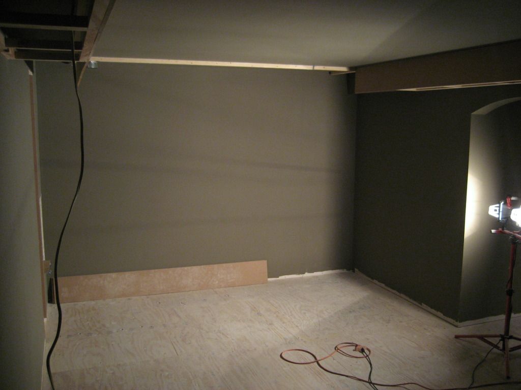

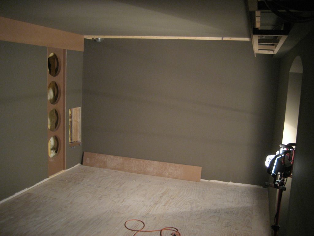

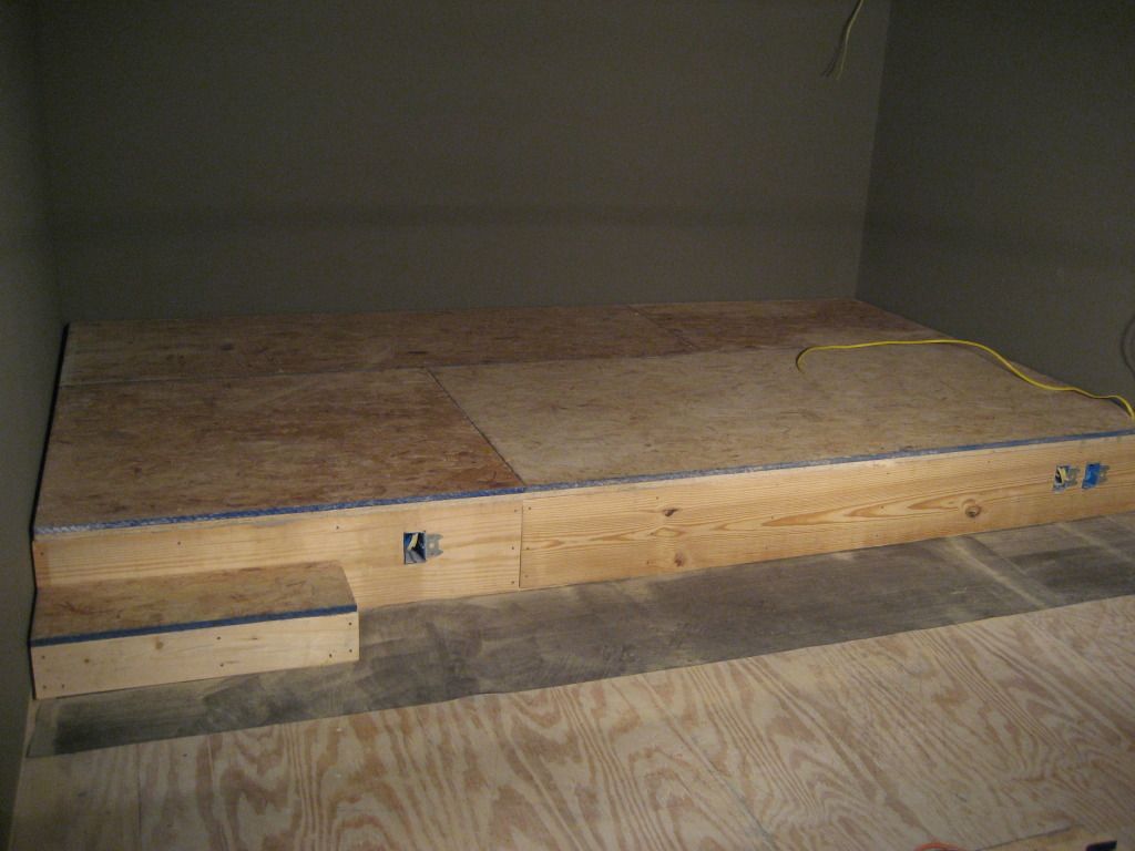

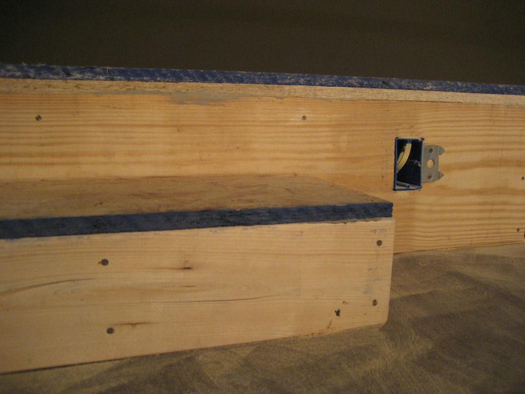

A small midweek update.
The riser now has it's second layer of OSB on it. At this point the riser is complete until I need to put the nosings on.
The step only got one layer of OSB so that the distance from the floor to the top of the step is approximately the same as the distance from the top of the step to the top of the riser.
So now that I have completed the riser I can move all the junk from the front of the theater to the back and clear out space to begin work on the front stage.
And some clean shots of the front of the room prior to stage construction kick-off.
Stage construction should begin this weekend.

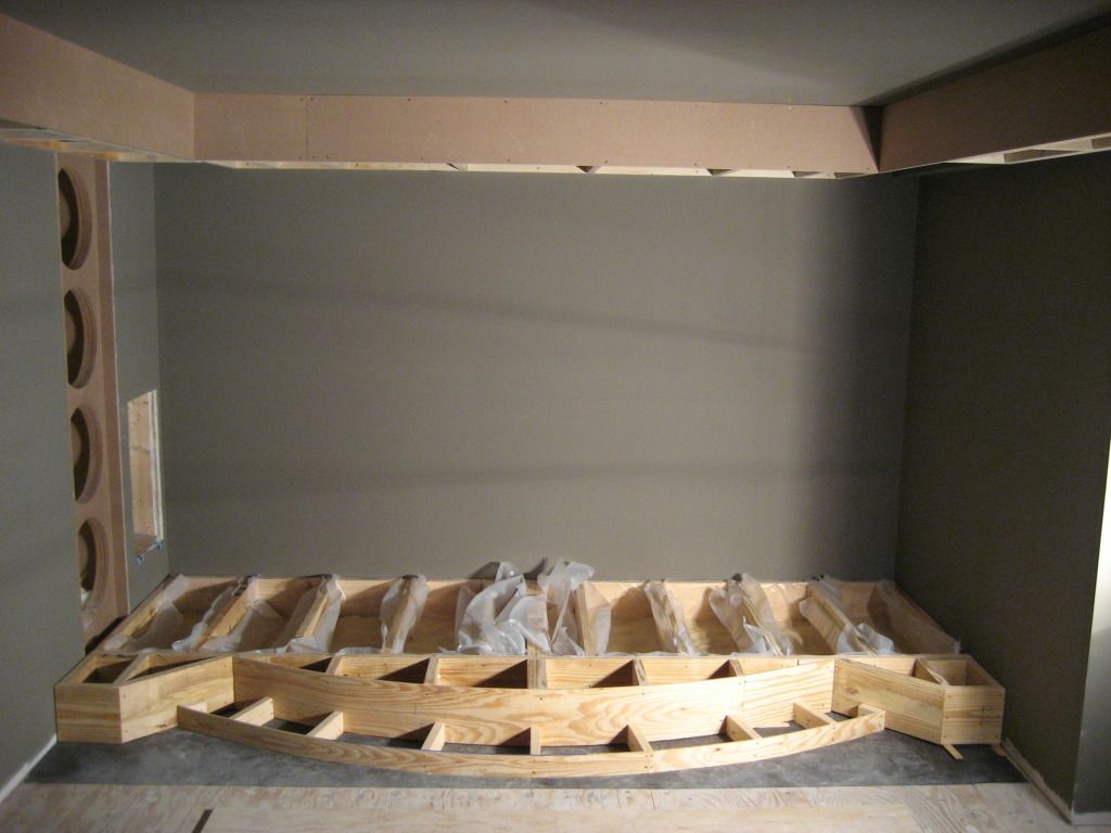

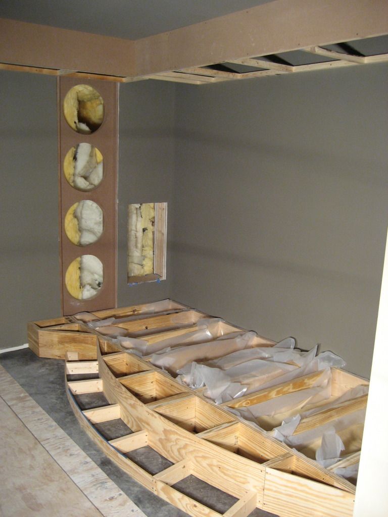

All the way back to page two even after a midweek update! This forum has been busy.
So I made some good progress this weekend. Here are the pics to go with my chatter.

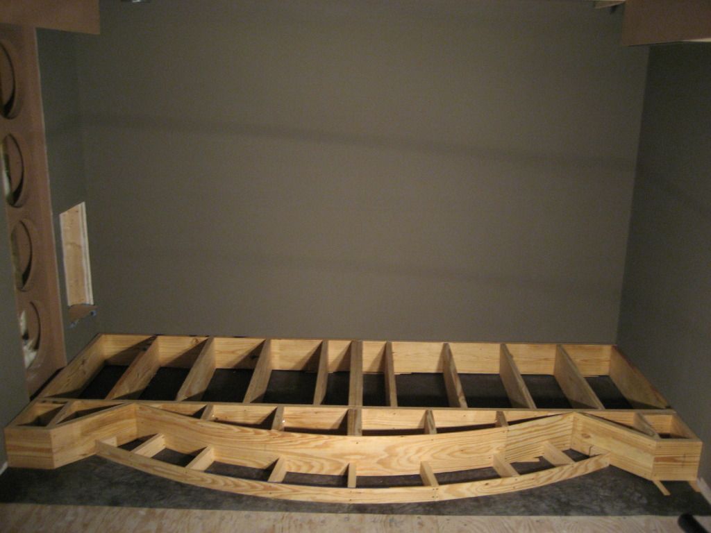

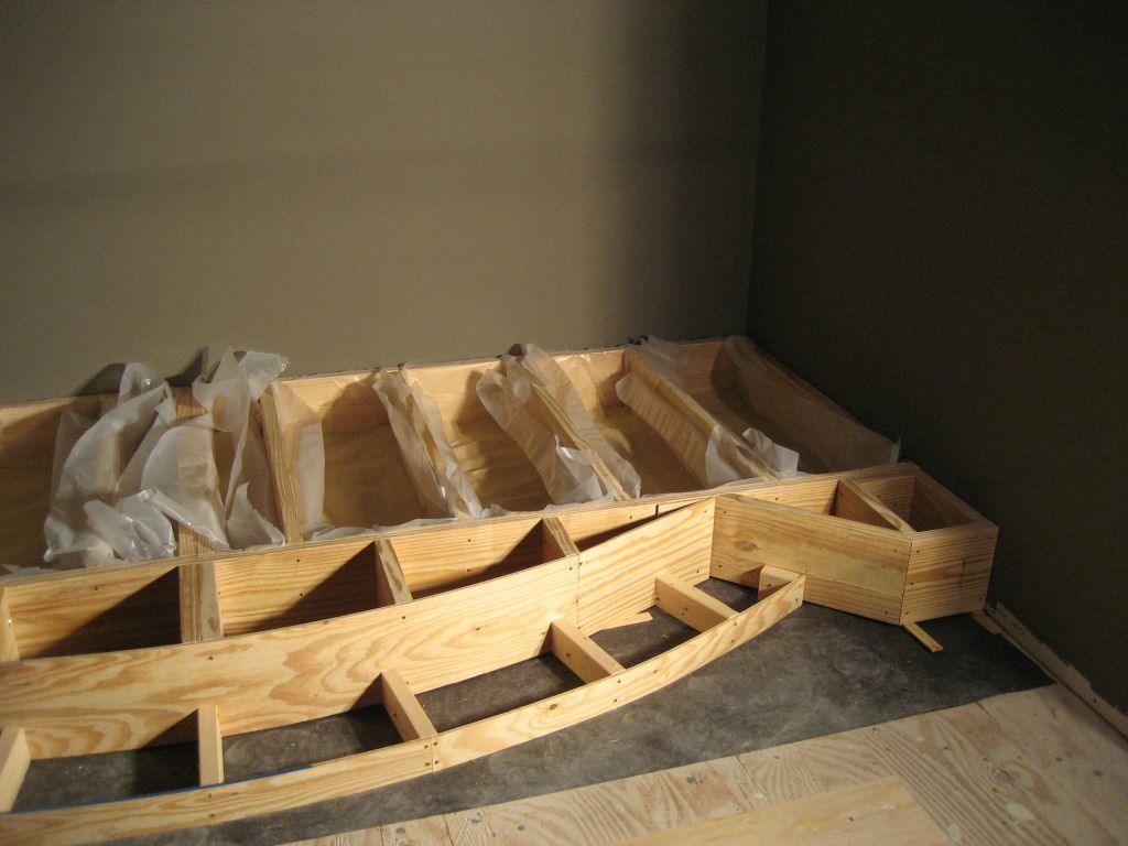

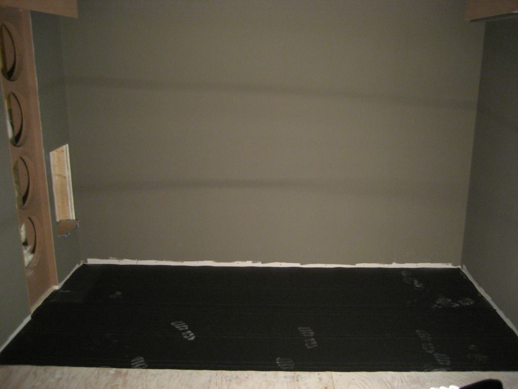

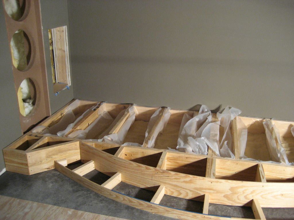

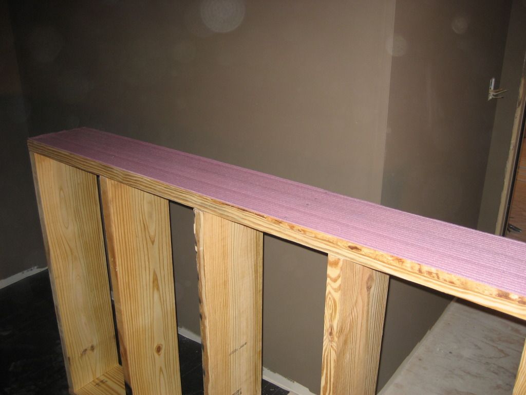

This weekend was dedicated to stage construction. I began with some 30# roofing felt.
Some basic rectangular frames were constructed. Add in some pink foam in case the frame gets a little too close to the wall.
Add on a couple of arcs and you get a design that everyone is familiar with. cool.gif

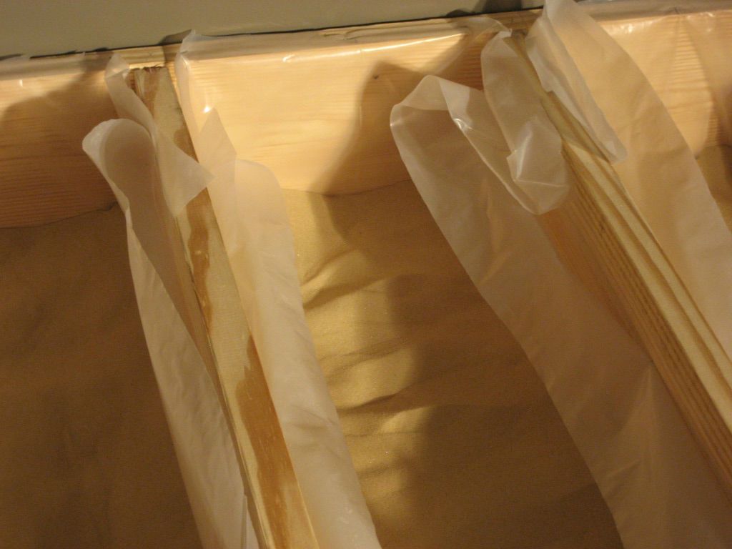

I also decided to pick up 500# of sand while I was at the store this weekend. It worked out great because I had just enough for one bag in each large cavity. I also got some early practice on my Christmas wrapping getting the 4mil plastic into each area. tongue.gif
I like this shot a lot.
Also in the above shot you can see that I finished off the front soffit structure.
I asked the question in another thread but I will ask it here also. Is it necessary to fill all of the deep cavities with sand? I know I will be filling all the large rectangular ones but what about the deeper odd ball cavities? These areas will be away from the speakers on the other side of the screen wall. I have seen them filled and I have seen them stuffed with insulation. What should I do?
So that was the weekend progress. Will try and throw in more sand when I get a chance and maybe get the top OSB on next weekend. Going to be working in other parts of the basement this week to try and keep that part on track as well. Man it would be nice to only have one room to worry about. rolleyes.gif
vanice is offline

Looks great vanice! I love that stage design.
I may be wrong on this, but I'd say that you'd be fine if you filled those other areas with fiberglass since the speakers aren't directly on them.

Thanks aaustin. It's been done many times before but I don't think it is getting old yet. cool.gif
That was my thinking but I figured I would put it out to the masses and see what kind of consensus I could get. I don't want to cut corners but insulation is easier than sand any day of the week. rolleyes.gif

I've seen some people that have a sub on their riser that only fill a small section under the sub with sand. I haven't heard anyone that did that indicate any problems.

Originally Posted by vanice View Post
Thanks snickers. Yes, it looks like several people are at about the same point. I do plan to fill the large cavities completely full (just slowly as I don't have access to a truck at all times). I was wondering about the deep curved cavities near the front of the stage. Since they wouldn't be under the speaker area are they required to have sand??
from what i have read and seen here most fill the the whole stage except the first step with sand then they just use insulation for the first step cavities

Hmm... what to do, what to do? Snickers - So I assume by your response that you plan to fill all cavities in your riser except the first short step? Thanks for the replies so far.

My room is based off of this build. A great theater. Right now I am leaning towards filling all cavities. One thing I definitely don't want is to have a potential issue and what-if myself to death.

One complaint I did have with my theater involves the screen wall. So behind the wall I have tower | Sub | Tower | Sub |Tower. All of the measurements you make with the room as far as reflections, and calibration depend on the exact positions of your speakers, their angles, etc. When I have to do things like adjust the volume knob on a sub (Usually only during a calibration) you cannot reach it without either taking off the screen itself, or sort of climbing over the tower speaker next to the sub since it is in the way. But I still want the entire front screen wall to be there when I am doing the XT32 setup. So it was a pain to take it all down, adjust the levels of the subs so that it hit the 75db which was needed, and then put it all back up. Some sort of swing panel would have been more convenient. Technically though, you should only ever have to do it one time. I had to do it a few times due to sending back my pre-amp, returning my built-in sub-amps for adjustment, etc. It is a lot cheaper and easier to do it the way we did though.
As far as the stage and sand. Yeah, it's a huge PITA. As snickers posted, we filled all of the large cavities up. Fiberglass is all we put in the small step. The reasoning behind that is that the large plywood pieces we put over the top were all fastened to those sections, vs the small step which was almost independent. I don't think there is any reason at all to fill up the little ones with sand. Fiberglass will be just fine.

I'm sure if you hang around here long enough you will always find things that you would like to copy for your own room. Like you said, once the lights are off the design portion really doesn't matter anymore. It's about getting the function right and in a form that you like and doesn't break the bank. I could never afford Cinemar's build nor do I have the room size that I think it would take to make it look as good as his. And don't get me started on the time it would take me. rolleyes.gif
I can see how the screen could be an issue. I won't have a sub back there but may in the future. I'll keep that in mind and see if I can't come up with a good hinged screen.
I'm leaning towards doing it all. What's a few more trips up and down the stairs carrying 50# bags of sand. frown.gif

BIG laughed a lot when I was hauling sand. I think it was 2 tons or so total. Had it delivered to my driveway (which was as far as lowes would bring it) and I took the bags all to my rec room around the back of my house. You could put several in a wheelbarrow, but that weight adds up fast. Plus I have a small hill behind my driveway so I had to run the wheelbarrow down with each load of sand. My back really was killing me after doing it. But BIG told me that "hauling sand" is a rite of passage for every theater builder. I didn't have to do the filling though, I had help early on and one of the guys filled up those cavities and smoothed it out for me while I was at work.
