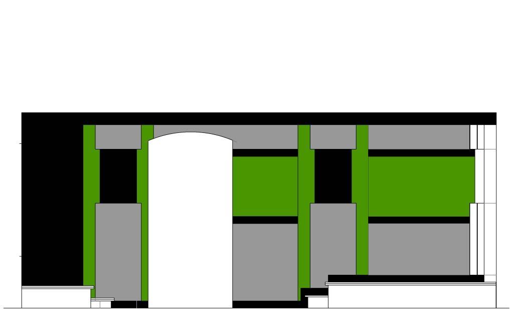

I also measured the arch and have redrawn that side of the room. See below...
I had it way too low.

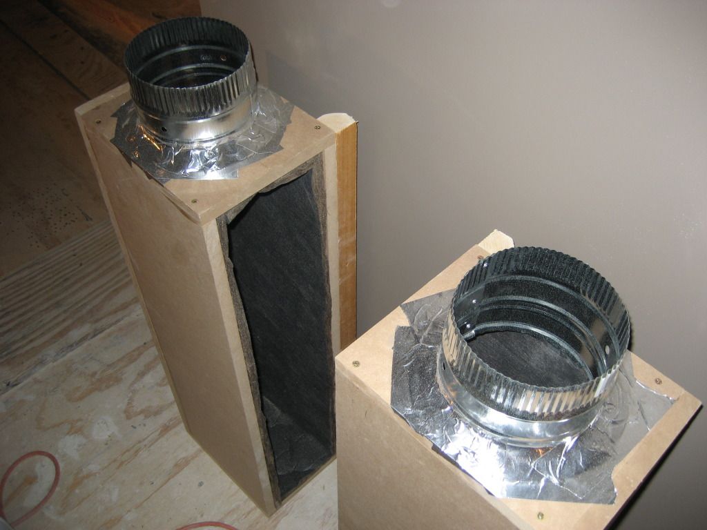

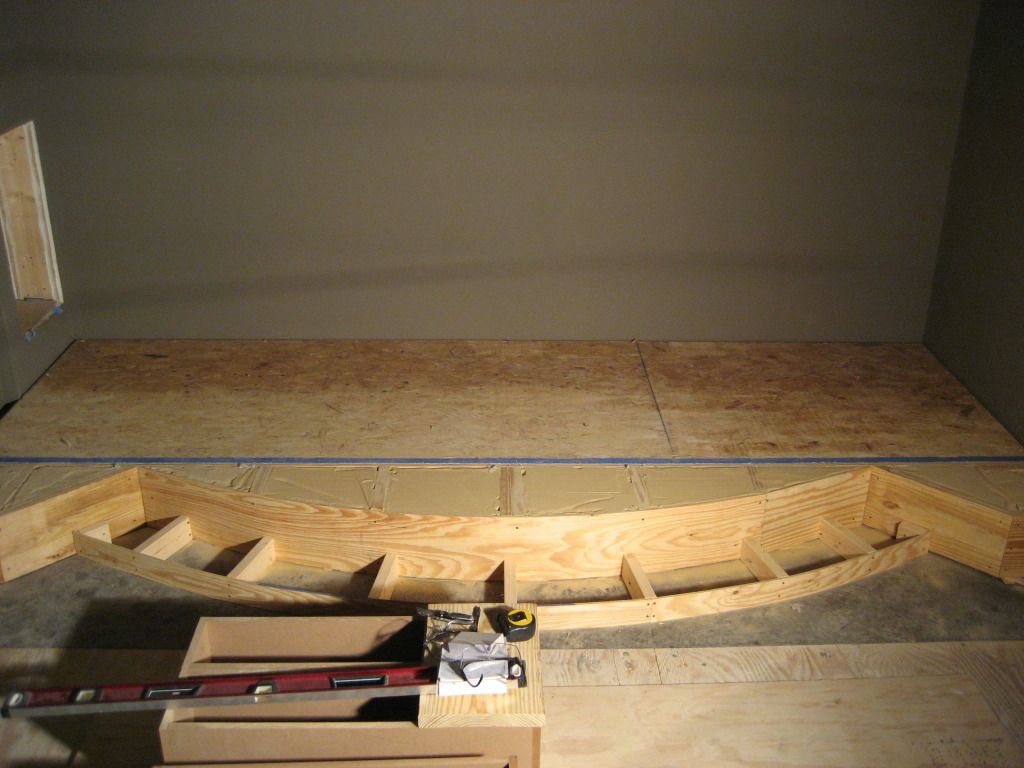

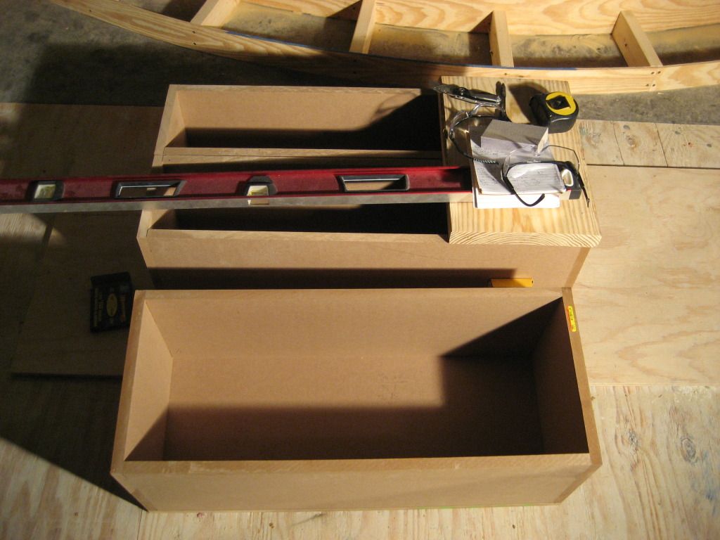

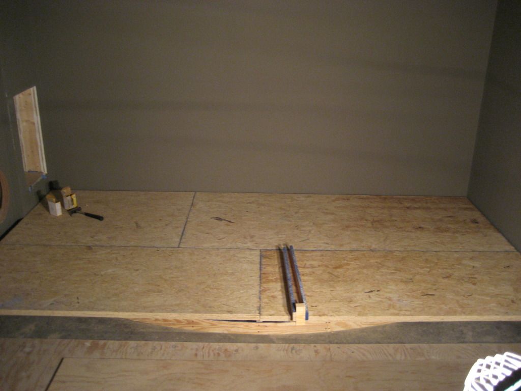

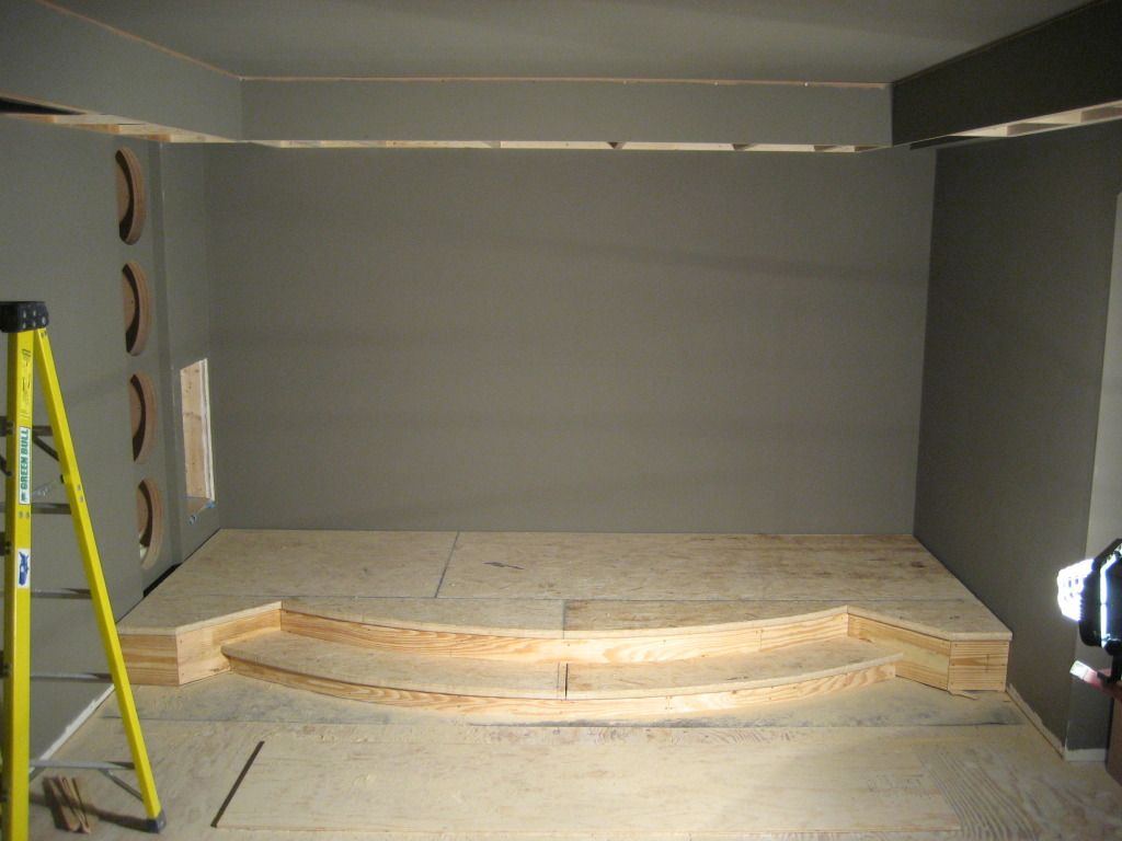

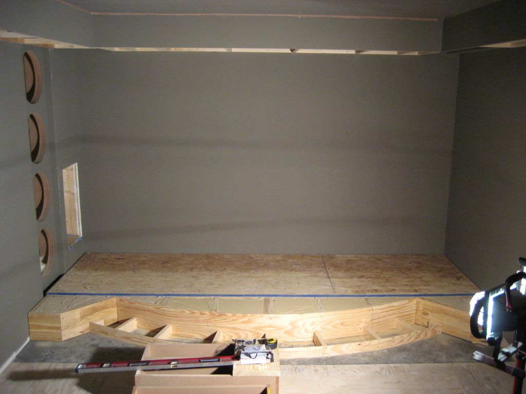

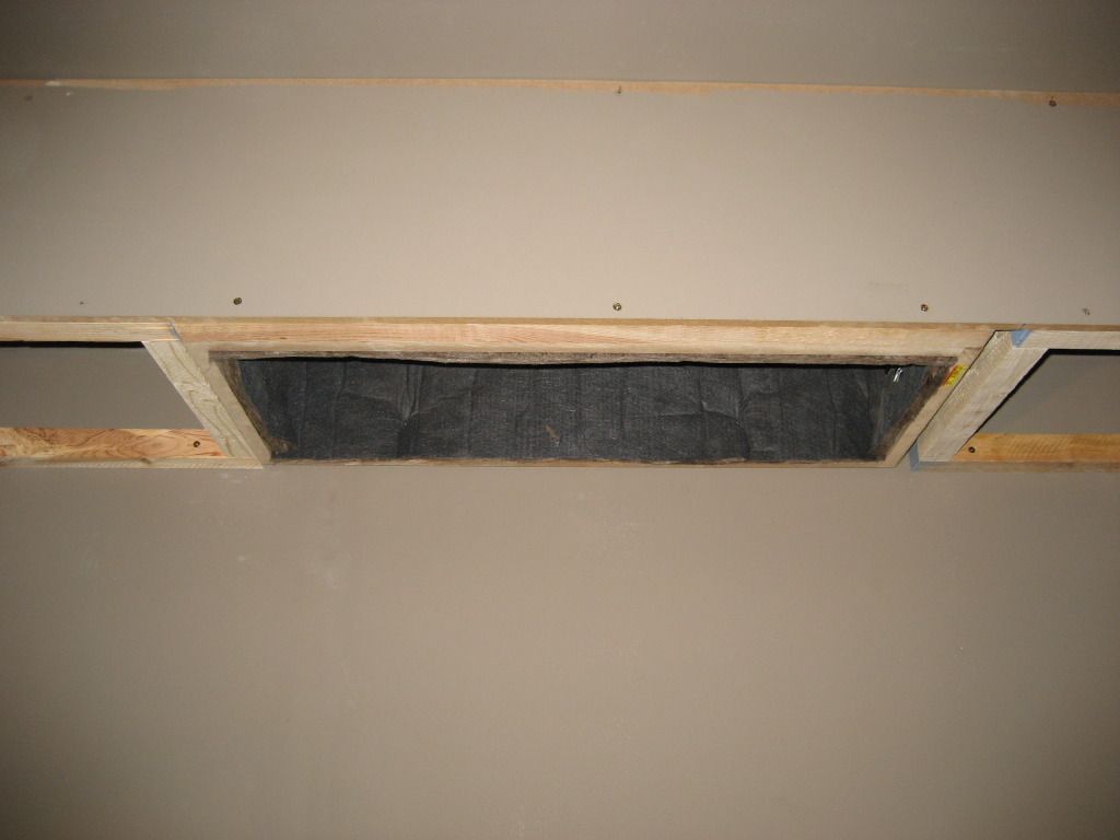

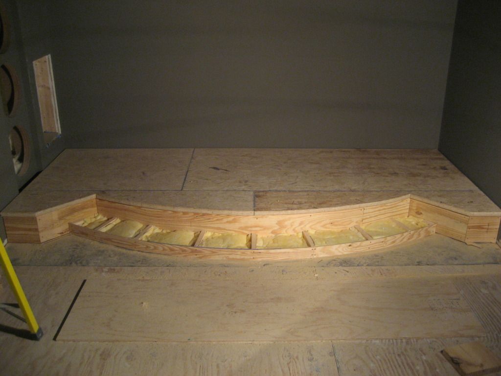

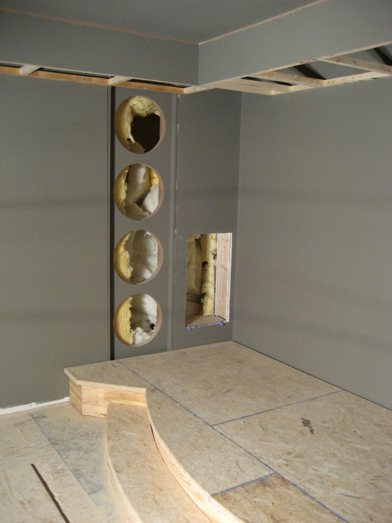

Ok... finally ready to post up some progress. Weekend work ended tonight because I had a tool breakdown (more on that later).
So Saturday began with more of the same, hauling more sand to the basement. As I stated before, I had hauled down (10) 50lb bags the first day I started filling. Then later that week I hauled down an additional (36) 50lb bags. This left me just short of filling the large cavities. So Saturday morning off to the store to get more sand. Figured 14 more bags would do it. It didn't...
Decided to go ahead and cover the back portion of the stage with two layers of 3/4" OSB.
Then it was back to the store for more sand. Figured I needed 9 more to fill the rest of the front cavities.
Crap, half a bag short. Figures. rolleyes.gif If your keeping track that is (70) 50lb bags of sand or 3500lbs. eek.gif

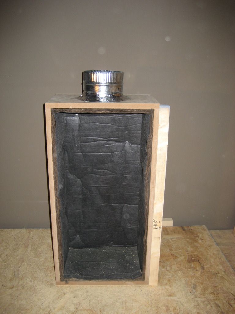

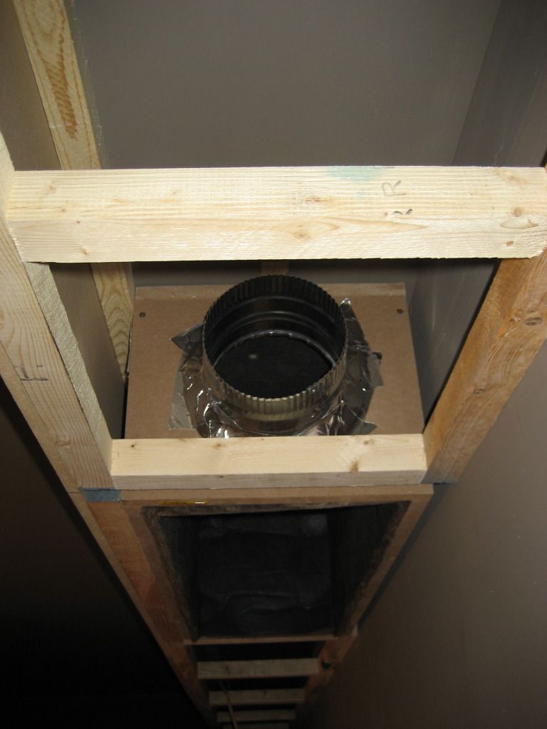

So on to something else. Built my soffit HVAC boots.
So Saturday ended with lots of trips to the store and nothing completed. There's always Sunday.
Sunday begins by finishing the top step of the stage. You can see my marking tool made famous by BIG. smile.gif
Top step complete.
It was at this point that the jigsaw died. mad.gif No idea why but it was pretty old and we did work it pretty hard cutting through two layers of 3/4" OSB. Spent about 30 minutes tearing it apart trying to fix it. Did not work. So we moved on to finishing the HVAC boots.
Added some 1/2" Linacoustic to the insides.
And got one installed in the soffit.

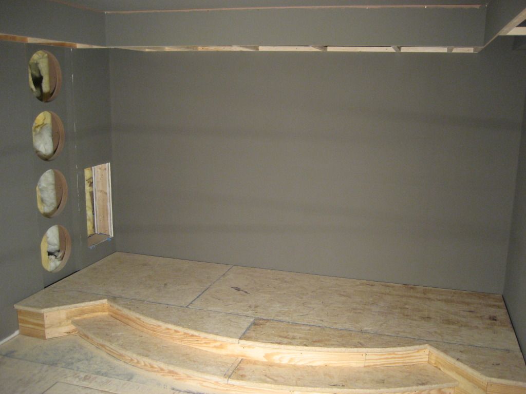

So that brings us to today. Jigsaw has been fixed so I can get back to finishing the stage. Filling the bottom step with insulation.
One minor issue but I am hoping that the carpet will cover it.
It is about a 3/4" gap on the backside of the first step. I could fill it I guess. What do you guys think?
And finally, a completed stage!!
So there we go. Finally a weeked update. Going to get the last of the HVAC boots in and then try and get some black paint on the ceiling and soffit. This weekend I hope to finish the soffit and maybe get some lights up. That will be a big step. cool.gif
vanice is offline
post #471 of 1325 Old 09-25-2012, 09:37 PM
aaustin's Avatar
Location: Upstate NY
Posts: 1,228
Liked: 36
The stage looks great vanice! Congratulations on such an awesome milestone!
In regards to the gap, I think that you will be fine leaving it and letting the carpet cover it up. The tack strips will bridge the gap in that small area. Plus, not many people will be stepping up onto the stage so it won't get worn.

Thanks Fetch! Looks like you are ahead of where I was as far as picking colors and panel designs. That is one thing that I underestimated going in. I should have known though since I am pretty indecisive. rolleyes.gif If I can come up with something that people want to copy that would be great! I am definitely "borrowing" my share of ideas from here. smile.gif
Originally Posted by NGiovas View Post
Stage looks great. How much of an overhang is there on the lip of the stage? I have been trying to figure out how much I need to leave. I am guessing 1 1/2" - 2".
Thanks Nick! I went with a 1 1/2" overhang and used a 1/2" roundover bit on the top and bottom. It turned out just like I was hoping. I definitely wouldn't go any shorter but if you decided to go up to 2" I think that would work really nice too.
Originally Posted by Jon_B View Post
The stage looks really good. Did you already paint? If so, what is your plan for the under side of the soffit?
Thanks Jon! I actually have not painted yet. The dark color on the walls and soffit is actually the darkest tinted drywall primer that I could get. My walls will be completely covered in panels so I wanted it as dark as I could get it to prevent any white from showing through if the panels have small gaps between them. I do plan to paint the ceiling and soffit black. The underside of the soffit will have plywood frames covered in fabric just like the Bacon Race Theater. In locations that I don't have HVAC I will fill it with insulation to act as a bass trap.
Originally Posted by Spaceman View Post
Nice job Vanice.
Thanks Spaceman! Feels good to have this part done. This should be the last bit of cutting that has to take place in the room so I am hoping to get things cleaned up some for the next phases of construction. I guess I will have a little sanding on the soffit but that shouldn't create as big a mess as cutting all this OSB did.

One question: what is the rectangular opening shown between your IB array and the front wall (for HVAC?)
Cuzed2
Thanks cuzed! Tell me about it. I've been hitting the Advil pretty regularly here this last week or so. rolleyes.gif
That opening is in case I ever need to get into the IB enclosure and roll around in a sea of insulation. biggrin.gif Basically I don't fit through the holes (nor feel comfortable trying) so I needed another way in in the event that I needed to add more bracing or something. If a speaker needs work I can just pull that out and get to anything I need. So that opening will hopefully never be needed. I plan to make a filler piece of drywall and OSB but have kinda been putting it off. I guess it is time to fill it in.

I would hate to be troubleshooting in that IB cavity with the LFE "live" smile.gifsmile.gif

Not without some serious hearing protection, some motion sickness pills, and a hazmat suit. biggrin.gif
