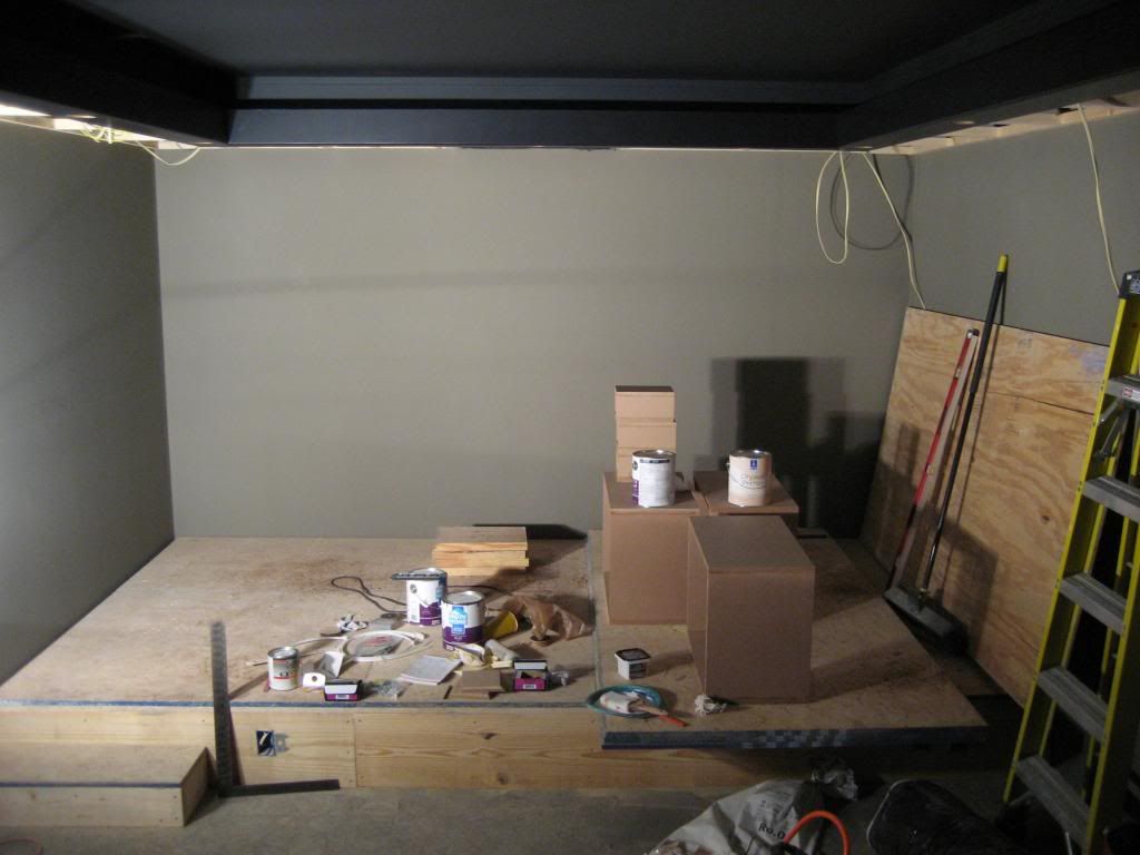

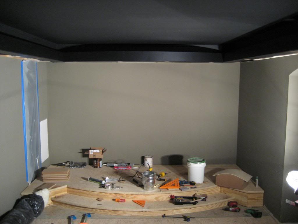

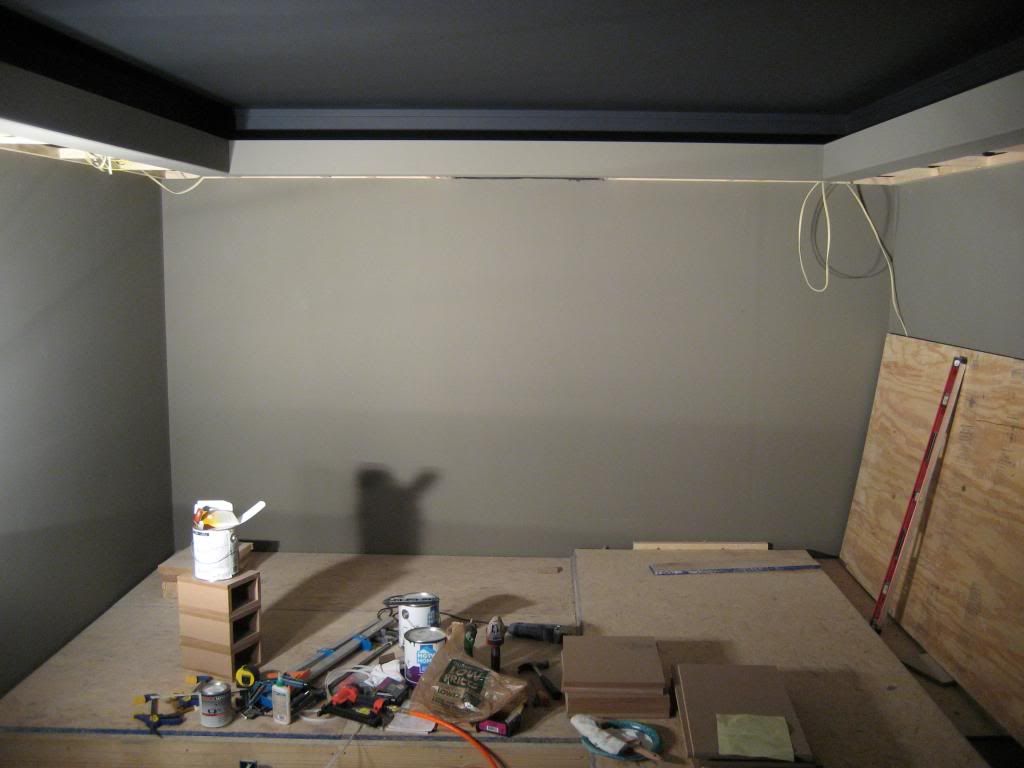

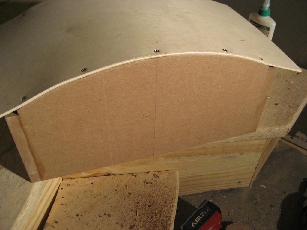

Well, I did find time to work last night. Started off by putting a coat of black spray paint on the can light trims. I have a couple that are bubbling and I don't know why. One is so bad that I will probably have to strip it all the way back down and start over. I'm using two layers of primer with two layers of black. It's almost like each layer I put on eat away a little at the layer before it. It's strange and really starting to become a pain.
I also was able to sand down the light tray and get a coat of tinted drywall primer on it. It turned out pretty good. I do have a couple of places where I notice that my hole filler didn't get sanded as much as it should have. Not sure if I will try sanding it down again at this point. 98% of it looks just fine so I will probably just leave it because I may make it more noticeable if I start going to town sanding again. Anyways... here is a pic of the front of the room.
And one of the back.
You can also see in this pic that I have started glueing up my pieces for the 4Pi's. Those are the ports under the paint can. I need to work on getting all the holes and routering done on the fronts and then it should be smooth sailing after that. I think I am going to follow BIG's method for covering them. I just need to get in contact with him to find out what he used.
This weekend I will be trying to construct my columns and wrapping up the light tray. And if there is any extra time (which I doubt) I will work on the 4Pi's.

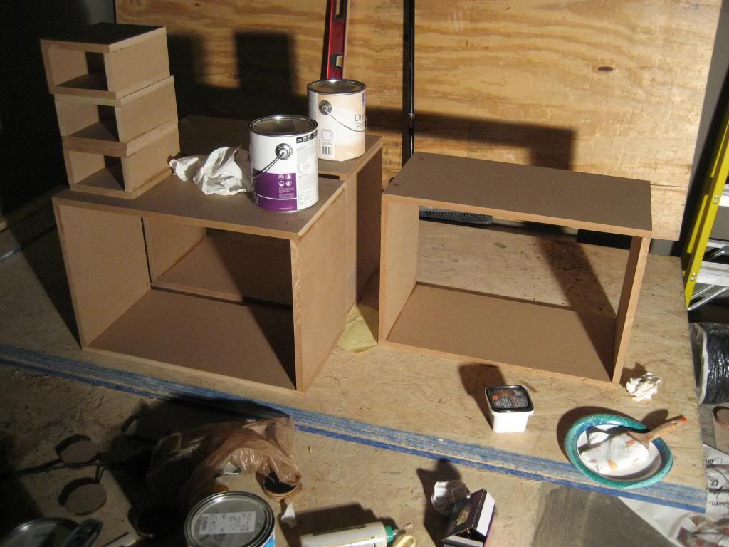

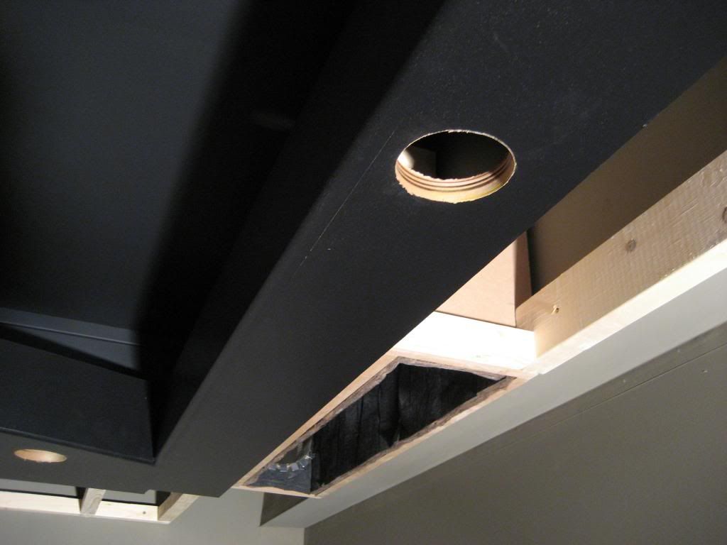

Well, the weekend update is going to be a short one.
Saturday:
Drywall guys came by to touch up some issues from before (non-theater areas). While they were here I started constructing the main boxes for the 4Pi's.
After they left I made a trip to the store for some supplies. Spent some time outside trying to strip down several of my light trim pieces. This is turning out to be a nightmare. I actually took one all the way down, cleaned it up the best I can, and hit it with some of the SW Problock primer that was suggested. Same issues. My next option may be brushing on the drywall primer I have. Nothing else seems to be working and I am not going to keep stripping these things down.
Saturday night I threw on the first coat of black paint. Looks really nice.
Sunday:
Started cutting holes for the can lights.
Then spent the majority of the day cutting pieces for columns. Didn't get everything cut (far from it actually) but got enough for a teaser pic. biggrin.gif
It was a good start but far from where I wanted to be at this time.

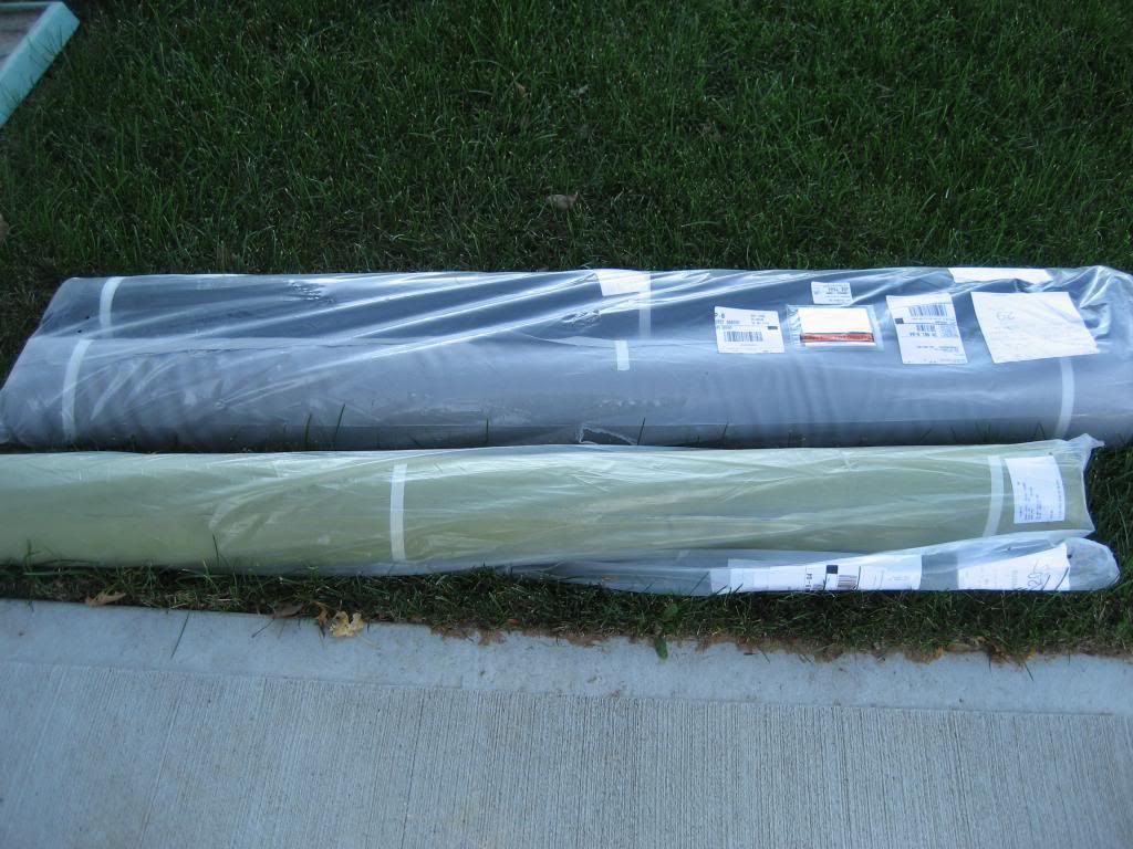

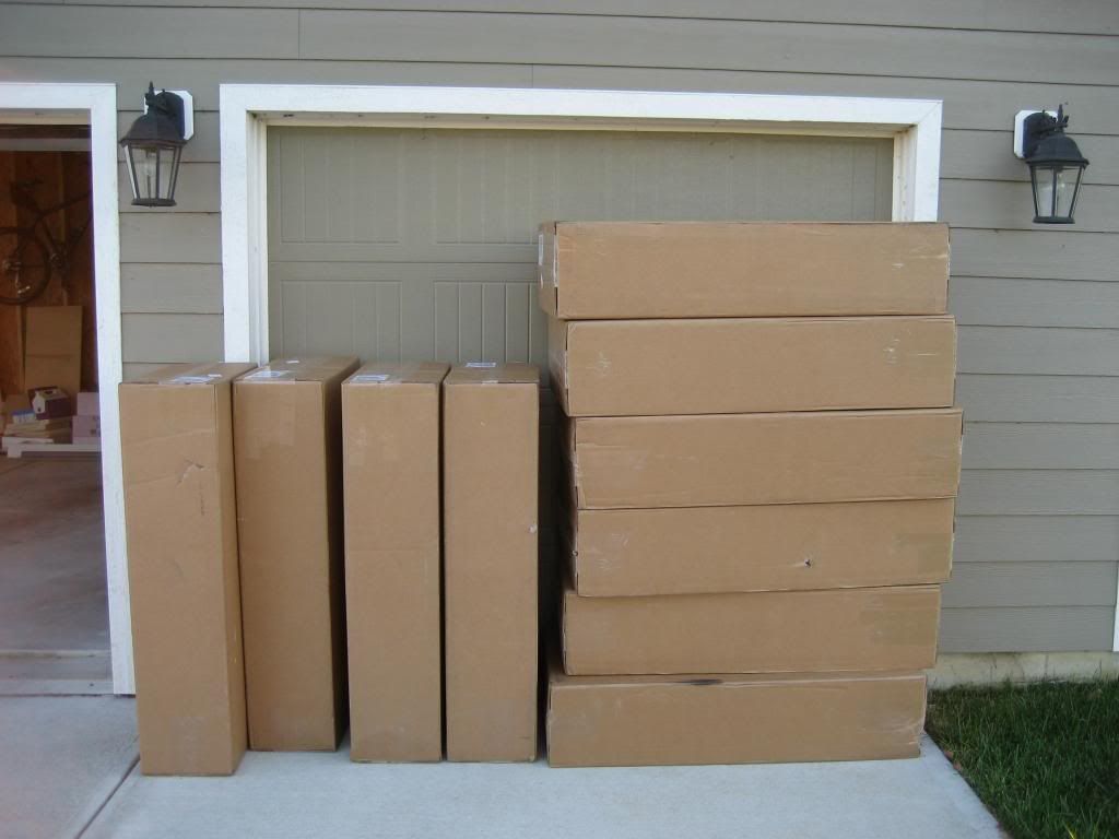

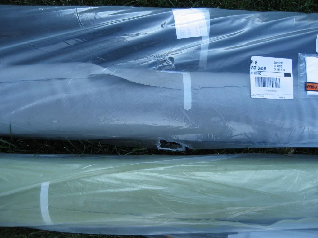

It's been a very slow week because of work and a cold but I do have some deliveries to report.
Found this waiting for me Wednesday night...
It's either Knause or OC703. Not sure what Bryan supplied. I didn't have time to crack it open.
And then last night came home to find...
This was a big surprise because I never received any kind of shipment notification. Also, I could definitely be ready to put some of this up this weekend and having it here leaves that option on the table. Let's hope I calculated the right amount needed. rolleyes.gif
Still waiting on the 2" cotton. Not sure when that will show up. Luckily it is the last of these items that I would need so it shouldn't hold me up too much. I just hope it's here before next weekend.
This weekend is shaping up for some good progress.
