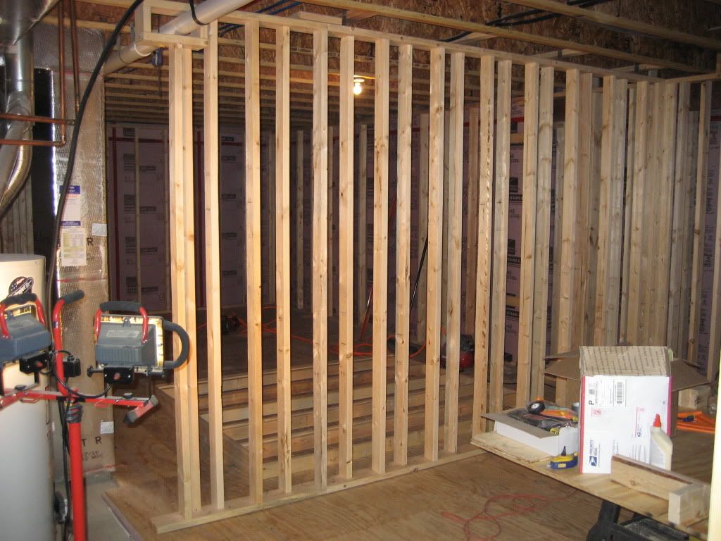

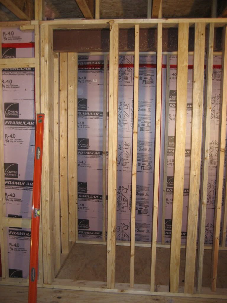

Worked a little today on the framing for the IB enclosure.
My first attempt at a staggered stud wall. Not too bad. Have a couple more to work on tomorrow.
Hope to have a little more to show for my day tomorrow. We shall see.
vanice is offline
post #71 of 1328 Old 02-11-2012, 09:03 PM
aaustin's Avatar
Location: Upstate NY
Posts: 1,227
Liked: 36
Looks great!
If that bottom plate is touching the support pole you might want to cut it out a little more to keep a 1/4" gap. That way there is no contact for sound to travel through. Also the same for the I-beam if it is touching. You want to minimize contact.
A couple things to consider as well after looking at your updated floorplan. You'll want to do the staggered studs on all theater walls that are not against the foundation. I noticed that the ones to the right and left of the door do not have them. Also are you going to soundproof the room that your rack is in like the rest of the theater? The hole for the rack will be a flanking path for sound. If you soundproof that room as well it would eliminate that path.

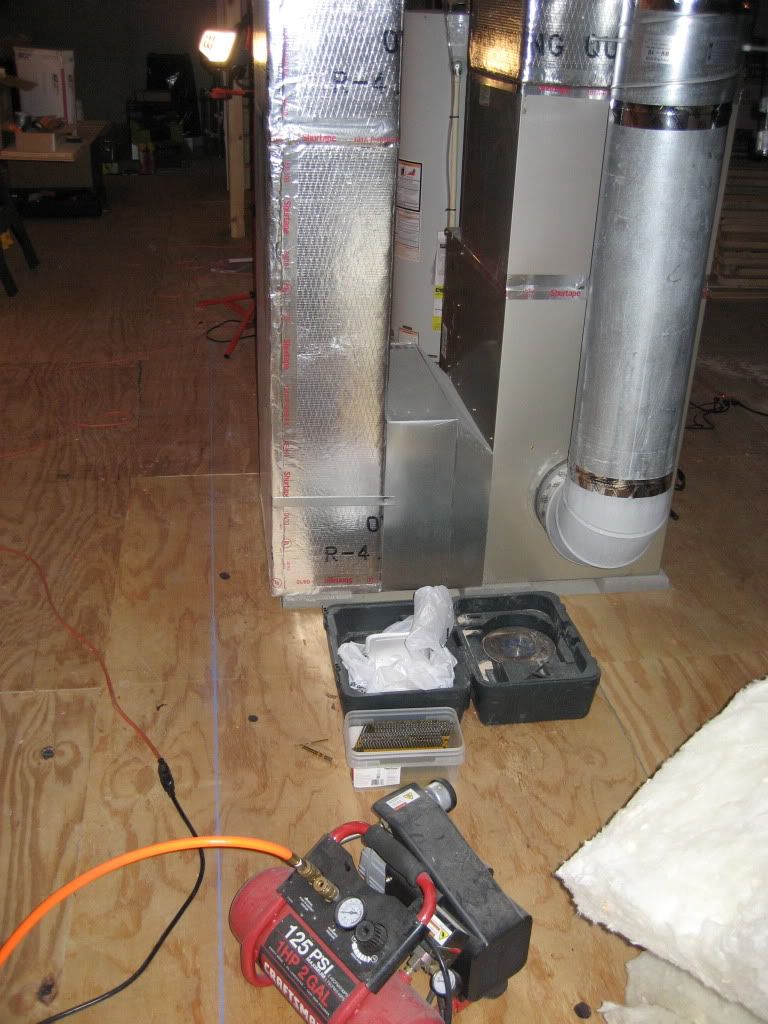

Still working on my ventilation plan. Probably need to bring in an HVAC company to help me determine what my current system can handle and what I would need to add to keep the basement comfortable. Maybe a dead vent for exchanging air between the theater/equipment room and the main room.
Lighting will all be in soffits so no holes in the drywall shell. Outlets will be in the columns or riser. Will work to keep outlets and switches internal to the room to limit holes.

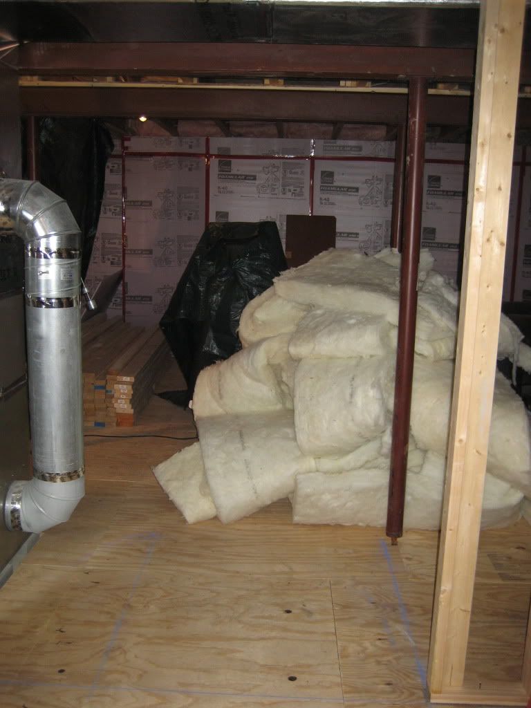

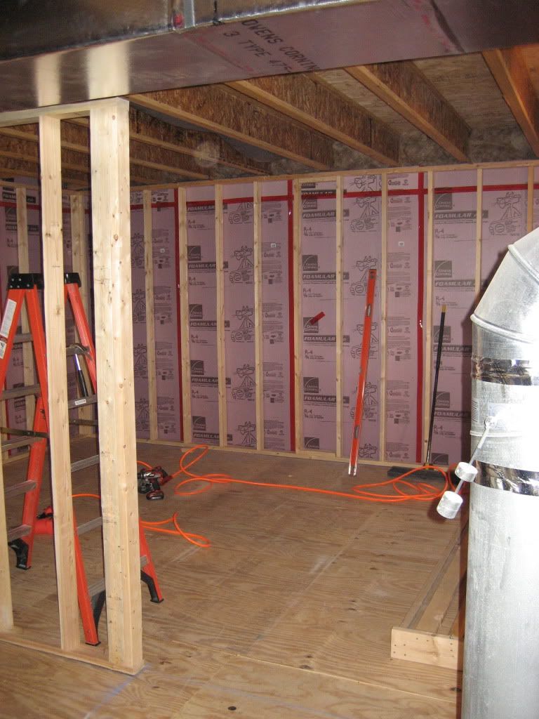

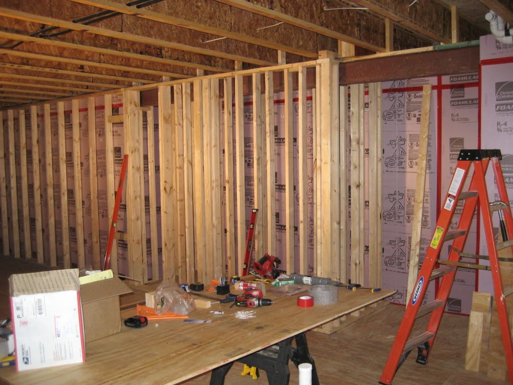

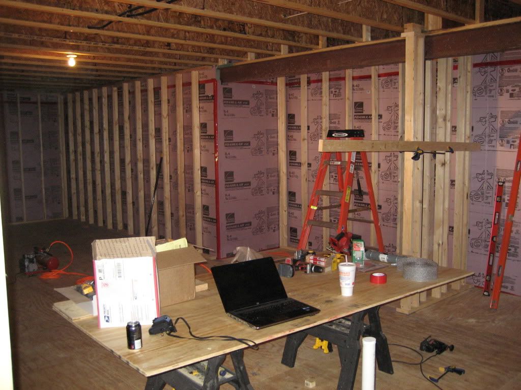

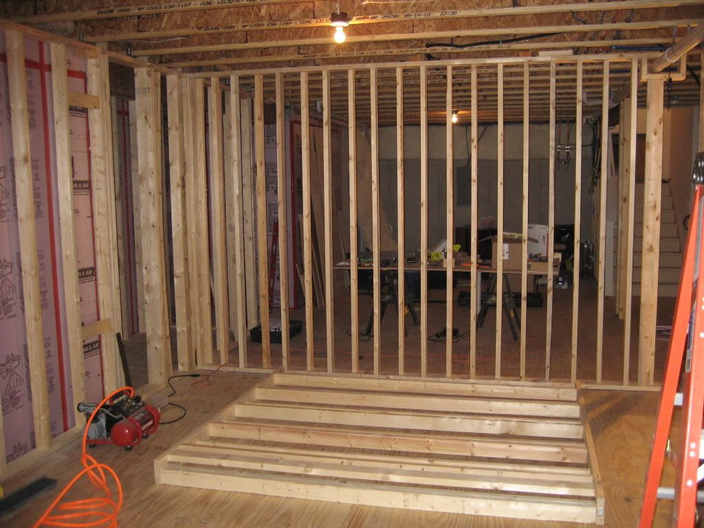

Here are a few pics of the days work.
Finishing the IB enclosure...
Soon to house (4) 18" IB3's!!
And here is a shot of the framing layout and the HVAC concern. The line shown is about 5 1/2" to 6" from the trunk. Will probably just shift this line about a 1/2" to make room for the staggered wall and the additional drywall. A little concerned with the shelving unit near the entrance. That will be tricky but I will cross that bridge when I get there.
vanice is offline

In terms of ventilation I would recommend the air exchange with the rest of the basement approach. That way you don't tie into the house HVAC at all and risk letting sound into where it can be distributed throughout the house.
Also what are your plans for the ceiling in the IB enclosure? I assume whisper clips and hat channel with double drywall plus green glue? That I-beam is going to cause a little trouble in terms of soundproofing that space. Considering the fact that you will have four big subs in there I would build a soffit around the I-beam. Build a 2x2 frame and hang it from a piece of channel reinforced with extra clips on both sides of the beam. Then cover with double drywall and green glue. Alternatively you could do the OSB and drywall method to eliminate most of the 2x2's. This will ensure that the beam is not a flanking path.

post #89 of 1328 Old 02-19-2012, 06:43 PM - Thread Starter
vanice's Avatar
Join Date: Jun 2010
Location: Southside Indy
Posts: 1,222
Quoted: 32 Post(s)
Liked: 54
Here is the weekends progress. Pretty excited because I nearly have a completely framed theater. Still have to frame the equipment room and entryway (and the rest of the basement for that matter) but I feel good about my progress. On with the pics!!
Looking at the new front wall (from outside the theater room).
Standing at the entryway looking into theater room.
Looking at the front wall. Still have a wall to put up but need to do some framing around the drainage piping first.
Standing in the theater looking out the entryway.
I would like to try and get that wall on the floor up and installed this week.
Seeing the room take shape is exciting. It makes me want to keep pushing a little farther each time I am working down there.
