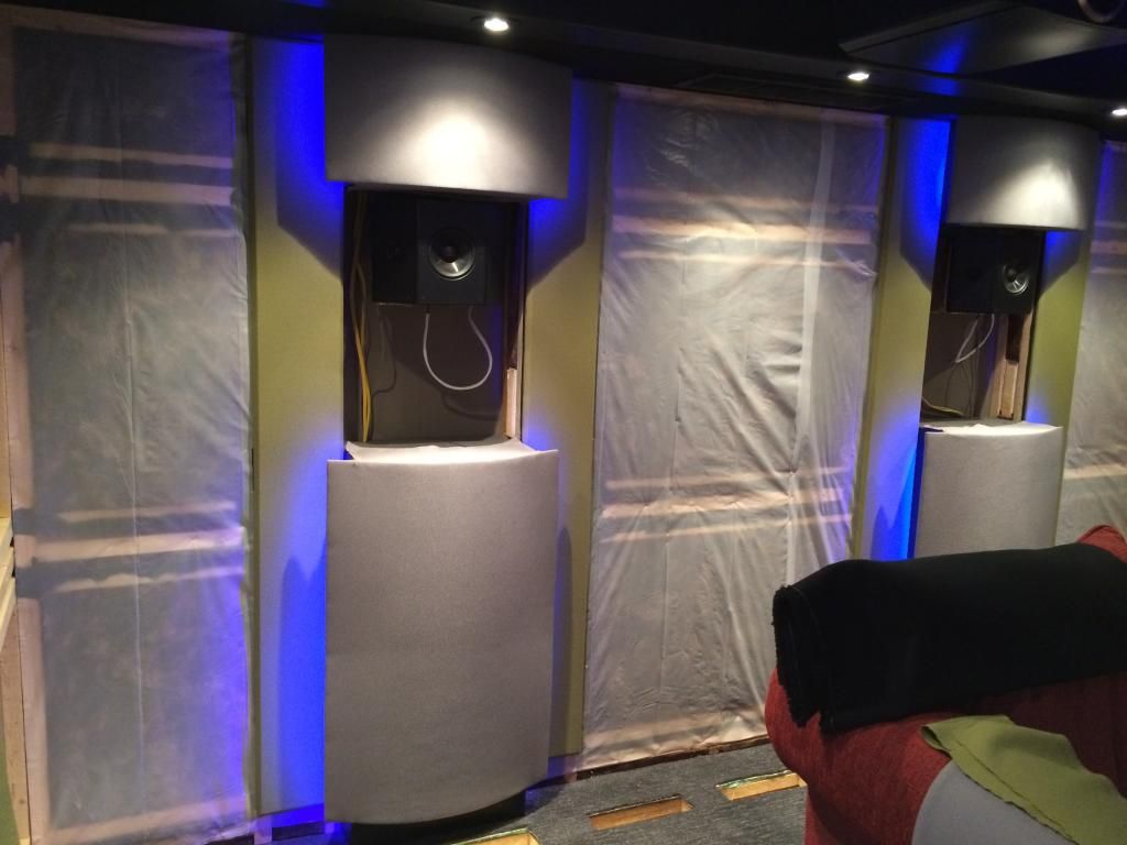

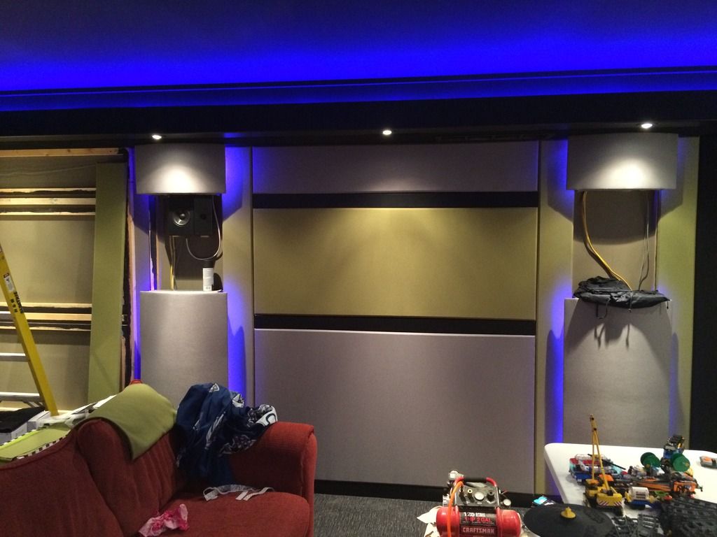

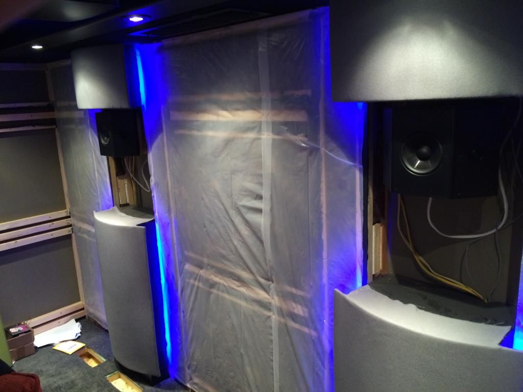

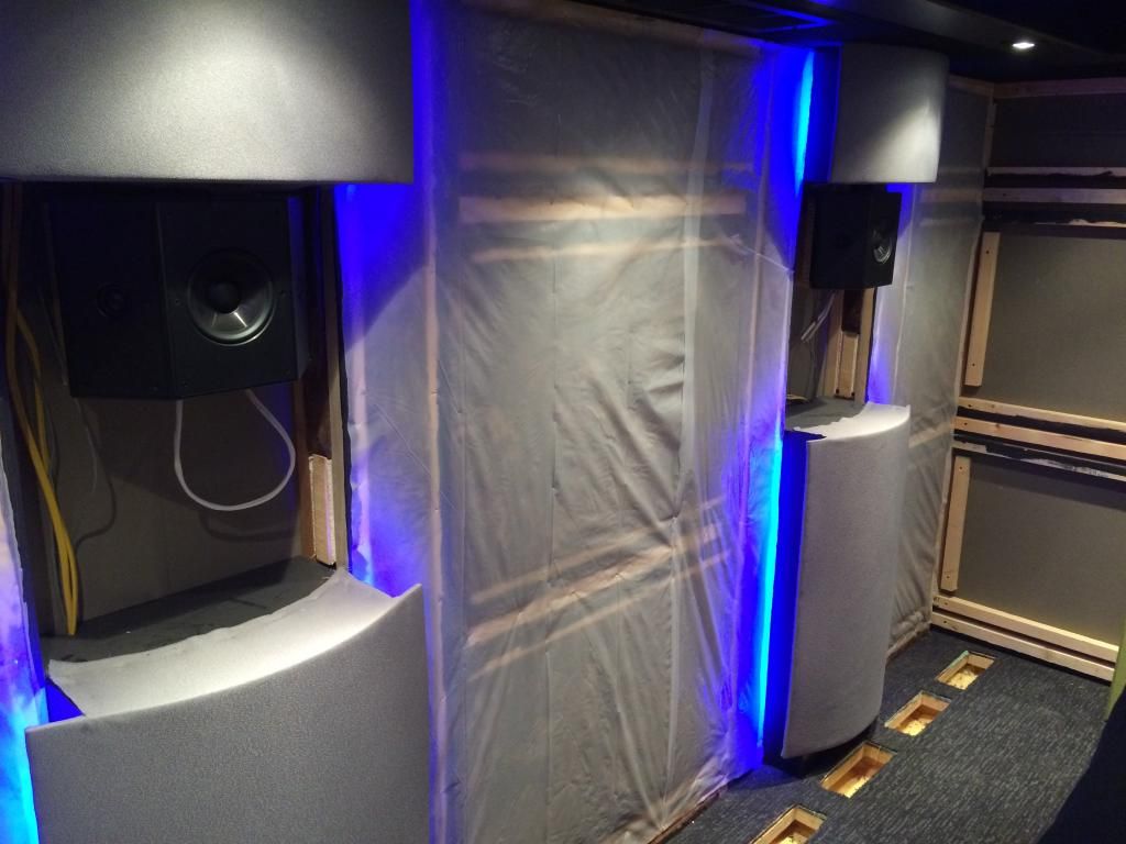

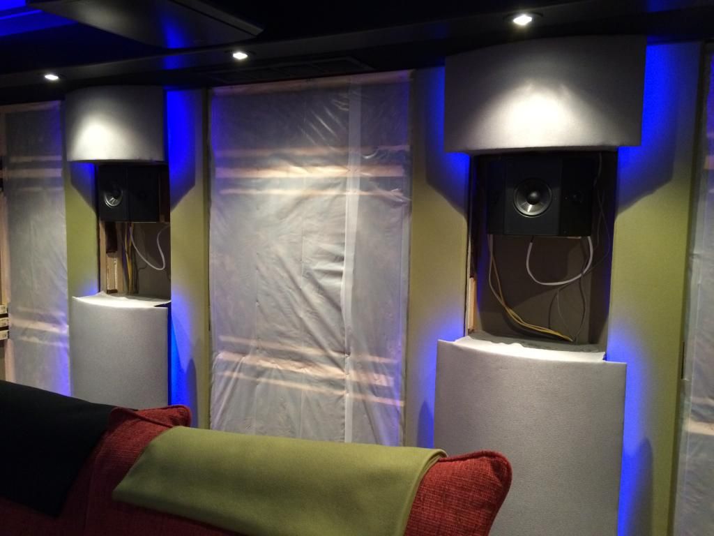

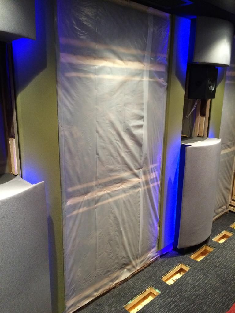

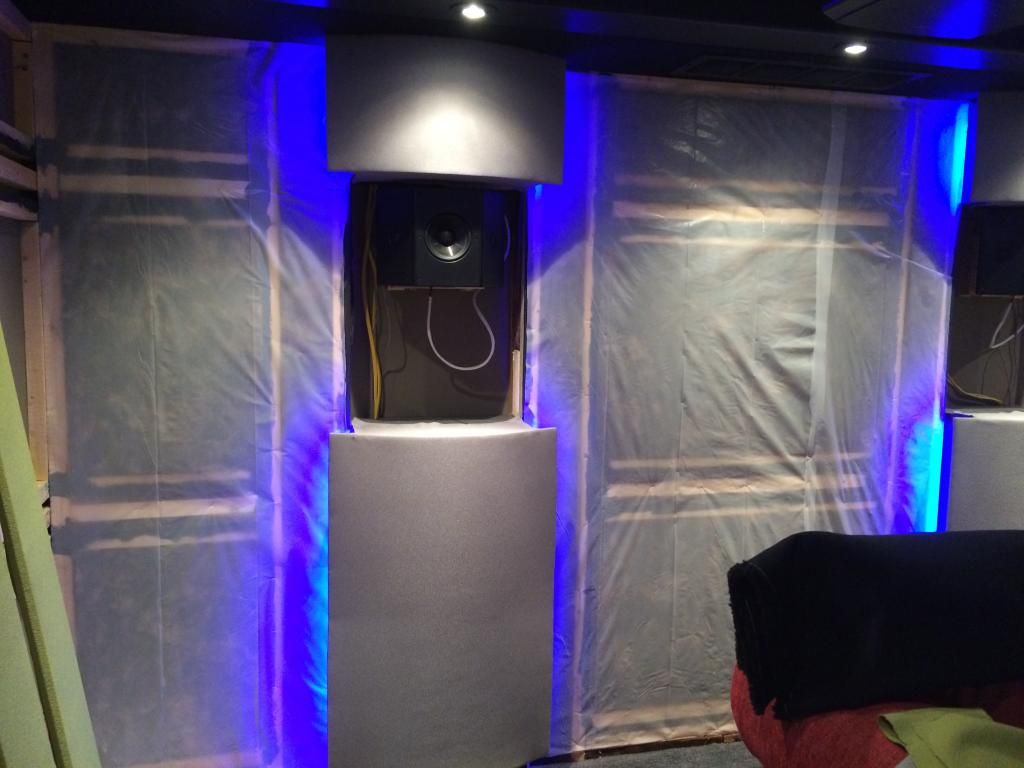

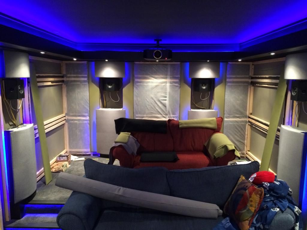

Minor update - This weekend I found a few moments to finish my back wall insulation and plastic. I also added four of the vertical green panels that I had complete but just sitting around.
Pics showing the 4 mil plastic stapled over the 6" of knauf insulation.
And now with the four new green panels added.
And a new overview shot of the back of the theater.
I still have two green panels to install on the sides and then I will be ready to start making some new panels to fit between all of these. Slow progress but it's still progress I guess...

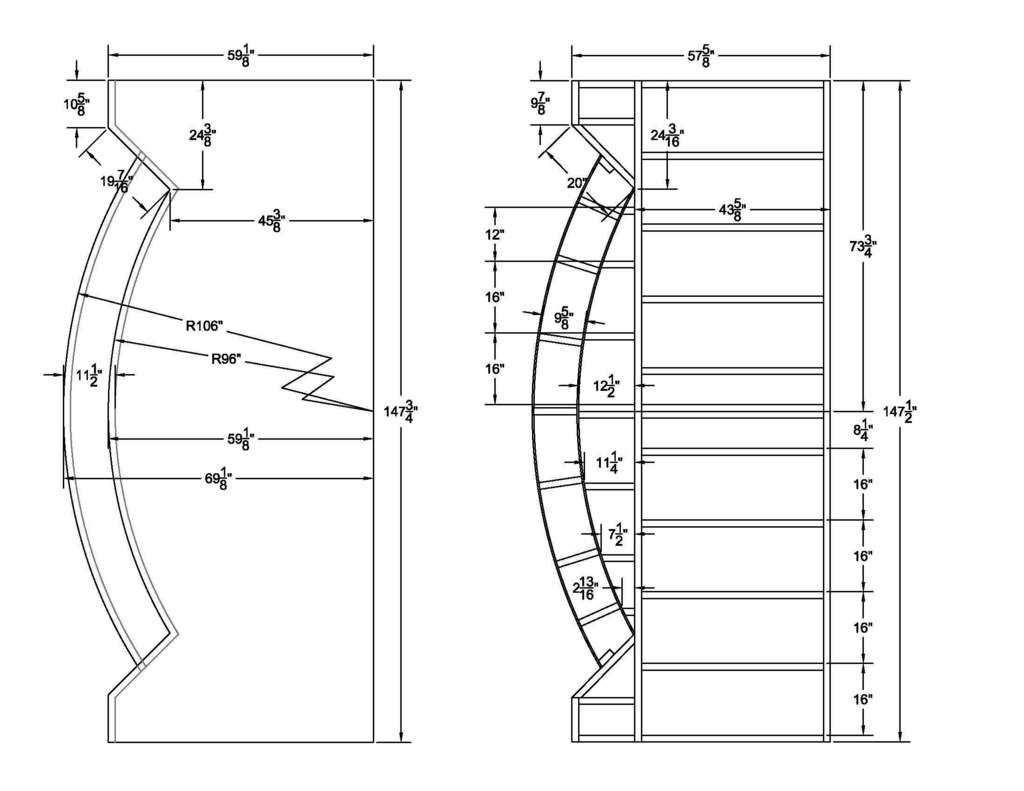

Your build is looking Awesome bud! I have a question, how did you spec out your stage??? Dimensions?

Stage Dimensions
Thanks for bringing me back from the dead bsuave. I think I can help you out with some dimensions. I work in CAD on a daily basis so I used it to draw every aspect of my room. It was such a huge help saving me time and money since I could draw everything out ahead of time.
Anyway... The rear part of the stage is constructed from 2x10 lumber while the front step is 2x4. The rear section and the front step both have two layers of 3/4" OSB on them. The front face of the curves is 1/4" plywood ripped to the req'd height. Then throw in about 3500lbs of sand!
The left view shows the finished dimensions (with lip overhang on the steps) and the right view shows the framing. Let me know if you need other dimensions that aren't shown on the drawing below or have questions about a dimension.
damelon and bsuave like this.

BTW... THAT... is a detailed drawing. Much better than the hand drawn stage charts I tried to provide back in the day. Good work there, even though it is late.
That stems from my day job as I work with CAD all day. Not only did I draw out my entire theater in CAD but I also did the rest of my basement build-out. Made construction much less trial and error.

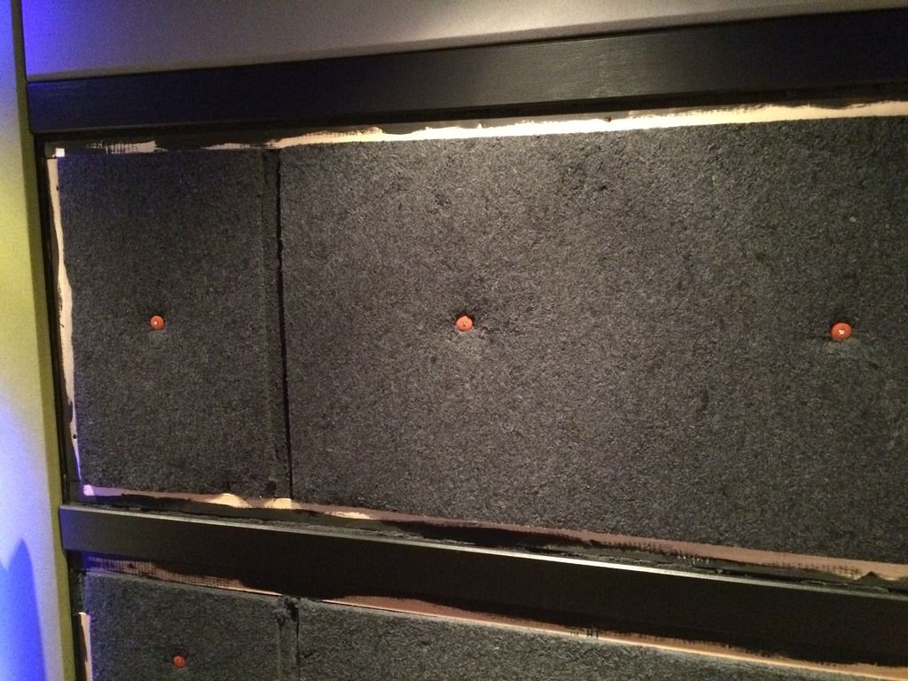

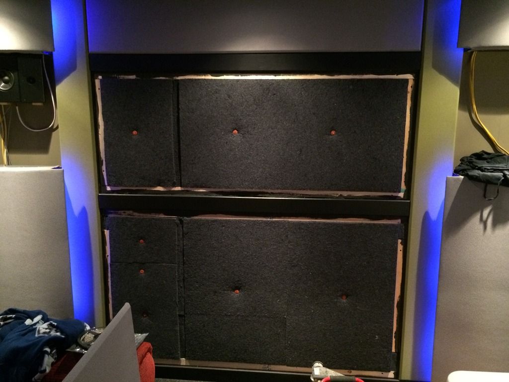

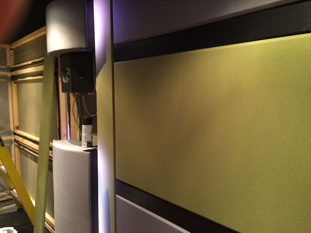

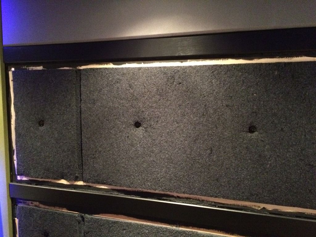

Here are a few updated pics I took for one section of wall that is now complete.
The acoustic cotton going on the wall (2" thick). Hung with roofing style nails. Painted the caps so they wouldn't show through the fabric.
Then the panels go on with Velcro. Even the black MDF strips are hung with Velcro.
This is the view when you walk through the door. I like the look. We'll see what it looks like with more completed in the back. Not sure when the column speaker grills will get done.
As I said in a previous post, I have four more panels ready to cover and several strips ready for sanding and final paint coat. Not sure when those will get done but I will post updates when they do.
vanice is offline

Originally Posted by vanice View Post
Today's progress...
Not as much done as I would have liked but still progress. Nothing fancy, still working on the sheathing and plywood. A few pics...
Looking toward the rear of the future theater space.
Looking from the right of the future theater spacer.
Hoping tomorrow to have more of the plywood floor in. If all goes well I should complete this stage of the build by early next week. I tend to overestimate my ability so don't be surprised if I am still working on this next weekend.
Is there a noticeable difference with using foam insulation boards and plywood vs. the plain concrete floor as far as sound isolation and insulation goes?

I can't say that the sound isolation is improved with the foam and plywood on the floor. I did it for the thermal insulation from the concrete floor and I would say that it did a pretty good job in that respect. I've been in basements where the flooring is laid directly on the concrete and it is cold. Mine is warmer. I do have tile in the bathroom and it is still cold even on foam, plywood, and backer board.

I like the look of that finished wall section, very professional.
Thanks for the compliment. I just wish I were further along by now. Progress comes in spurts and hopefully I have another one coming soon as I have some pieces that are pretty much ready to go up on the walls.
