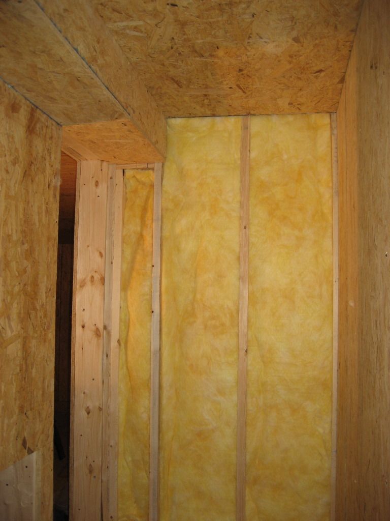

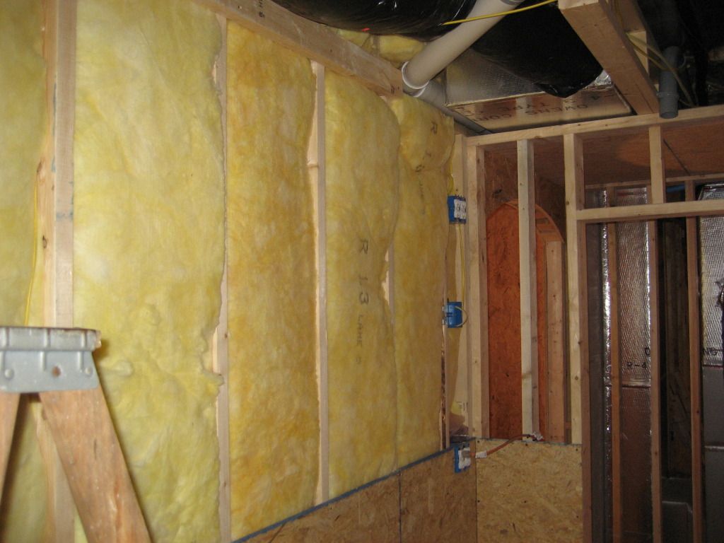

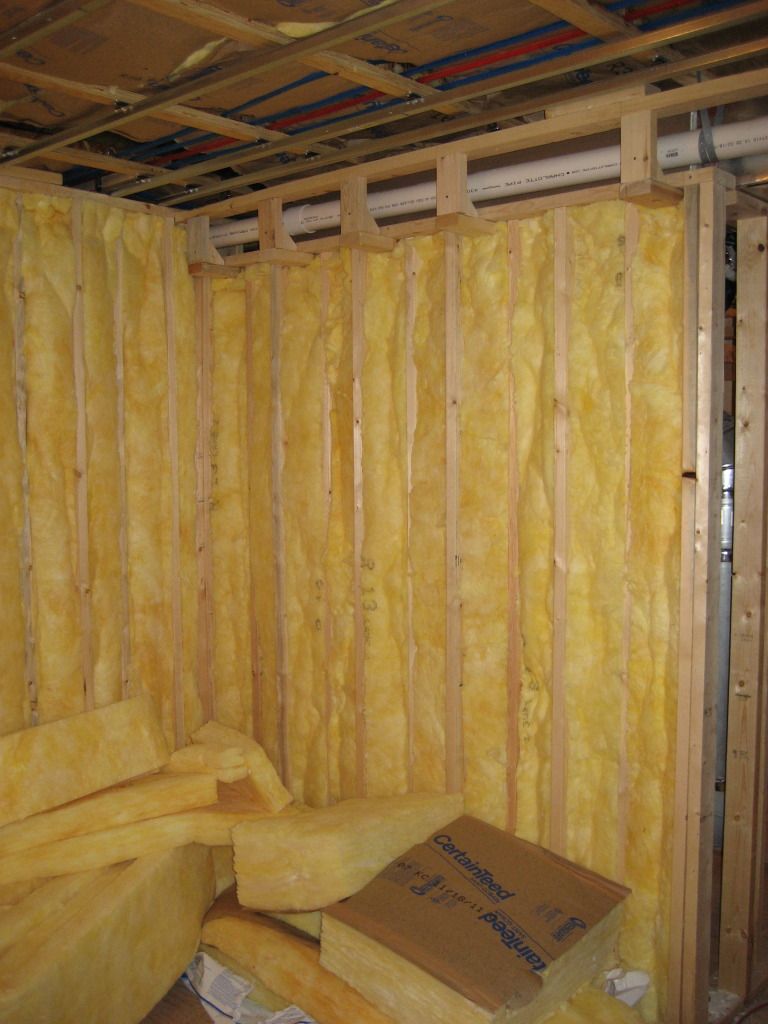

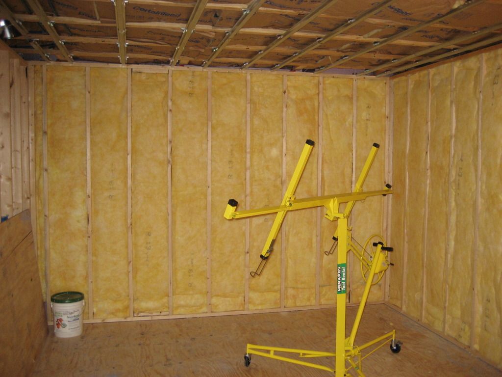

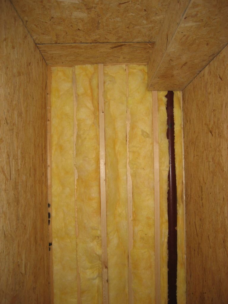

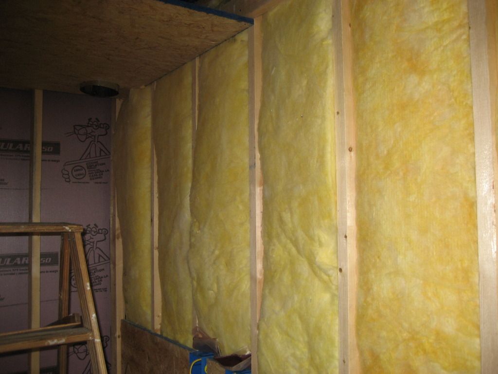

Weekend update. More pics!

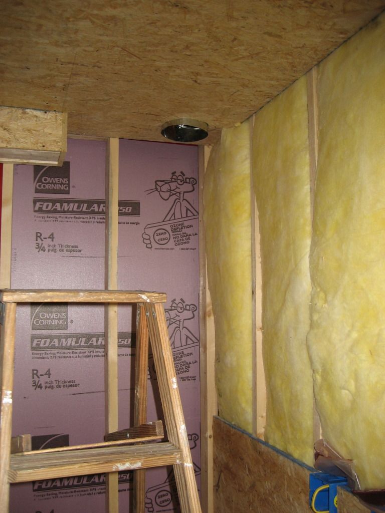

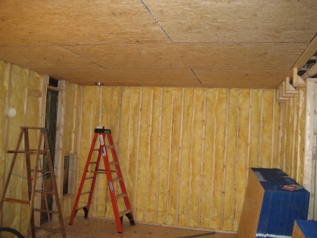

Insulation up...
Modified insulation pieces to fit in staggered stud wall...

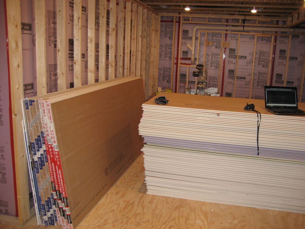

Drywall has been moved into the basement with the help of 7 friends. Only took us about 40 minutes.
OSB ceiling up...
OSB walls going up...

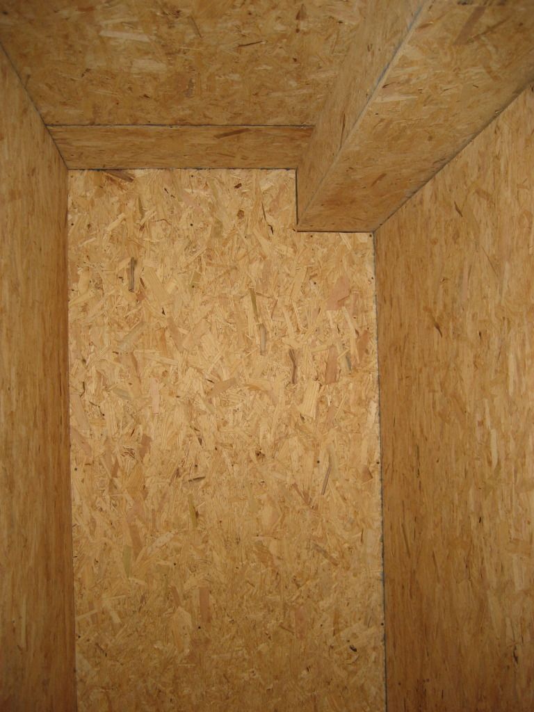

IB enclosure...

Thanks, I have to say that I was itching for about a day after working with the insulation. The worst was putting it in the ceiling because everything fell down on me with no way to get away from it. That was a rough day and a half of itching.
I don't think I was prepared for the time it would take to put the OSB on the ceiling. Getting the fine thread screws to pull the OSB tight to the channel without stripping out was an exercise in patience. I am not looking forward to doing the drywall on the ceiling and trying to hit the channels again. At least the OSB will give me a little extra security if I should happen to miss or not get a good connection. It felt like a vacation once I got to the walls. I was starting to make some good progress at that point. Then came the IB enclosure and another big slow down. Lot of cuts and odd pieces. This took me to the end of my work on Sunday and a well deserved rest.
This week I plan to do more wiring in the equipment room and other areas in the basement so that I am ready to rock and roll next weekend with more OSB and maybe a little drywall in non-theater related areas.

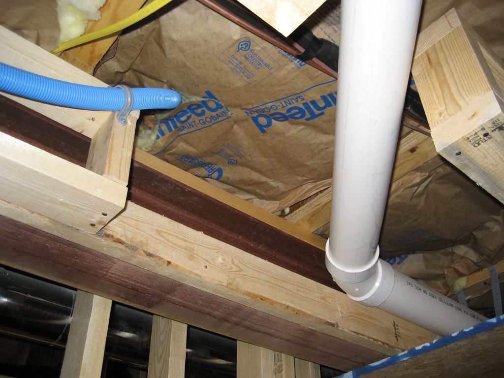

Liked: 265
Hey! You had a wonky PVC in the corner of your room/ceiling too! Yay!

Almost finished with IB chamber.

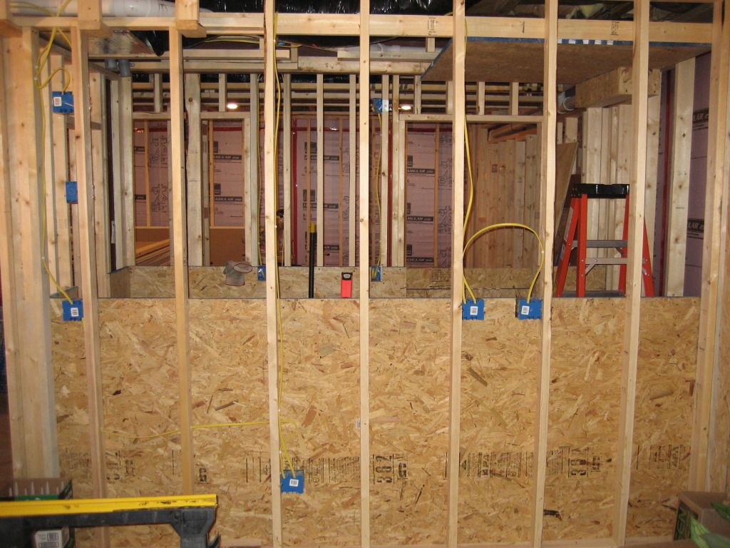

Ran electrical for equipment room.
Started putting up OSB in the equipment room.
Conduit added from the living room to the HVAC area.
Hopefully I'll get a chance this week to finish a little more wiring.

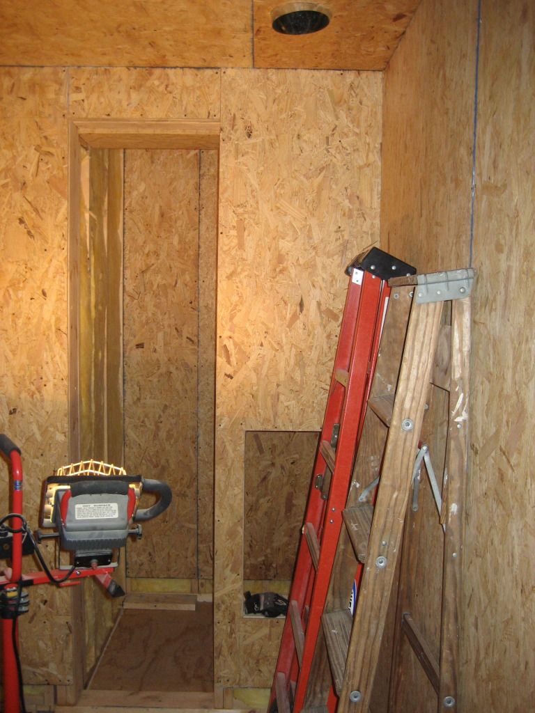

Small update from the weekends work.

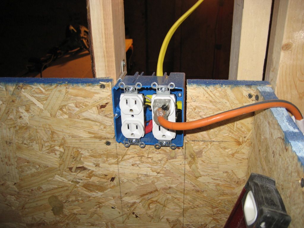

A small thing but a big help...working outlets!
IB enclosure is pretty much done and ready for drywall.

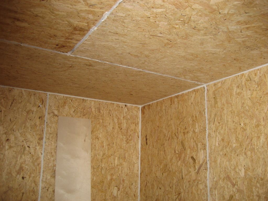

Caulked all the joints and seams of the OSB that I have up.

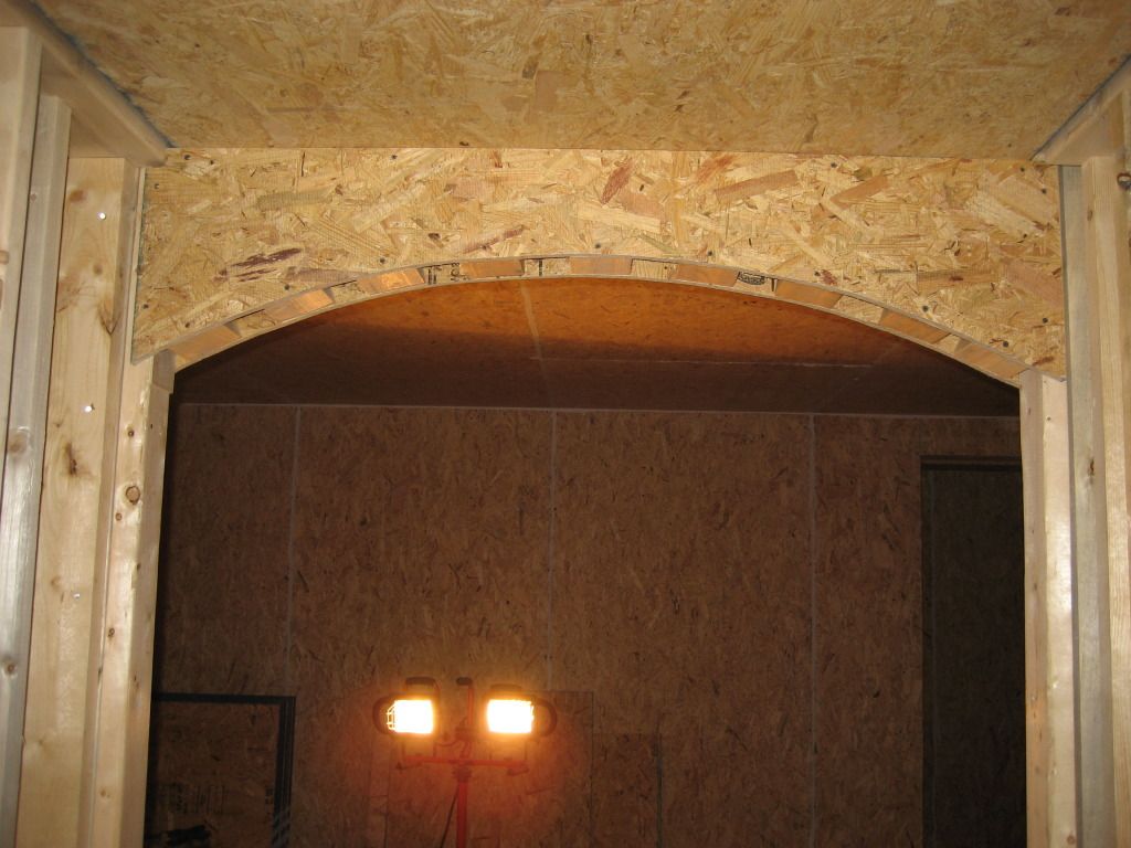

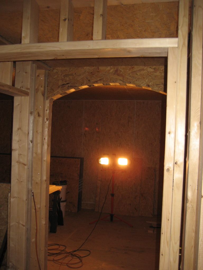

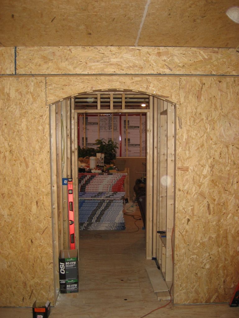

And the main project today. Created an archway in the small hall entryway into the theater. Pretty happy with how it turned out.
Need to do some additional wiring so that I can finish off the wall between the theater and the equipment room. That might get me to my next milestone of having all the walls in the theater room covered in OSB. Then it's on to green glue and drywall.

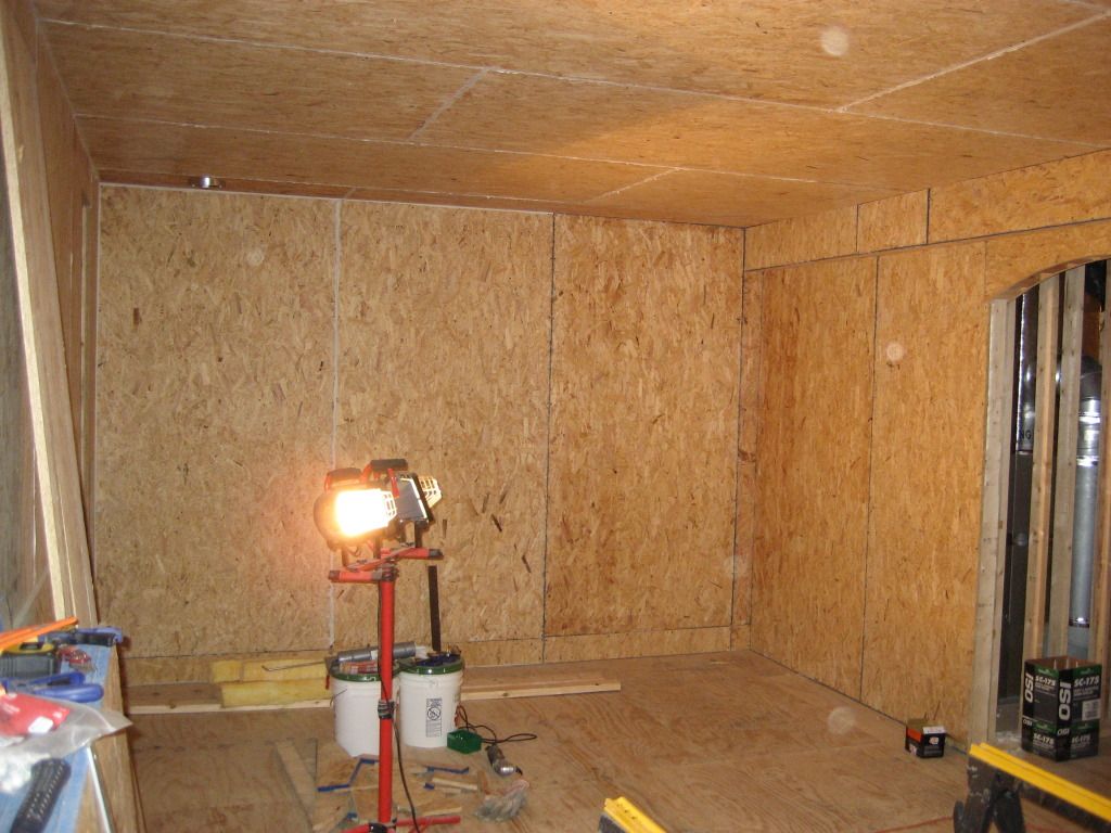

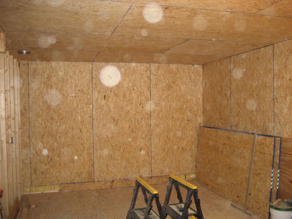

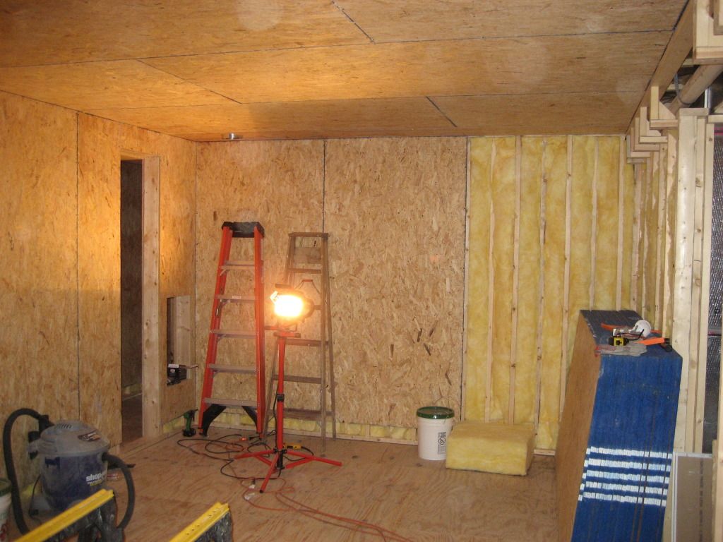

Very limited work this weekend. Three day weekend and only one day to work kinda sucks but I did get to hit the pool twice and enjoy some 90 degree temps. On to the progress...

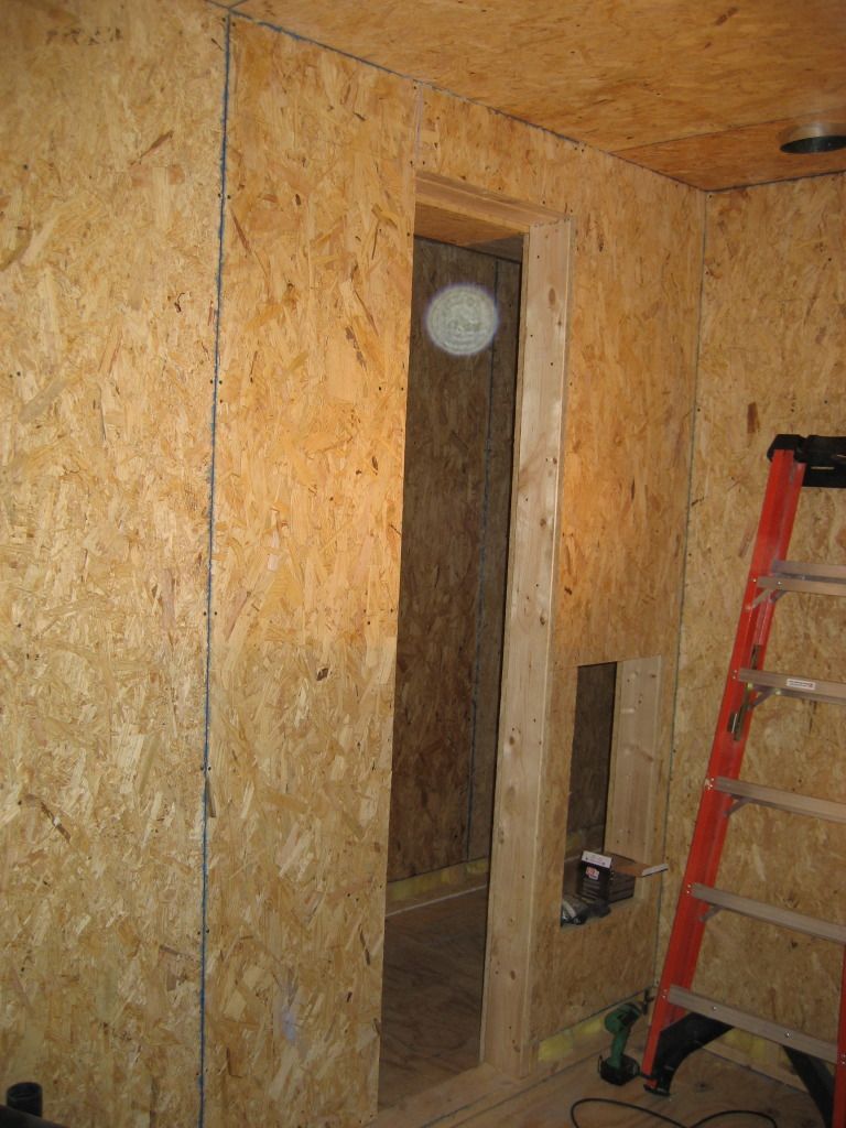

Some insulation up between the theater and the equipment room.

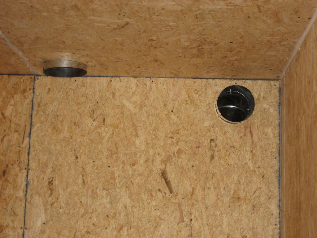

Added a vent connection between the theater and the equipment room. This will be the dead vent connection to pull hot air from behind the projector out of the theater, through the equipment room, and out into the main basement living area. There will also be a dead vent for the front to bring air in.

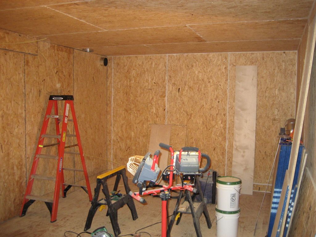

View from the theater side. The vent on the right will be the dead vent. The vent on the left is the cold air return tied to the HVAC system.
Added putty pads to the back of some of the outlet boxes. This picture looks a little funny because the top of the pad plastic hasn't been removed yet. I am not ready to put the top piece of OSB up on the wall so I can't complete the pad. Hoping this keeps the pad from drying out before I finish the OSB.

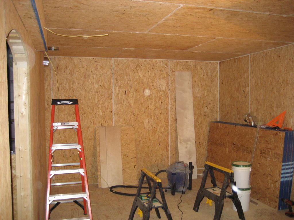

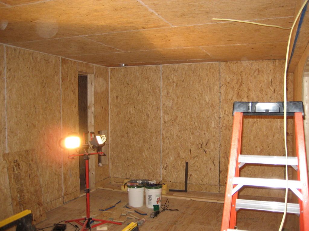

Also finished all the OSB in the theater room. Only have to finish the entryway and the equipment room. Still need to do a little caulking as well. Some updated room pics.
View from rear left corner...
View from the rear right corner...
View from the front left corner...
View from the front right corner...
View from inside the theater looking out the entryway hall...
Might actually get to crack open a pail of green glue next weekend to put up some drywall in the theater and sub enclosure. More than likely though I will probably finish the OSB in the entryway. I also ordered some doors this weekend. Unfortunately they were not the theater doors (waiting for some pricing on those). Slowly coming together.
