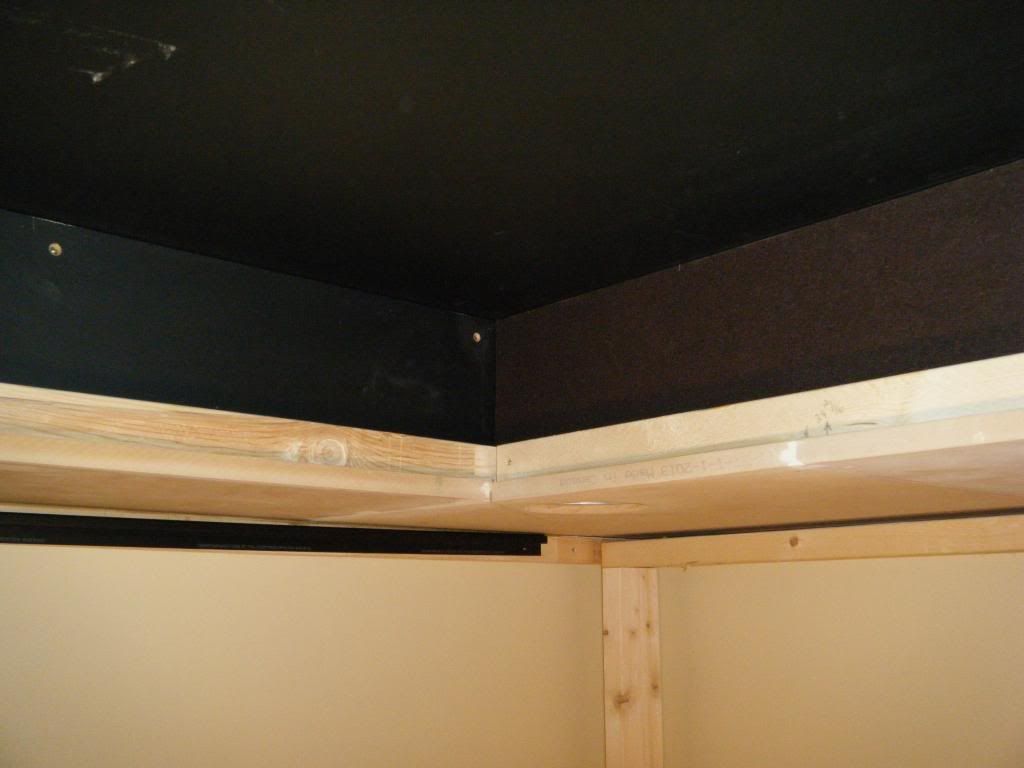

I wanted to avoid having to fill and sand all the screw holes and joints in the vertical section of the soffits. I found this brown felt roll with peel and stick backing at Fabricland at clearance prices. They also had matching felt fabric that I will use on the bottom portion of the soffits and the columns:

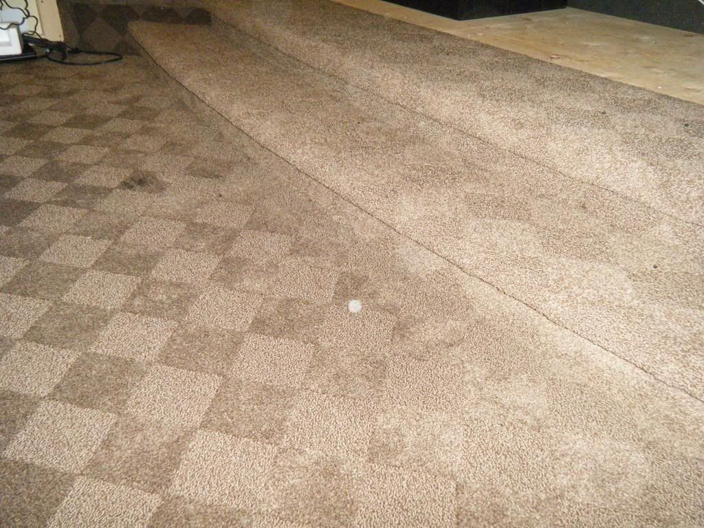

Carpet has been installed for a while. I'm a horrible photographer but this gives you an idea of the color. I had a close call with the installation. The roll they sent me was short from what I ordered. The installer noticed as he unrolled the final piece and it literally stopped at the wall eek.gif He didn't even have to cut it.

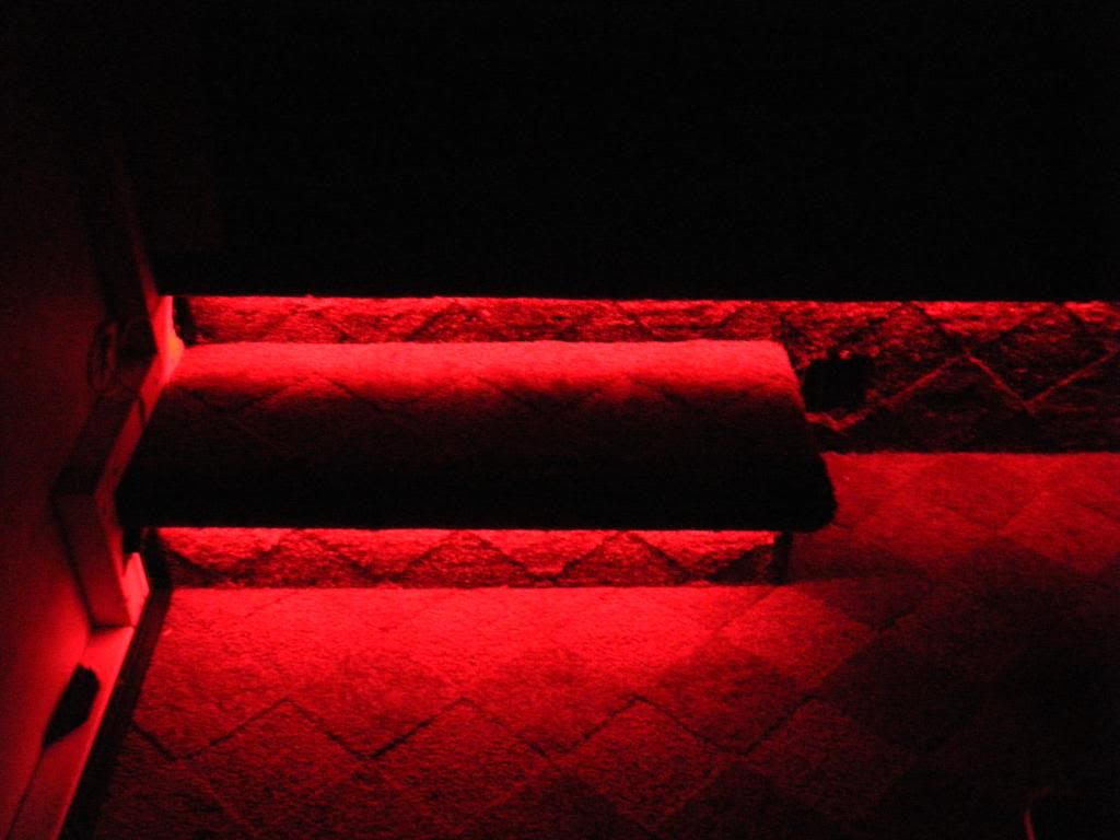

post #567 of 586 Old 06-01-2014, 10:27 PM - Thread Starter
235
235's Avatar
Join Date: Dec 2011
Location: Winnipeg
Posts: 497
Curved front soffit with black velvet into track:

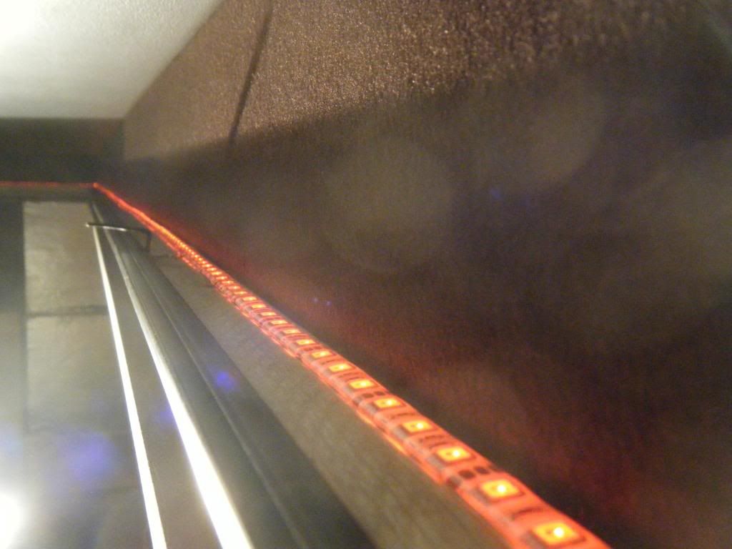

Led strip lights along soffits:

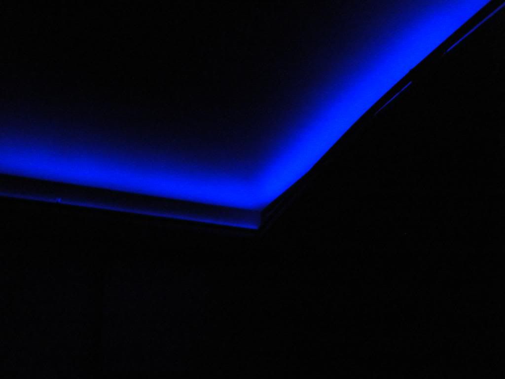

Can't decide between the blue and red:

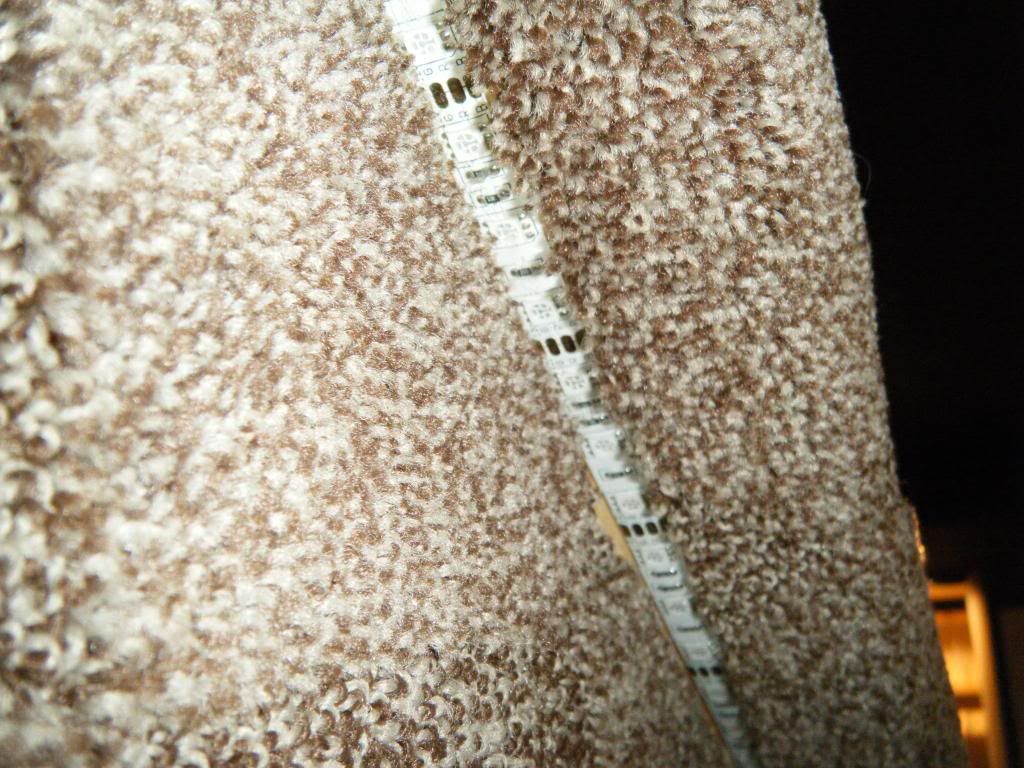

I had the carpet installer leave a gap for riser/step lights:
Peel and stick:
I think I prefer the red:
235 is offline
post #568 of 586 Old 06-02-2014, 07:03 AM
vanice's Avatar
Join Date: Jun 2010
Location: Southside Indy
Posts: 1,222
Quoted: 32 Post(s)
Liked: 54
Nice work on the LEDs. Those step lights look great. I'm partial to blue in my room but that is what's great about color changing LEDs, you can switch them up at any time for a change of pace.
