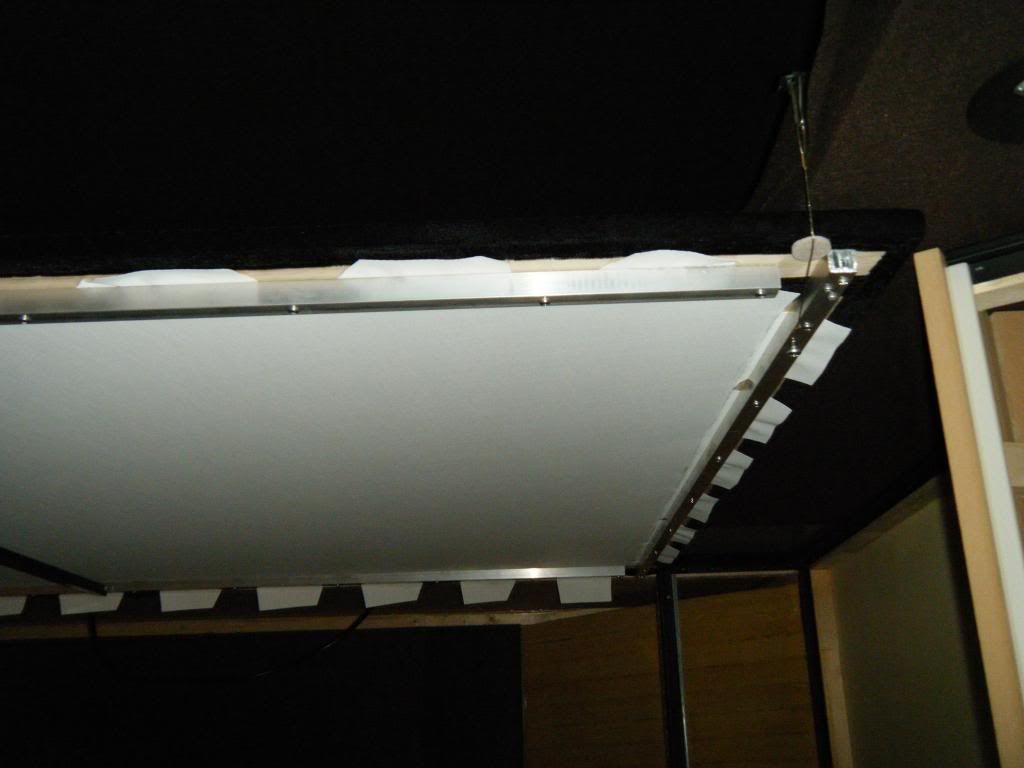

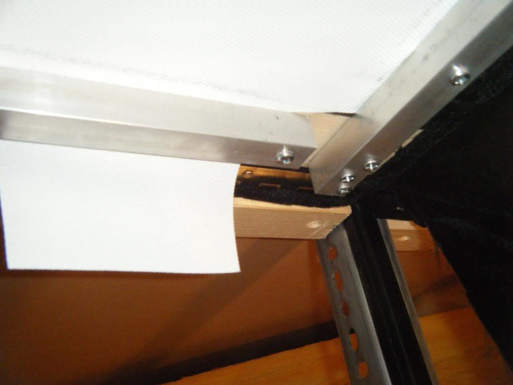

Jamestown screen mounted to 2x2 using piano hinge:
Brackets in side soffits can hold up screen to allow easy access to speakers behind screen:
View from behind the screen:

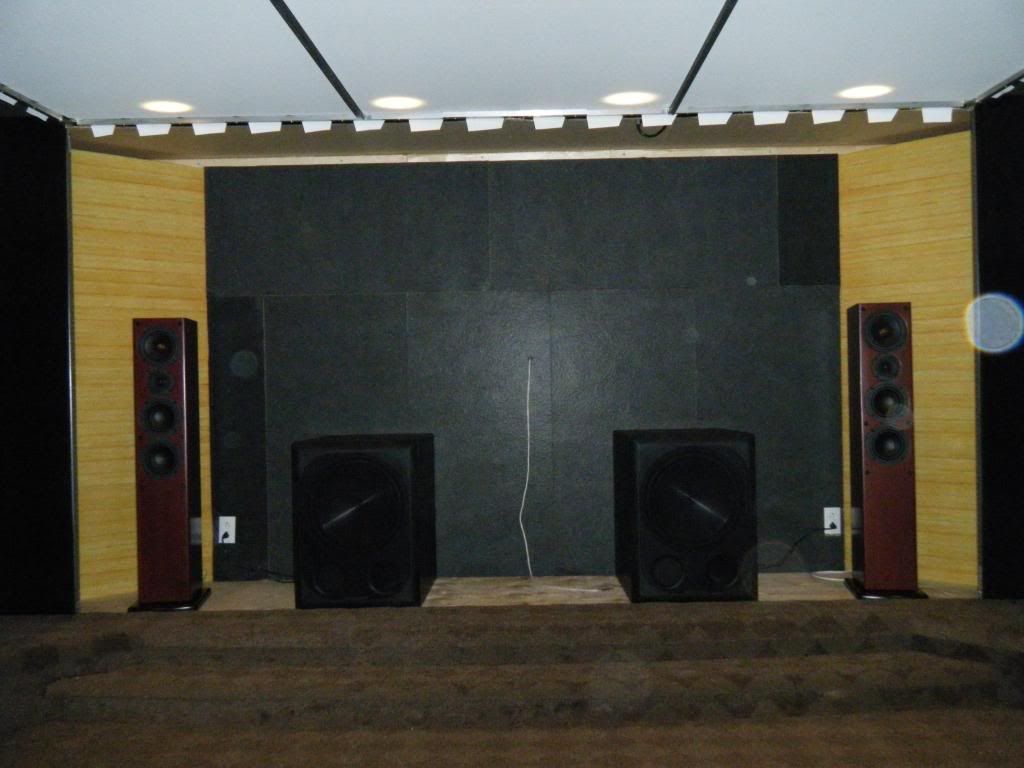

The great looking Sierra towers (still working with Dave on the midrange problem) and 15" Rythmik subs:

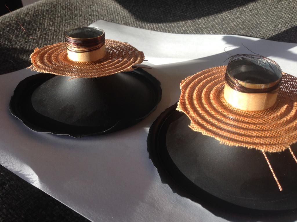

I worked directly with Dave at Ascend to resolve my blown mid woofers. He charged me a highly discounted rate for the replacements and I sent in the woofers for him to inspect. Had there been a manufacturing defect then he would have reimbursed me fully for the cost. He sent me back this pic, unfortunately it looks like I just cooked the coils:

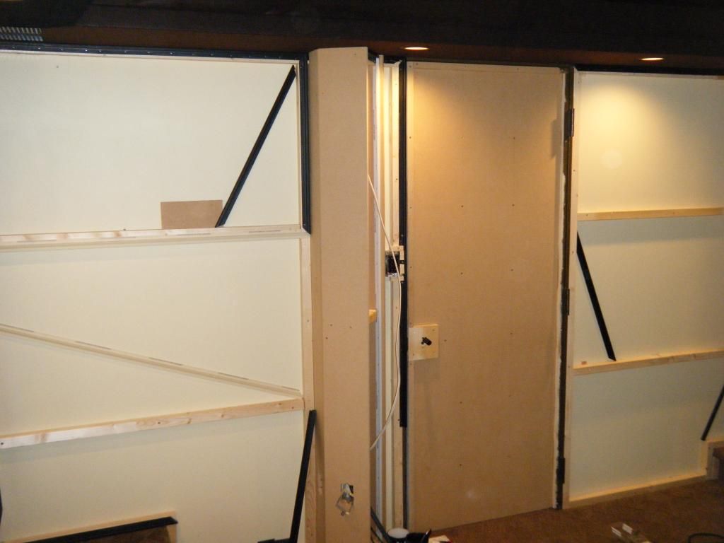

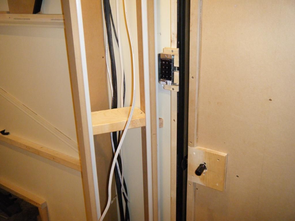

The door with the handle test-mounted showing the offset bolt.

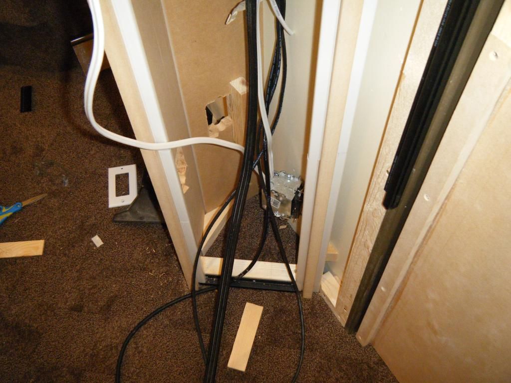

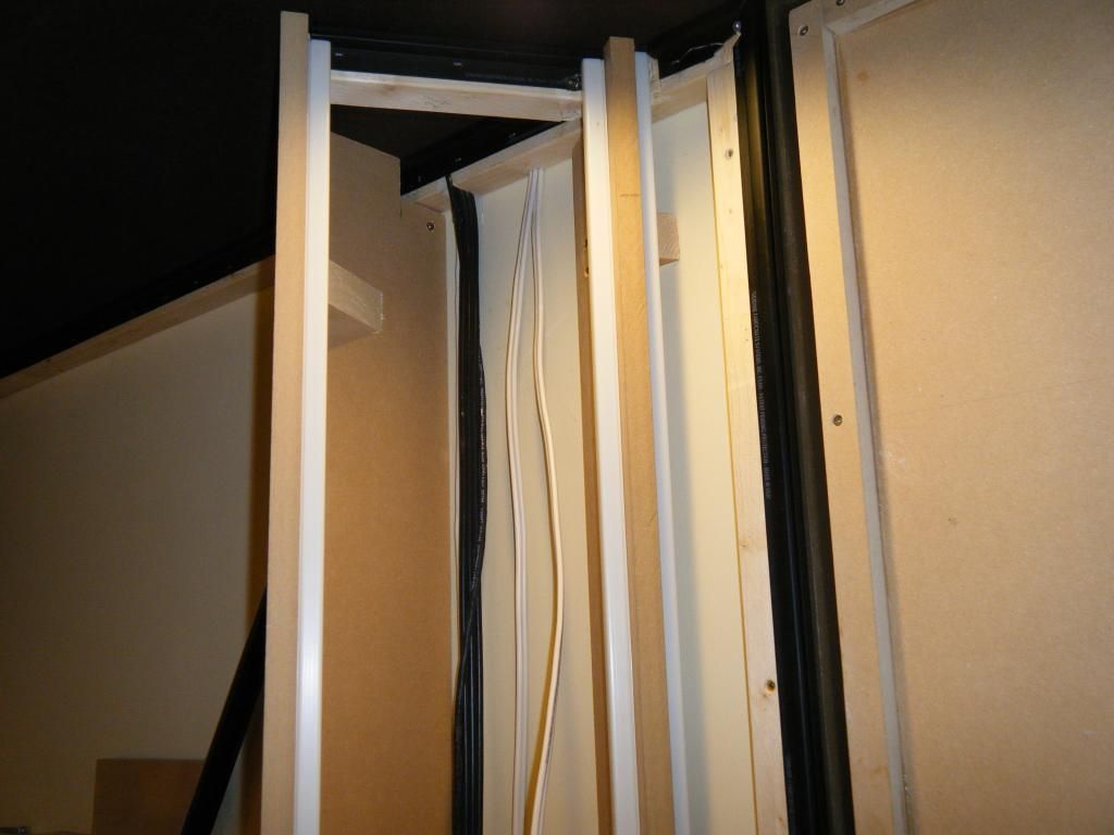

Front column angled to suit front-wide speakers. 3/4" MDF screwed into 2x2's on the wall.
Shelf to hold up speaker:
Track stapled to MDF for vertical pieces and stapled to 2x2 for horizontal pieces.
Using column for electrical and low-voltage wiring.

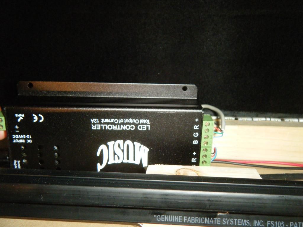

Also added this inline with my LED soffit lights. I can activate a music mode where the lights flash with the beat of the music. Works pretty good.

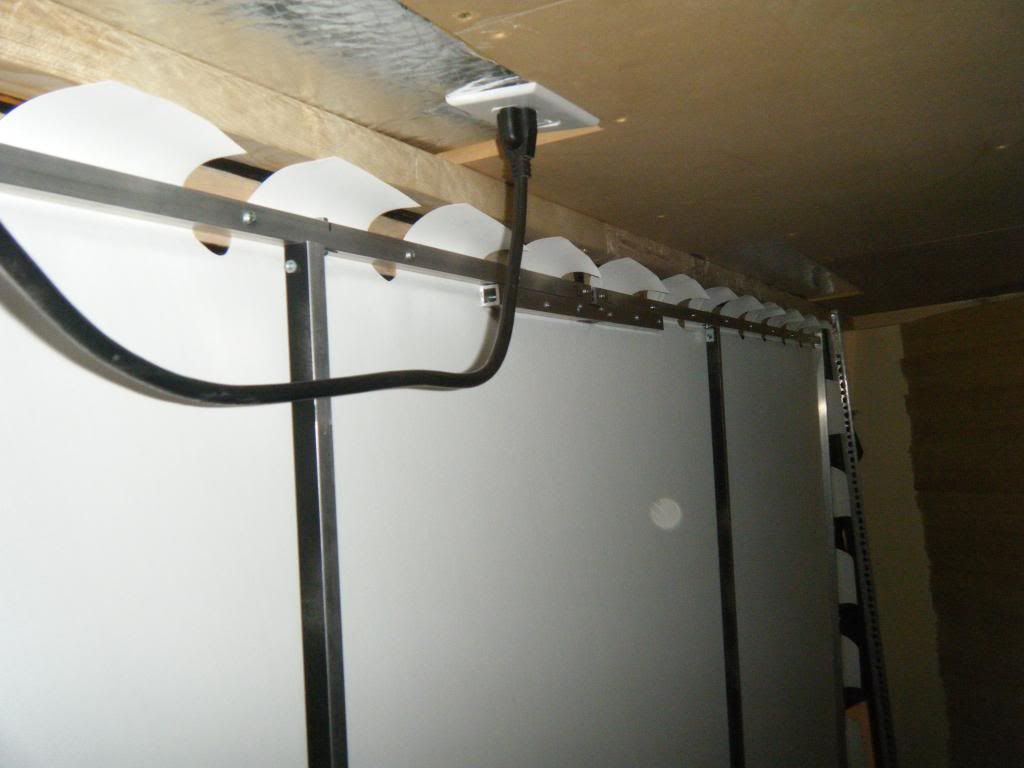

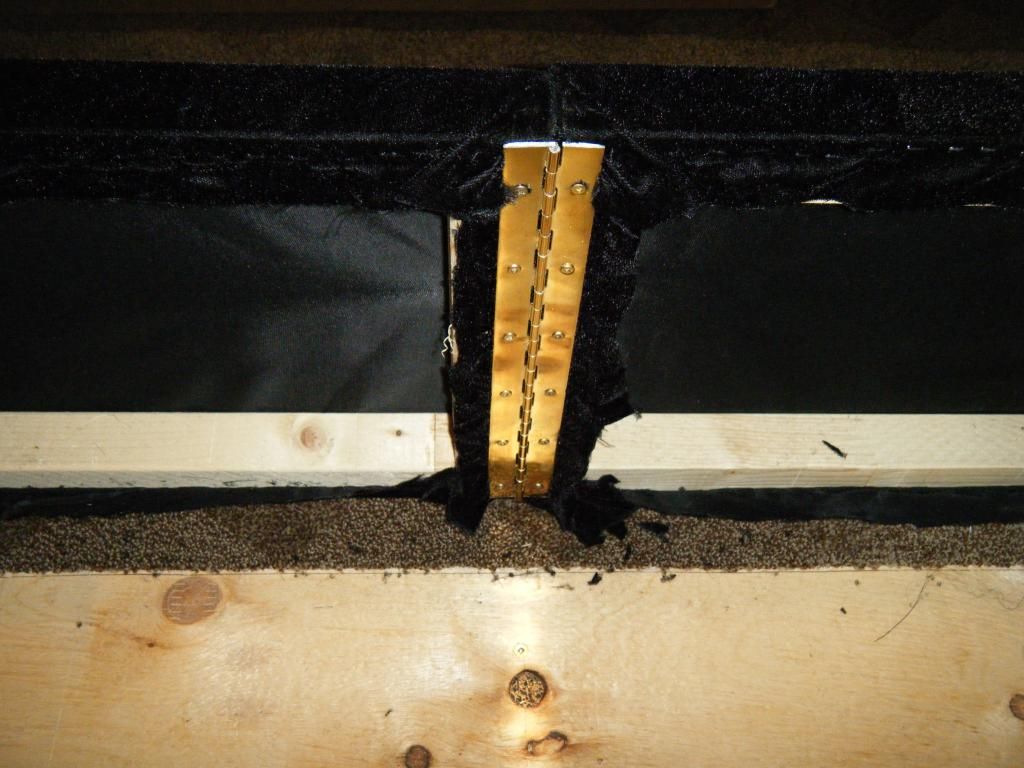

Catch up time. Black velvet being inserted into curved track on front soffit. The velvet was pinched behind piano hinge at the top of the screen. I covered the shiny hinge with a roll of adhesive black velvet. This worked out well. I also have an extra Jamestown screen like the one here that I will be selling (235 aspect, 118" wide, acoustically transparent). If anyone is interested then please PM me.

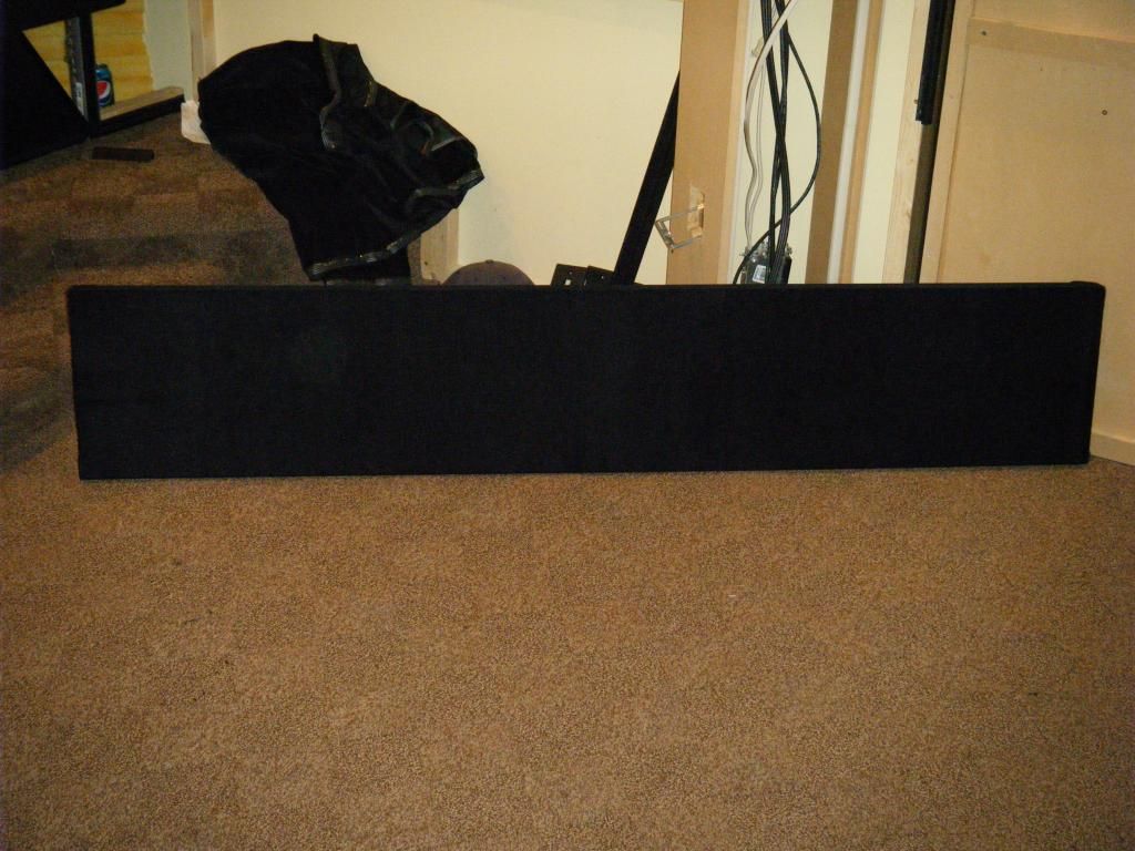

Removable velvet panel below the screen made from 2x2 with stapled velvet:
The first half:
Hinge between the two halves allows for easy removal to access speakers:
