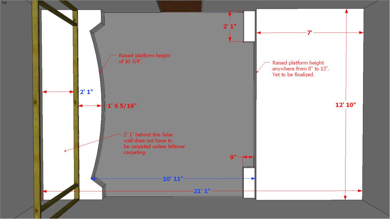

post #120 of 586 Old 07-10-2012, 11:54 PM - Thread Starter
235
235's Avatar
Join Date: Dec 2011
Location: Winnipeg
Posts: 497
Here's my first cut at the riser and stage dimensions. I hope this will be good enough for the carpet installer to determine amount of carpet needed. Next up, finalize my screen purchase and get schooled on installing GOM. Anyone know of an easy way to determine how much fabric I will need to order?
235 is offline
