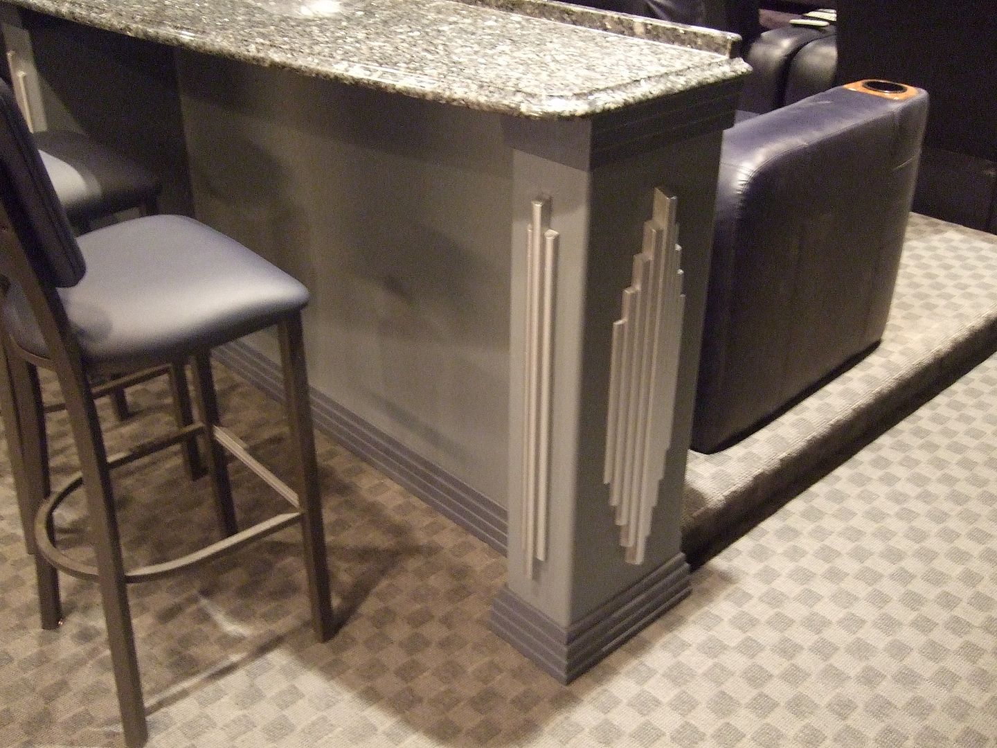

Copied in from my multi-year thread. I think it is 42 inches tall.
First the finished granite top is 135 inches long, 17.5 deep at the ends, 25 deep in the middle. Yes, finding a slab that long turned out to be a problem I had to go to the regional wholesaler to pick out the slab and then my fabricator ordered it. When I planned it the fabricator had one long enough but it was gone by the time I needed it.
Final view:

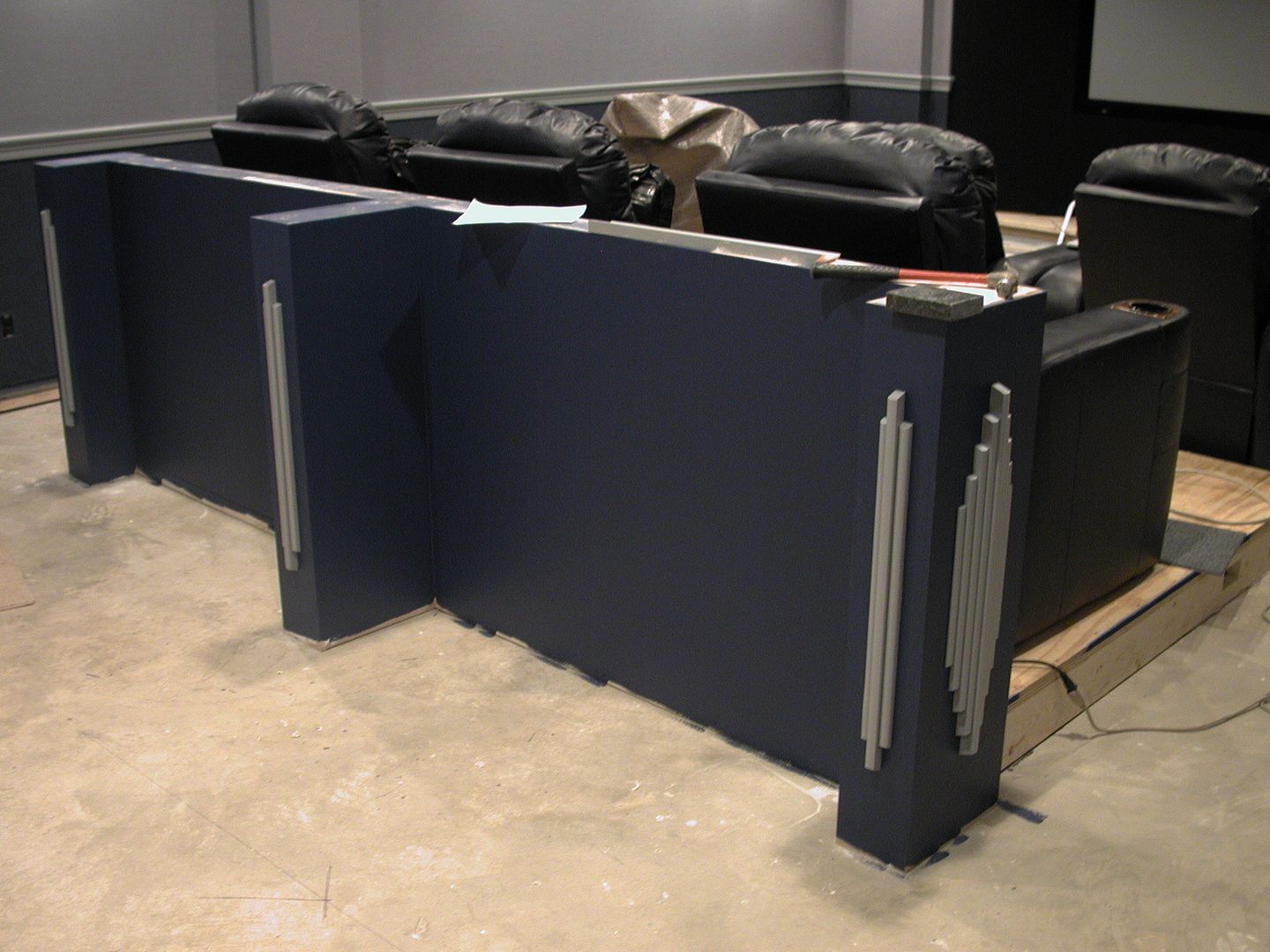

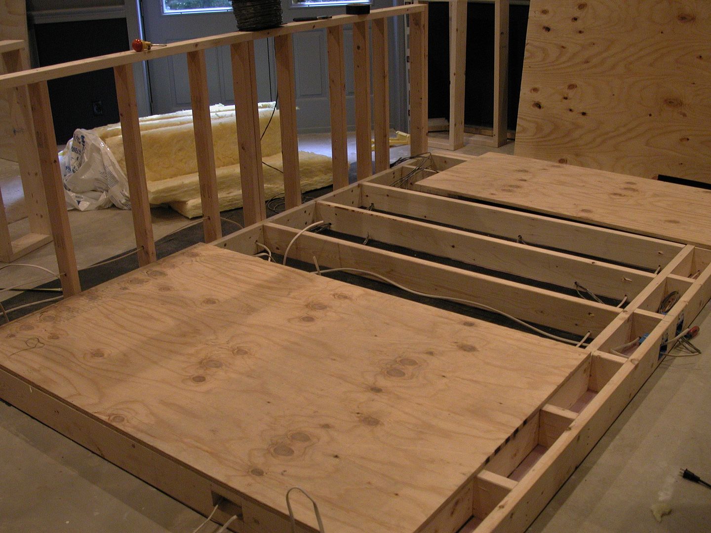

Some of the framing, basically a 2x4 short wall, with 2x6 wings (purely aesthetic) screwed to the back of the riser and to the floor. you can see I changed my mind on how deep the riser needed to be. 6ft didn't cut it.
Covered it with a combination of plywood and MDF. The wings are MDF.
The designs were scraps of wood that I wondered if I could ever use. It started out life blue but I changed it later.
I ended up rounding over the edges, Added base molding and repeated under the top. The base molding was a build up of a 3 step and then another piece making it a total of 4 steps.
decided it looked better gray.
