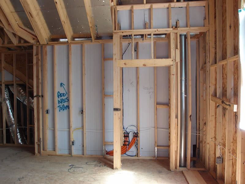

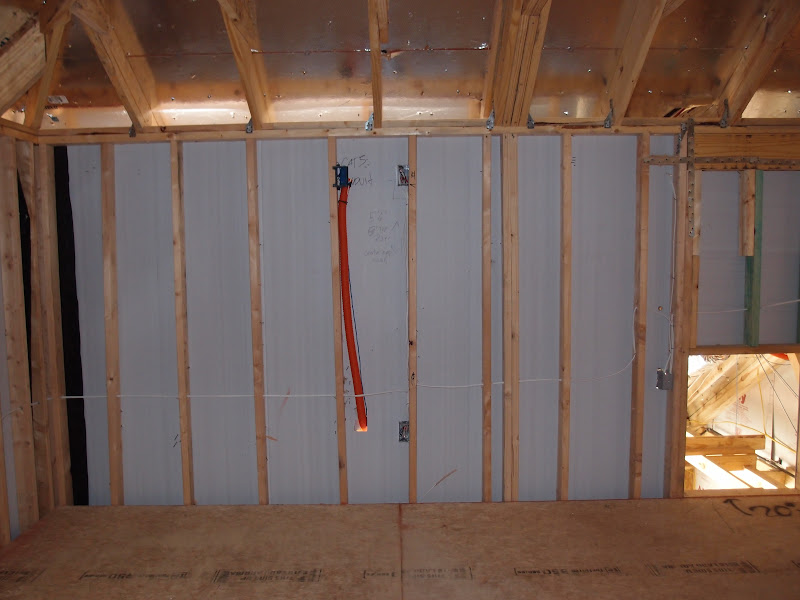

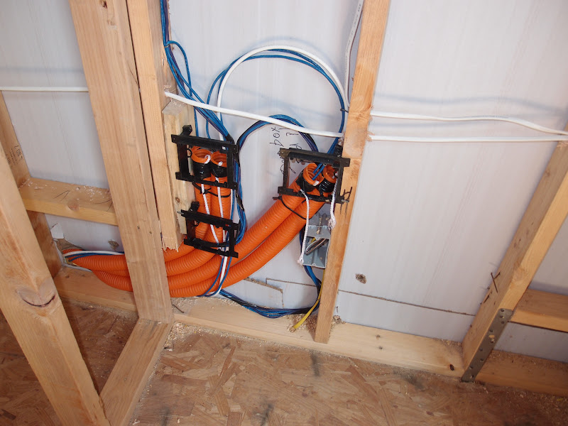

The house construction is on the way :
https://picasaweb.google.com/lh/phot...eat=directlink
I had my first call with Shawn from the Erskine Group and he made few recommendations that will most likely impact the equipment I initially selected, especially the projector. The recommendation is to downgrade to Triad Bronze for surrounds and put the savings towards a better projector like Runco LS-HB. This projector is more than twice as much as the Epson I was considering and the difference in cost for the speakers will not cover it. However, I started reading on the projectors and I am now inclined into spending more on the projector, maybe I can find a demo model with low hours.

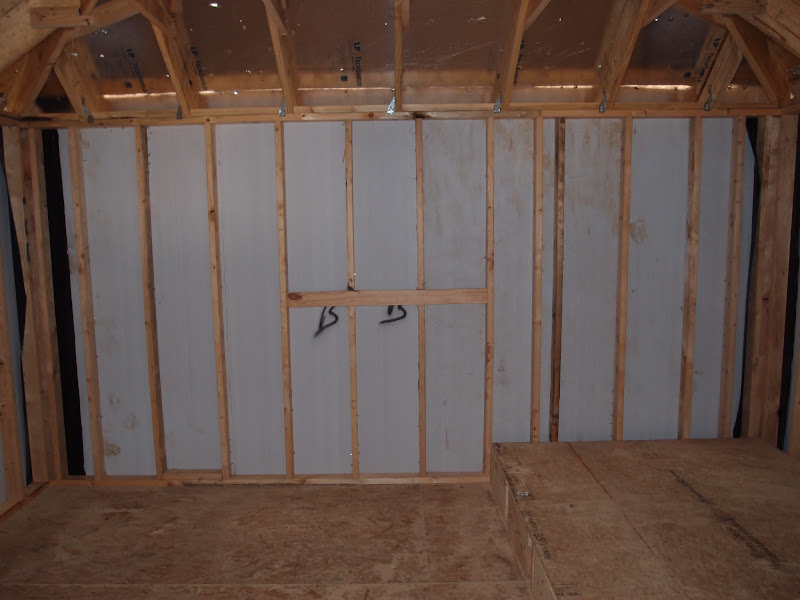

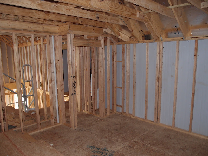

Some progress
Stairs to the media room and my better half that is making this possible:

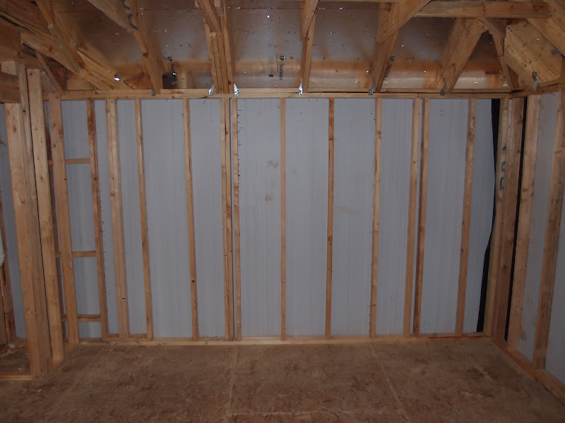

Here is what paying the professionals gets you:
BEFORE...
...and AFTER :
Looking forward to getting this project started. I do need ideas for placing the two wall sconces and two can lights we already provisioned with the builder, where should they go?

Media room is taking shape, they already build the raiser:
Game room next door, the closet on the left will house the rack:
sebis is offline

View to the back with riser, the holes in the riser are for filling it up with spray insulation:
Entrance to the room:
Front wall:
Right wall:
This is the custom window, $750 upgrade:
Before ... (in the model home):
...and after :
sebis is offline

The electrical and low voltage wiring is completed, they did get some things wrong, hope to get them fixed before drywall.
Home run for wires and conduit, I am going to ask to spread it a bit vertically, seems too cramped.
Another view of the closet in the adjacent Game room.
Back wall with conduit for projector HDMI.
Conduit run in the future sofit, I asked for extra outlets in sofit, the two on the right are switched going to a 3 gang box for future Grafik Eye.
They got the location of the sconces wrong along with many other things, like installing surveillance camera drops within reach and completely ignoring my written instructions in some cases. So far a mixed bag, I hope for better results once I meet again with the superintendent ...
sebis is offline
