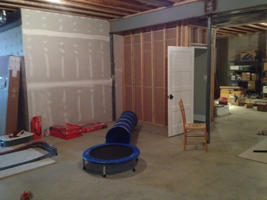

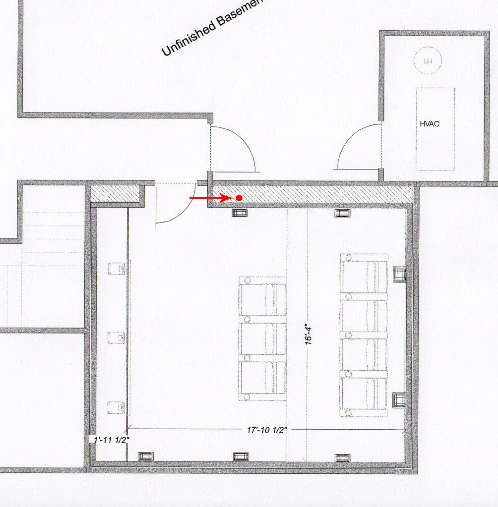

Soundproofing question
OK, I was standing in the unfinished theater space today trying to envision the construction process, and had a sudden fearful thought. If you look at the blueprint for the space below:
Notice that there is a metal I-beam with a metal pipe support which I am going work around.
In my rudimentary floorplan, the metal pipe stands in the dead space between the two proposed decoupled walls (red circle):
So my question is: will that metal pipe conduct sound into the theater, if it is inside that dead space? And if so, would it make sense to build the double stud wall on the "south side" of the pipe so that it is entirely outside of the two studs?
rs691919 is offline
Old 02-11-2012, 06:46 PM
aaustin's Avatar
Location: Upstate NY
Posts: 1,228
Liked: 35
If the support is between the walls I don't see how it would hurt sound isolation. Make sure no part of the walls come in contact with it to preserve decoupling. Also when you put insulation in make sure to not compress it against the support to avoid recoupling the wall through the fiberglass.

Old 02-12-2012, 09:41 AM - Thread Starter
rs691919's Avatar
Location: St. Louis
Posts: 457

How far apart are the two walls going to be to accommodate the post? Were you going to space them out around it or cut a curve in the top and bottom plate to fit it? Either way would be fine. The second option might give you a little more space.
Actually, the two stud walls are going to be about 2 feet apart. The reason for this is that I'm going to extend the already finished wall into the unfinished basement, and then enclose the HVAC unit and water heater so my son can't get to them. I figured that the bigger the air cavity, the better the sound attenuation.
Don't know if you've already talked to someone about this but that 2 foot space is a concern.
If the walls are that far apart then you will need to treat that 2 foot space like a seperate room. That distance isn't really room within a room but more like another room. Sound will shoot through your first wall and head right up through the floor between the walls. The walls should not be very far apart. 1 maybe 2 inches at most.
Hmmm...ok, thanks for the warning. I will look into that. Gonna be working with bpape on the design, so I will run it by him. The pipe and I-beam are problems then -- the beam is about five inches wide off the top of my head. I will measure the exact distance later. I have plenty of width in the theater I think, so if I have to make it narrower, I don't think it would be a big problem.
