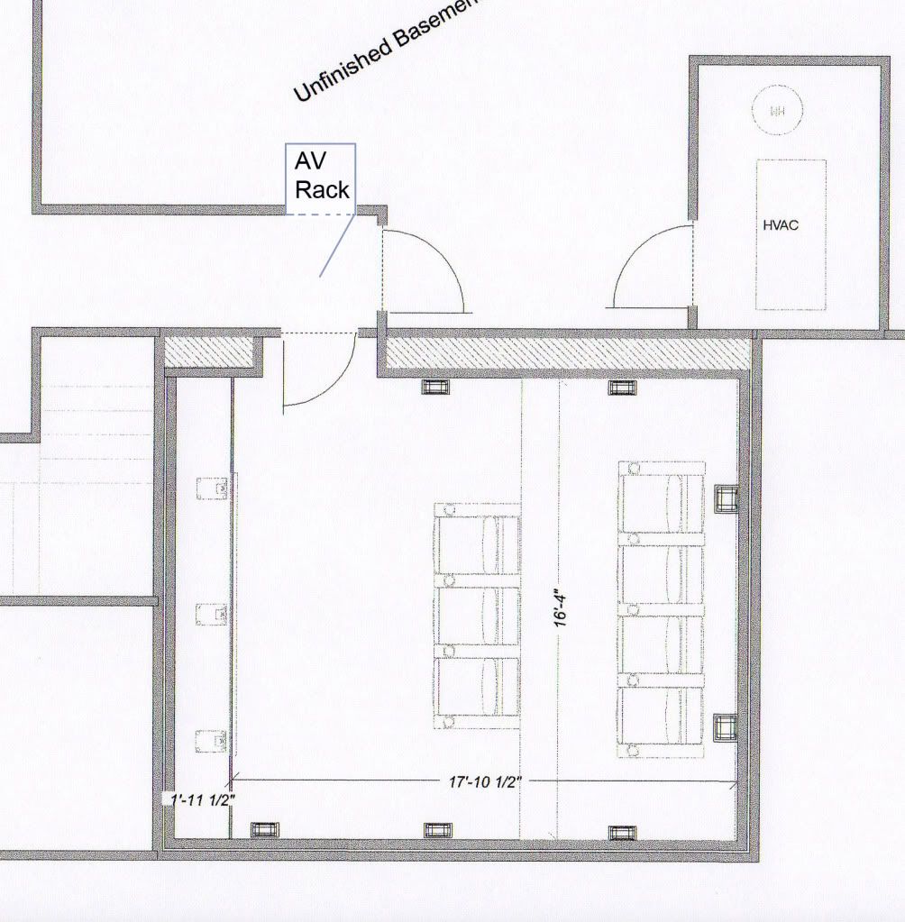

I spoke with bpape this week, and he seemed to think that the "dead space" was not a problem as long as there was not drywall on the inside of the cavity. But, it brought up a question in my mind regarding the decoupling of the dead space.
The reason I have the niche for the doorway is because the interior wall of theater has to be south of the metal pipe and i-beam; also, because I want the theater to be symmetrical -- thus bring the walls in to create the dead space. However, I was wondering if those walls are truly decoupled because they are connected by the north-south running studs (red arrows in above picture).
If they are not truly decoupled, how would I fix that?

Trying to figure out how to run the HVAC supply. There are two ducts coming off the main trunk just to the north of the theater. My thought is to run both of these above the decoupled ceiling between the joists and then down to a soffit muffler on the south wall. Is it ok to cross the two flex ducts (green and blue) within the soffit so that the runs have enough length to deaden the sound transmission?

Rack will be opposite the entrance door, with the back open to the unfinished basement. That way, I can vent into the unfinished area and have it enclosed so my son can't get at the backs of the components.
Will the open back cabinet affect your soundproofing?

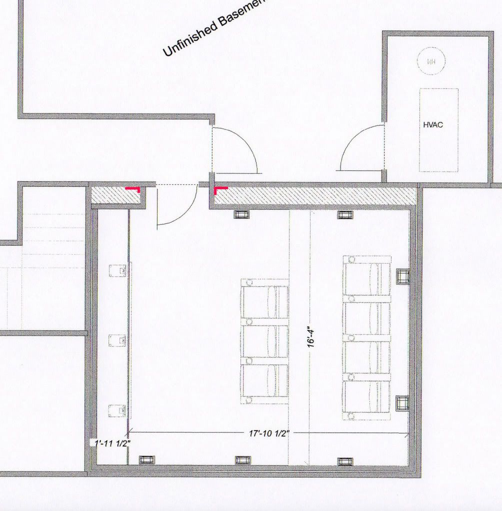

rs691919, the door recess design is definitely going to couple the room to the rest of the basement. Why not continue the interior walls so that you create a another door opening parallel to the one shown as part of the theater framing (essentially two back to back frames 1/2" - 1" apart). Fit the door on the theater side and fit an empty frame where you show a door now. Done right you will have a small gap between the door frames which can by trimmed out with a thin trim strip fixed to only one side. If you ignore the door alcove this is exactly what I did.
Moggie, I assume you mean like this:
New walls drawn in grey. My only issue with this is the loss of symmetry when looking at the screen wall from the seating area. I assume that if I were to frame up the area outlined in red to maintain symmetry, then I would be getting into the dreaded "triple-leaf effect". Any suggestions on what do with that corner?

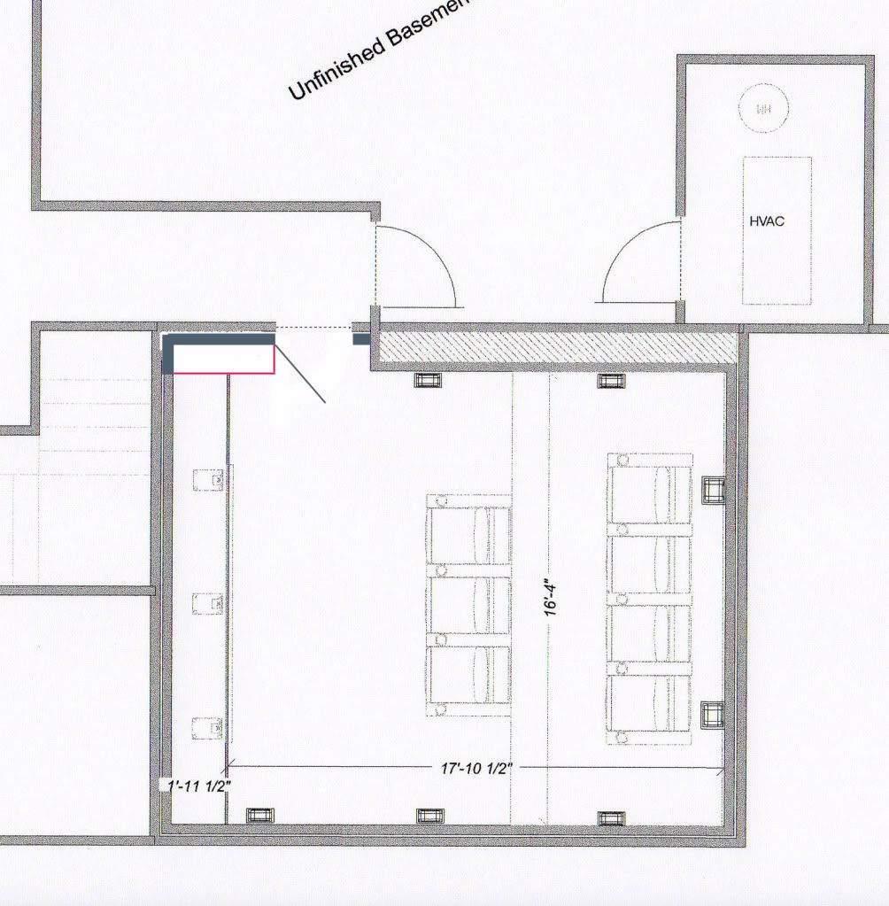

I was thinking of using some of that wall depth and recess the door area, but still do a dual wall. Decouple the end where the two walls, with acoustical sealant to seal the gap. Frame the door as two frames and do the filler strip attached to one frame.
Then I wondered if the entry was played up, the acoustical caulk could be in the corners and covered with some trim detail nailed to one wall. Then I was curious if flipping the room end for end was possible due to the height of the basement.

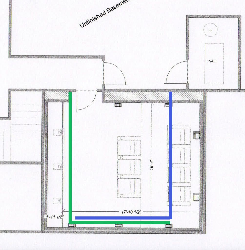

Tedd has some interesting ideas, but this illustrates what I was thinking:
Frame following the green line. Make sure you are not coupling the framing at the red circles -- looks like you are in your drawing. Eliminate the wall with red X's.
anyways, a whole bunch of ideas...
I do like this idea, and played around with having the screen on the righthand end for a while! But I think getting it passed through the Committee for Domestic Affairs (if you know who I mean) might be difficult. Thanks though, that really is a cool idea!
Well that makes a helluva lot more sense. I need to start wearing around a necklace that says "WWMD". If I don't go with Tedd's excellent concept, then this will definitely take care of the issue. Thanks!!!!

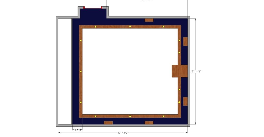

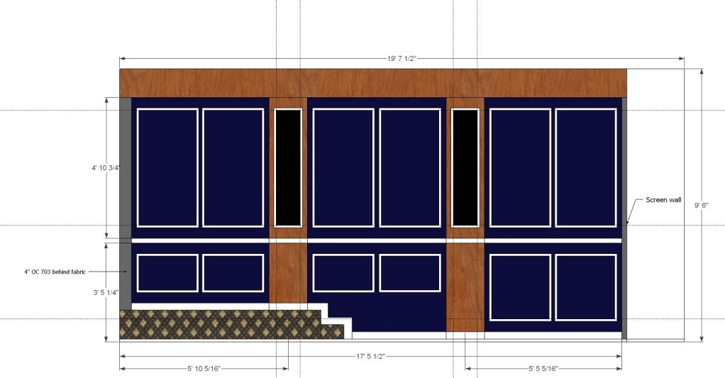

Also have done some work on figuring out the style of the theater. With apologies to Mario, I'm going to borrow heavily from the Cinemar build. However, I would like to use two inch thick acoustic panels in between the columns instead of column-to-column GOM covering. The panels will be framed and mounted above chair rail. As of now, they will be a deep navy blue to match the navy blue drywall, with the moulding and chair rail providing the contrast. Bryan's plan calls for 2' x 4' panels, but I am worried that might look too busy. I have mocked up the side wall for both 2' x 4' and 4' x 4' panels:
Any opinions as to which is aesthetically better? Also, any thoughts as to the navy-on-navy look of the panels? Should I build the columns as stained wood veneer -- other option would be to paint them navy as well. Keep in mind that the recliners will be a beachwood brown color

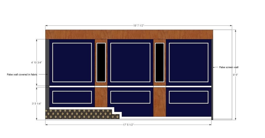

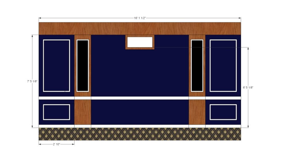

Also mocked up the rear wall, which will be OC703 covered in fabric to match the dry wall at the sides:
The two panels at the sides would not be real panels, but rather just moulding to mirror the framed panels on the side panels. Is there a good way to mount the mouldings on top of the fabric, or would I have to work the fabric in around the trim pieces?

Can you use the dead space in the wall to run your ductwork vertically? You could enter at the top, 90 down to the floor, then 90 over and 90 back up to ceiling height, and then 90 into the room. As long as you have that space well insulated, and possibly use DD+GG to build an isolated enclosure for the ductwork if you want go crazy with it.
The Plains Theater Has Begun
J_P_A is offline
post #87 of 207 Old 04-16-2012, 05:29 PM - Thread Starter
rs691919's Avatar
Location: St. Louis
Posts: 457
I hadn't thought of that, but it would fairly easy to do I think. I'm assuming you mean the supply, not the return.

I like the bottom panel layout better.
Looks like it's coming together nice.
so what r u doing for subs?
the other column that is by itself is there going to be one on the other side? or don't u have the room.
what's going on with ur rears? they going in the columns or up in the soffit/ceiling? or does bryan think u have enough room?
looks nice.
i'm still in framing mode for the rest of the basement. the theatre is sitting for now.
jim
jimim is offline
post #89 of 207 Old 04-16-2012, 06:00 PM - Thread Starter
rs691919's Avatar
Location: St. Louis
Posts: 457
looks nice.
jim
Thanks jim! I think I like the bottom one with 4' x 4' panels better too. I can't wait to start framing!
1) Undecided on subs. Possibly getting the Klipsch THX Ultra 2 subs from AVS store (Mike Garrett has been very helpful!) to match the KL 650s and KS-7800s. Had also thought about getting a single Seaton Submersive HP. Any thoughts?
2) Yeah, not enough room to have another column on the door-wall and still fit the acoustic treatments in, so that column will be by itself.
3) Rear speakers will go in the columns
rs691919 is offline
