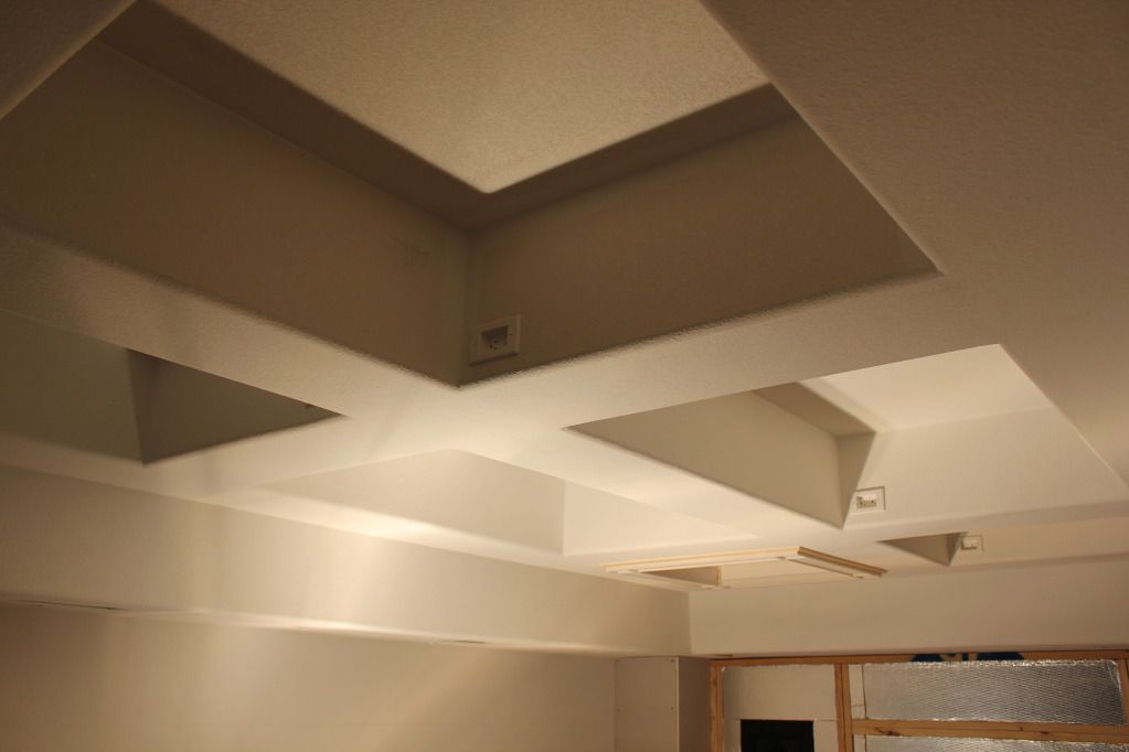

Originally Posted by chinadog View Post
Jeff -
Great build and great theater. I think you did a great job detailing out the how and the whys of what you did.

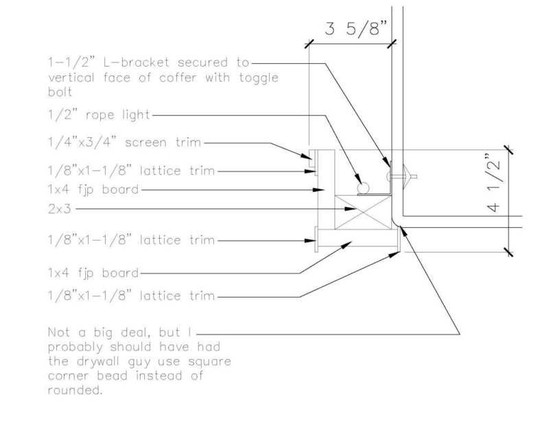

I'm build 2.0 myself. I've decided to go with a coffered ceiling this time around and after doing some googling, I discovered your thread.
Thanks - I'm not sure what search terms you used that got you here, but wow, that's cool!
The one question I have is around how you (contractor) ran your rope lighting in particular. Did you guys run 8 separate individual sections of rope light - each plugging into 8 outlets that were strung together? Or did you have two switches (I know you did a GE) each with four outlets on one switch and plug a section into each outlet? I'm racking my brain on how to run rope light in the coffers.
Bud
Yeah, electrical - that would be me...
There are eight individual sections of rope light. So in the attic I placed two junction boxes to hold all the runs - a single feed comes from the GrafikEye to one box, then the other, with the eight tray feeds split between the two. Following the style used by the builder's electricians for rope lights throughout the rest of the house, the romex pokes through the drywall, and gets hard wired to the rope section. The splice is capped and hidden by the tray. I remember seeing the romex hanging during the house construction, so a quick look with a ladder showed me exactly how they had done it...

I have a recessed duplex outlet in each of the 6 coffers and plan on 6 separate pieces of rope light (or maybe LED).
Spaceman is offline
post #172 of 355 Old 07-05-2012, 07:33 PM
chinadog's Avatar
Location: Knoxville, TN
Posts: 5,558
Liked: 35
Spaceman -
Thanks. Exactly what I was thinking - six recessed boxes per switch, each box hidden with crown. Definitely look at LED rope light, 1000bulbs.com has rolls of 150 feet for about 200.00, but not in all colors. Much less head in the room with LED rope lights.
Bud
chinadog is offline

Spaceman, I know you've got one tray assembled - with the large-ish trim profile you used, are you able to see the outlet from the ground?
Chinadog - Regardless, paint the outlet the same color as the ceiling and no one will notice it anyway...
Jeff
jautor is offline
post #174 of 355 Old 07-05-2012, 08:30 PM
chinadog's Avatar
Posts: 5,558
Liked: 35
I think I'll be doing a wood coffered ceiling and staining it - regardless, I should be able to paint the outlets to something other than white. smile.gif The crown should hide it and I'll definitely put the recessed boxes in the side (and sideways) towards the back of the room so no one will see them.
Bud
Jeff
If I walk all the way to the front of the room (at the foot of the stage), I can make out the top 1/2" of the 2 receptacles in the far back of the room. The remaining 4 receptacles remain hidden from view. I'm 6'-5" and my wife is 5'-11" and she could just make them out. A fix is in order if for no other reason than to satisfy my OCD. I'm planning on adding a thin piece of flat trim to the top of each tray for some extra height.
Here is the detail for the tray, without the extra cap piece. The receptacle is not shown, but the bottom of the receptacle box would be 2" above the bottom of the coffer.
Legal Disclaimer: Detail is shown to convey size and proportions of trim pieces only. Any attempt to borrow the half-assed method of attachment is done at your own risk.
Spaceman is offline

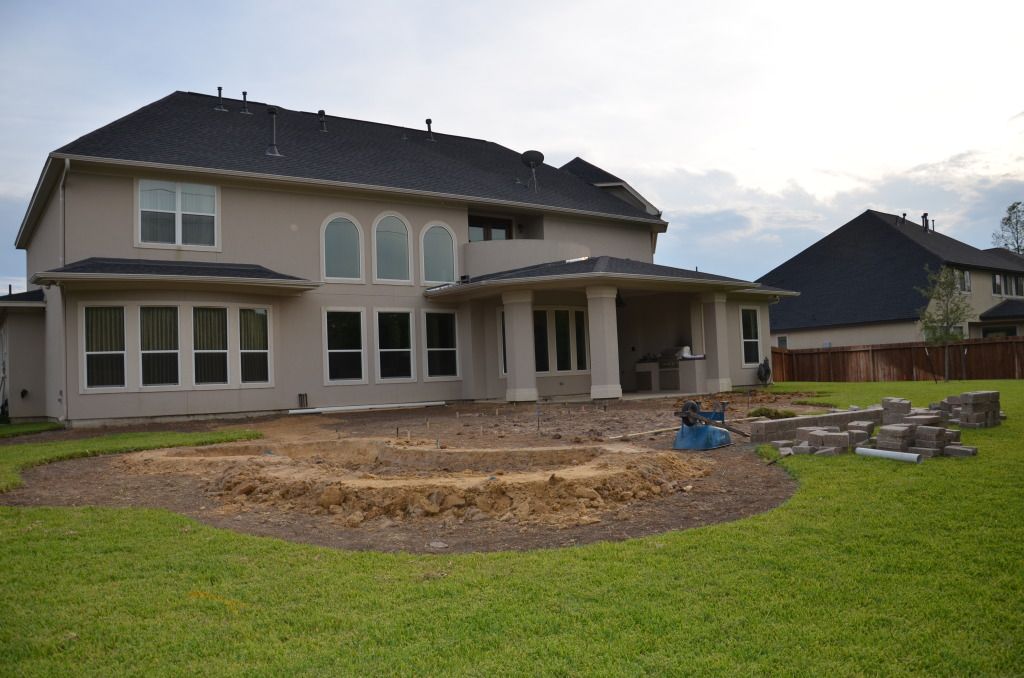

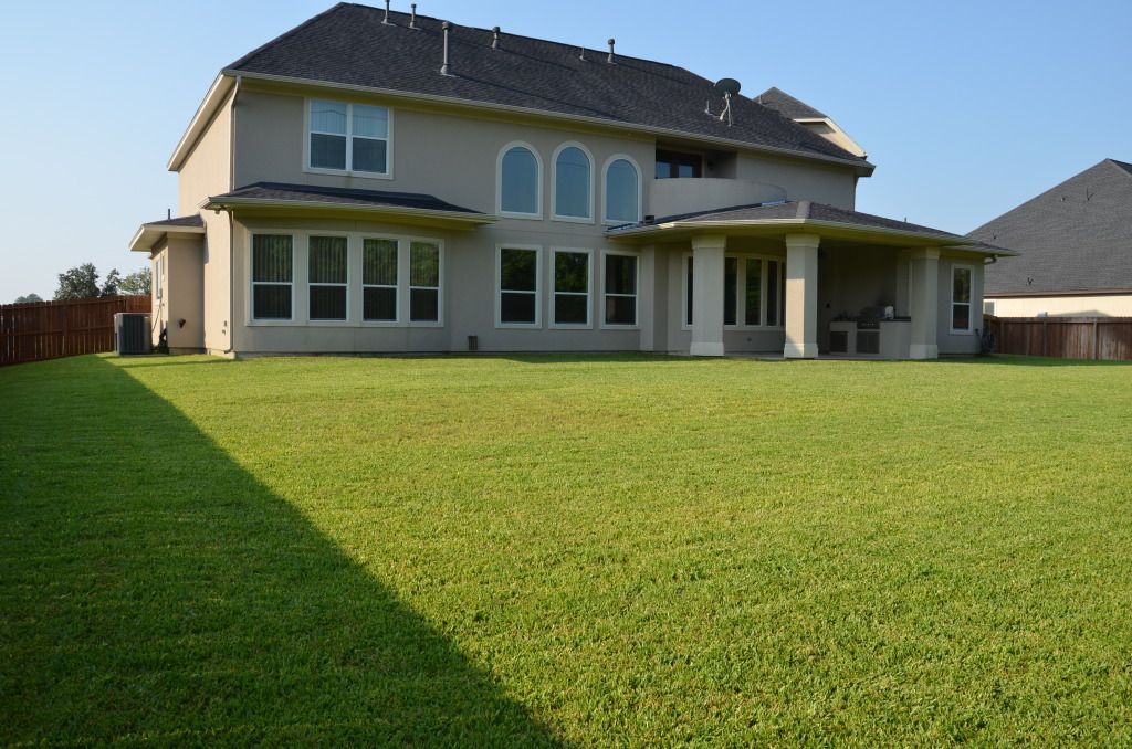

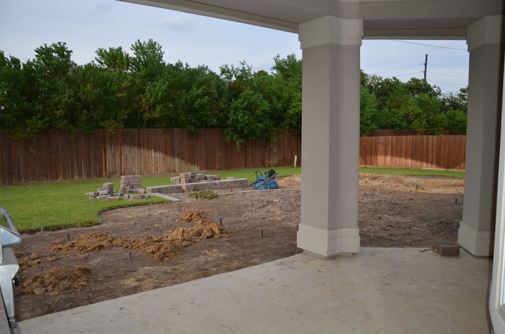

Thanks to Spaceman for the idea to add some "build" to this thread... cool.gif Not really theater-related, but I did add another speaker zone to cover the area.
Last week construction started in my back yard for a patio and pond / water garden. Since I built the house 3.5 years ago, the back yard has been, well, on the back burner until higher priority projects (aka The Theater) were done. I had an empty lot next door (held in reserve by the developer for future potential), which was finally sold and currently under development. When that happend this spring, I decided to press ahead with plans for the back yard - under the assumption that I'd want to take advantage of the construction next door to provide a path for earth moving equipment.
Here's the "before" pictures, from the covered patio and looking back from the yard:
Working with the landscape design company that had done all the work on the front of the house (local folks: Carnahan's Landscaping), their architect came up with this plan:
The render is pretty close, although there's no mountains in Houston, the dog and 2.5 kids are not part of this plan, and the 'bridge' over the stream will be a simple stone path, not a Mini-Golf water hazard. Construction started last week. At the end of Day 1, they had marked out the area, and removed the sod, giving me a good look at the final scale of the project...
I'll post some more images later - we're on Day 6 of about a 15-day build.
Jeff

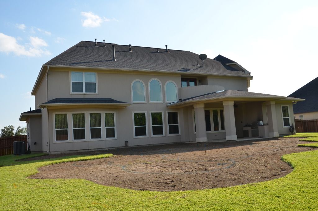

Day 2: Excavation of the pond starts, site surveyed for the patio. We found there was more slope in the yard than expected (flat!), so the design changed to incorporate one step down, dividing the patio into two tiers.
Jeff
