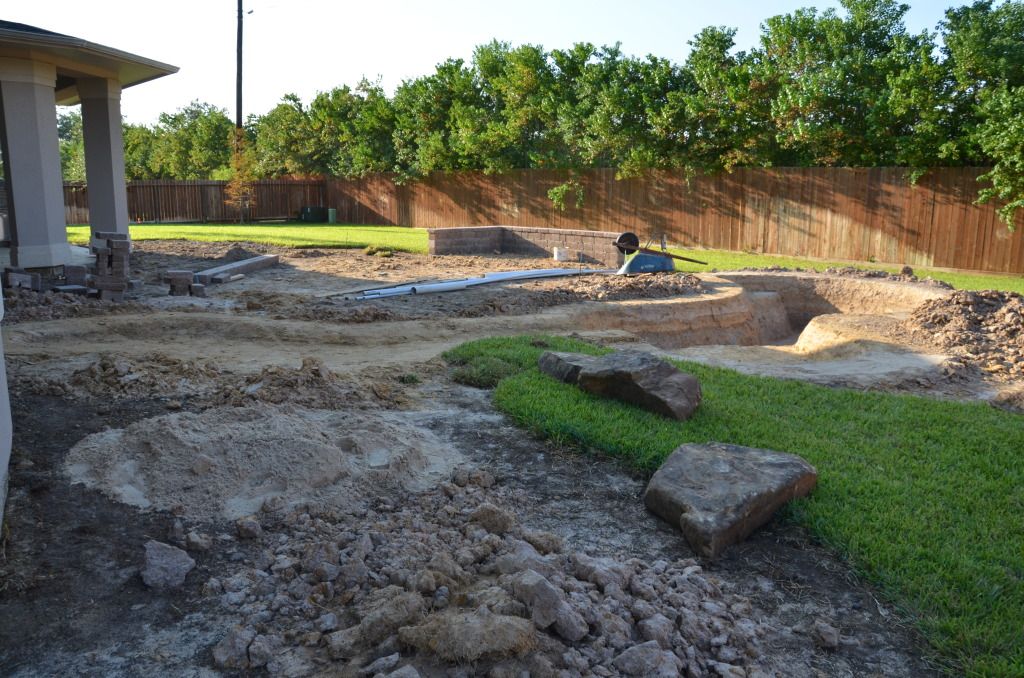

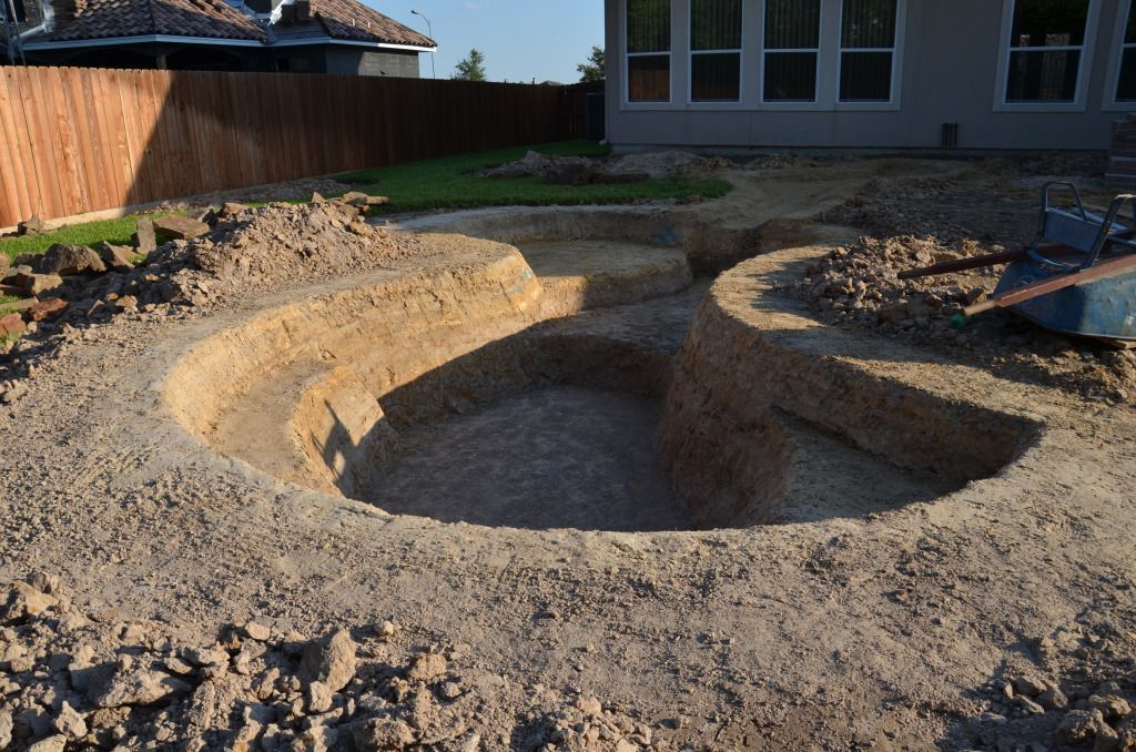

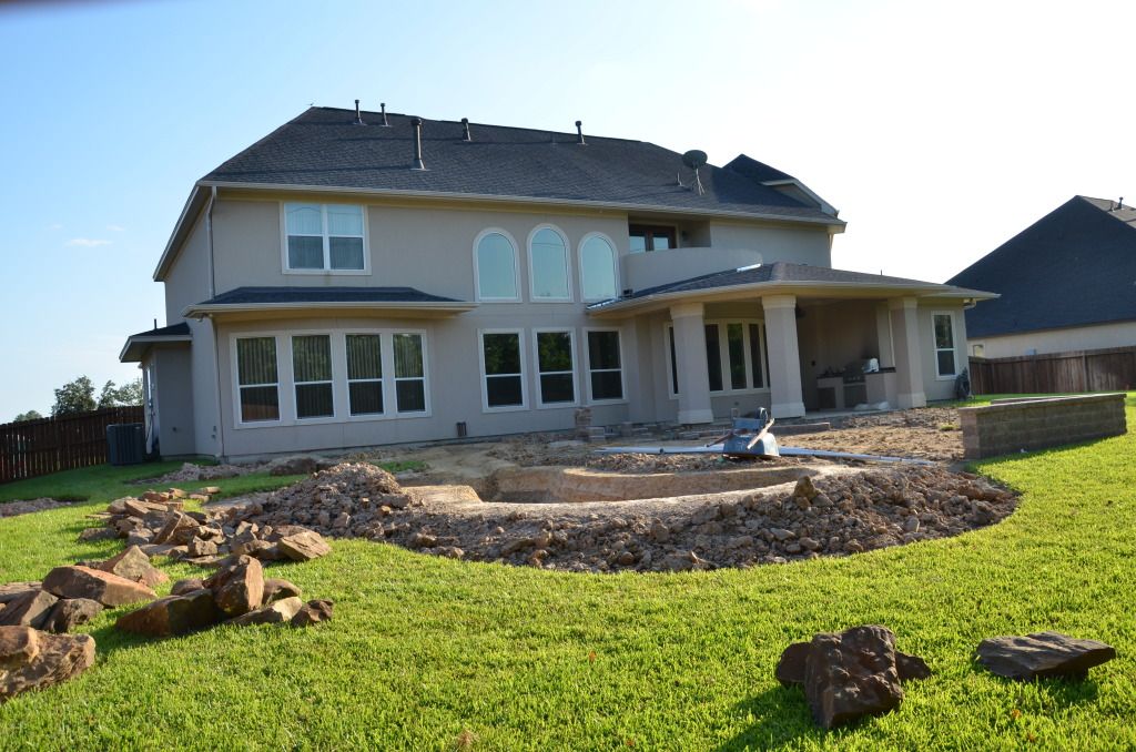

Day 3-5: Pond completely excavated - we had some rain that halted work over the weekend. Seating wall constructed, pavers delivered.
And yes, it's a pretty big pond. 3.5' deep at this end. Need the depth to allow the fish to get out of reach of the predatory birds that I see around the area... Exhibit A as to why this wasn't a DIY job!
First load of boulders dumped around for later placement. (ahem, Exhibit B):
And, yes, Exhibit C. Defense rests...
(next post will catch us up to real time)

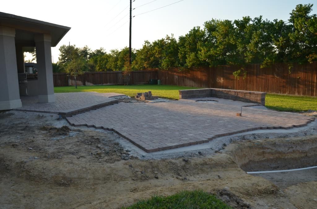

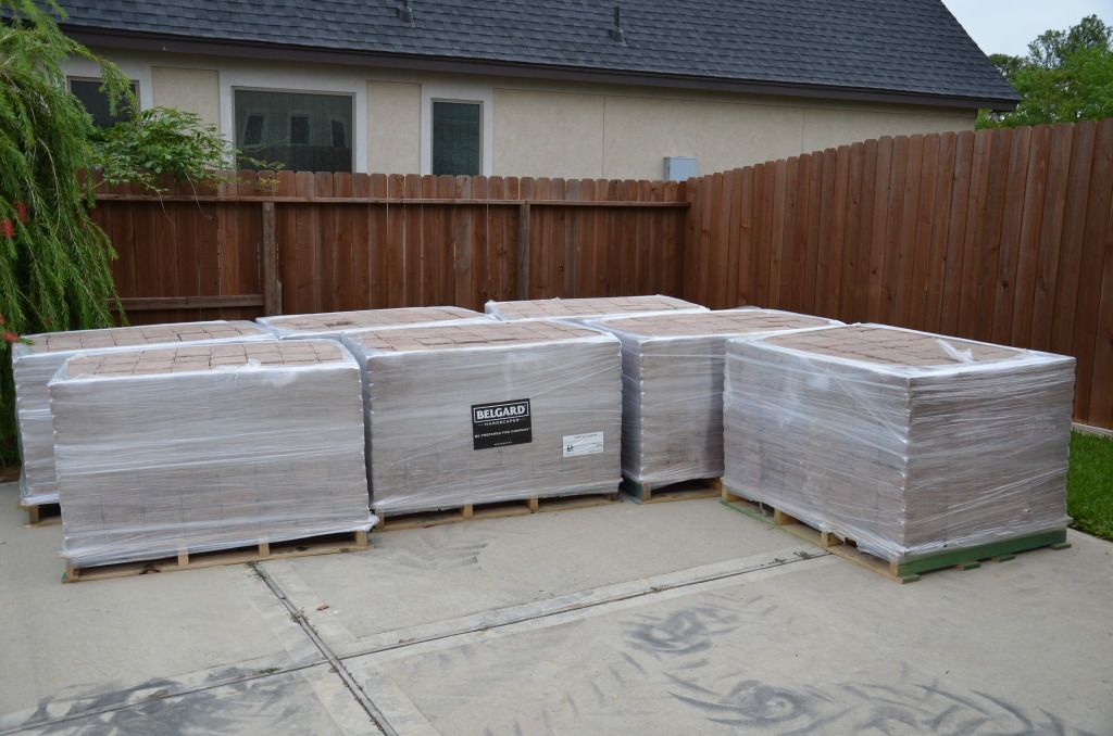

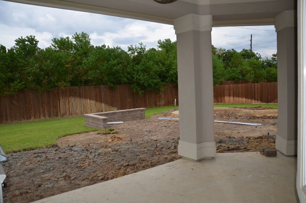

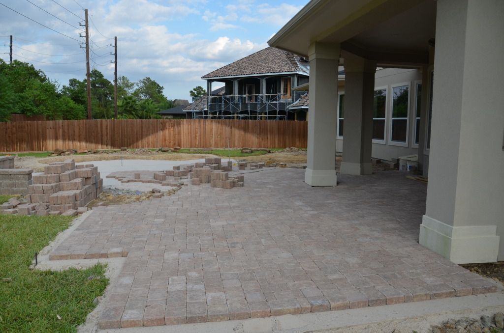

Day 6-7: Base for the concrete pavers put down, graded, and first 2 pallets done. Pond liner is being ordered (couldn't find one wide enough locally - I was surprised by that), and luckily the weather will hold out until it arrives - I'm guessing early next week.

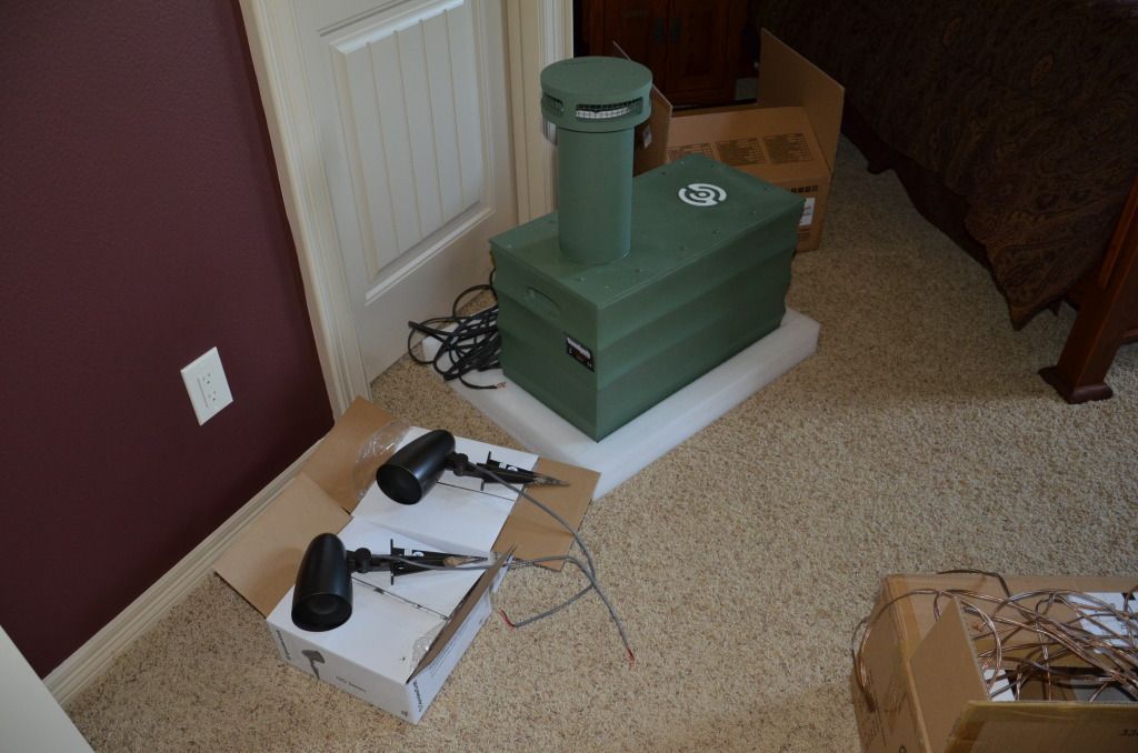

Oh, here, back on topic! The A/V gear for the patio. 4 SpeakerCraft OG 3's, a SpeakerCraft BoomTomb buried subwoofer, hooked up to Dayton/AudioSource amps and fed by the NuVo zone already in place for the covered patio:
And I'm still debating whether I'll attempt to fish new wires to the outdoor kitchen for a TV there... This outdoor location was *NOT* one I planned for a display. The garage, yes, back yard, no. Silly me.
(there, now we're all caught up to real time)

It's amazing what the pros can get done in a short amount of time. I'd probably spend a month digging! eek.gif
It looks like you will have a great outdoor space. I'm interested to hear your opinion on the BoomTomb. I've never seen one of those before.

Thanks! Yeah, I would have had to use equipment or hired a crew anyway to get it done in any reasonable amount of time. I covered up the pond hole over the weekend when we got an inch or more of rain to prevent it from becoming a mud hole.
I tested the BoomTomb sitting on the ground - it's definitely a huge improvement to the small satellite speakers. First impression is that at reasonable listening levels it's very good. At higher levels and with very bass-heavy beats it's "sloppy". But I'll reserve judgement until it's in the ground. I am using a Dayton 230W subwoofer amp in lieu of the SpeakerCraft model, which had an MSRP of $999 eek.gif... But the BoomTomb, compared to other brands of buried subs I saw at CEDIA, at an MSRP of $549 (I think) is certainly a good value.
I wasn't going to use any of the "rock" speakers for the simple fact that their colors are *never* anything close to the kinds of stone we use in this part of Texas.

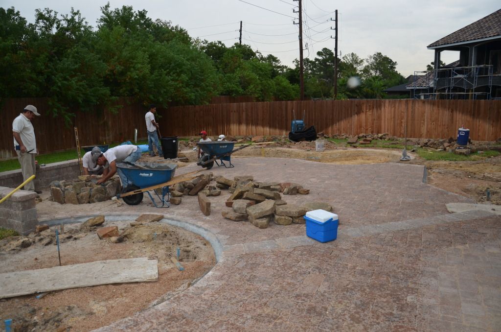

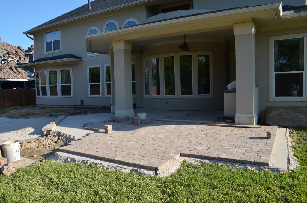

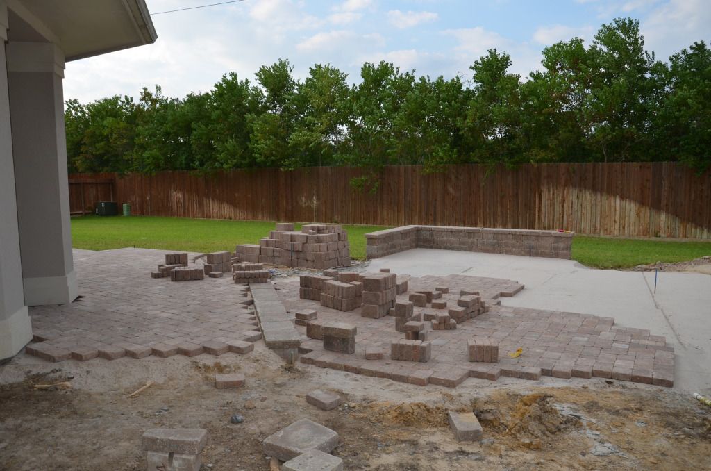

Day 8: Lots of paving progress, anticipating the field being completed tomorrow. We'll see how long and how many saws will be involved in the brick-cutting...

That's coming together. What's the ETA on the 1st fish?
Looks like they went right over the existing covered patio with the new pavers. I was hoping they were going to do that. Do you happen to know the installation method they used over the existing concrete? Did everything work out ok at your patio door (no funny transition)? Looks like they are leaving a small gap between your existing stucco columns and the pavers. That's good. You don't want them touching. In the areas where the pavers are actually higher than the bottom of the adjacent stucco, you'll want to be sure to clean that gap out periodically. You don't want dirt and water collecting in there.
Does the plan include some tall trees & shrubs on the right side of your yard between the pond and the fence? Your new neighbors have a great view of your yard from their balcony.
ETA for completion was end of next week. That may get delayed a bit depending on when the pond liner shows up. I'll probably give it a week to get some plants into the pond and stabilize the water before adding a few fish. See how they go, and a week later dump a bunch in. I'm not doing Koi, although I had them in my old pond. They were cool, but more work than I expected and they're just not water lily compatible. I had one that routinely dug up plants and made a mud soup out of the whole pond. And then they jump out or get chased out by raccoons... At this house, I'm more concerned about predatory birds having a feast.

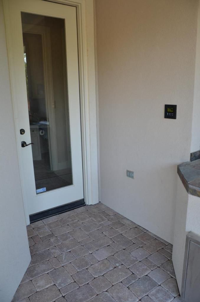

Yep. Sand base prep on top of the concrete to get some slope, but otherwise nothing else.
They haven't started cutting the edge pieces into place yet, but there's plenty of height at the door threshold, so it'll be fine. The builder expected the patio would be covered eventually, so the (final) height is fine. Where the pavers will be higher than the stucco, should they just stuff the area underneath with the sand fill to keep dirt/water out? The columns are all under cover and don't get rained on, though...
Yeah, a good sized live oak being positioned right in the line of sight to block that direct view. The good news is my balcony has a good view back at them, so two can play at that game. But I don't have a 6 or 7-year old to peek back!
Although it's only wishful thinking that anyone would see something "interesting" going on in my back yard... biggrin.gif
Ideally, you would want the pavers to slide under the stucco and the weep screed to be raised if needed to maintain at least a 2" gap. That's a lot of work however, so I would recommend they just leave a wide enough gap where it's easy for you to come along with a leaf blower and keep the gap cleaned out. You definitely don't want sand piled up to the bottom of the weep screed or against the side of the stucco. An air gap, while not as visually appealing as a sand joint, is what I would recommend. Let me know if they have some other creative way to handle it.

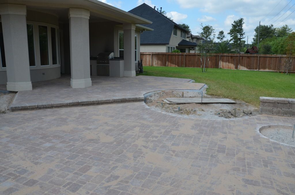

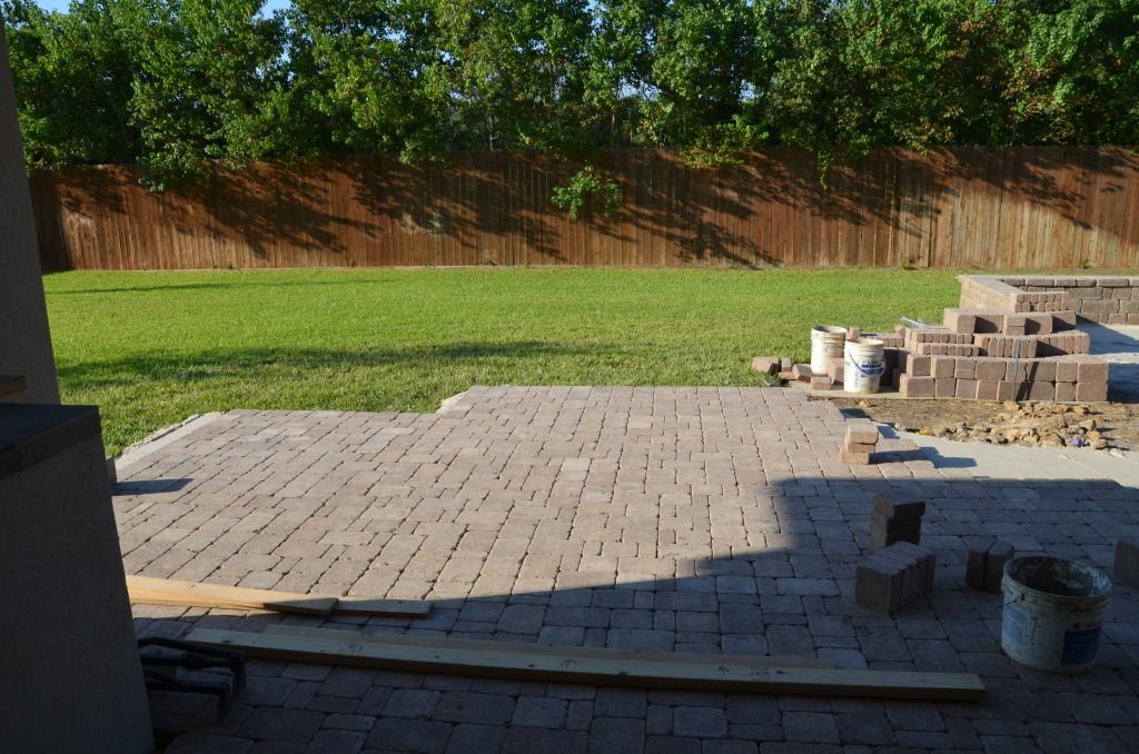

Day 9: Paver field done, about halfway though the edge cutting work - expect that to be done on Monday. I took some measurements today and calculated the pond volume right at 3000 gallons...
Spaceman - patio height at the back door came out just right!

Very Nice. That's quite the entertaining space. Perfect for hanging out before poker and a movie.

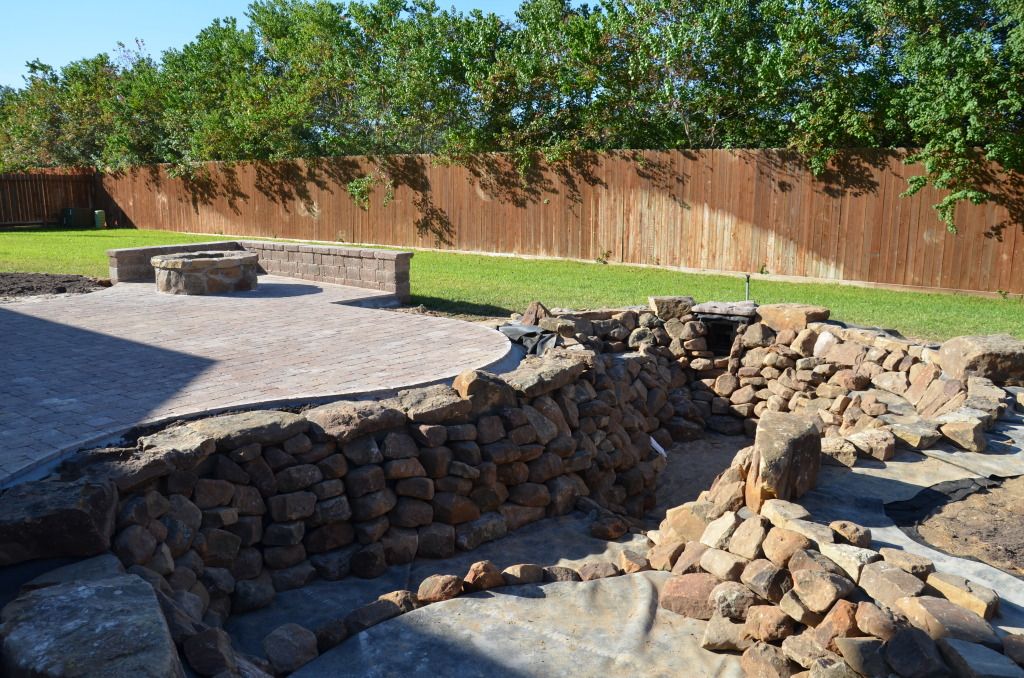

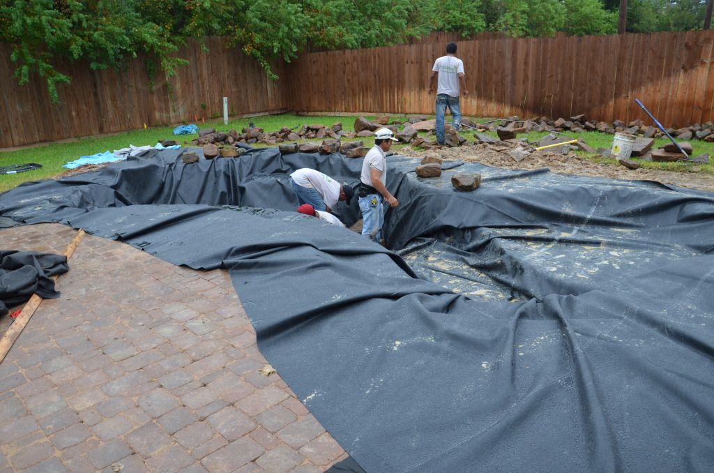

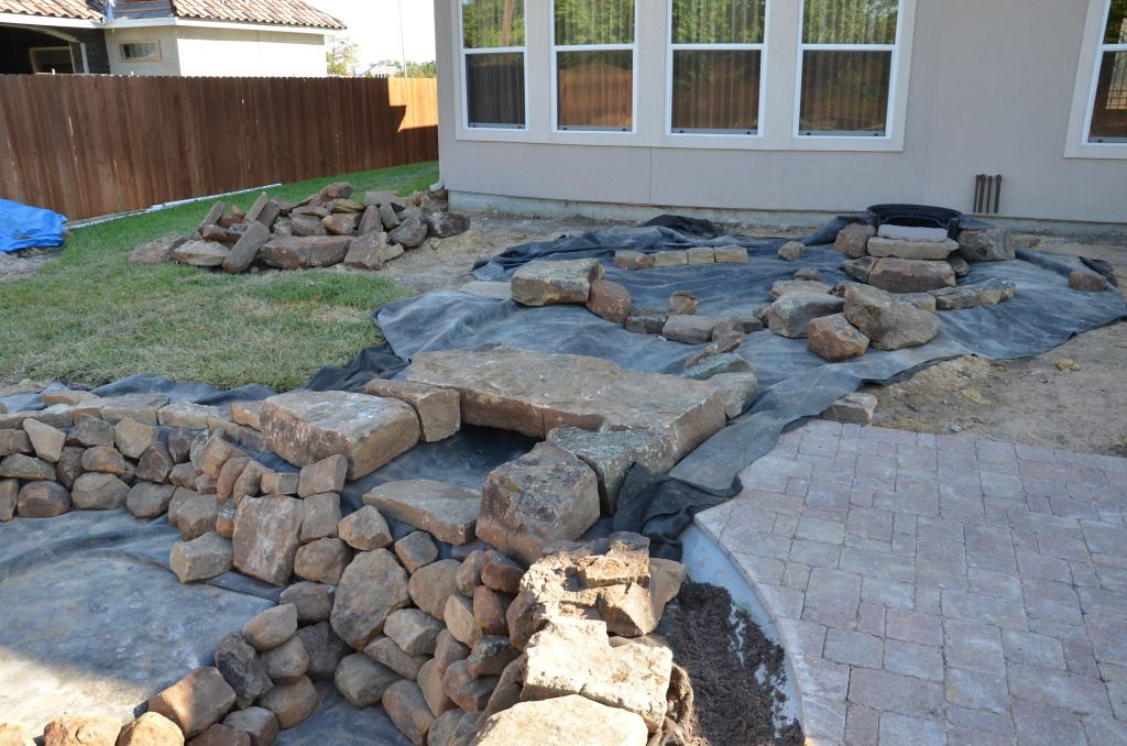

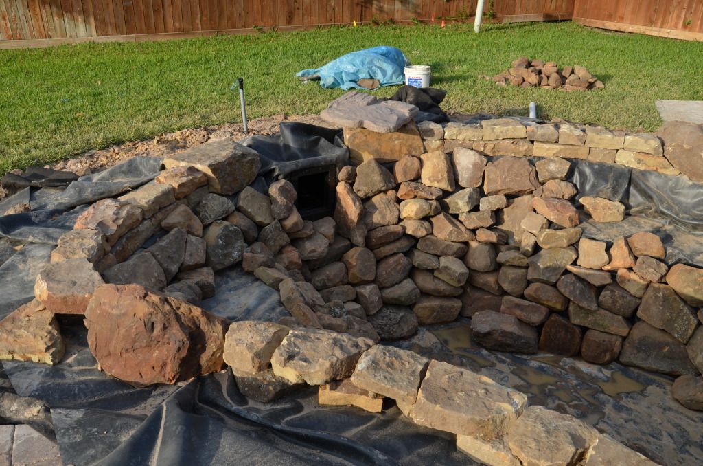

Day 15: After a few days delay waiting for the pond liner to arrive, a flurry of activity today, well, until the rain came. We had some rain this weekend, so I had protected the pond hole with a plastic tarp. First job was to pump out that water. Two crews here today, one to build the fire pit and the other for pond construction.

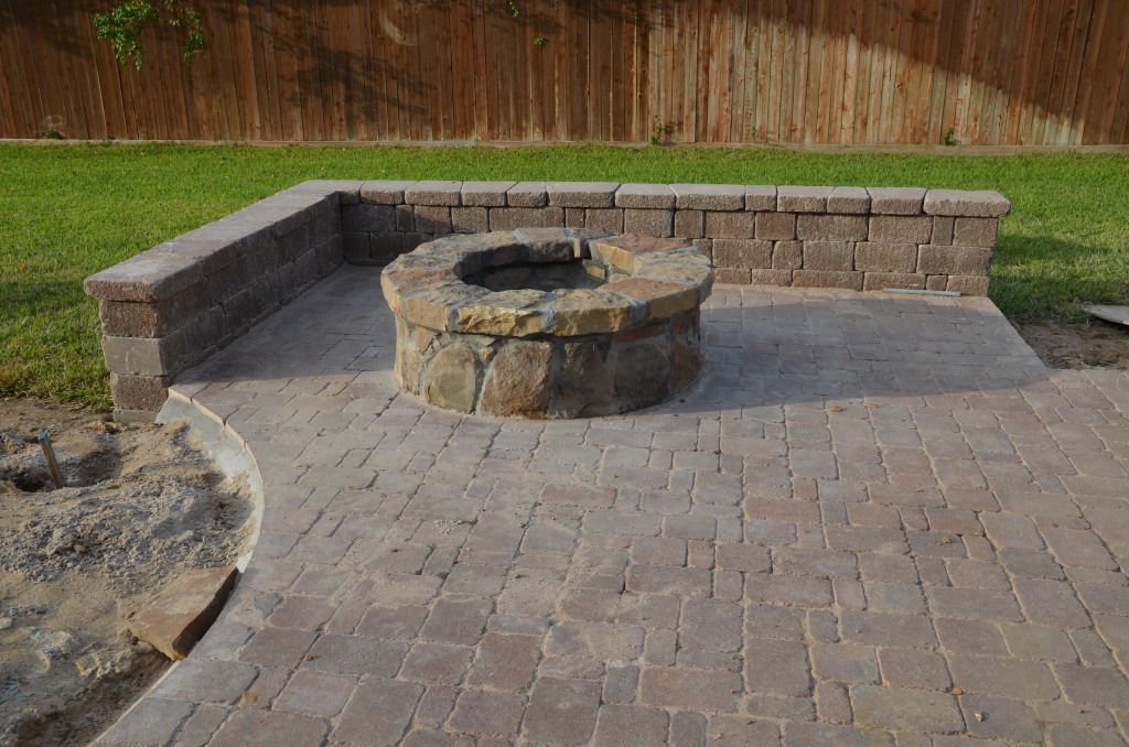

Fire pit:
Pond liner and underlayment down, just in time for the rain to start (that wasn't forecast!):
And by 3pm the rain had put a stop to work for the day. The liner is one continuous piece covering both the pond and the entire stream. So no seams or dissimilar materials to worry about.
They'll be back in force tomorrow to do a lot more rock arranging. Expect that to take at least 3 more days, with hopefully soil brought in to form the planting beds to finish out the week. Definitely starting to look like something, and really glad to have the hold covered - now filling with FREE water!
It makes me laugh at the little one that I was going to buy at Home Depot when I had plans for a pond.
The whole project is looking great. I especially like the rock fire pit.

Originally Posted by aaustin View Post
That pond liner is HUGE! :eek:It makes me laugh at the little one that I was going to buy at Home Depot when I had plans for a pond.
20' by 50'. Entire setup in one piece without a seam. The correct answer!
And this is my 3rd pond, so I didn't just come to this without experience... In many ways, a larger pond is easier to care for, as it better mimics nature.
Thanks! Fire pit is now done (Day 17):
It has just enough Fred Flintstone in it to fit in!

Day 17-18:
Weather stopped cooperating and so we lost another day to rain and the drying out of the site. Fire pit is now done, and the sides of the pond have been covered in stacked stones. Not how I would have done it (those rocks will barely be visible below the waterline, but certainly not going to undo it. Here's a shot of the 'end' of the pond, where the skimmer has been installed and buried electric installed to service the pumps.
I happened to be at my desk at work with the webcam running when I saw the crew arrive in force with a stone slab for the bridge on a dolly. Took six guys to manhandle it into place, probably ~500 pounds. Crew chief found a great stone for the job - naturally squared sides and just the right size to span the stream. You can also see the stream taking shape with the biofilter / waterfall weir in the background.
I did have an issue with the way they were constructing the stone edging around the pond, which will be visible above the water line. They had chipped the stones to fit tightly, which gives the pond a 'formal' and unnatural look - not what I wanted. Owner of the company was with me, and had no issue having them pull those stones back off. They had enough rock in the right shapes and sizes to re-do the front edge, and they'll be shopping Monday for enough pieces to do the rest. Compare the corrected 'front' edge here with the 'back' edge in the skimmer photo above.
So tomorrow may be a big day - once the edging is finished, they'll construct the bog garden area, finish the stream, and then it's time for water and the pump to bring this sucker to life!
I picked up a dozen LED light fixtures for the project yesterday, and today harvested a bunch of bog plants from a friends' pond. If all goes as expected, it could all be finished this week.
(and then we'll return to the regular theater thread... biggrin.gif)
