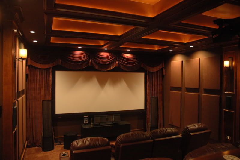

After months of promising that I'd start a build thread, here, I've finally done it. This is a retrospective, the theater is complete, and no, I'm not going to change anything. I mean it, it's finished! So I'll try to point out the things I learned along the way, mistakes I made and stuff I would do differently if I did it again. There are plenty of threads here (I know, I read them!) that go into great detail about construction details, acoustic considerations, screen size, etc.- so I'm going to focus more on the functional decisions and planning. Overall, none of the mistakes I made were critical, the design changed quite a bit from my original thinking, but I'm very pleased with the final results.
So the specs in case you don't want to read any further:
  • Room: 16'x22'x10', double 5/8" drywall with Green Glue, raised coffered ceiling with rope lights
  • Screen: Carada BW 136" 2.35:1 Masquerade screen and motorized masking system
  • Projector: JVC RS50, Panamorph U480 anamorphic lens w/motorized sled
  • Speakers: Martin Logan Vantage (L/R), Stage (C), Depth/i (Sub), Definitive Tech (2) BPZ/A, (4) BP/A (surround)
  • Subwoofer: (2) SVS PB-2000
  • Electronics: Integra DHC40.2, Emotiva UPA-7, Oppo BDP93, Xbox 360, Aton HDR44 providing DirecTV remotely
  • Rack: Middle Atlantic AXS-20 32U
  • Power: (2) 20A dedicated circuits, Panamax M5400 line conditioner, Middle Atlantic PDLT-815RVA light/power bar
  • Lighting: Lutron Grafik Eye QS 6-zone, seeTouch control pads, remote IR interface
  • Control: iDevices, Global Cache GC100, iTach, iRule app
  • Seating: (8) United Leather USA 'Penthouse' in 'Clove' leather Berkline 45094 'Hollywood', (4) Pier 1 Mason Club chairs
  • Furniture: Ikea 'Stockholm' console table, site-built 12'x12" bar table, BD storage area with glass shelves
  • Acoustic Treatments: Acoustical Solutions SoundSuede 'Cordovan' 1" wall panels, 4"x5' corner Bass Traps
  • Paint: Benjamin Moore 'Hasbrouck Brown' (Walls), Modern Masters Antique Copper (Ceiling trays), Sherwin-Williams 'Golden Maple' (stain)
  • Carpet: Shaw Tuftex 'Park Place' (style ZA972) in color 'Pecan Pie' (03776)
And the "after" photos...

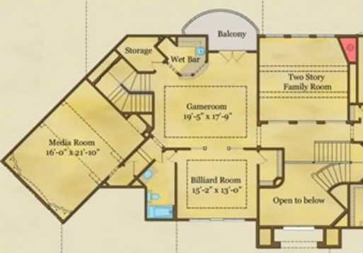

Initial Design Work
With the involved process of home design, construction and financing, time passed quickly. Note: builders and contractors do NOT nickel and dime you - they only work in $100 increments. The house was finished on April 1st, 2009 (my project manager called me that morning, just as I left closing, telling me my financing wasn't clearing. I still owe him for that one...). But with my previous home still on the market, with about one showing per month, I was happy at this point to just not be eating cat food for dinner. So the theater would have to wait. Plenty more time for CES and CEDIA trips, which if you're planning one of these projects with some percentage DIY - a trip to CEDIA is invaluable. (CES not so much anymore, although it is in Vegas)
The entrance to the unfinished theater space, with someone's smart-ass comment who was hopefully not invited to the Grand Opening
LESSON: At the time, Dennis' AVS-special design service wasn't available, and having shopped for other design services (which I deemed too expensive at the "basic" service level for the amount of additional expertise I would gain), I didn't use any of them. Having seen Dennis' design work here, and for the price he offers the AVS service, I *HOPE* that if I was starting from scratch today I would be smart enough to send him a check! I did get a lot of free advice from industry experts and manufacturers by visiting them at CEDIA, and of course, reading lots and lots of AVSforum threads.
With that, I planned the space using dimensions I *thought* would be "big enough". My original goal was 3 rows of 5 recliners, for a seating capacity of 15. Why 15? No idea. I decided on a room dimension of 16'x22', with two 12" riser levels, based on some seating dimensions and the belief that I didn't want or need an aisle on the 'far side' of the room.
LESSON/MISTAKE: Look at more than one chair manufacturer's dimensions. I have no idea where I got the dimensions that would have allowed for 5 recliners in a 16' room width. I can't find anything that would fit that we would consider "recliners". I should have planned for "any" recliners since it was going to be a while before the room would be complete. Also, 5 across is an odd number - most folks come as couples...
MISTAKE: Having the risers built-in as part of the structure means it's not possible to undo the theater and turn the space into something else. Not that I would ever do that, but it could be a turn-off to potential future owners. While it would be possible to fill in the front of the room, lowering the rear riser would be a huge challenge.
MISTAKE: I also made the risers 5'9" deep, also using some chair dimensions (see LESSON above). In the final theater, there's just enough space for the Berklines to recline fully.
Here's a shot of the unfinished room - the official "before" shot. And I always shook my head at folks that posted images of their rooms with piles of crap and boxes in them - well, ok, I can't go back in time to clean the room out now. So my apologies for thinking that y'all should have cleaned the room first.
The full room depth it turns out is nowhere near enough for three rows of recliners. I figured that out early in the design process, and quite frankly, looking at the prices of the 'high end' seating manufacturers, re-thought the seating arrangement. First, the quantity - 15 recliners, I could be looking at $15-20k just for seating. Um, no.
And I liked the idea of using a bar for the back row seating, which solved a number of problems:
1) Bar stools are much cheaper than recliners
2) Bar with seating takes up considerably less depth (which was fixed by this point)
3) Bar seating pulls the rear row away from the back wall, allowing proper rear surround placement.
Since I intended to keep/use/add large floorstanding speakers for the fronts, was looking at a masking system to go with a CIH setup, and didn't have a lot of space up front, I didn't intend to use the false wall and screen arrangement. For the same reasons, I didn't plan on having a stage.
IF I DID IT OVER: I'd have made the room 17'x 24', adding a foot of width (6" to each aisle), with at least 1' longer to the front, and 6" more on each riser. But I would have stuck with my final seating plan. If I had the room up front, I might have put in a small stage, but I don't consider the lack of a stage as a mistake, either.
This is the final design, although there are changes here from the original plan that I haven't discussed yet.
Next up, re-framing... (yeah, it's a brand new house)

I've added the info to the 'specs' list, too, as I'm sure that's going to be an FAQ...
Walls are Benjamin Moore 'Hasbrouck Brown'. Stain is Sherwin-Williams 'Golden Maple'. Acoustic panels are Acoustical Solutions SoundSuede 'Cordovan'.
Jeff

Fine. Here's the "before":
Yeah, I figured the game room question was going to come up, as yeah, the bar/game/poker/billiard areas usually coincide with a good theater...
I do have at least have an album of the game room area. Which a friend commented was essentially a "Las Vegas suite". That wasn't exactly the intent, but yeah, I suppose the 2nd floor of the house has most of the elements (bedrooms, poker table, bar, theater). I'm only missing the stripper.
http://s773.photobucket.com/albums/y...r/Game%20Room/
But your comment did remind me of my very early thoughts (at least a decade before I built the new home) on what I wanted. A great layout (basement) was in an early issue of "Stereophile's Guide to Home Theater" mag, which was a non-dedicated theater space with pool table behind the seating, a game table off to one side, and a bar completing the square. I thought that was awesome! The basement part is obviously a non-starter for me in Houston, but I loved the concept.
In my previous house, I would have folks over for movies on "the big screen", which was in the family room of an open plan. Upstairs (also open to the rest of the house) was a small game room where I had my poker table, darts and a pinball machine. Kids would often head upstairs to play the pinball machine while we watched a movie downstairs. That really doesn't work. Noise from the pinball is way too distracting. Same is true for any billiard games. For movie watching (not the case for sports), you have to close off the area(s) if you intend multiple, simultaneous uses. So that's when I realized that the future was going to be a game room "area", with a closeby dedicated theater.
As the house design process progressed, I made a poker room out of what could be converted back into a bedroom. It has a closet and a door to the bathroom - you'd just have to remove the decorative railings and fill in the wall. But I don't believe anyone in the future who would buy my home would be likely to do that - that whole area should be the selling/non-interested pivot point!
EDIT: I've attached some of the better game room photos here...
Jeff

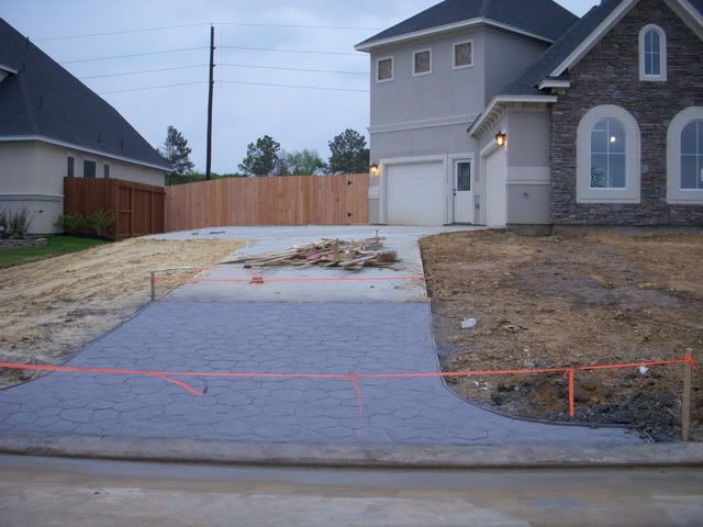

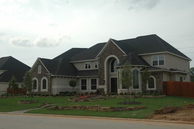

Yeah, it's not really visible from the front of the house, and it's really just a 2nd story on top of one of the garage bays, so it blends in fairly well. From the side yard, the rear of the theater is a big blank wall, but as it's angled off, it's not really visible from the back yard, either.
Not a lot of call for shots of the garage door - the only one I have handy was from late in construction. We put some slate-covered accents/false windows up there to avoid the "blank chunk of stucco". That's the screen wall.
But as the garages are entered from the side of the property, none of it even shows up in most pictures:
Jeff
