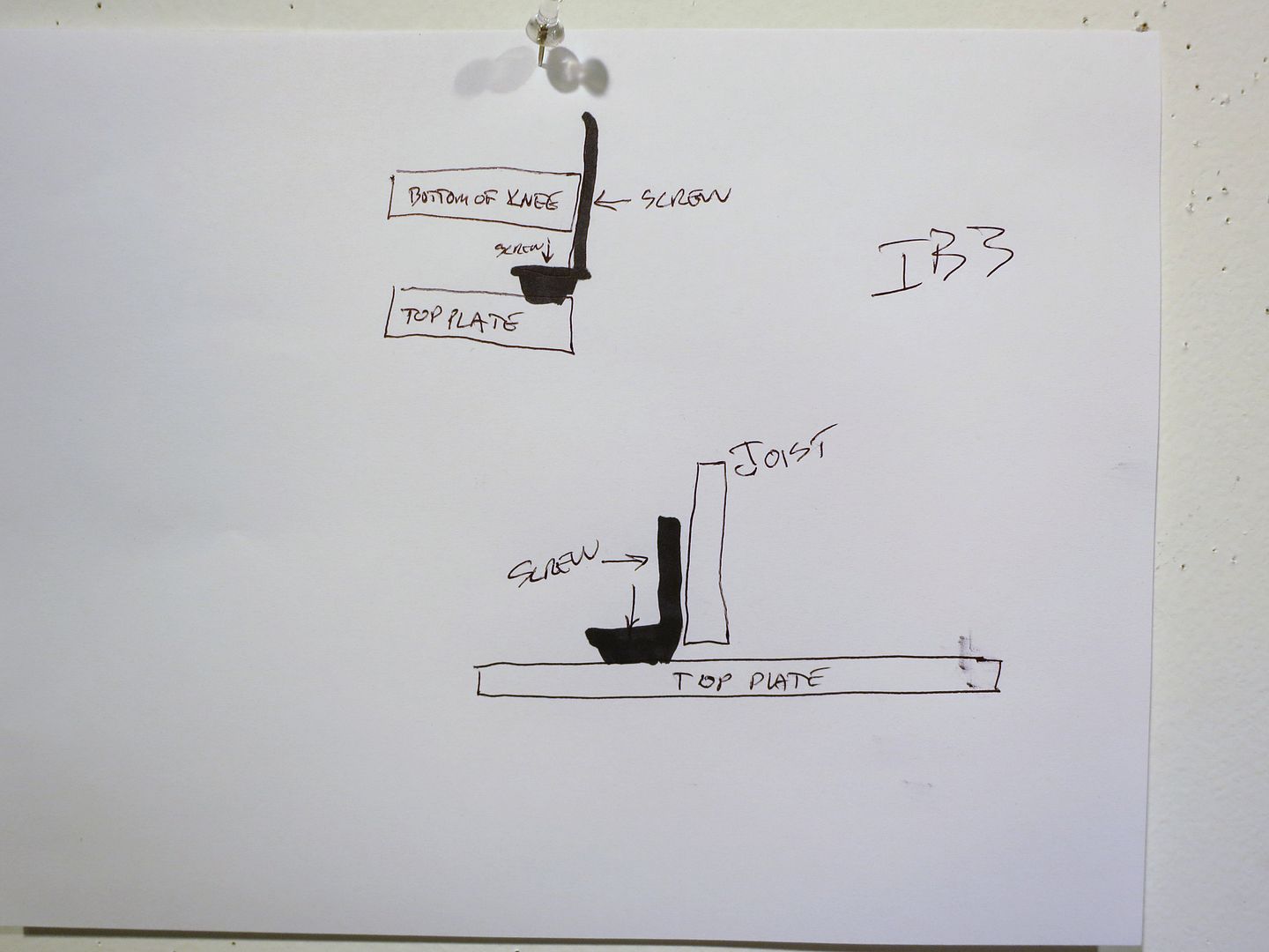

Originally Posted by jimim View Post
Right now yes cause the ib3 clips aren't in yet. We have to add the knee wall still that will drop down to catch the lower wall before the ductwork to front wall. That ductwork span is about 40". I won't really know till I get the clips in or should I just fix that today?
Am I ok with my space between the joists and to plate on that wall being the space is only 1/2" to 3/4"?
Also what do u think of the way we are attaching the knee wall to the joists and using clips on the knee wall to the top plate for decouple.
Are those two things ok?
thanks,
Sorry was building a theater yesterday. To answer your questions.
In my basement it would get fixed.
1/2 inch to 3/4 is fine
If you want to attach the top plate of a the wall to the dangling part of a knee wall that I see in the picture You will need a little more space for the base of the clip, and it will need to get screwed to the top plate of the wall before you mount the knee wall, It should also go on the back side. Not on the finished side.
So I'm going to attach the clip to the wall first line it up with the knee wall to make sure I have enough space so I don't recouple the wall and then attach everything? And make sure the clip is on the outside of the room wall.
I'm sorry if I not catching this.

post #69 of 123 Old 02-13-2012, 07:45 AM

Big, your drawings are priceless. I would hate to play a game of win lose or draw against you.

BIG has a toolbox of sophisticated drawing tools to help him with those:
(and yes, his pictures are worth at least 4500 words...)

Yes a drawing! I'm officially in the club! Thanks for that! I'm a visual learner.
I appreciate it! Oh btw I hate toe nailing. I suck at putting up nailers. I just can't get comfortable with the impact driver.

Toe screw instead of toe nail, Use a drill to drill pilot holes, put in 4 deck screws then lift up and drive the screws home. You can work on the floor or a workbench instead of up in the joist space.
Yes toe screw. Sorry. Oh pilot holes! I was starting 2 on the flood to make it easier but I suck overhead! Oh and I never used a hammer drill before. . . We are using tappers for the bottom plate and I've been song the pilot holes, very fun piece of equipment. I can't believe how fast and powerful it is!

Hi everyone.
I have a quick question. I'm doing the ladders tomorrow night to wrap around the beam in the room. I'm attaching the ladder to channel and clips. I'm putting clips on every joists for strength. The first clips will be 6" from the side walls.
Question. The channel ENDS, how far off the side walls should it be? Can I just leave a 1/4" gap from the wall to channel or should the channel touch the side walls? I assume not.
Also when I do the full ceiling for channel and clip. How far should the channel ENDS be off the walls. I know clips 6-8 inches.
jim
