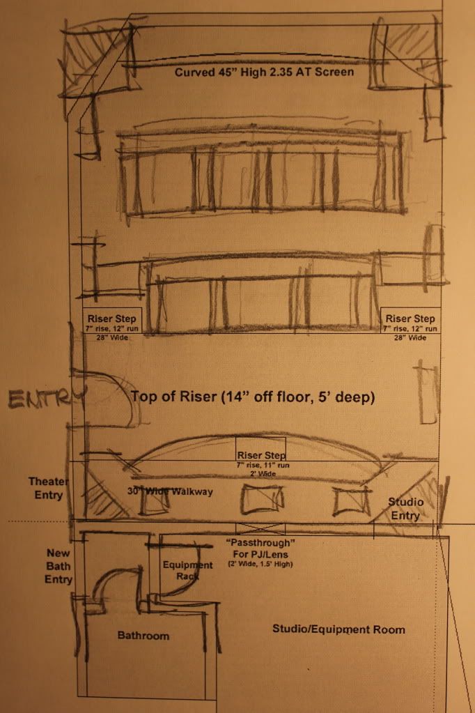

Here is my current floor plan sketch, very basic to give an idea.
The house was built in 1967, I bought it from the original owners who helped design it. There are several unusual things about this home, most of it is commercial grade product and not what one expects to find in a house. I do believe that there is a steel beam that runs perpendicular to the soaking tub in length that is housed in the area of the ceiling that is "the middle step" (shorter than the duct, but longer than the tub). As for the floor joists, in the Studio/Equipment Room the floor joists are 2x12s that run perpendicular to the soaking tub in length (same direction as the steel beam). So, if the tub is resting on some of the floor joists, or that beam, it would only be on the shorter side's ends. I'm not sure what the "under side" of the tub is made out of, but the "top side" is shells in some sort of an epoxy resin. The bath vanity counter top and the floor of the shower are all made with this as well.

I'm not feeling any love for your riser design, add some dimensions to that drawing and the collective wisdom of this community will respond.

This is all I have so far when it comes to dimensional sketch. Still brain storming.

With a 14' wide room, you should be able to make it work without having to create a center aisle. Try a layout with access against a side wall with a step up on the side of the riser.

Yeah ... I was going to say the same thing. Two riser steps from the walkway up, which mirror the two on the front. Push the seats hard into the middle and get them away from the side walls.

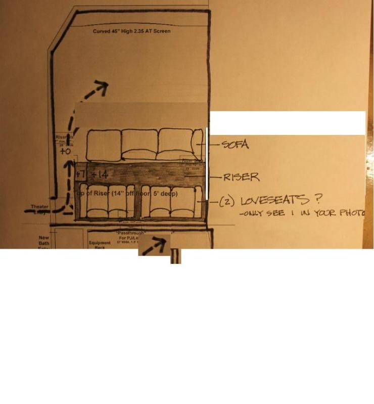

Either my loveseats are too small or the sofa is too big, but you get the idea.

Even better if you could do the above AND keep the seating centered more and away from the walls as Peter mentioned.

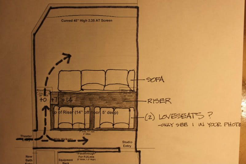

If you aren't stuck trying to work around that particular furniture, I would go with a more traditional layout like this (3 seats in front, 4 in the back)
The 3 seats could become 2 singles if you think that would work better for you. I don't know how the bathroom is configured, but if you have the option of moving that door, it would allow you to change the entry location to the studio/equipment room, which would free up that entire wall for either the front or back of your theater without the need for a 30" walkway. I flipped the theater but I think it could work either way if you really want to keep the pj in the equipment room.
A layout like this will be much better for speaker placement and corner bass traps (symmetry is your friend). Speaking of, does the angled wall you are creating really buy you much? I would ditch it, but if you really think it's necessary, you might want to try making it a smaller 45 degree angle that doesn't eat up as much of the room. Maybe that angle gets repeated within the room on the opposite end of that wall for symmetry.
This post was really interesting to me. I hadn't even thought of arranging it that way. So I started playing with that idea. However, I believe I unfortunately found a prohibiting factor:

Would flipping the room address this issue?
Well, the current design has all that stuff down in front of the screen where we won't be walking around much. If I flip it, it would put all that directly above head.
Looks like Brown Glue, which never really caught on due to it's resemblence to cow patties. After hiring a new marketing team, Green Glue has taken off. I don't really know what that is but it got me thinking about the age of your house. You should keep an eye out for asbestos as you rip that room apart.
Lol, it does look like cow patties. As for the asbestos, its always on my mind. I called a few asbestos removal companies and they pretty much said not to worry about it, lol. They said just wear a mask when tearing stuff down and make sure I vacuum everything up. They offered to accept pieces for testing but didn't suggest it as they seemed confident it would be fine. Somewhere between $500 and $700 per sample is what I've been quoted. I don't know if they are all too busy or if they really don't think its that big of an issue? My fiance's brother works for a restoration company in a different state, I've talked to him about it. He said more or less the same and said if we were to insist and hire someone, we could expect to pay ranges well above $15-20k just for the removal, if there is asbestos.

With respect to the booster riser concept, here is one from Cathan. It doesn't need to go wall to wall if you have an aisle. You can put your sofa on blocks if you want to see what it is like to get in and out.
The thread is the Flaming Oak Cinema.

Interesting Big, I will experiment with putting blocks under the sofa and see how I like it. It would be nice to save some headroom.
-Sean
