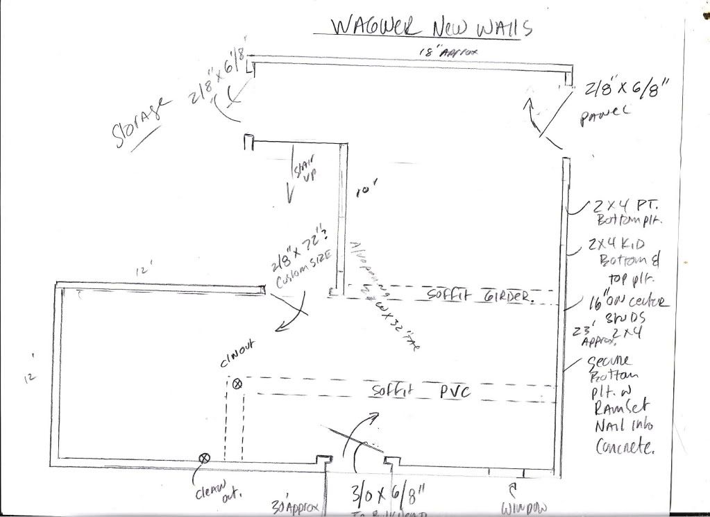

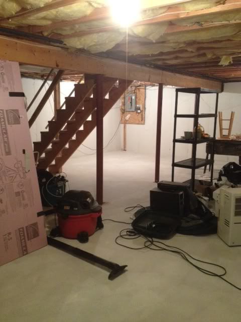

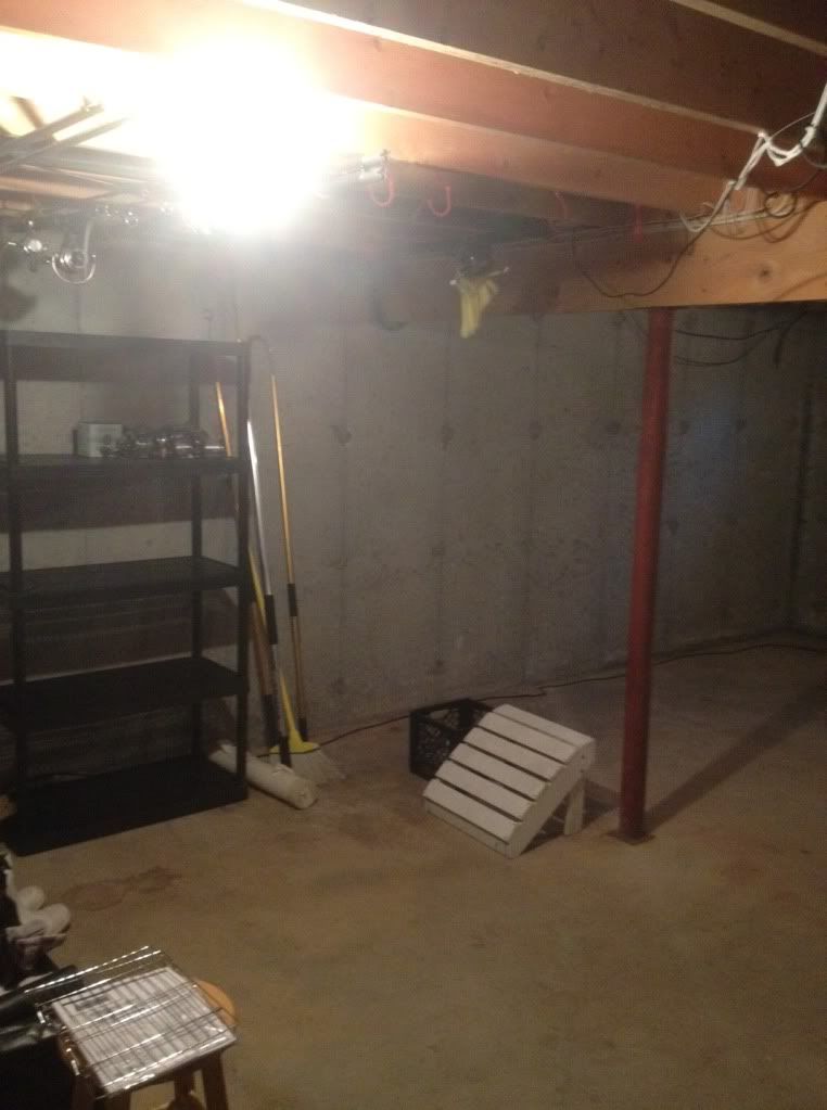

So I figured I would start a thread on my basement build the the Admiral just gave me the green light on. This will be a L shaped basement build with the theater going into the long part. We will be doing a drop ceiling do to access to mechanicals etc. Going to be 2 rows of 3 chairs and possible bar behind second row. Also construction starts end of the month.
Layout
bottom of stairs looking in
looking at screen wall
Looking at the back of theater area

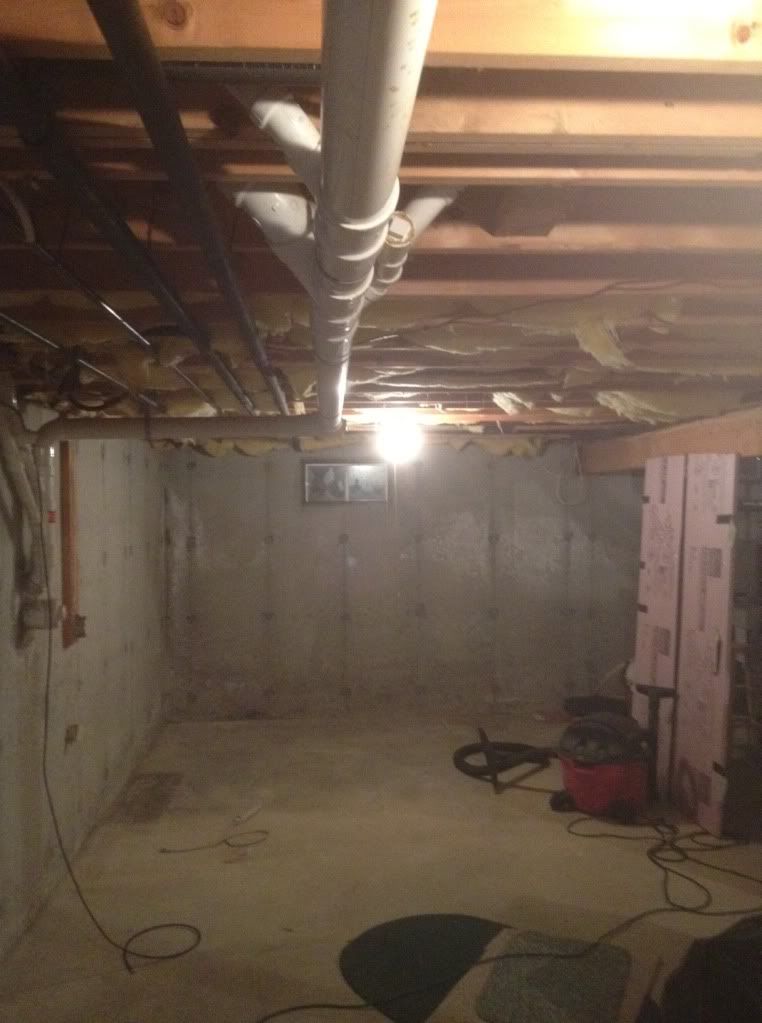

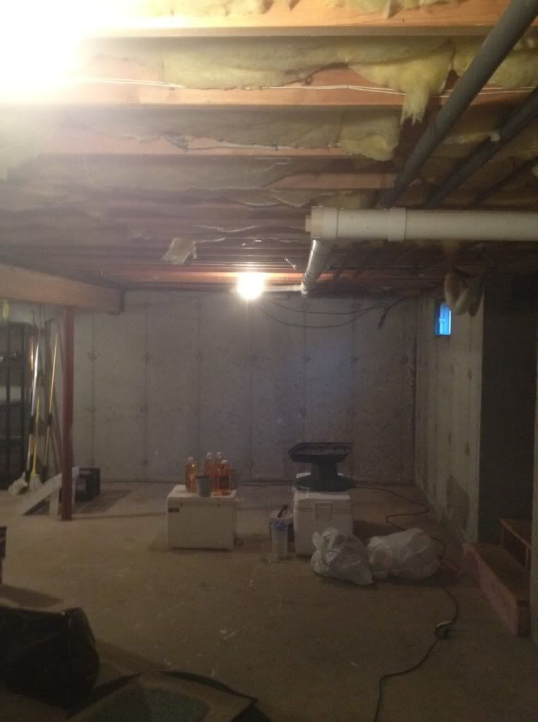

Couple of quick observations. I'm pretty confident that drain pipe could be tucked against the outside wall and you would gain some headroom if you were to build a perimeter soffit.
A growing number of local building code jurisdictions require the addition of an an emergency window exit when unfinished basements are converted to living space. It started only be required for basement bedrooms but some areas now want to see it if any living spaces are being constructed. Personally I think it is a good idea.

Yeah that drain pipe is a real pain in the butt! I have talked to my plumber about it and waiting for him to come over and take a look. If the pipe stays it will be boxed in like a beam and have a head height of 6'6". Main area will be ceiling height around 6'11".

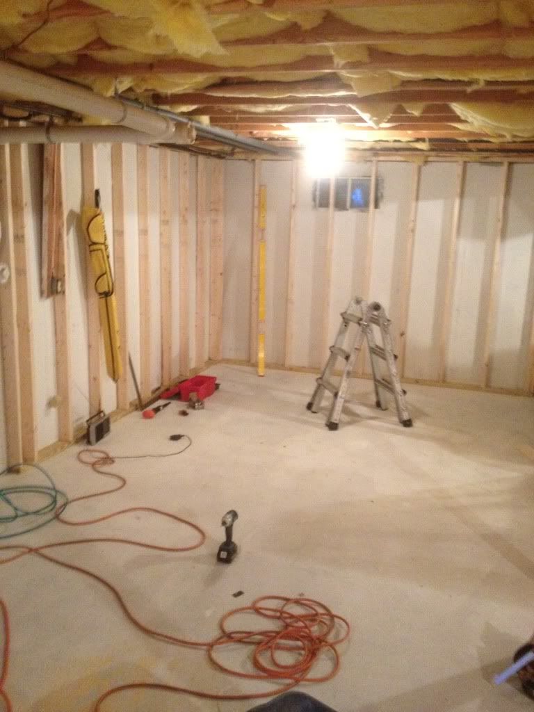

Ok so it has been a little bit since I last updated the build thread. Since last post my wife and I finished cleaning out the basement and put 2 coats of Drylok on the walls and on the floor. Also framing has started and should be completed hopefully by the end of the week. Next week hoping to add another heat zone for the new area and then have the electrician do all wiring for the outlets, lights and switches etc, I will do all low voltage stuff.
As for the wast pipe that you see in the picture I spoke with several plumbers and unfortunetly it has to stay where it is do to the bulkhead door. If it is moved tight against the outside wall it would be in the way of the entry door from the bulkhead. Also it would cost alot more to move so it will be boxed in. Hopefully with the black ceiling the sofit will not be to noticable. Anyway here are a couple of pics thus far.
Walls Drylok
Framing
