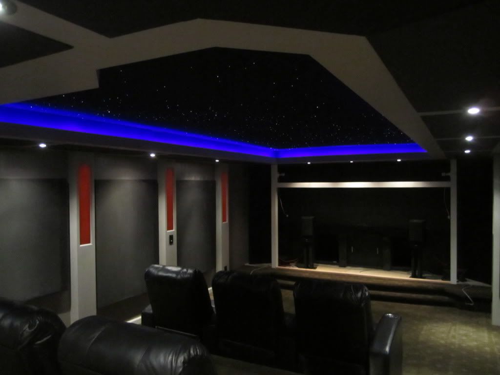

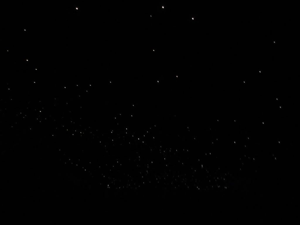

HT completion is coming down the home stretch, but here's my star field ceiling with freshly installed LED effect lighting.
Star Ceiling Size - 10' x 15'
Star design - Summer Night East Coast by FOSI
Illuminator - FOSI LED Illuminator
Dimmable - Yes by Graphik Eye
Wired - Hardwired
Pre-Made - FOSI Pre-Installed Panels (4)
Stars - 741 total (523 Milky Way dimmed, 218 Constellation with larger strands, twinkle)
Structure - ¾ MDF with black fabric
Secure Method - Screwed with 3/4" backing blocks through double-drywall install clip held channels - Screw head hidden behind fabric
Opinion - Very pleased
Here are some quick shots in both red and blue. The locations of the shots are in the same order (entering the room, back right corner, right side, front right corner).
RedTopDown is offline
Wired - Hardwired
RedTopDown,
Fosi did an incredible job on your ceiling. The burst of smaller stars (believe it is the Milky Way) are those stars the same fiber optic cable size as the others?
Larry M is offline

Originally Posted by Larry M View Post
RedTopDown,
Thanks! The MW stars use a fiber that's about half the size of the constellation stars. Only the constellation stars twinkle.
