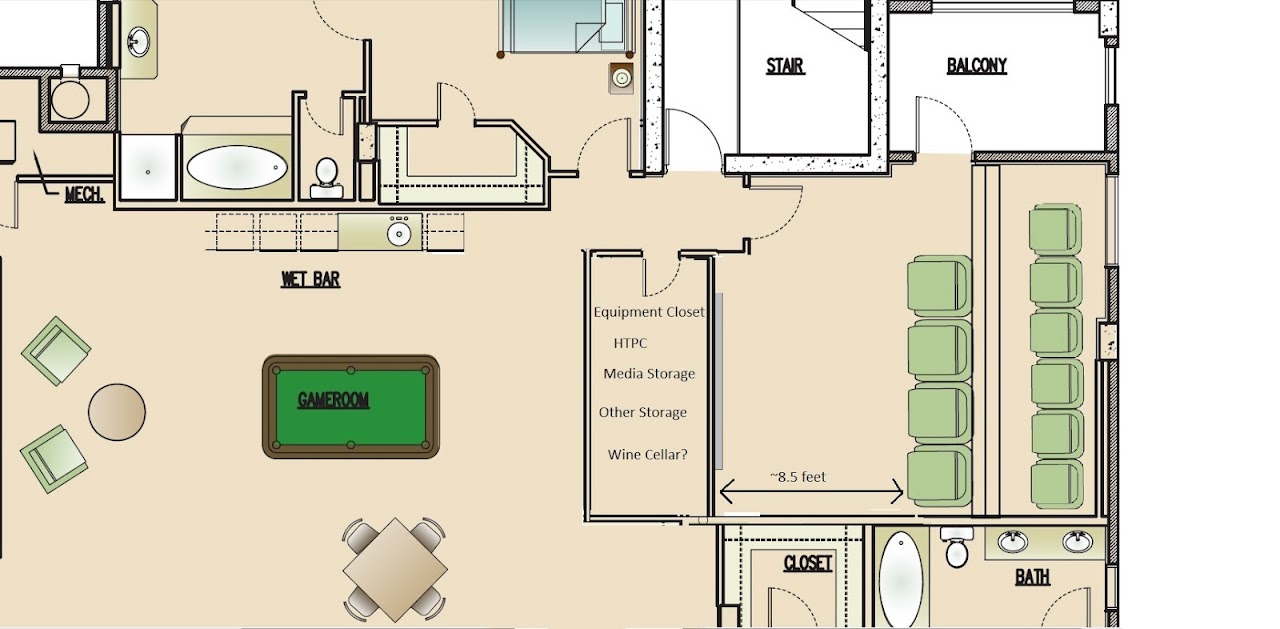

Here is a brief little sketch of the room, which is 16x16. Sorry I didn't include any scale, but I think I did a pretty decent job approximating the size of the chairs, doorways, etc.
I know I probably way overbudgeted for some of the items, especially the HTPC and videogames as you mentioned. Although to be fair an HTPC that I build that will be connected through this setup would probably get a fair bit of use as a gaming computer too, so $3000 might not be far off for that.

Just browsing the thread and opening my mind a bit got me to thinking... maybe I'm not limited by 16x16. If I'm willing to knock out some drywall, why not take it a step further and move the location of walls?
As it turns out, I think this would make a lot more sense:
Seems to me this would offer several advantages
- I would not have to enclose my balcony
- I could build a (larger) wetbar in a more accessible area; the plumbing work would be easier and cheaper as well given it would back up to a wall with a bathroom on it.
- I could expand the 16x16 footprint of the theater to something more acoustically conducive, as well as get a few extra feet of space in the room to make the viewing experience more pleasant.
- I could get a dedicated equipment room that could truthfully be as large as I needed it to be. The game room space is very large, so losing a 16x6 or 16x8 area of that would not be a big deal. I could add an extra 3-4 feet to the theater, and give me a nice large 4 or 5 foot wide by 16 foot long room to store equipment, and perhaps put in a wine refrigerator at the back of it! This seems more in tune with what people who build from scratch end up with (a room directly behind the screen with all their equipment).
- The HTPC/other equipment would be more centrally located in the home, making running cables to other zones if I desired quite a bit easier.
I suppose tearing down a wall and rebuilding two walls would add a decent bit to the cost of the theater, but given all the advantages it would offer, it seems to me like it would be well, well worth it.
And yes, I think I will definitely be looking into getting professional help in designing the layout of the room (and the entire floor to an extent) as I can see how limited my scope of thinking was. For all I know, there is room for even more flexibility. I'm excited already!

I would lose the front row and back row seat next to the side wall. Those seats are not going to be very good due to the surround speaker location. I would also steal a little more room and get the back row away from the back wall. That would be a big improvement for sound using a 7.1 system. I would look into using in-wall speakers and an AT screen. Plan for more than one sub and I would wire for several locations.

10 people in a room that size is really pushing it. With a 75k budget it makes sense to shift more of that cost to the room and less to the equipment. If you wanted to leave the room size the same, I would agree with rotating the screen and entering the room behind a single row of seats. This would allow you to push the front row back slightly and increase the screen to something like 120-130 inches.

If you are unsure as to what your final space dimensions would be, I highly recommend you consider a design consultant before you do anything. Ask around on various sites and do some internet digging to narrow your choices. Can't stress this point enough.

Forget gear for the time being - just hire Dennis/Shawn (above) and get the room right from the outset.
If it were me, I'd spin the room 180 with the door at the back, rack and projector in the closet there

Originally Posted by steveklein View Post
....I think I will definitely be looking into getting professional help in designing the layout of the room (and the entire floor to an extent)....
What is the current state of the space? Are you putting a theater into a basically finished area or is the whole thing going to be built out at once?
It's a finished space, but it looks like I will hire some extra help to figure out how to design it. I'll probably be tearing down and rebuilding some walls to get an extra several feet in the room and to give myself a dedicated equipment room.
