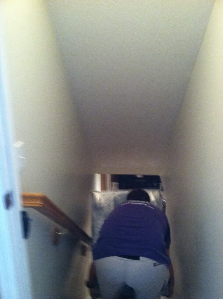

Ding Dong!
Honey, there is something at the door called an Orbit Shifter!?!?!?!?!?
Do you know anything about this?
And so it begins....
(I posted this in the sub forums as well but it is pretty fun so here ya go)
jedimastergrant is offline

Should we remove the plastic? Na'h, it can't be that heavy.
Easy does it
Uh Oh! Here's a tip. Take off the plastic you idiot!

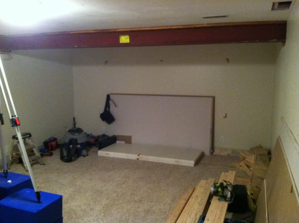

Obligatory post showing the screen taped out. Just before things get torn apart a little.

Liked: 271
Did some work last week.
Demo of the 2 existing soffits. One ended up being a support beam. I need as much height as possible so I am contemplating how best to deal with this.
What is the best way to cover the beam up and do so without losing more height? I am not opposed to rebuilding a soffit there. In fact, since the beam is already there I might as well just put the same kind of soffit in front of the beam as I will have around the sides and back of the theater. I am going to copy the Bacon Race design as much as I can with the soffits.
Any ideas on how to handle this beam?

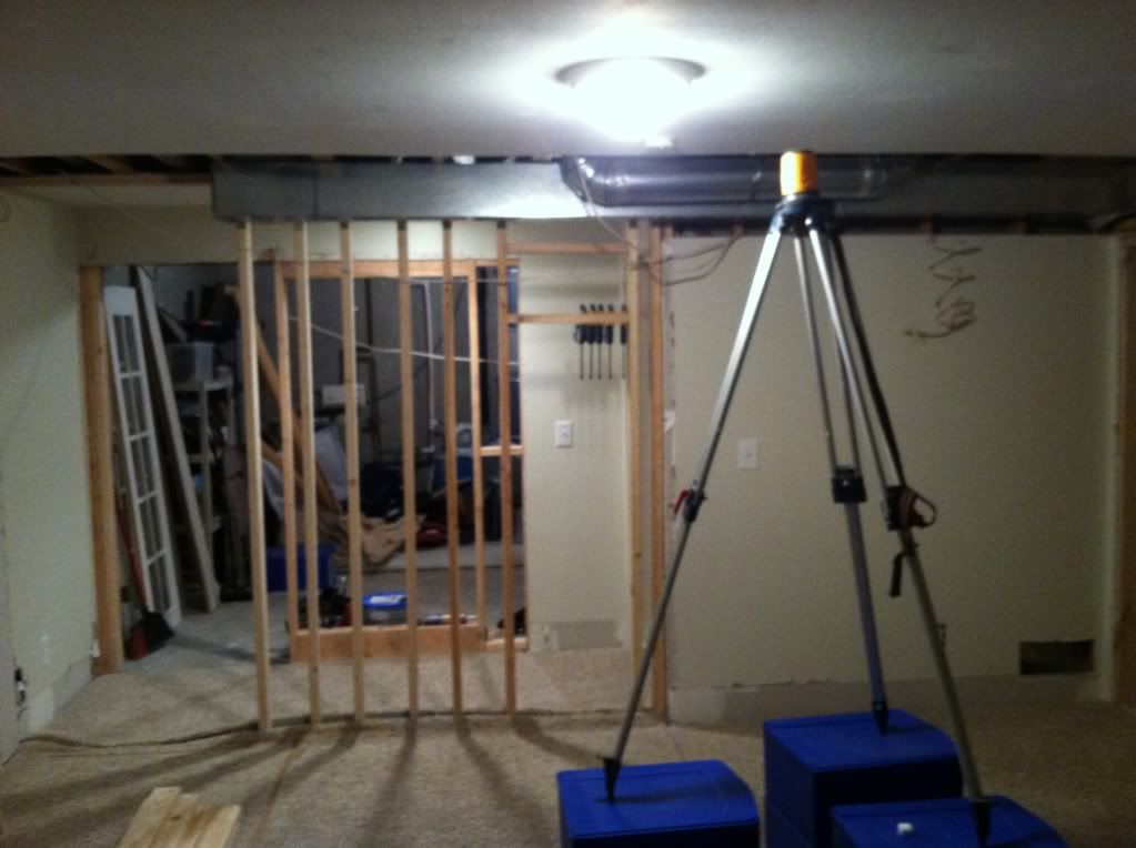

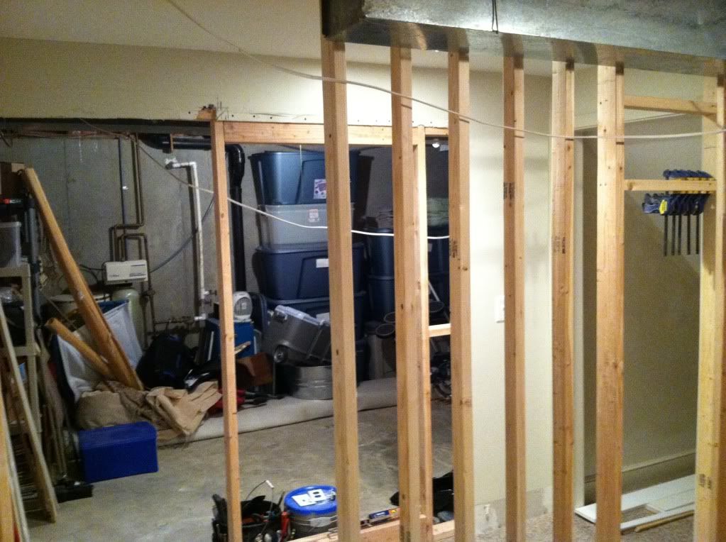

Here is a picture of the rear of the room. The extra wide stud in the middle of the picture is where I plan to have the projector behind the wall. The left side of the wall is where the door will be.
The second wall that is going in behind it will make a little hallway where my AV rack will be and a slide out media rack.

Here is a close up of the back. The front of the AV rack will be in the little hallway and the back of it will be in the storage area that you see there so I will have easy access to the equipment and have plenty of cooling. I plan to put a sliding media rack beside the AV rack.
