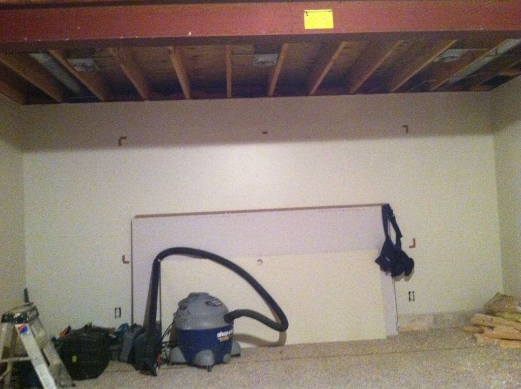

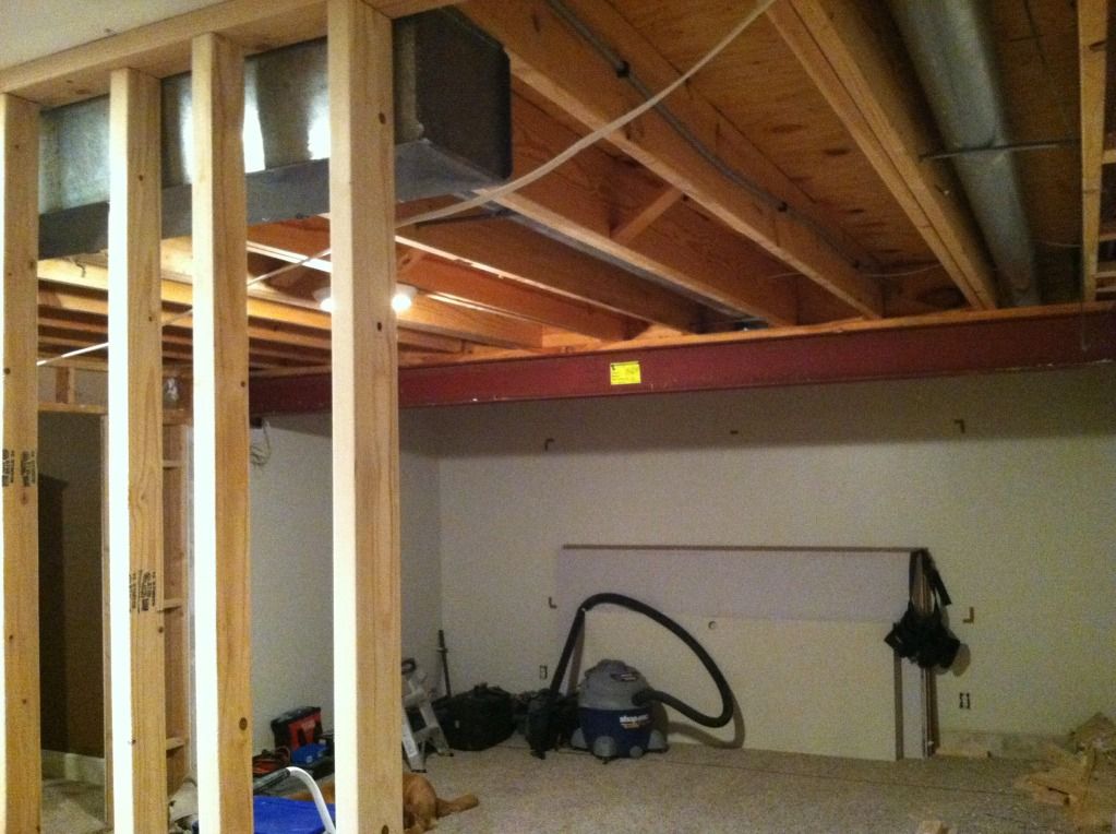

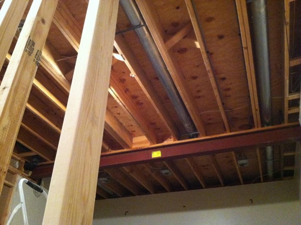

Ceiling Demo Pics
The days carnage.
Here is a shot of the bare ceiling.
Another shot.
Front of the room.

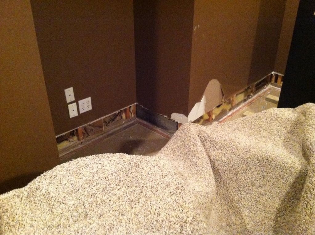

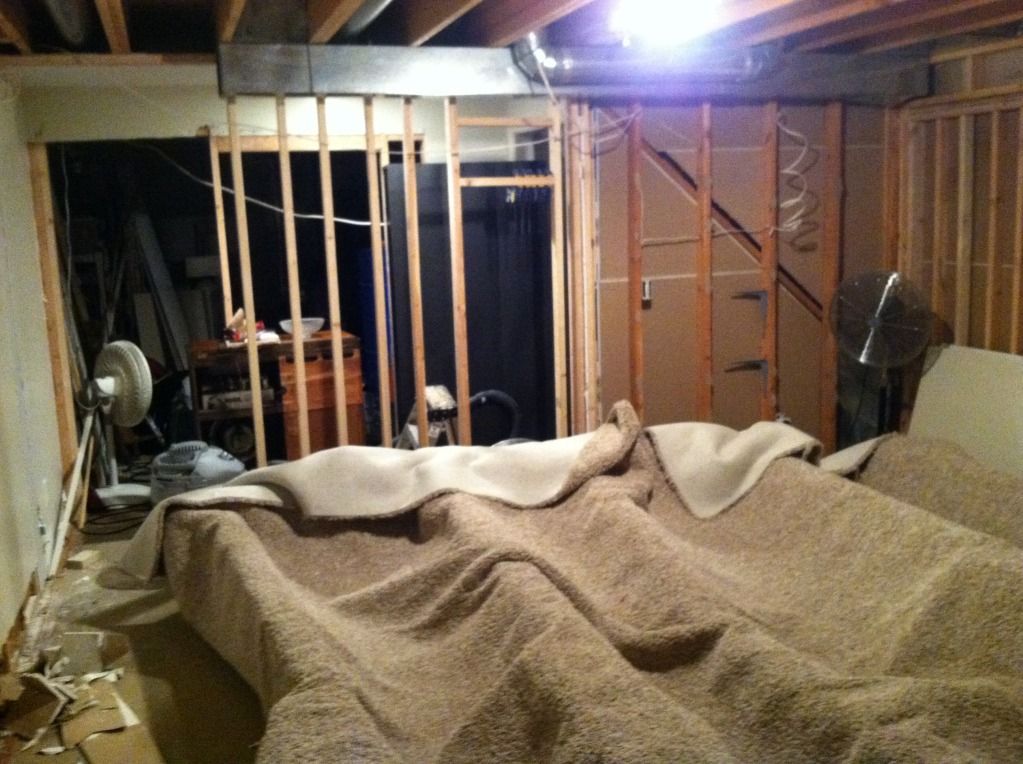

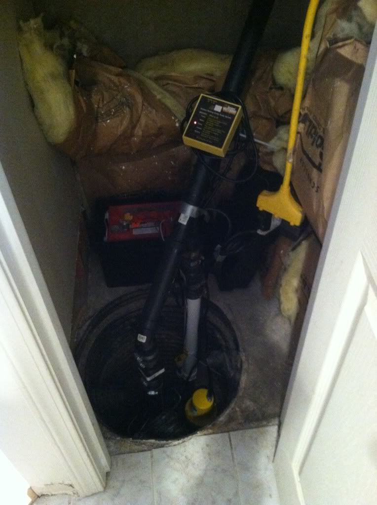

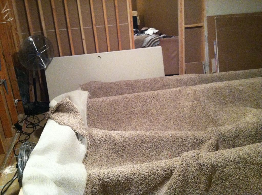

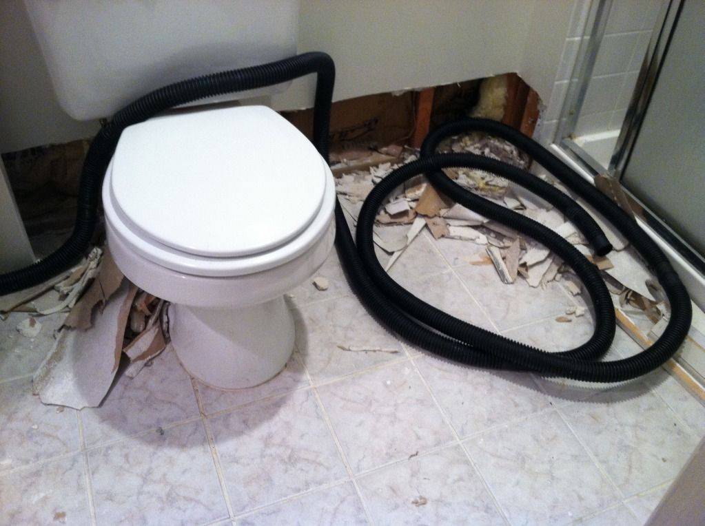

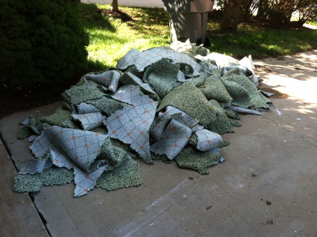

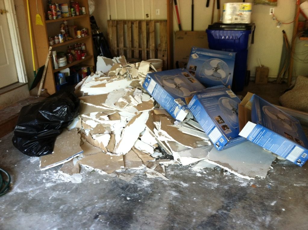

Flood!! Gruesome Pics follow.....
No not from Sandy. I actually got hit more than a month ago but I haven't had the heart to post about it until now after a little prompting.
What a mess
The offending sump pump has been replaced and I have also installed a battery back up sump pump just to make sure.
I was able to save my HT gear but the carpet, pad, and bottom 8 inches of drywall are toast. Even the bathroom will need some work.
I had a city dumpster delivered to my driveway and then continued to fill up that sum'bitch to the brim with my flood damaged basement. Oh, the dirty things that were coming out of my mouth on that day (more like a week). It took over a hundred hours working mostly by myself to clean it up and dry it out. Heavy duty carpet drying fan and dehumidifiers along with 5-6 more powerful fans and lots of work. (This is a different picture than the one I posted awhile back about my ceiling demo.)
Umm, yeah, I think the pad is done.
The rest of the house now gets to look like a bomb went off too from all of the displaced junk.
Tons more pics but I think that is enough.
I hope that this will prompt others to do regular checks on their sump pump and do what they can for the grading of their property, installing french drains, cleaning gutters, and whatever else it takes to prevent a catastrophe like this. And don't assume that you have sump pump insurance coverage unless it is explicitly stated. I had flood insurance but the sump pump coverage was an extra clause that I mistakenly left out of my contract. A very tough lesson. Life can be a merciless teacher sometimes.
Next post. A look on the bright side!

Flooding looks like a nightmare scenario! When we bought our house I could see that the uninished basement had been flooded regularly. Knock on wood that adding the sump pump, more external gutters and drylocking the basement walls will keep me from going through what you did.

I wouldn't trust the bulb type floats on those sump pumps. I paid the $40 and switched mine out for the straight up and down float. Worked like a champ through Sandy. Luckily, we didn't lose power.

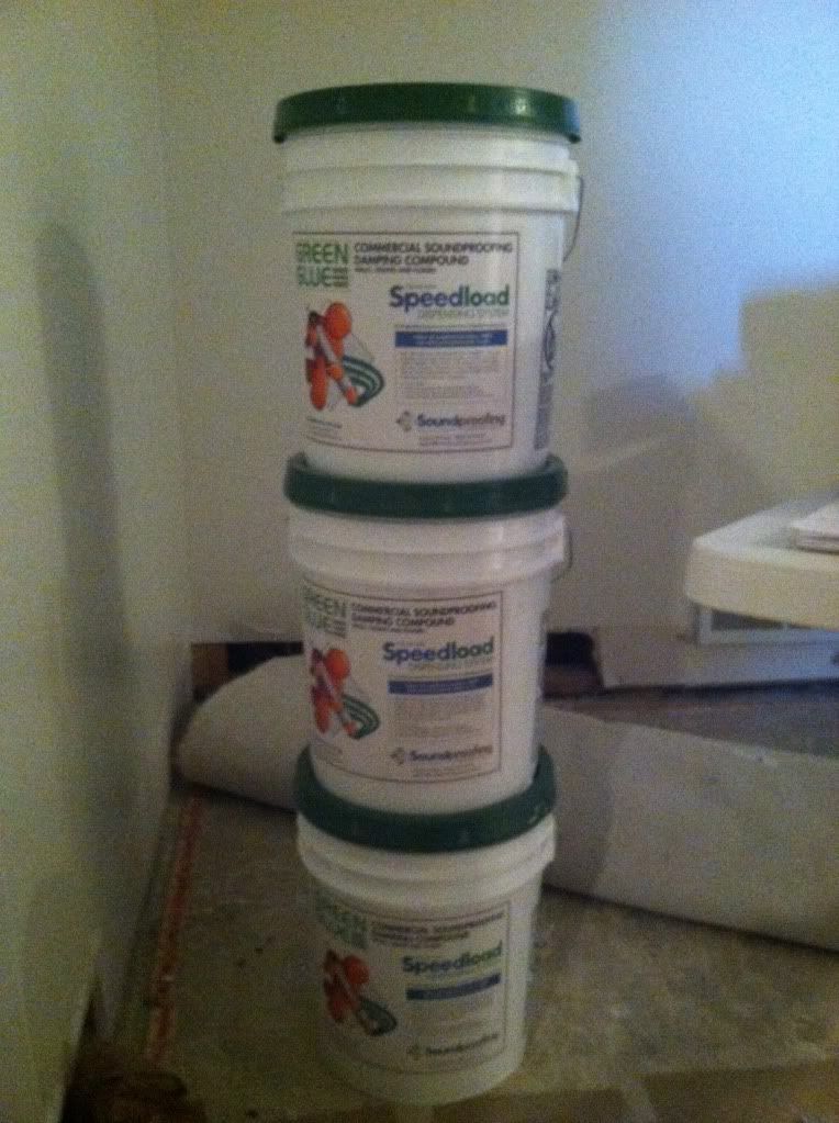

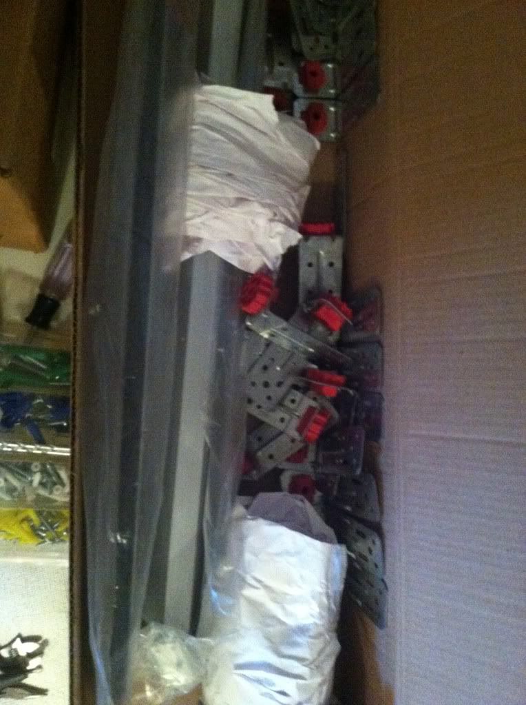

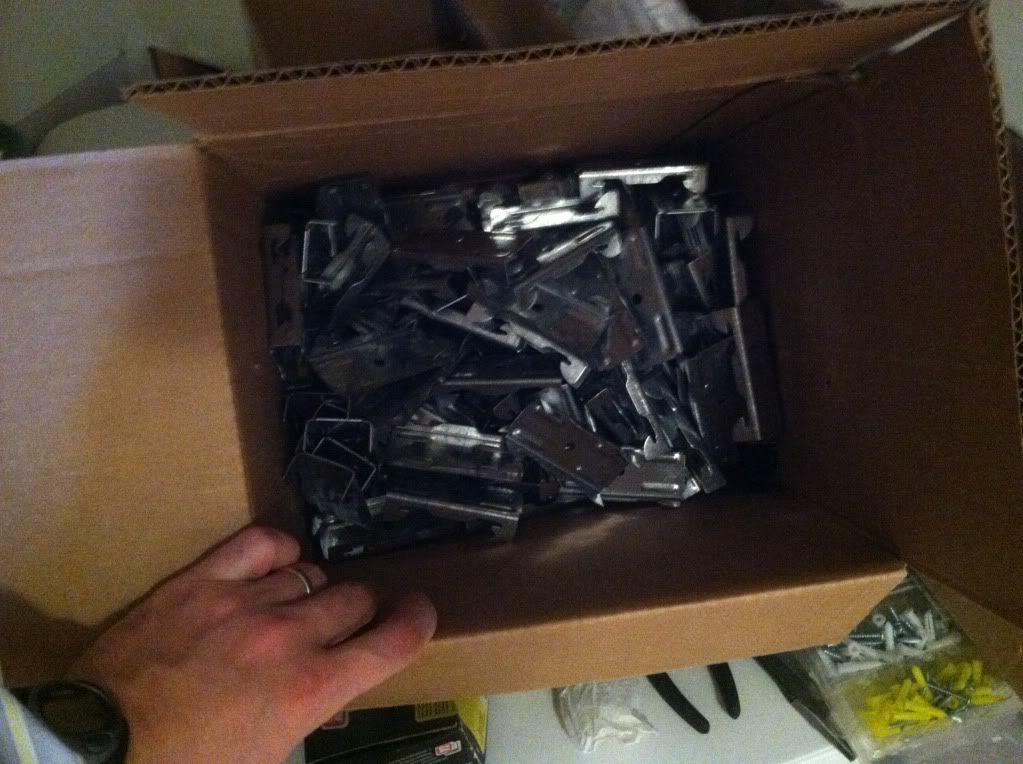

Soundproofing Materials Delivered!
I have in my possession the following:
IB1 clips for the ceiling.
Putty pads for electrical holes and whatever.
Acoustical Sealant.
IB3 clips to fasten my walls to the ceiling joists. And 3 automatic door bottoms.
And last but not least. A couple buckets of Green Glue.
I can't wait to put these to good use.
(Stitch1 I will get you what you asked for in a day or two.)

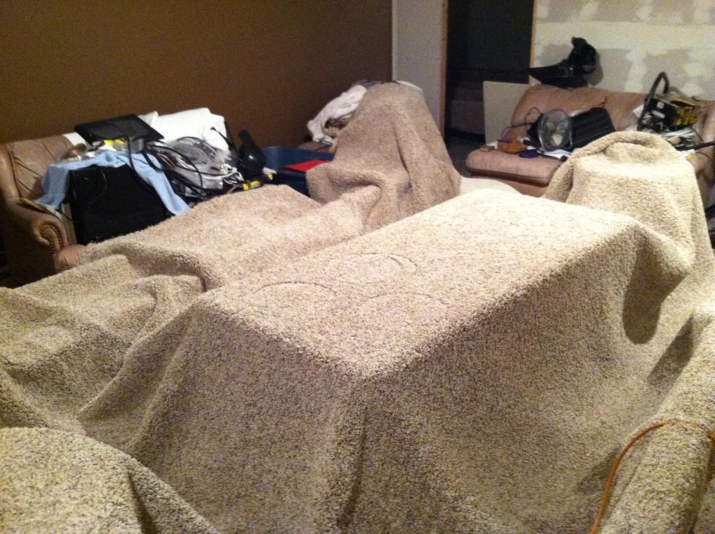

Before and After Pics.
Most people look forward to posting before and after pics when their HT is completed. But, we all have to start somewhere and I started with a finished basement. After some demo, a flood, and even more demo it seems that I am going backwards. I thought it would be interesting to see a different kind of before and after pic. Kind of like a before and middle pic really. It will make the day that I post the completed pics that much more satisfying.
I tried to match up the angles as best I could. I know it needs to be cleaned but wanted to post the pics first.
Looking at the front wall from the back corner
Looking at the rear wall. The right side is the stairwell. You can see the unfinished storage area beyond.
Looking at the right rear corner. You can see into the next room which will the be kids play room
And this one is taken from inside the kids play area looking into the theater room
Next time I will be looking at the bright side as promised.

Room Flip?
I have been considering a room flip to gain another foot or two. Tough decision so I thought I would post it here and see if anyone has anything to add.
I made an outline of some of my current plans and I will post some of them in sections so it does not get too lengthy.
A. Merits of flipping the room
B. Stage
C. Riser
D. False Wall
E. Electrical and Lighting
F. HVAC
G. Soundproofing
H. Sound Treatments
Here is the first one on the merits of flipping the room.
1. Advantages (Extra room length and other alleviated concerns)
a. The space behind my false wall is supposed to be nearly 32" and this space would now be mostly behind the stairwell wall giving me the made up space in the room. I was thinking that this space would be nice to have to keep the back row a little farther from the rear wall for acoustic reasons. It also gives me more space between the rows and lets me put my front row back another 6'' if I find that I can see the weave in my AT screen.
b. Having extra length would make it easier to build another wall alongside the stairwell wall for a complete decoupling approach with a double wall with insulation between.
c. The support beam that is currently in the front 1/3 of the room would end up in the rear 1/3 of the room. This allows me to have a taller image without sacrificing sight lines and it is also better aesthetically to have the beam in the rear 1/3 of the room. Then I could actually do another soffit down the middle breaking up the rear of the room into two large "coffers". This would make everything look like it was a design decision instead of an eyesore.
d. Currently there is supposed to be a door in the back corner of the room to allow access to the "hallway" area that is adjacent to the stairwell. This door makes it difficult to do a riser there and I would like to have vents along the wall boundaries just as you had suggested to make use of the area of highest air pressure. There will be a soffit above the door so there really is no room for a 1 foot riser and a soffit and a door. There is just enough room for the soffit. I had thought about making the riser only 6' tall just where the door is and that would mean making the door 6'' shorter which is not ideal. On the other hand if you feel we don't need the riser at all where the door is and we can still get good bass absorption then no problem.
2. Disadvantages (equipment closet, projector heat and noise, acoustics of
front wall)
a. A big unknown for me and one of the reasons I am willing to pay for your advice is the question of what the room flip would do to the acoustics of the front wall. Obviously almost half of the front wall would be essentially the stairwell wall and this would make the boundary of the right speaker closer than that of the left speaker. Since the stairwell wall is not quite halfway across it does allow a vertical center channel of moderate width to be unimpeded. However, the center channel would again be very close to the stairwell wall. The left speaker on the other hand would have much more space behind it.
b. My previous plan was to place the projector outside of the room adjacent to the stairwell wall and shine through a glass plate in the wall. I am also very concerned about vibrations from the kitchen above with soon to be three young boys stomping around on a hardwood floor (not to mention intense bass which I have seen happen in more than one theater). So my idea was to avoid hanging the pj from the ceiling and instead do a simple shelf that is affixed to the concrete floor. This would also take care of the heat and that particular pj puts out an immense amount of heat. In addition, the location outside of the room takes care of any noise the pj (or any future noisy pj's) will make.
- Ok, so if I flip the room I cannot put the pj outside the room and I will reintroduce heat, noise, and vibrations. I know I can build a hush box to take care of the noise but ventilating the box may be difficult because of the location of my supplies and my proposed return dead vent. And the vibrations part is still tricky. I would be clipping my ceiling so that would help. I was also
planning to use osb as the first layer for a substrate to nail miscelleneous items into. So I could also put IB3 clips into the osb to hang my hush box and or pj
from that for a little additional damping. I have also thought about using 1/4 inch steel for the floor of the hushbox to add some mass and reduce vibrations.
* Heat. I understand that if I have a very good HVAC plan it will take care of the heat. However, I do not think I will have the budget for a mini split system and I kinda doubt that I will be able to add another zone to my system. I am interested in both of these solutions and I have done a bit of research regarding them. I will detail those things later in my HVAC plans but I would much rather not introduce more heat to my room in the first place.
* Noise. My current pj is not loud but with a low noise floor it may be very loud. Also, in the future you never know what kind of noisy pj I may want.
* Vibrations. Even with the precautions I outlined I am still worried about this and it would really take me out of the experience.
c. My equipment rack location being in the storage area was really ideal and if I flip the room I would not have access to that storage area from inside the room. The only place I can put the rack and have it outside the room yet close enough for ease of use is somewhere in the wall that I will be putting back up. The only problem is that wall would also need to have the right
speaker along it, the door in it, and a column taking up space. The door is 32'' plus the casing. The column is 16''. The equipment rack would need to be I imagine at least 24". I would prefer to have some kind of pull out media storage next to the rack that would be around 12" as well. The speaker will come out an unknown distance but I imagine it could be at least 3.5 ft if that
distance is an important one for me. And the total length of the wall is a little less than 11 ft. So we are pushing it but we might be able to squeeze all of those items in there.
d. The actual length gained would not be quite 32". If I decide to do the extra wall around the stairwell then the wall will be around 4" plus DD and at least an inch between the walls so that would take up around 7-8''. Then if my false wall is made of 2x4's and it is located at least an inch in front of my actual wall that cuts off another 5" or so. The screen itself could end up about a foot in front of where the stairwell wall is. If we started with a total of 32" and take off a foot we end up with 20" of extra space to work with from the screen to the back of the room. If I take up 6" more by moving my front row back that still allows me to move my rear row away from the wall an additional 14" vs the previous configuration. I am not sure if it is worth it just for that but it might be.
I know it is complicated and kinda long but does anyone care to take a stab? I hope the pictures already posted in the thread can give you a mental picture but I can add more if it would help.
