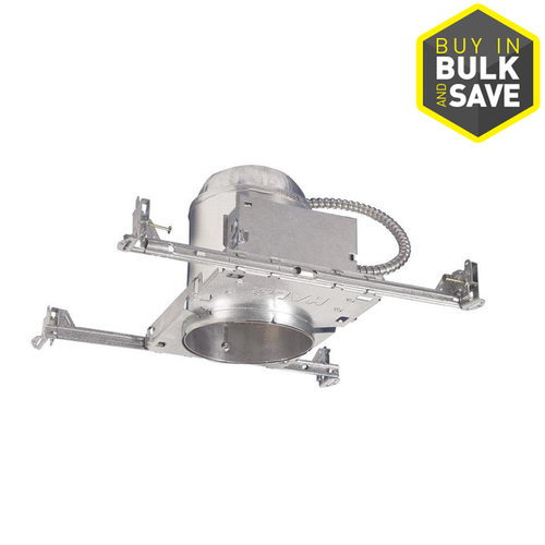

Starting to look at soffit lighting. Has anyone used these or something similar?
Airtight IC Housing
Would the airtight nature of these be a benefit, or am I just getting sucked in by marketing (again)?

I assume that the soffits will be built after the room is drywalled?
I'd recommend these lights:
http://www.amazon.com/gp/aw/d/B005WJ...dir_mdp_mobile
You cut a hole in the drywall on the soffit and then just pop them in. They're cheap, dimmable and come with an MR16 lamp. The trim can be spray painted.
They sell them at Home Depot and Lowes (well they do at mine at least).
I've seen them used in many theaters (bacon race comes to mind) and I used some in the ceiling of my theater.

Posts: 501
I used can lights like that in my basement, but not in the theater area. I dont think them being 'airtight' would be of any benefit (or detriment) to you, as it looks to me like you are doing a DD+GG shell, then adding the soffit/lights later. I would however, be careful if you do decide to install them, as it looks like the sliding mechanisms would have a high likelyhood of vibrating during bass heavy scenes.
brausch is offline
The front soffit will be built prior to DW, rear and sides after. The thing that concerns me about the lights you reference is that they are 13" tall when fully assembled. My soffits will only be 9-3/4" tall. Other than that, they look to be a great solution.
Yeah, the vibration factor concerns me too. For some reason, I thought they might vibrate less than the ones that clip in to the DW. What lights are you using?
GWCR is offline

In the theater I am using 3 small 3" can lights (remodel type, from HD) for the front screen wash. The only other lights I have planned are the 6 wall sconces and the one step light for the riser.
Everything feelt like it snapped in pretty tightly when I installed my small cans, but because I used the remodel mounting method, IF this is a rattle, I will be able to pull out the light to fix it. You would be pretty limited with the new construction lights.
One thing I had read somewhere on this site was to mount the lights, then wrap any loose parts tightly in tape to prevent rattles. I think if you were diligent when installing them, you should be okay.
The ones that I used were from Home Depot. They have the junction box off to the side instead of on top like this one.
http://www.amazon.com/gp/aw/d/B00766...dir_mdp_mobile
They were the smaller 3" housing though and came with the trim and bulb. I can't find a link to them right now though to tell you the exact height (on my phone at the moment).
EDIT: They were these ones, though mine weren't labeled as "spots". It looks like they are about 7" tall.
http://www.homedepot.com/webapp/wcs/...5f%2d202199102
Thanks Brian. Good point on being able to pull them back out for service.
Thanks for the link. Those should fit. Doesn't look like the ones on that link are IC rated, but I'm sure they have a model that is. I'll check them out next time I'm over there.
I've also been thinking about puck lights above the screen instead of recessed. Where did you get your pucks? Looks like they might be a good fit for me as well.
That's a good point. I used these exact cans in my room. I will tape the slides with electrical tape to prevent rattling before I rock them in. Hopefully that'll suffice!
