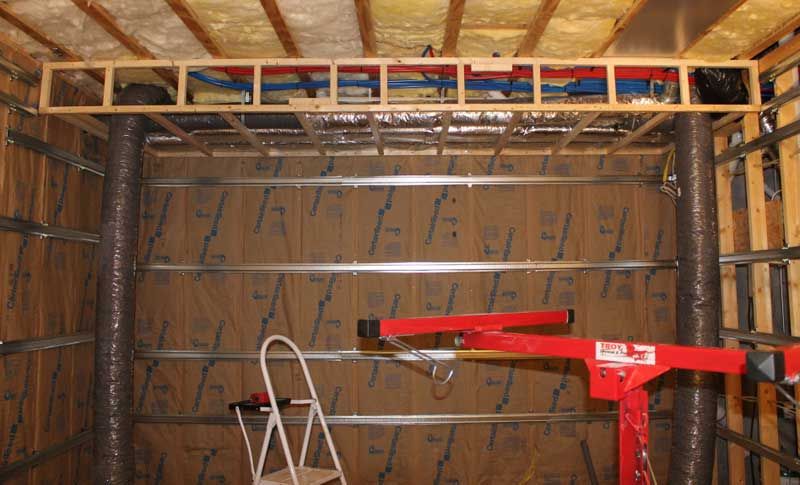

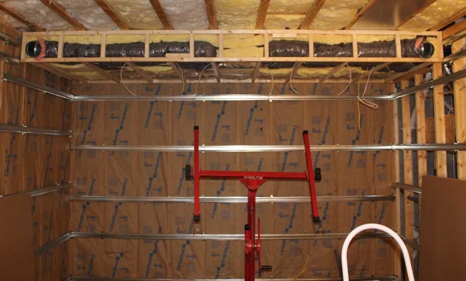

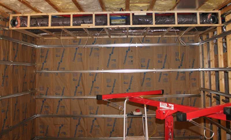

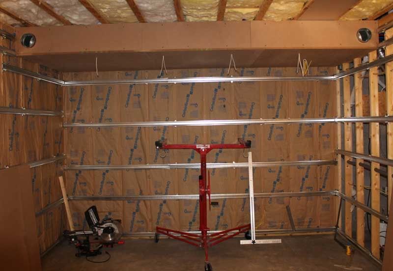

Made some decent progress over the past week. Got the clips and channel installed on the walls. Almost done with the ceiling clips, but I ran out. Need to get some more ordered today. Also, framed the front soffit, snaked the HVAC, stuffed with insulation and closed it up with 3/4" MDF.
Soffit Frame 2x2's
HVAC Supplies in Soffit
Insulation
Closed up with MDF
First time I have worked with MDF. Very heavy and a dirty mother when you are cutting it. I had the guys at Lowes cut it to the length I needed for the soffit bottom, but still had to make a few cuts. So much easier to handle since they made the initial cuts.

Originally Posted by GWCR View Post
Quick update from the weekend. Finished hanging the 2nd layer of drywall. Will post some pics after I get the room cleaned up a bit. Next items on the to do list...
Run conduit for projector cables.
How are you eating that piece of the elephant if your drywall is up?
