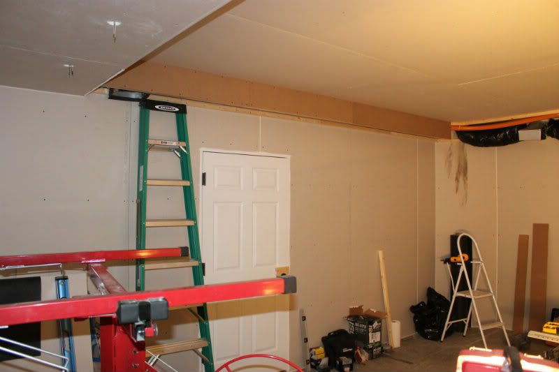

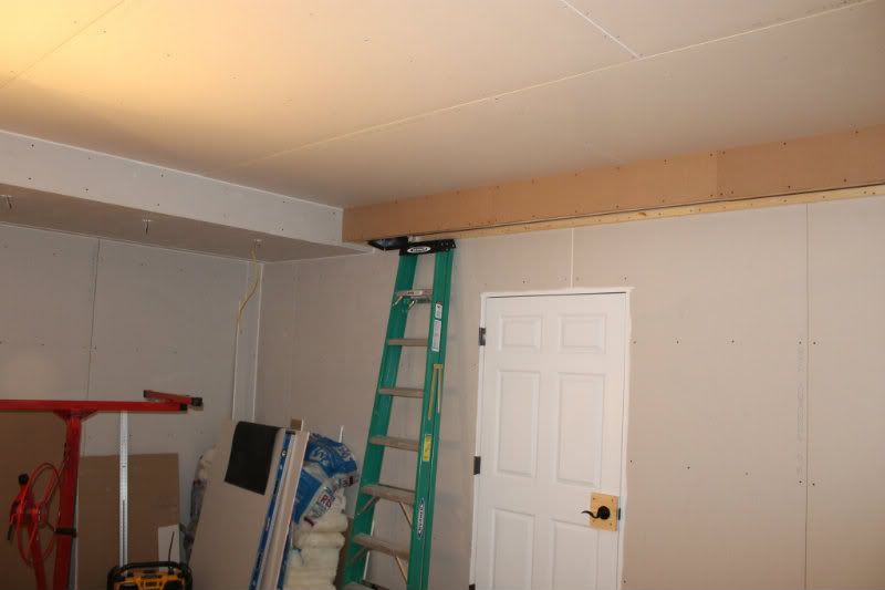

Wow. I just noticed that my thread fell to page 2...OF MY SUBSCRIBED THREADS PAGE!! Totally unacceptable. Guess I need to do a bit more regular updating, but July has been kicking my butt and making it hard to get anything accomplished in the HT. I did make a little progress, but nothing too exciting.
Installed 2x2s around the perimeter of the walls for the soffits.
Primed and painted the door frame and door.
Installed the door hardware.
Trimmed out the family room side of the HT door.
Yeah, I know the door stuff didn't NEED to be done right now, but at least I don't have a shim keeping the door closed anymore. Plus it made me feel like I at least got SOMETHING accomplished amidst all the birthdays, anniversaries, baseball, basketball, football, etc.
I won't be able to work on the HT this weekend, so hopefully I can get a few things done during the week. Sorry for the lack of pics. Will try to post some later.

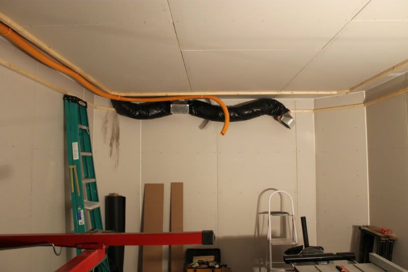

Nothing really picture worthy. I ran the conduit for the HDMI cables to the projector. Double and triple checking my wiring needs to make sure I don't forget anything. In a bit of analysis paralysis at the moment, but plan to get as much done as possible this weekend. My goal is to finish the wiring, HVAC boots, and close up the soffits. That would make me a very happy camper.

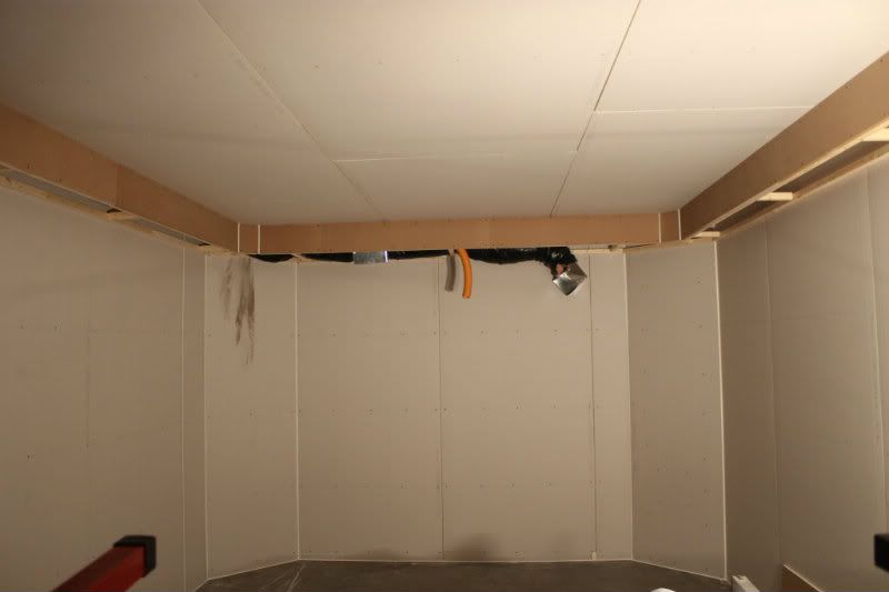

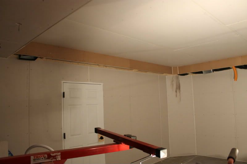

Ah, the best laid plans...
Didn't get as much done as I wanted to, but have a small update.
Decided not to make custom boots for returns and supplies. Went with 6"x10" for both. Held vent cover up to the boot when air was on. Very slight air movement noise with my head directly underneath it, but not enough to be a concern to me.
Returns now have their proper spacing.
Had just enough time to get the MDF up on the entry wall soffit.
Now that I have the soffit sides started, the motivation is back. Too bad the available time doesn't match up with that. I have officially decided not to do sconces on the walls. I will be doing a light tray similar to Mario's Cinemar Theater. That should give me enough light for my purposes. Labor day weekend will not be very restful for me...

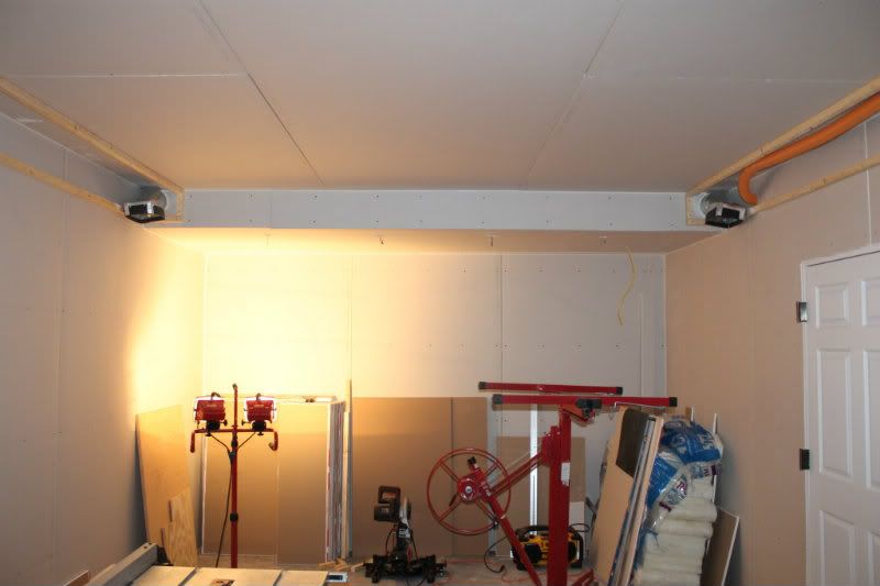

Quick update from the Labor Day weekend. Between football, confirmation, family and being under the weather, I didn't get as much done as I had hoped (seems to be a theme with me lately...). I did manage to get the rest of the soffit sides up, and start to run cables.

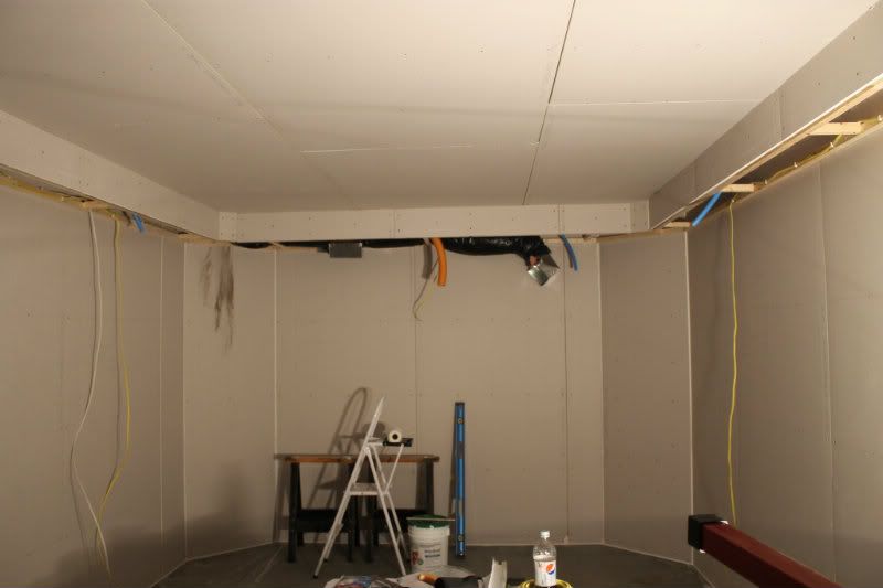

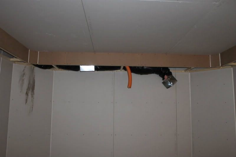

Two weekends in a row where I've accomplished something! Power and lighting cables have been run inside the soffit. Ran 3/4" conduit to speaker locations and sucked string through them with shop vac. Put DW up on outside of soffit.
Next up is to fill soffit with insulation. Then close that sucker up and hire out the mud/tape!
