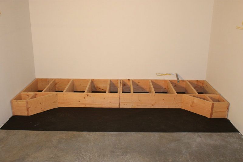

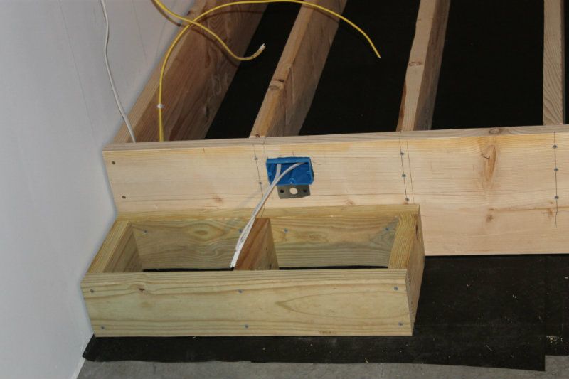

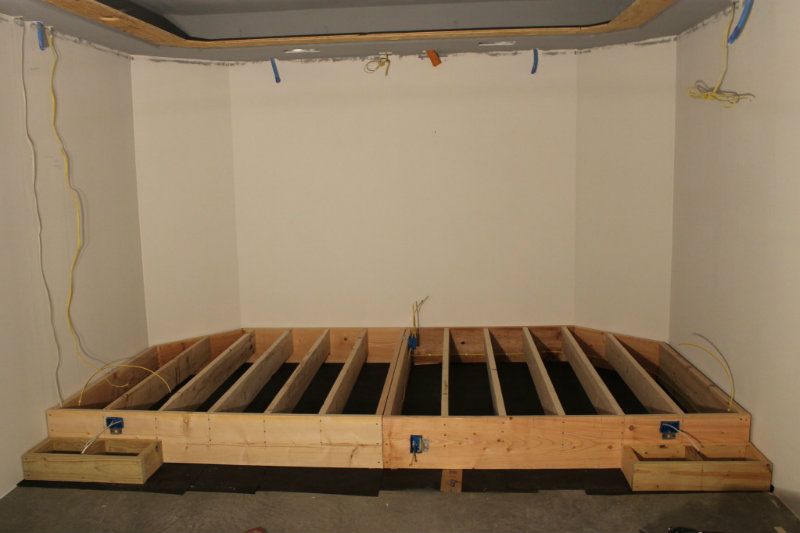

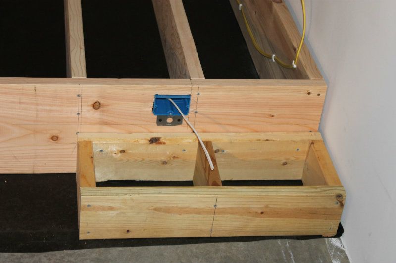

Finished wiring up the riser tonight. Tomorrow I build the steps, put the insulation in and seal 'er up. Then we'll see how far I can get with the stage...
GWCR is offline
post #194 of 534 Old 11-10-2012, 06:31 PM - Thread Starter
GWCR's Avatar
Join Date: Jul 2009
Location: Cedar Rapids, IA
Posts: 827
Quoted: 17 Post(s)
Liked: 39
Riser is done except for the holes for the bass trap. I don't have the register covers yet, so kept that on the to do list for now. Here's proof that I actually accomplished something over the last week.
Wiring and steps done.
Insulation in
Deck on
Stage is next...

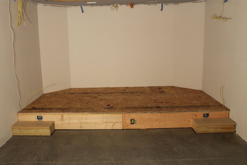

I could use a little stage advice. I worked on the stage this weekend, and have everything done but the curve and step. This would be the "AVS Stage" design that is very popular on here. I am having trouble figuring out the depth of the step and arc of the curve. Here is what the stage looks like currently.
Here are the dimensions.
Overall width - 12'4"
Center width (between the 45's) - 7'7"
Depth of middle - 3'
Depth of sides - 4'4"
I was thinking the depth of the step and curve at the center would be 18" total. That would mean the step would protrude into the room 2" farther than the side of the stage. I could simply have the middle of the stage height curve be 9" deep and the step be 9" deep. Or go 8" and 10" respectively. Or do something else that may be suggested on here.
I have a bit of analysis paralysis at the moment, so any help is greatly appreciated.

post #200 of 534 Old 11-18-2012, 05:37 PM
CEO FALCON SCREENS
snickers1's Avatar
Location: Northern Virginia
Posts: 918
Mentioned: 13 Post(s)
Quoted: 82 Post(s)
Liked: 126
it is easier then you think i thought it was hard at first ... here i how i did mine
start from the middle and figure out how pronounced you want the curve and take the piece of plywood your going to use and start from the middle and have someone hold it and then bend it towards the outer edge and eyeball what think will look good... then just cut the middle support and the outer end support then fill the middle it starting with long pieces working you way down maintaining the curve you wanted... then you just duplicate it for the other side
notic in mine the curve is two pieces joined in the middle
hope this helps
