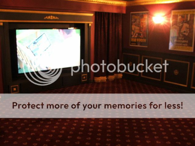

Here are pictures after the wiring has been run and the drywall is up and finished.
I built a header/valance at the front and back of the room where the curtains will be installed later.
I put in a solid door on ball bearing hinges with a self closing spring hinge in the middle so it would be like the old theatres I remember as a kid.
I drywalled the ceiling and then switched gears to install a tin ceiling so I put up plywood over the ceiling drywall.

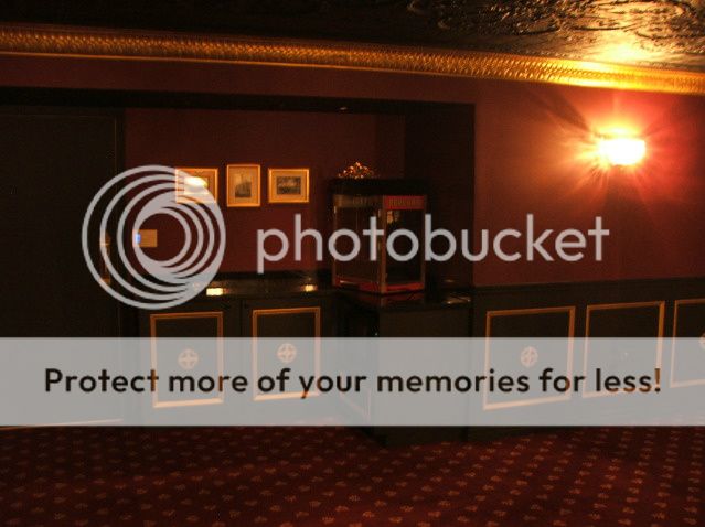

Then I put on some paint and installed our wall sconces as the dusty part of the job was finished.
I used MDF on the lower walls for the wainscotting and after a major brain cramp figured out my spacing around the room for the stiles and rails.
I then modifed some cabinet boxes to accomodate our old microwave so we could reheat things without running upstairs all the time.
I installed and painted the bezels on some low voltage recessed light above the future counter and threw some paint on the wainscotting.
I then started work on the surround for the tv (Sharp 80"). I decided against a projector for various reasons...
Then onto the tin ceiling installation.
Priming took about 8 1/2 hours with a brush due to the depth of the pattern.
Followed by two colour coats.
Then I installed some panel molding and inserts in the wainscotting to give it the style I was looking for.
Installing the finished cornice was a patience test for sure. It doesn't look like 8 1/2 " wide but coping those corners was not fun.
I went with a "Black Galaxy" granite tile for the counter as the cost for a one piece was ridiculous. I ended up darkening the grout later on so it blended better colour-wise.
I then made some cupboard doors to match the wainscotting in the room.
I finished the component and speaker covers and installed them.
I had to contract out the sewing of the curtains to a friend's wife or I would still be doing them 6 months from now.
Some pictures up on the walls and a popcorn machine ready for the final steps.

Here are a couple with the new carpet installed. It looks better in person.
All one of the installers could say was "Wow!"
Mind you I don't know if that was in a train wreck kind of way or a good way...
The colours are hard to capture with my camera for some reason. They seem to turn out purple instead of burgundy.
These are blurry but a little closer to the actual colours.
If you are interested the paint colours are Benjamin Moore Radicchio and Black Panther.
The carpet is Milliken Adonis in Garnet II.
I have to move in the seating in a bit so for now here are a couple to look at.
