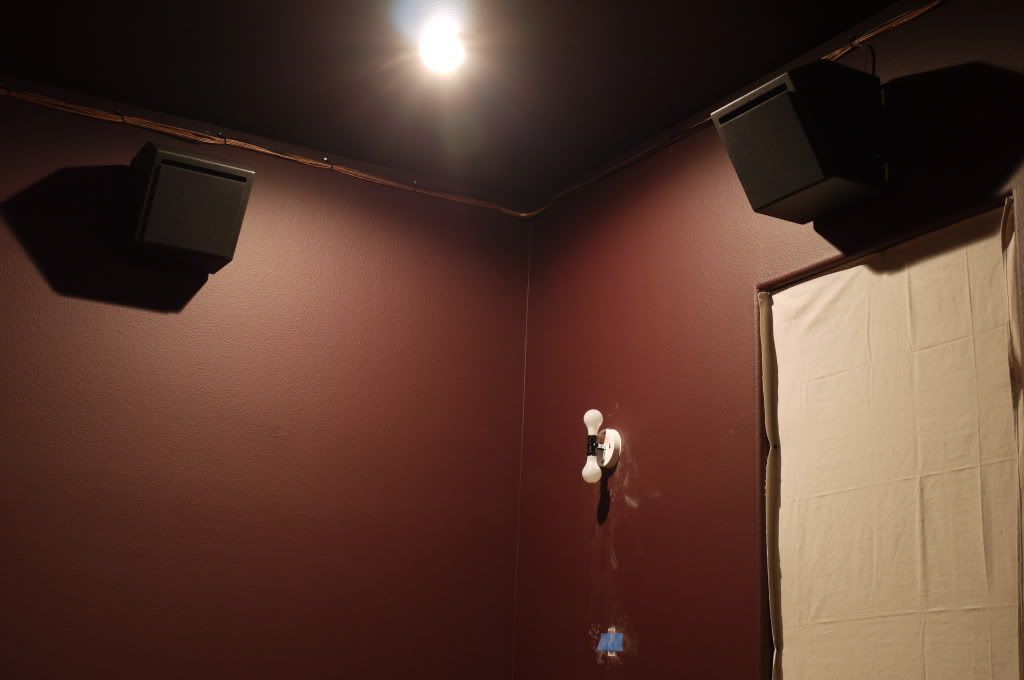

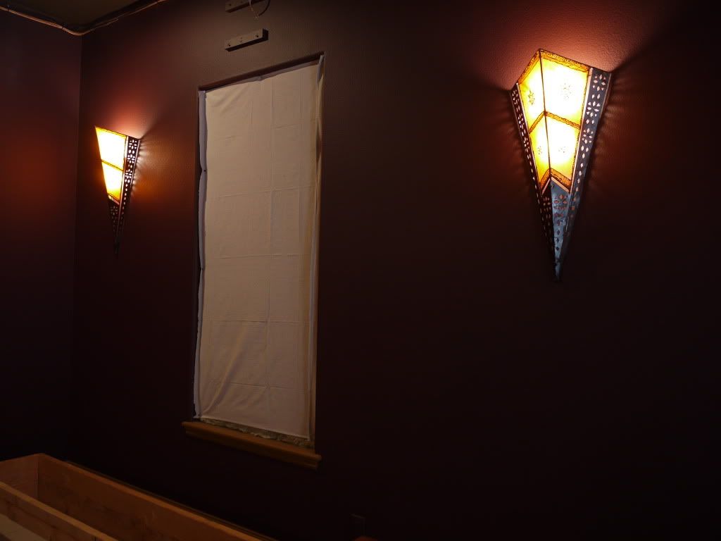

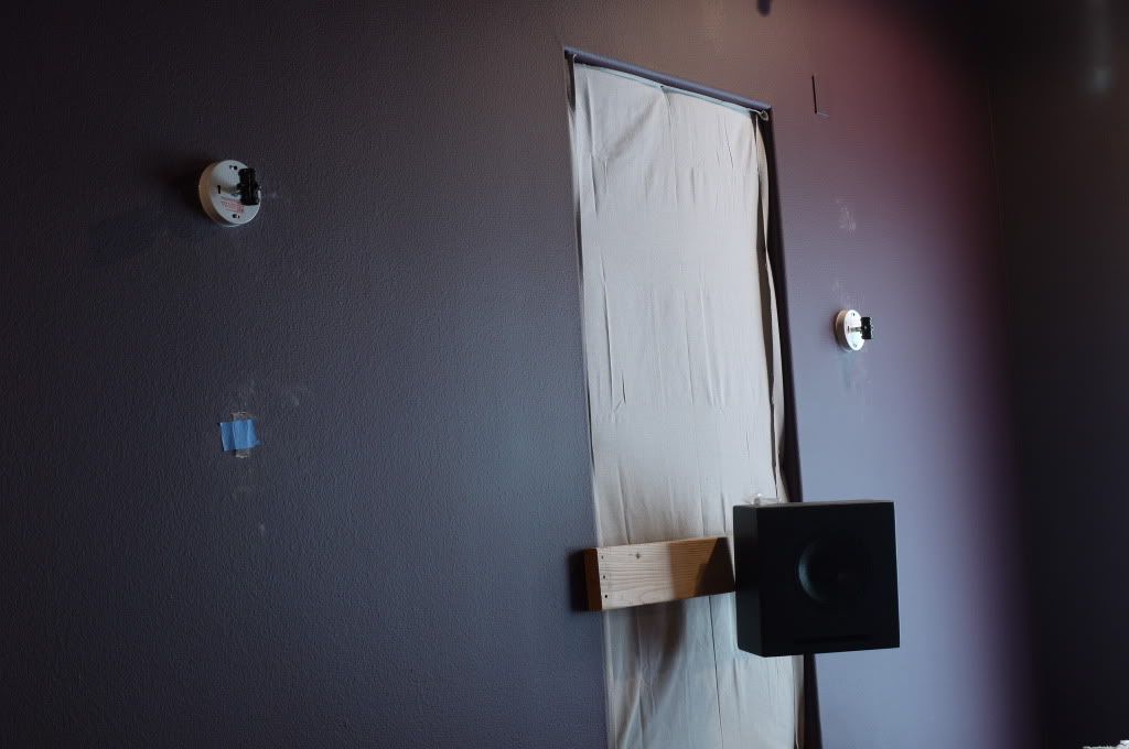

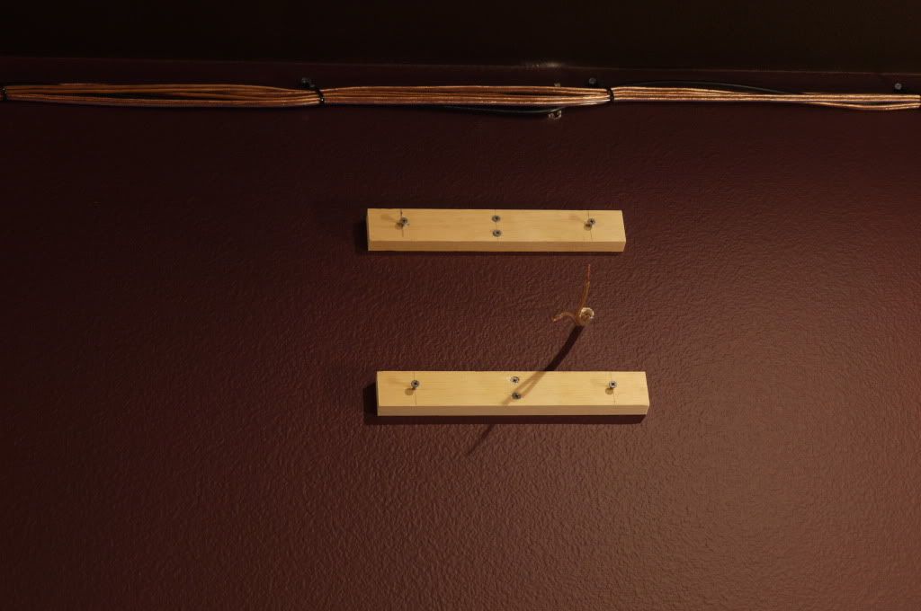

This picture shows one of the challenges I alluded to in the preceding post. I previously mentioned that I have a bathroom door at 50 - 60 degrees to the right of the main listening position; I also have a window at 45 -55 degrees to the left of the MLP. 50 to 60 degrees is the ideal location for the wide speakers in an Audyssey DSX 11.1 arrangement. I shorted the right wide speaker next to the bathroom door to 45 degrees. I wanted to mirror the left wide speaker at 45 degrees.
Solution: Throw a board across the window and mount the speaker to the board. I realize putting the speaker on a stand would have been easier,
but I prefer the speakers to have no visible stands or attachments in this theater. In addition, the walkway by the bathroom door is going to be a little narrow and I don't want guests bumping into or knocking over my wide speaker, so it's securely mounted to a stud in the wall. So, both left and right wide speakers are mounted to the walls creating a bit of visual symmetry.
I intend for the left wide speaker to appear to be floating in front of the drape that will be covering the window.
This picture also shows the wired locations of two of the sconces. Wiring the sconces on this (exterior) wall proved to be a bit of a challenge and some drywall repair will be required.

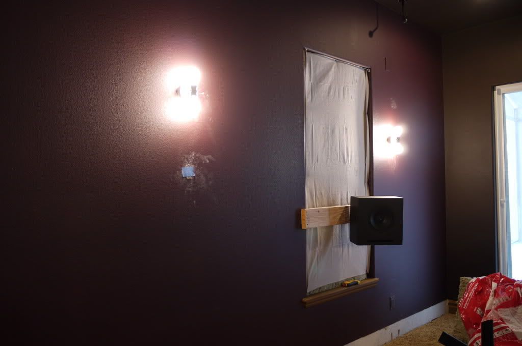

Checking that the lights work.
We chose a fixture with two opposing bulbs. The intention is for the more widely distributed light to more evenly illuminate the sconce that will cover the fixture.

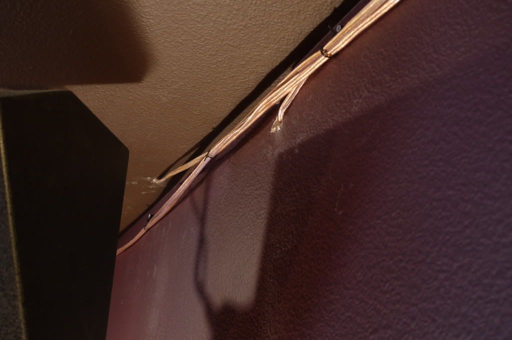

Running speaker wire in-wall and along ceiling/wall corner.
The speaker wire will be covered by crown molding.
I used these to bundle and attach speaker wires to wall.
"Trying is the first step towards failure" - Homer Simpson

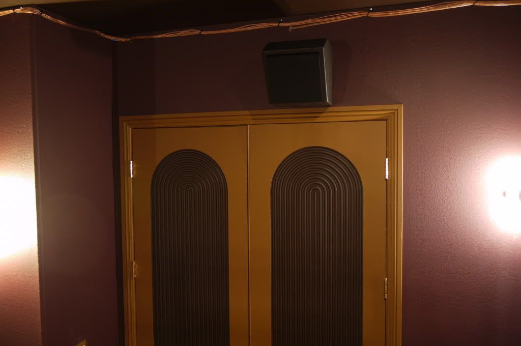

Another obstacle to aural nirvana are my double doors entering the back side of the theater.
To mount the right side surround speaker anywhere near the 90 to 110 degree mark from the MLP, I had to mount the speakers high on the wall (my wife wouldn't let me hang the speaker on the door for visual design reasons - WAF ). The speaker will hang just below the crown molding.
Thankfully, JTR speakers makes surround speakers that already have a 30 degree angle to their drivers. They fire not too far overhead from the main listening position at their mounted locations.
I'm leaving the sconce covers off of the light fixtures for now, they provide loads of light to work by.
I mounted the left side surround over a window directly opposite the right side surround (above the double door). All four side and back surround speakers are at the same height.

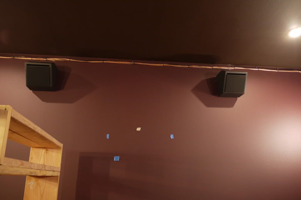

Back surround speakers.
Right, right height, and right wide speakers. The LCR Triple12HTs will all be behind an AT screen and false wall.

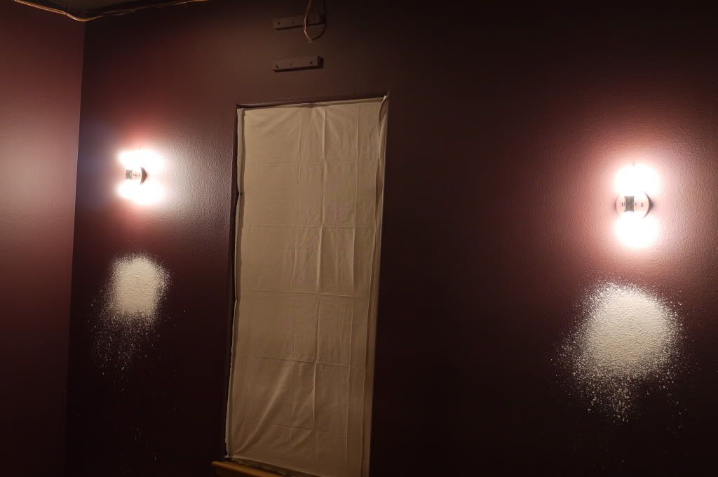

Here's what I meant by more even light distribution/illumination by using a two bulb fixture.
The sconces are 30" long and my electrician friend and I thought it would be best if they had two points of illumination. The photo accentuates a hot spot on the lower half of the sconce that isn't as noticeable in person. I've ordered a Lutron Spacer dimmer to control light levels in the room. There will be 3 zones.
The sconces are authentic Moroccan pieces. My wife and I thought we would go for something a little offbeat and create a Moroccan lounge/Hookha room themed theater.

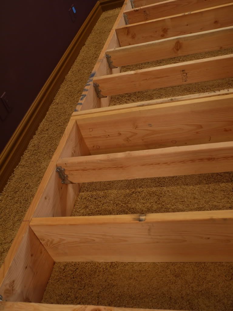

Yesterday, I finished putting back on the baseboards and started patching the drywall in a couple of places where we had to cut into the walls to fish the romex over a horizontal exterior wall support board.
With the baseboards back up, I'm ready to continue work on the riser. The riser is going to be up on rubber isolation mounts, have at least one Earthquake shaker installed (need to test adequacy of just one shaker), stuffed with pink insulation, and will have an LED step light.

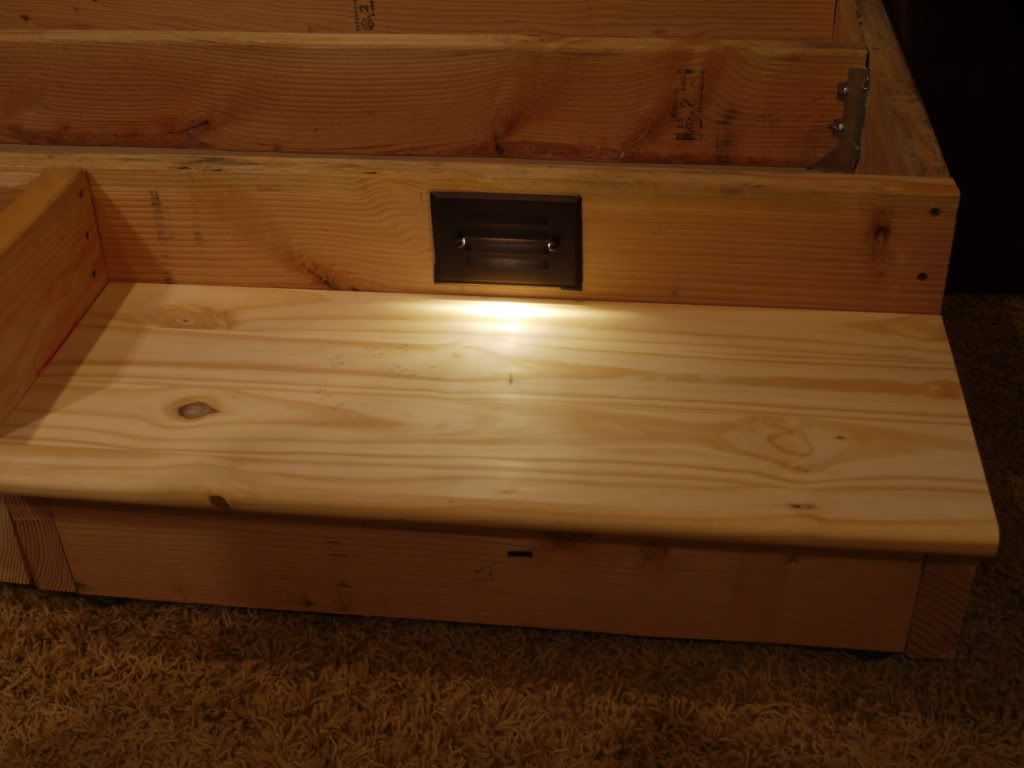

My friend, the electrician, suggested I plug an LED step light into an existing wall outlet and just leave it on all the time (not on a switch). I'm OK with this as long as the light is not too bright. I'm trying to minimize ambient light in the room. The step light will be perpendicular from the screen, so I don't anticipate this being a problem. Thoughts on this?

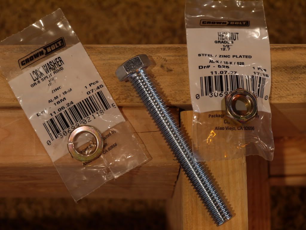

The stands are actually a worktable from Northerntool. http://www.northerntool.com/shop/too...1563_200451563
I think you'll like the price, sub $30, and can supposedly support 1000 lbs. The height has some adjustability, too. Works great for these massive JTR T12s. Hard part is picking up the speakers and putting them on the stands.

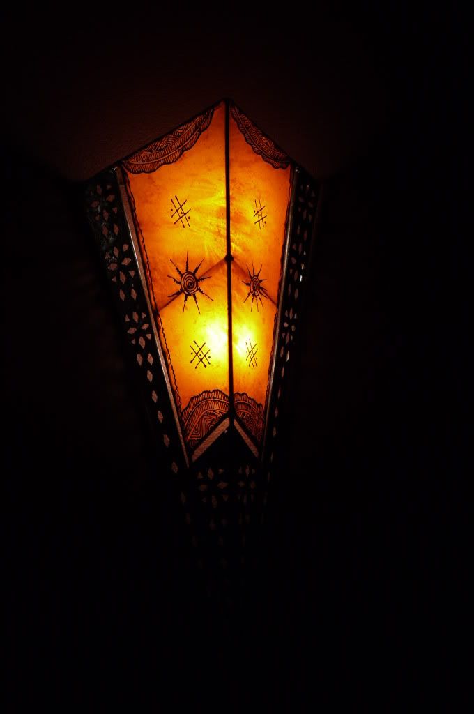

Here's a photo of a sconce that's hanging between the bathroom door and the double doors.
With sconce light on and a spotlight illuminating the wall. The color of the wall and the doors is pretty accurate in this photo, just too much light shining on them.
Another photo with more accurate representation of the color of the sheepskin.
Once I get my Lutron Spacer system up and running, I'll should be able to dial in the lighting ambience.

Repairing wall from sconce install. Spray on texture looks OK. I don't want to do too good of a job, then my wife would have me fixing up walls all over the house.

I had a request on the Official JTR speakers thread for details on the paint I used. Instead of cluttering up that thread, I'm putting it on my own thread. I got my paint from Home Depot. Behr flat paint. It's a matte paint, but I've found it's pretty easy to touch up smudges without damaging the matte appearance.
Here are the colors:
Spice bazaar on baseboards, crown molding, and door trim.
Folklore on side and rear walls.
Sweet Molasses on ceiling and front (screen) wall. Also on central arched portion of doors.
The only reason I put Sweet Molasses on the front wall was because I knew I was going with an AT screen and wanted a very dark wall behind it. I ended up going with a Screen Excellence 4K Enlightor screen that already comes with a black backing, so that color choice didn't matter.

I got an early start on the weekend (which is going to be hectic) and did a little work on the riser.
First, I connected the two halves together using some 1/2" bolts, nuts, and lock washers.
I laid the two halves of the riser side by side.
Another view of the two halves coming together. The two 2 x 12's in the center are the boards I bolted together.
After bolting together, I propped the riser up on it's side to attach fabric and feet. The newly unified riser had gained quite a bit of weight! My back is still feeling that one.
The riser has extra feet at one end to support the step, which is just screwed on to the adjacent platform. I was concerned that with the rest of the platform being suspended, the step might not survive just hanging out there, with no support from below.
After laying the riser back down, to attach an Earthquake Sound Q10B tactile transducer, I noticed that the middle of the platform, near where I had bolted them together, was touching the ground and was not suspended like the rest of the platform. I don't know if it sagged a bit, though it seems sturdy, or if the boards were not straight in the first place, likely, but I need to put some springs or something beneath that section. It's hard to shake a platform that is attached to the wall or floor.

A little more progress.
I've installed a LED step light in the riser. The riser will be 14" tall when finished and the step is 7" high.
I've attached the Earthquake Q10B to the riser. It vibrates the riser, but doesn't really "shake" it. I'm going to have to mess with it a little more. It's being powered by a Behringer EPX4000, so it's getting plenty of power. I'll have to track down some springs for the riser to see if that makes any difference. I may have to order additional Q10B's, but I don't think I will do that before testing the Q10B in conjunction with the Captivators. Since my theater is on the second floor, I may get plenty of shake once I add in the subs. I really want to finish up this riser!
I finished patching and painting the wall. The picture is a little dark; suffice it to say it passed the wife's inspection.

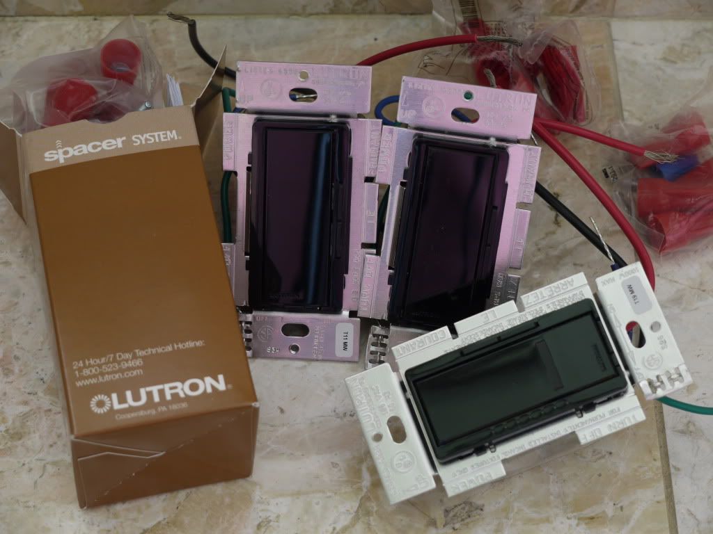

The Lutron Spacer System showed up yesterday afternoon. I'll be installing this today. Not sure why the top two dimmers look pink, must have been a weird reflection. They're silver colored, just like the bottom one.
