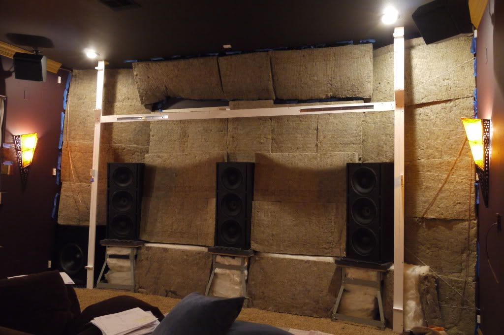

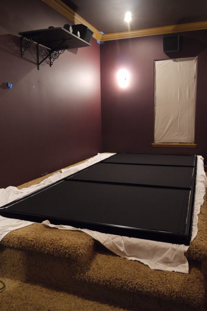

I got the screen fabric installed in the screen frame. The picture below shows the screen lying face down on some sheets on my riser. The Screen Excellence Enlightor4K material comes with a black backing because the screen material is so thin and translucent. When I have the screen mounted on the false wall I'll take some more pictures.
Larry, if you look carefully at the projector shelf you'll see the two 25lbs dumb bells still sitting up there. With the better lighting in this photo, I think you can make out the sturdy center bracket better.
I also finished off the acoustical treatment of the front wall. It's not pretty, but it will all be behind the screen and black velvet panels. May not be easy to make out, but the side wall/front wall corners, ceiling/front wall corner, and floor/front wall corner all have bass traps pretty much along there full lengths. There is loose fluffy insulation behind the Roxul batts.
The JTR T12HTs look happy ensconced in Roxul.

Looking good if you ask me! I'm going to attempt to put the linacoustic up in a neat maner but dont see it looking "good" by any means.
Every time I check in on your build it makes me wonder why I didnt go with the 12s enstead of the 8s!
Haha yes I see the weights. Looks sturdy enough...Just make sure you put a few 1/2" screws in those brackets to hold the 3/4" wood you have being supported by the brackets
Seriously your captivators will rattle that board off in the 1st 20 min of Thor. Also might want to consider trimming an "edge" on that shelf in case the projector walks forward or sideways it'll be blocked by the "edge". Maybe 1" x 1" trimmed around and dressed up with something like this
I really like nose and cove molding, it really makes a great outside corner
I used the nose and cove here just above the corbel and put it upside down so that it shoots out and butts up to the upside down baseboad molding

Oh yeah that might be the greatest screen wall I have ever seen...Looks like 100" thick
Trust me, your back thanks you. I work out pretty regularly with weights, but I still have to stoke myself up everytime before I lift these things up onto their stands.
I didn't really bother with being neat (proof is in the pics), I'm too impatient. Also, I did it by myself and those Roxul batts are a little floppy and tear pretty easily.
The shelf board is connected by a total of 9 screws, so I hope it's not going anywhere. That is a good idea about putting some trim around the edges of the shelf. It would improve both appearance and safety. I'll be putting the projector and screen up this weekend, I'll see what height trim I can use without obstructing the projection. Thanks for the useful suggestions!
I would have it to the height of the feet on the projector. That should be about 1/2" I would guess...and your wife will like it from a design aspect!

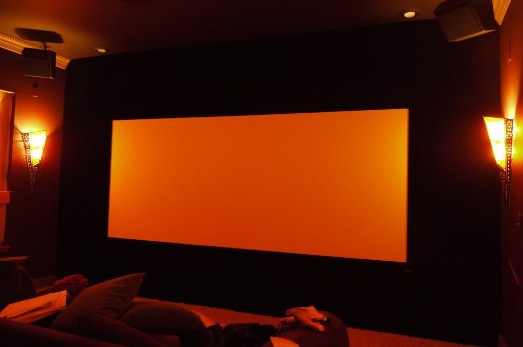

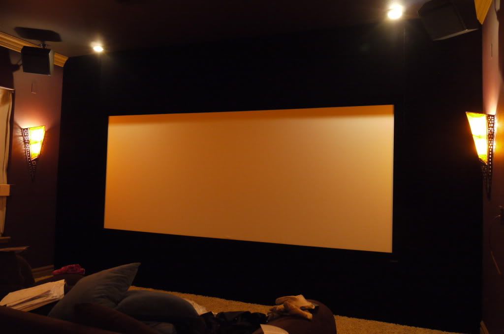

Now you see it....
Now you don't....
and now with some mood lighting....

You are quite the magician
I've been on the fence about this in my theater and it may not even be possible due to my screen size and 16:9 ratio, but have you thought about continuing the crown molding for the screen wall? Should be easy to do by connecting it to your panels and in your case with no stage you can wrap baseboard around the screen wall too
My wife actually suggested extending the crown molding along the screen wall at first, but after I put up the panel frames for a test fit, decided against it. Who knows, maybe she will change her mind.
As far as I'm concerned, I like the effect of a big black void with a screen floating in the center. Nothing to distract from the movie viewing experience.

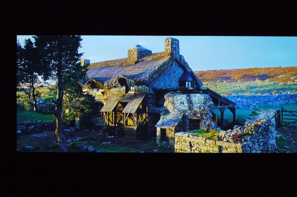

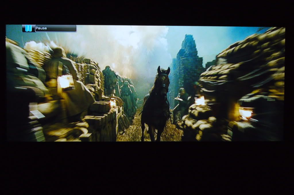

My theater is 90% done. Besides tweaking sound and image, all that's left is mount some cabinets I'm putting on the back wall, buy and hang drapes, buy dark area rug, and touch up paint. I expect to be fiddling with the audio and video for a while though.
We watched our first movie in the theater on Memorial Day. We watched Mission: Impossible - Ghost Protocol. Pretty fun movie. Projector was bright enough and the picture looked really good. The sound was decent. I have a Denon 4311ci and I changed amp assign after running the audyssey set up, so that defeated the audyssey setup and MultEQ wasn't running during the movie. So the sound wasn't as good as it could be. Plenty loud though and the subs were impressive. My girls gave me a with the first explosion.

Here are the requisite screenshots.
"Trying is the first step towards failure" - Homer Simpson
willscam is offline
post #119 of 146 Old 06-08-2012, 11:56 PM
Brad Horstkotte's Avatar
Location: Torrance, CA
Posts: 5,197
Liked: 63
There we go, that's more like it. biggrin.gif Proof positive - or you're very handy with Photoshop!
Brad Horstkotte is offline
post #120 of 146 Old 06-09-2012, 12:58 AM - Thread Starter
willscam's Avatar
Join Date: Aug 2009
Location: Las Vegas
Posts: 365
Hey, it's not easy taking pictures in a dark room with a bright subject!
I was using my Dune Smart D1 streamer for these shots and I'm still not convinced it's as clean as my OPPO, but it's pretty good.
I actually think my theater would benefit from 4K at my screen size and viewing distance.
