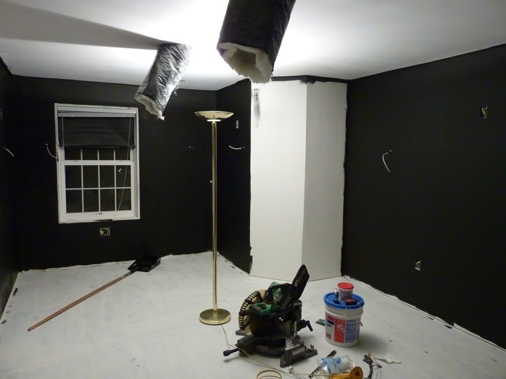

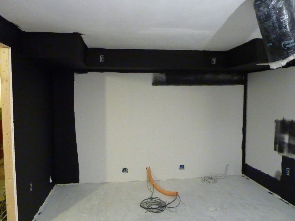

Hmmm...that tire swing looks interesting! I will post some pics later of the space...but if you want to see it faster, follow the link to my build thread.
No attic space, it is in the basement.
EDIT: Pictures of the space:
Here are two that show the distances a little better, but they are older pics:
cybrsage is offline
