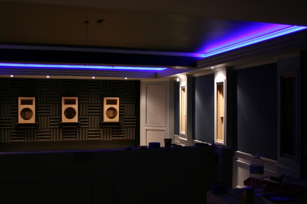

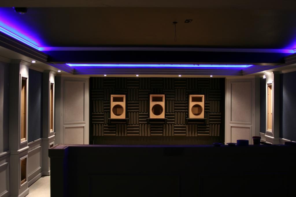

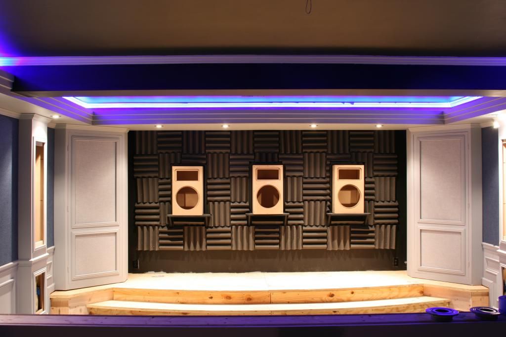

got 99% of the theater area painted the color we choose was Benjamin Moore "sweatshirt grey"
here is the sample ....
took me a little over two days to do two coats .. second coat i added Flotrol that way it gave me more time to work with the paint and with that along with a nice fine brush the virtually no brush lines at all very happy with the end result .
i still need to paint the crown molding above the stage ....... note to self next time PAINT THE CROWN BEFORE NAILING IT UP........ live and learn frown.gif also need to paint the back of the riser .

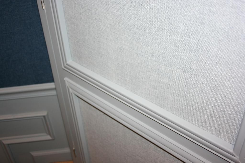

once everything was dry my shipment of fabric came in so i was anxious to see how the well color matched so i started with the cabinets on the stage ..
and the finished product

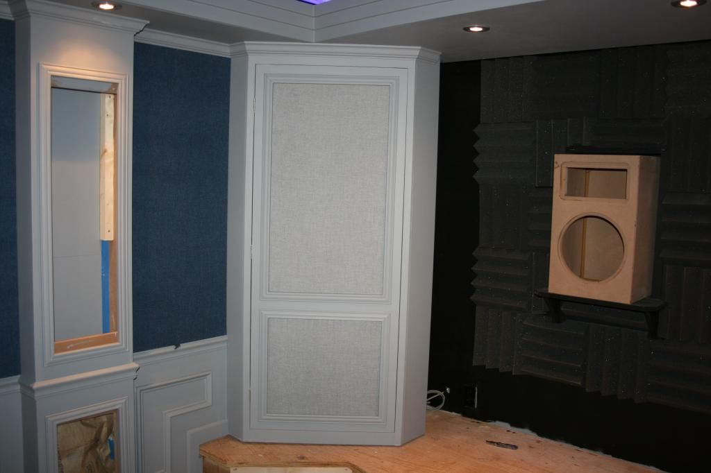

got the fabric panels in the lower part of the columns ... these where built just like i built the fabrick panels for the rest of the room just 1x2's put together with the kregg jig.
the the fabric color i choose for front cabinets and the columns is Bleu Papier i am so happy with how well it matches the sweatshirt grey BM paint and it really makes the baltic blue fabric panels pop

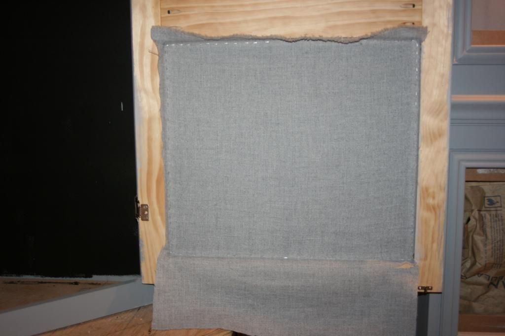

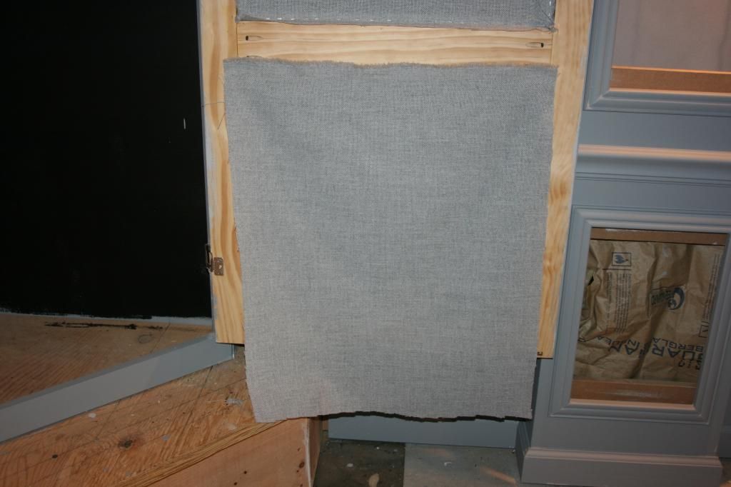

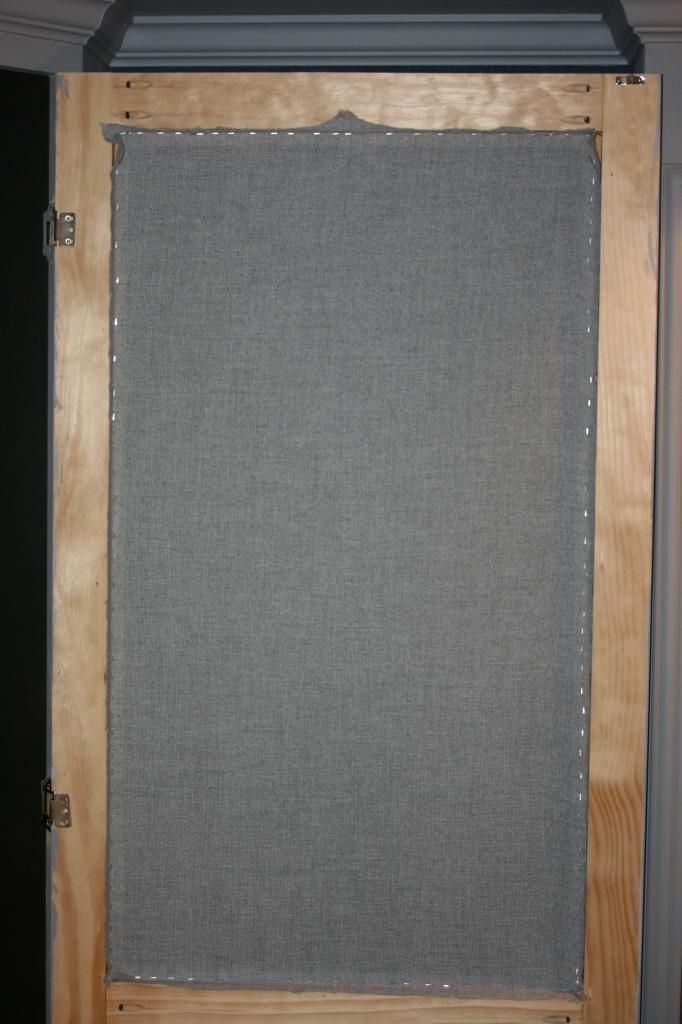

started on the fabric speaker panels in the columns
i ordered 6 replacement kits from parts express
these are friction fit and i also used small magnets in all four corners
then i used hot glue to attach the fabric to the panel and test fitted
