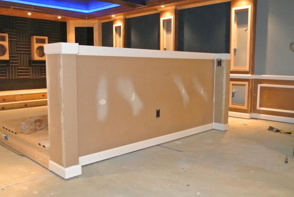

the columns, the light trey, and 90% of what you see in the pics was 3/4 MDF parts of the Light trey is 1/2 MDF
the fabric for the upper part of the walls was GOM the color is Baltic blue
http://www.fabricmatestore.com/p-393-fr701-baltic.aspx
The columns and the cabinets on the stage are also GOM the color is Bleu Papier
http://www.fabricmatestore.com/p-443...eu-papier.aspx
There was no Cardboard used
here is Raw pic of the all the MDF that was used ...every thing that looks like Carboard is MDF.

Originally Posted by SteveFred View Post
Very nice build!! What do you use to fill in the seams on MDF? I am just about to build my ceiling(inside soffit tic tac toe style)using 3/4" MDF and would need to make the seams smooth if possible before I spray paint/paint them. Thx!
Thanks!!
i just used a sand able wood filler, and then sand and sealer over all the MDF because if not it will soak up the paint like a sponge.
