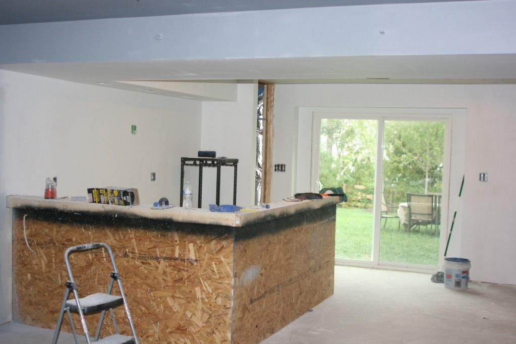

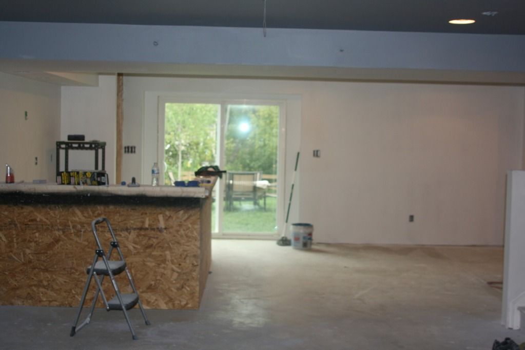

drywall guys finished the sanding today ...picked up the primer tonight and tomorrow will be spent cleaning up the floors and whipping down the walls before priming ....
drywall guys took longer then i thought/was told..... and they sorta complained a awful lot about how hard they worked all day on there day jobs so i really did not feel bad having them treated all the theater walls as if they where not going to covered with with fabric smile.gif .... they sorta annoyed me a little ...they did great work no doubt but with that came a little much complaining ....o well the stage of the game is done ...looking forward to moving onto the finishing stages

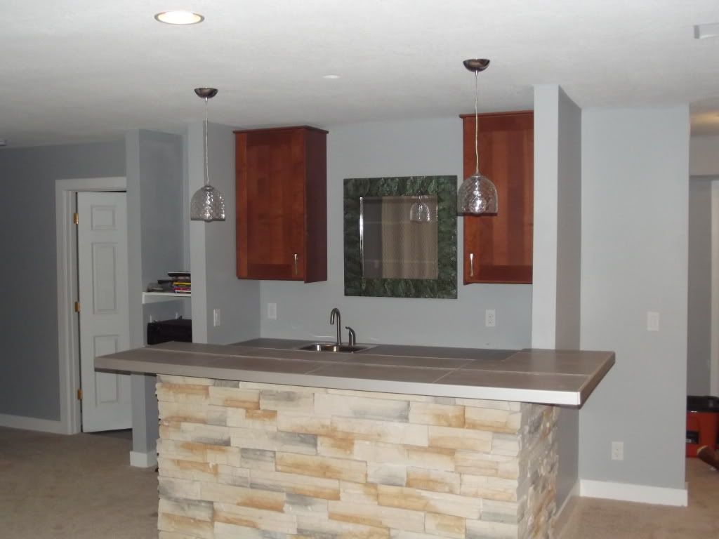

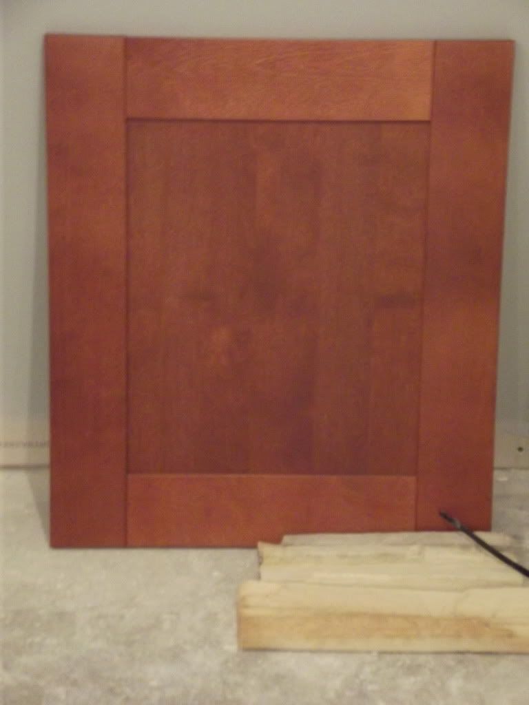

Originally Posted by snickers1 View Post
need some opinions on colors , the carpet is silver lake house of jewels, cabinets are Sturbridge (red birch) and the laminate for the bar area is a black slate
I like the colors. I have to say my cabinets look a lot like yours, and I bought them at Ikea. Very good quality for the money and get lots of compliments on them. Perhaps it might save you money (or not). One other thing, tile is cheap if you lay it yourself and I think it would add value to your room vs laminate flooring. I like the look of your laminate but would recommend considering tile. I layed all the tile in my bar area in just a few hours.
Here is a pic I took during my build:
thanks for the tip i will look into tiling over laminate ...... i looked at ikea but it seems to not be very common to find a microwave base cabinet so will be ordering RTA cabs from here
http://www.kabinetking.com/js-international-cabinets-sturbridge-kitchen-cabinets.html

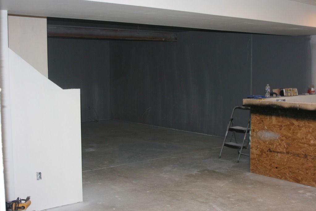

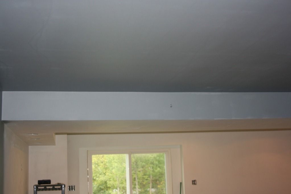

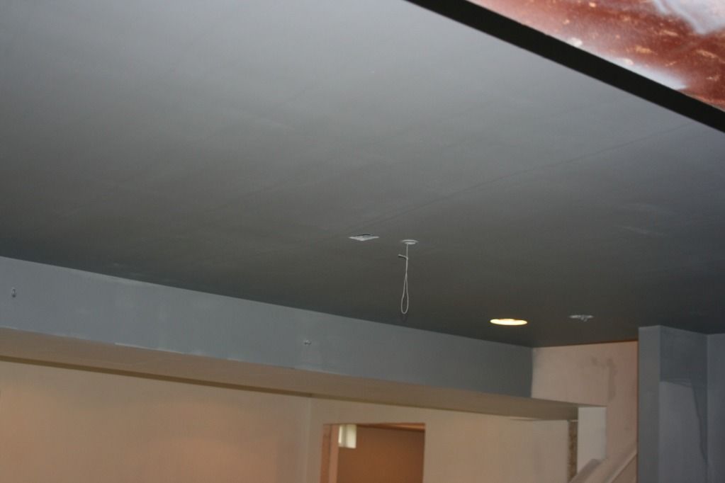

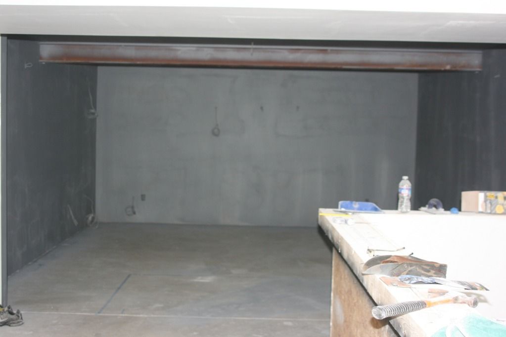

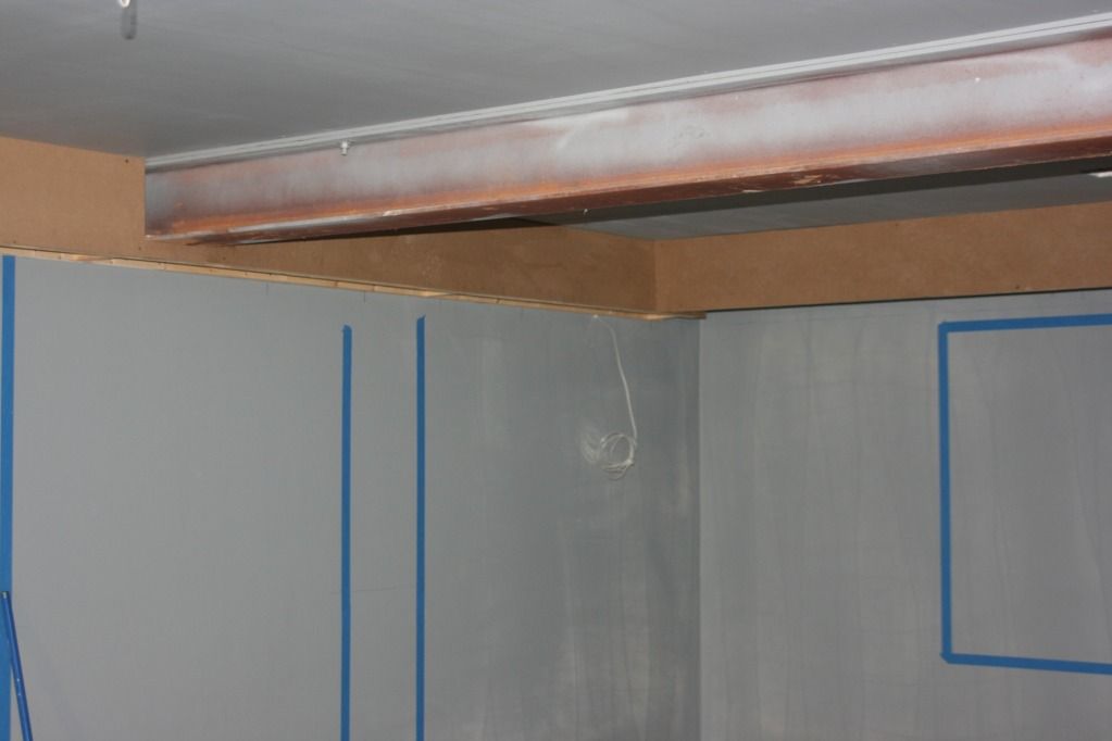

got to priming this weekend the walls in the theater really didn't need to be primed because they will be covered with wall treatments
snickers1 is offline

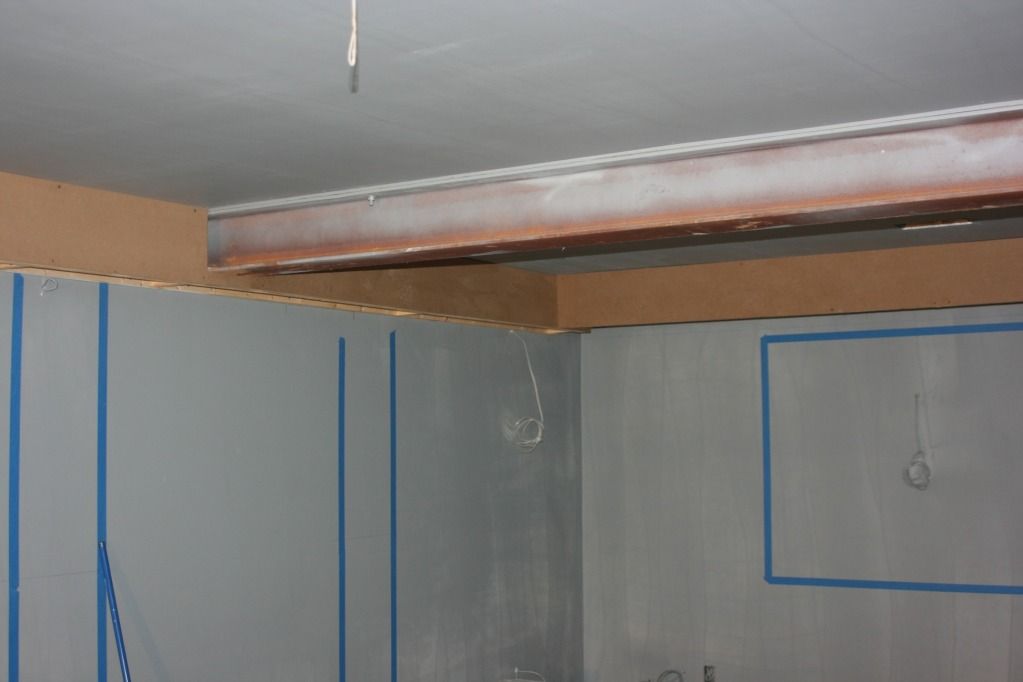

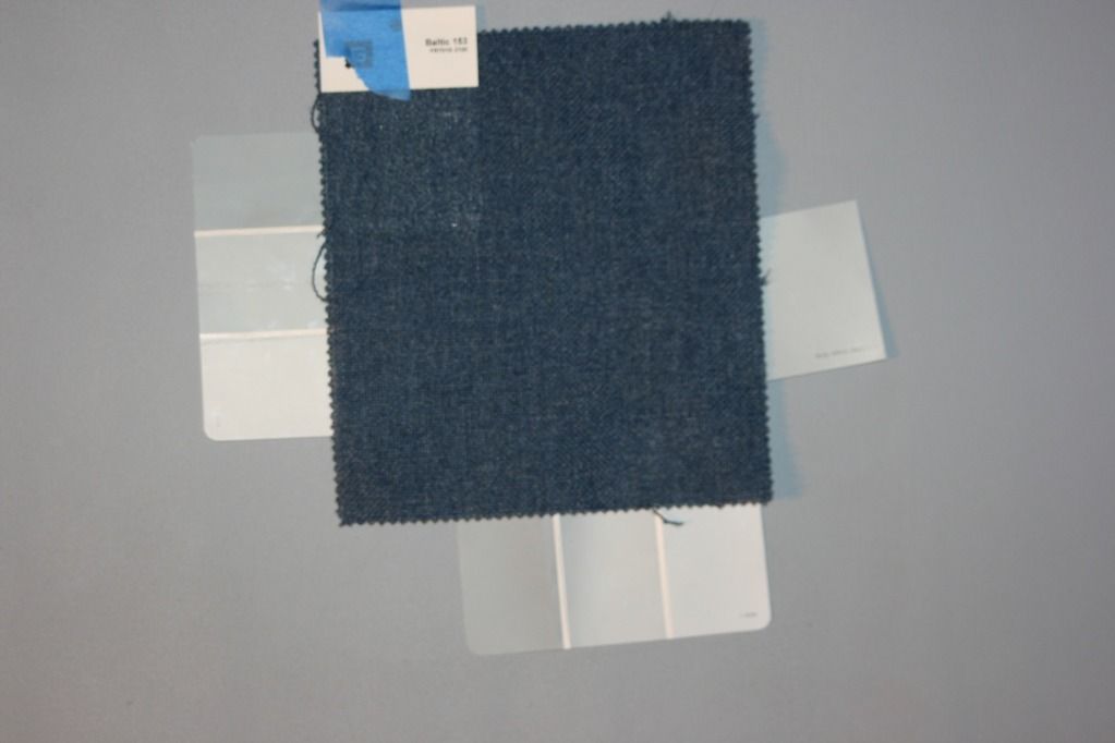

trying to nail down the colors
theater area tops all walls will be the baltic blue tom
bottom half of wall will be mdf and shadow box and columns will be done very similar to cimemars but will the lower middle grey also the soffit will be the same color and
have not decided if i want the ceiling to be black or a dark grey ...looking for any opinions ??
bar area and game room colors , walls the middle grey and ceiling the top lighter grey the whole room will have crown molding maybe light grey or even white again opinions are welcome

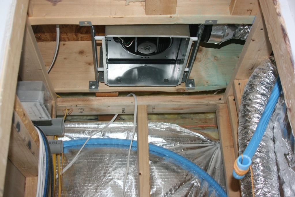

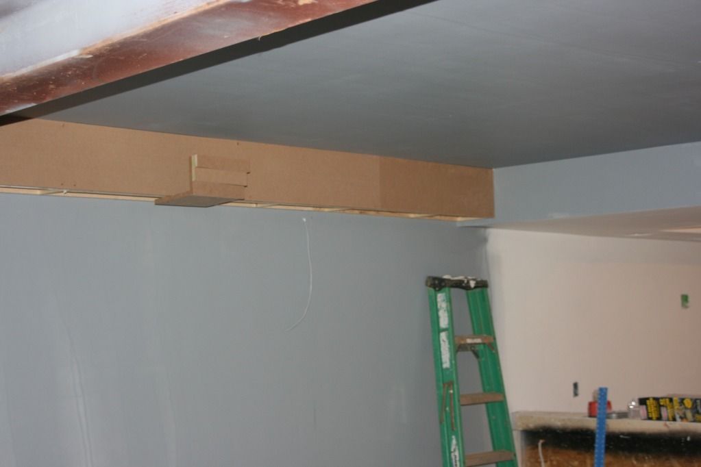

also got the fan mounted int he equipment closet

Darker the better for the ceiling, but I have to say I like the look of the dark grey. You are making great progress, keep it up!

I would go black for the ceiling.. or perhaps a dark blue. Since your walls are blue, I think you could swing either one.
Check this:
Benjamin Moore "Old Navy"
It's way darker in the fan deck. If you follow the link to the BM site it also pairs with a couple of grays.
Tim

wow didn't even think of that but i really like that defiantly going to get a color chip of that thank you

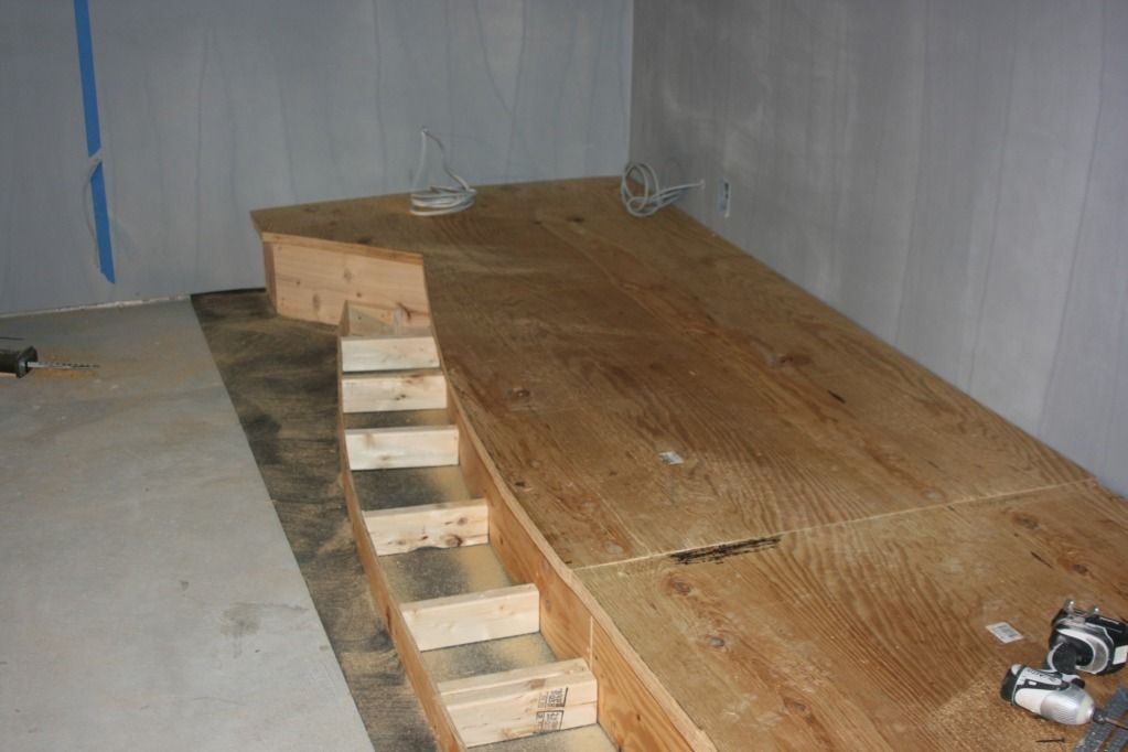

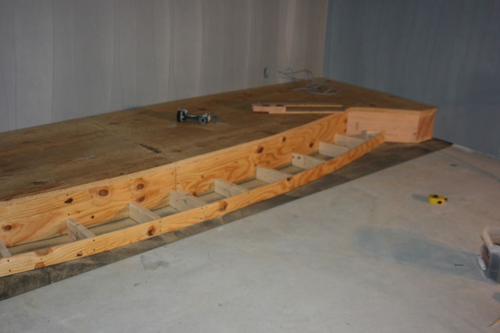

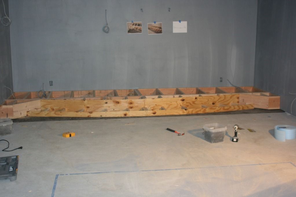

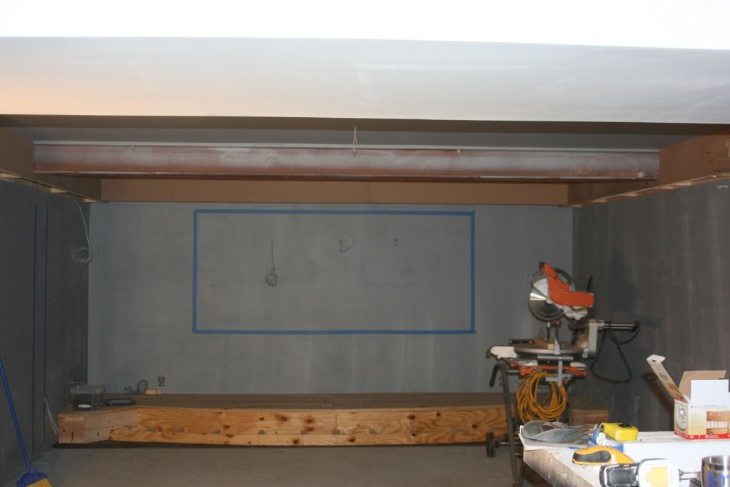

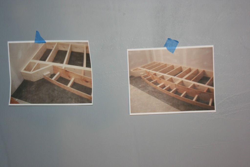

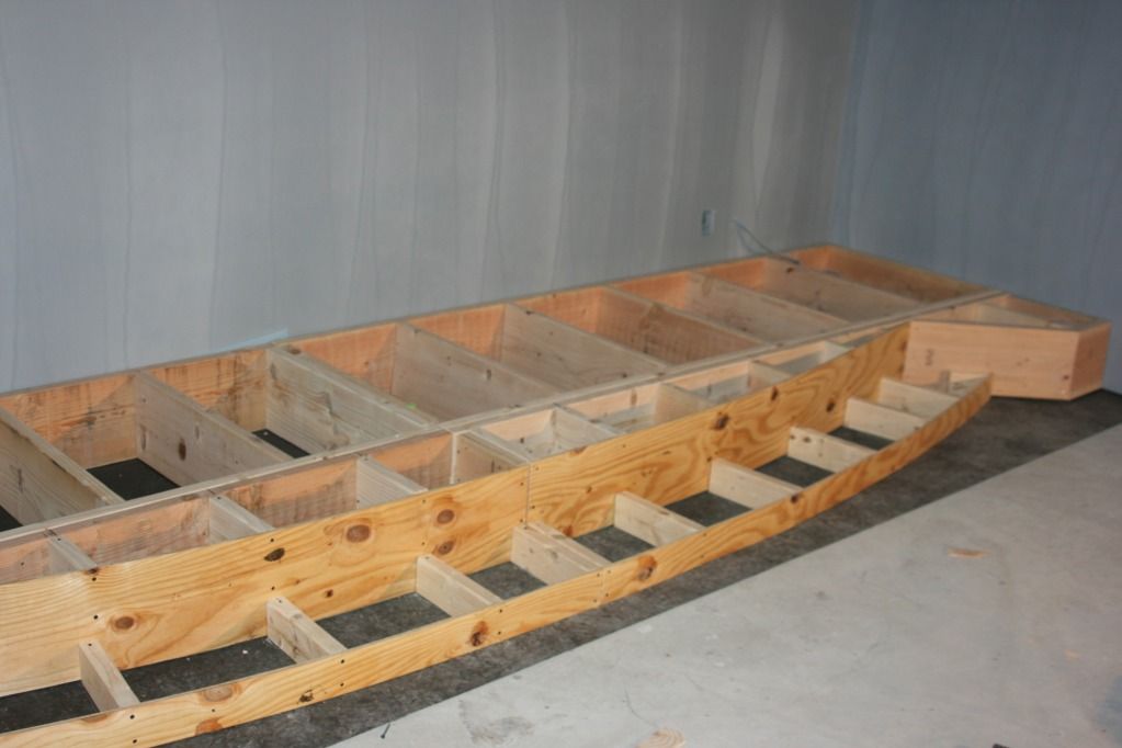

decided it was time to make this room look like a theater ...time to build a stage
thanks to the bacon Race and Cinemar for such great detail in there stages smile.gif and how could not thank Big more on that later
we laid down thirty pound roofing felt and then framed the stage with 2x 10's

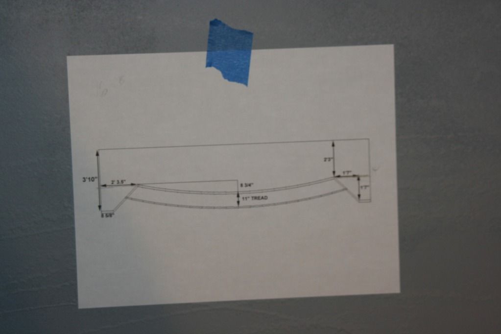

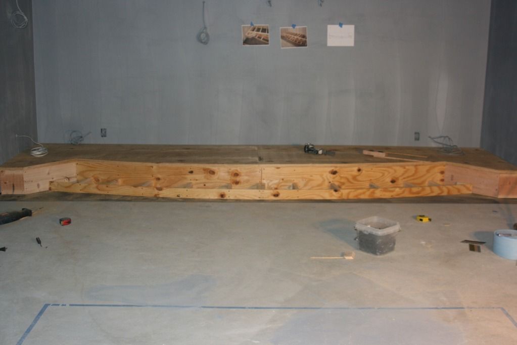

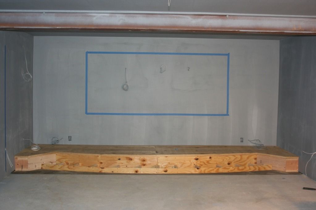

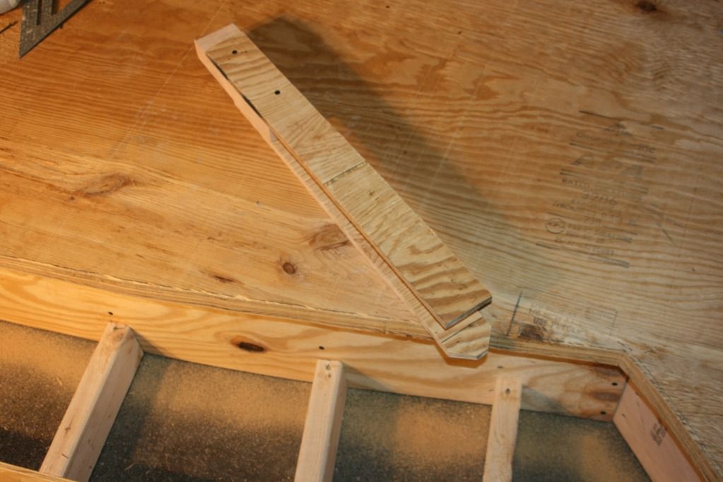

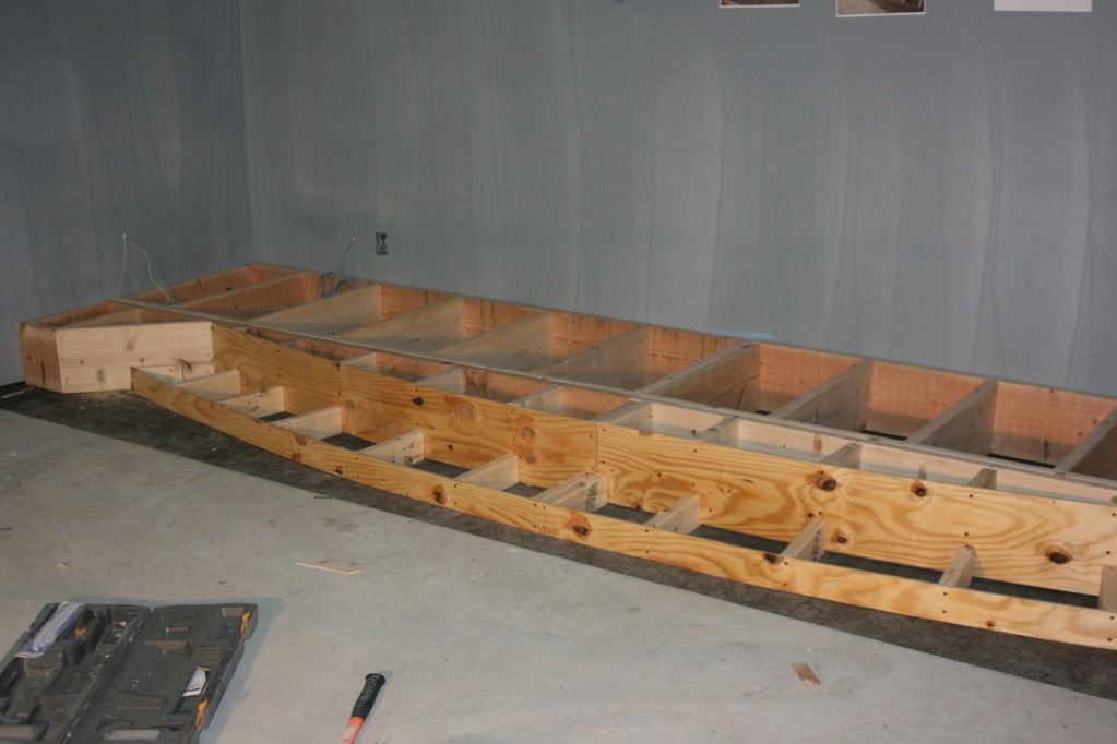

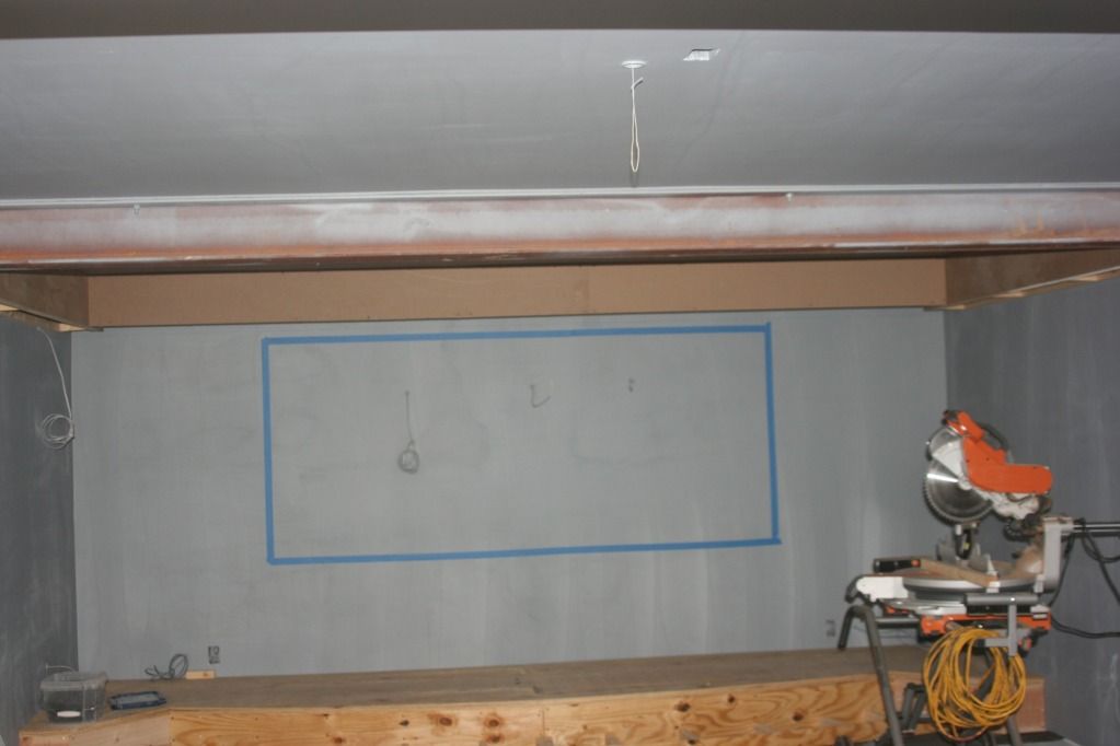

next came two layers of 5/8 plywood
thanks big for the great idea on the jig plan
ran out of plywood for the bottom step
and coarse the tape goes up to see what is will look like with the screen
4AlexF likes this.

The stage looks great!
What screen size are you going with. Your last picture makes it seem like you could go bigger.
have not decided yet either 115 or 120 leaning towards the 115 only because of where the first of seating will land but will see smile.gif

Excellent work on the stage! Have fun with the sand.
I know!!! going to need 50 or so bags ... the stage is not as big as one you built for the bacon race and he used i think 70 + bags
that little jig you showed us for making the final round cuts works perfectly made it so easy
Do you plan to fill every cavity under the plywood you have cut or just the large rectangular ones??

i will be removing the plywood to fill the stage with sand the whole thing will be filled except the first step that will be insulation

so today was a tough decision 1. pick up the sand and fill the stage 2. start the soffit hmmmm this was a tuff one to decide
the soffit design is pretty much the same as the bacon race ... this was the first theater build i followed and really wanted to incorporate some the designs used and the soffit is simple yet very nice looking
i will be making slight change to the design more on that in later post ....
the soffit is 10 inch tall the light tray will come out a additional 6 inches to accommodate three inch lights and blue rope light
her is the mock up the light tray the moldings will be rounded off with a rotor
will make the light tray above the stage rounded to match the curve of the stage
i was going to make the center beam just like the soffit with light trays on either side of but decided it would make the room look like two separate rooms so now i am just going box it in just like you normally would and paint the same color as the ceiling to make it sorta disappear
