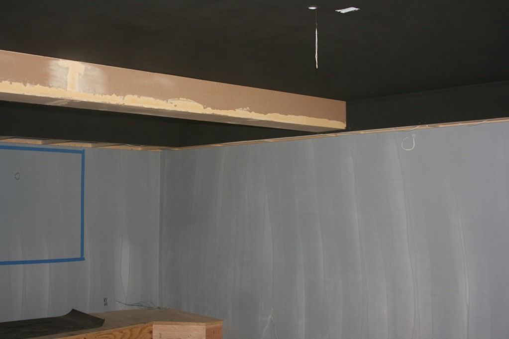

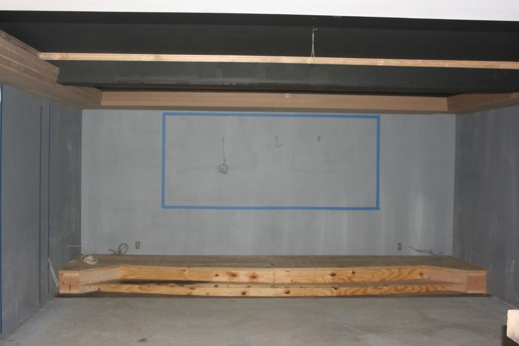

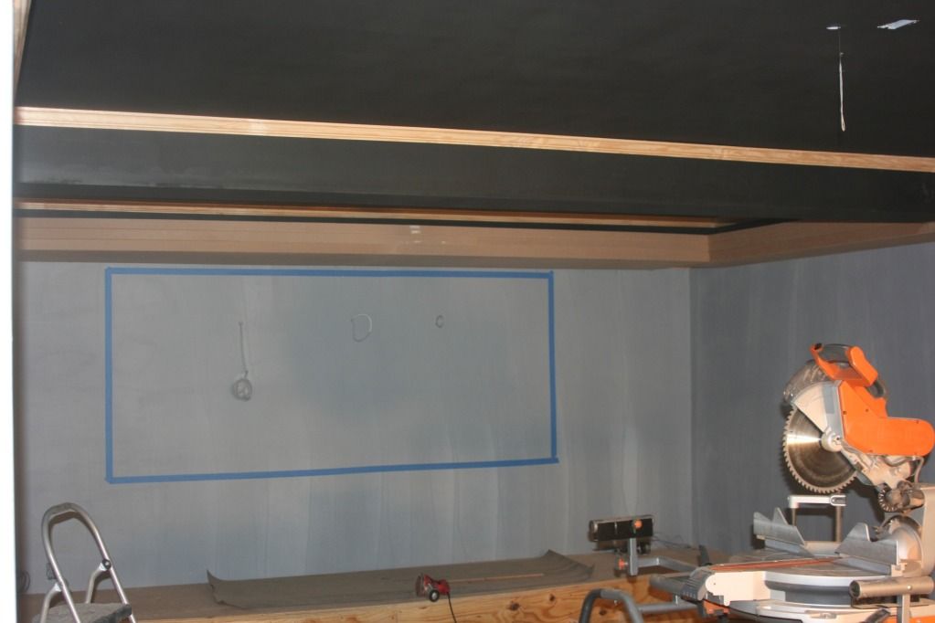

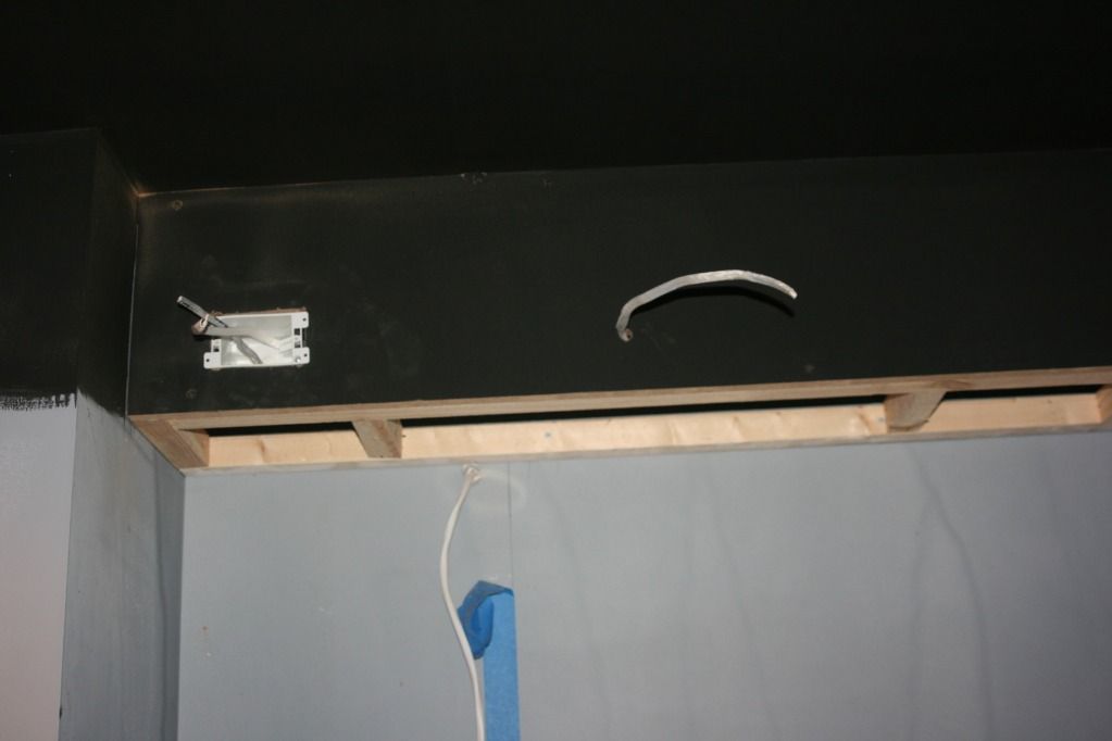

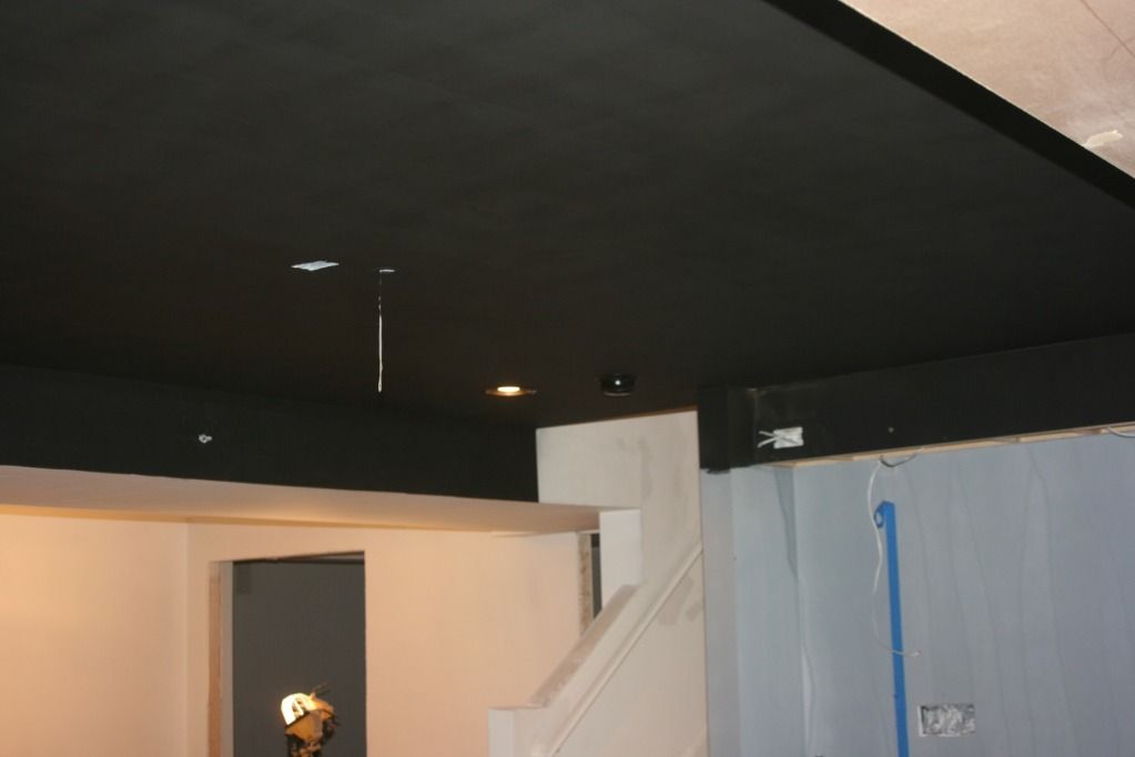

got a coat of paint on the ceiling and the soffit and finally finished boxing in the beam the runs across the room
snickers1 is offline
post #130 of 612 Old 09-23-2012, 07:25 PM - Thread Starter
CEO FALCON SCREENS
snickers1's Avatar
Location: Northern Virginia
Posts: 921
Mentioned: 13 Post(s)
Quoted: 81 Post(s)
Liked: 126

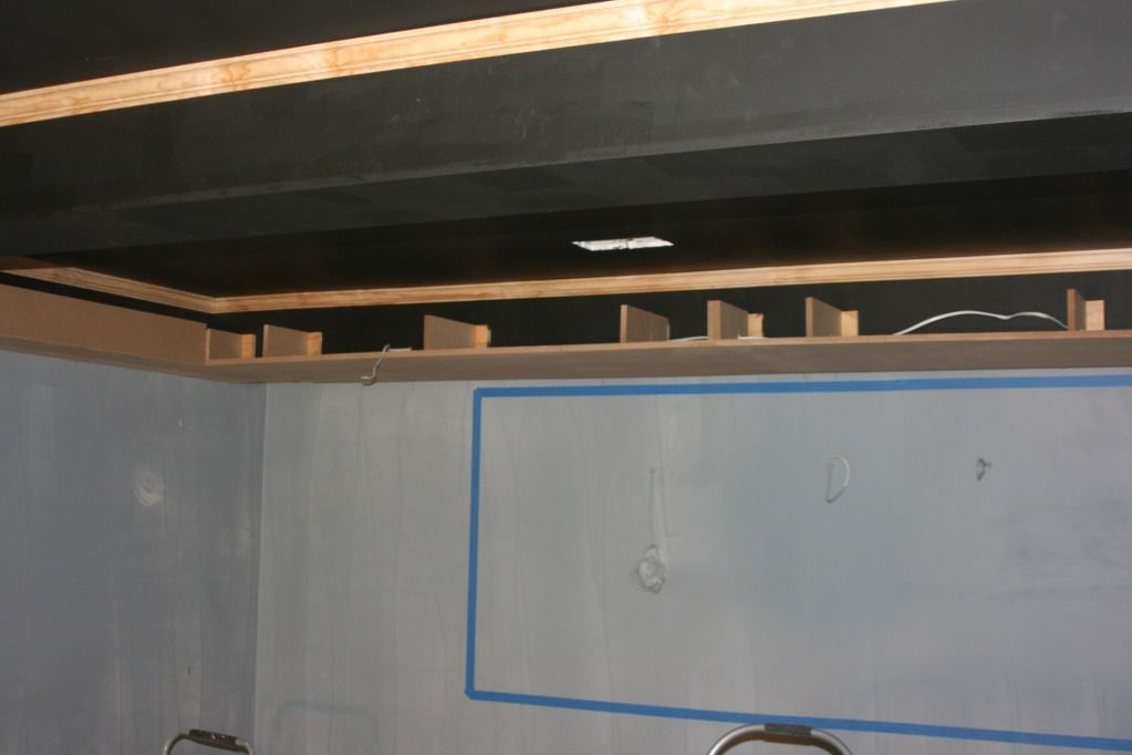

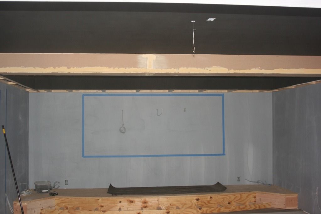

you can the see ceiling still needs a second coat of paint
also got the one the outlet boxes for the soffit led lights
the other wire will be for the 3" can lights that will go around the perimeter of the room
i wanted to get the light trays done this weekend but got caught with family activities

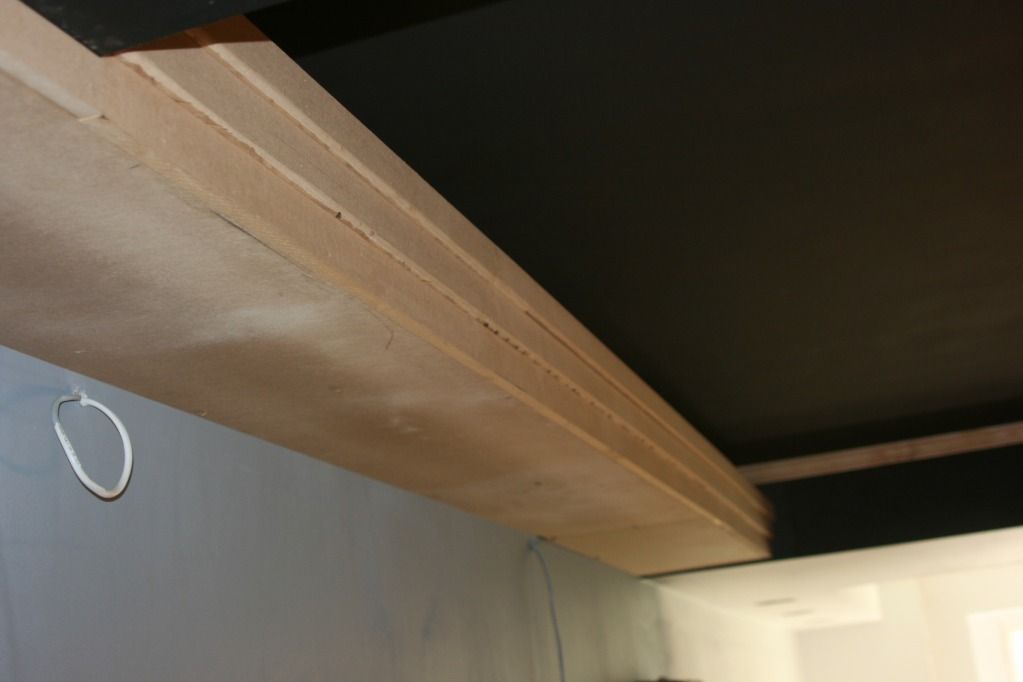

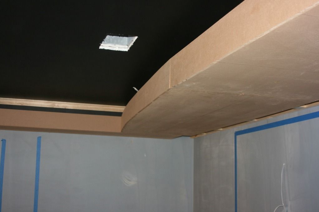

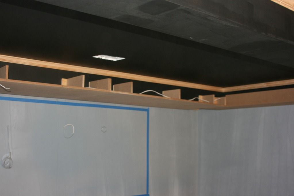

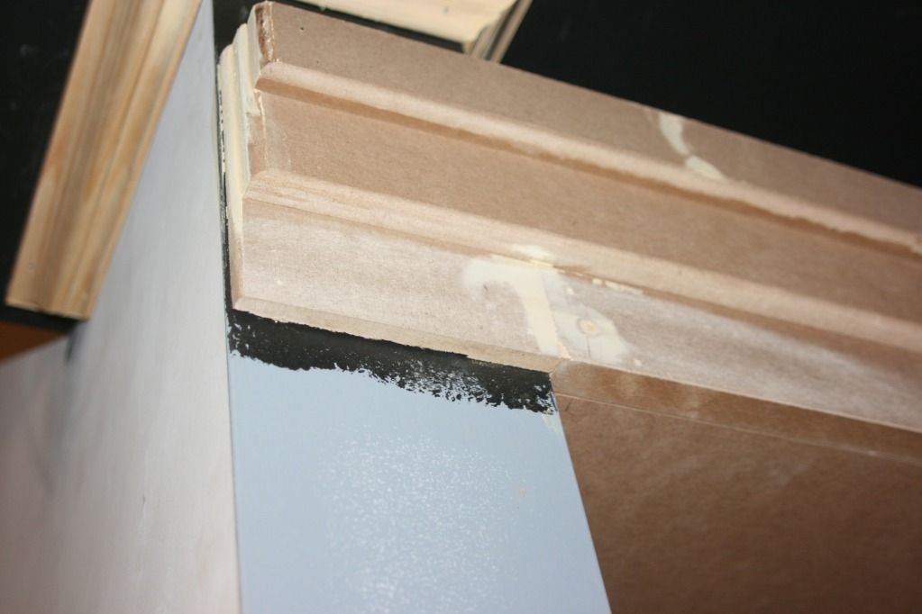

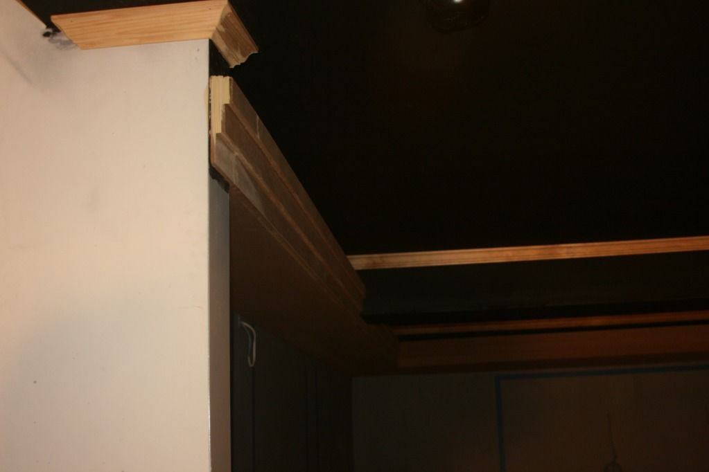

a little grown and a some lights trays makes for a productive weekend
started the weekend with a mission and that was to finish the lights trays, my inspiration was combo of the bacon race and the ohio build, bacon race was the very first build i followed when i joined AVS, and Big was fist person i met here and have spent a small amount time getting to know and have loved each of builds, i have also drawn inspiration from cinimar, as i start to work on the columns and walls treatments that will be more obvious.
so we stated with putting up two inch crown molding two reasons it hides the screws in the soffit so less putty work, also it makes for nice accent when the led strips lights go in (preview of that later in the post)
crown will quickly let you know how straight your walls are luckily it went up fast so yo be the judge smile.gif..... i wanted to get primed crown but lowes was out, and as i walked into home depot there was a guy there that bought the last 100, pieces
so at this point i was tired of driving around to un primed i went with.

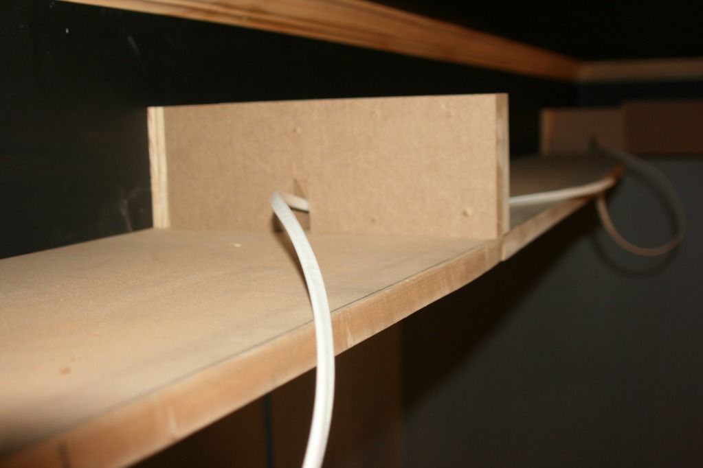

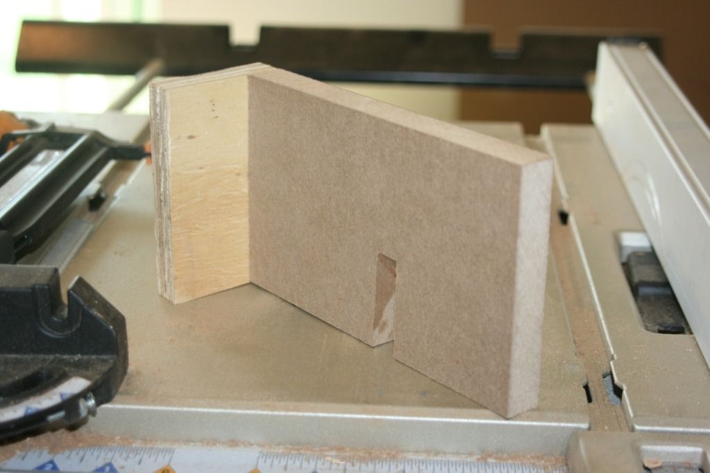

next we started the light trays these where made from 3/4 mdf cut at 6 inches, first we made the blocking to secure the front the trays to
i made a notch in to pass the wires through
post #132 of 612 Old 09-30-2012, 06:21 PM - Thread Starter
CEO FALCON SCREENS
snickers1's Avatar
Posts: 921
Quoted: 81 Post(s)
Liked: 126

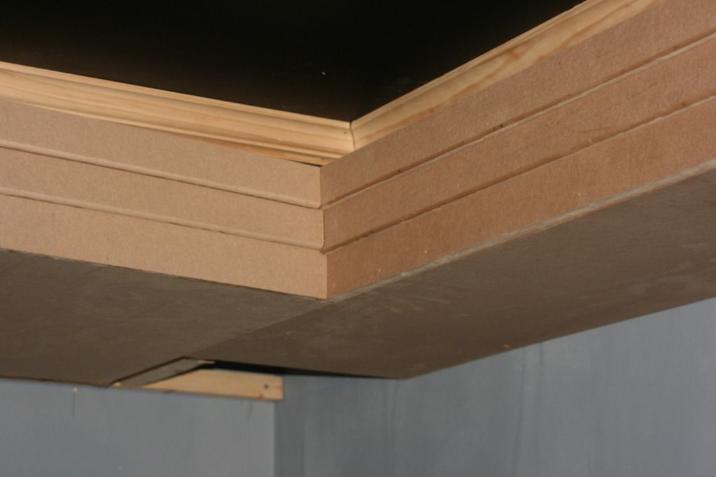

next came the 6 inch mdf i used 3/4 for the all the straight pieces and 1/2 inch mdf for the curve above the stage
next i just like the bacon race i cut 4 inch strips and 2 inch strips and then ran through the rotor to round the edges, took about 30 minutes to get the rotor table setup the way i wanted so the rounded edge was just right
ran into a trick part the light tray went out past the all by 3/4 inch so i did something that was boderline dangerous i took a piece of 1/2 mdf and ripped to thin it out this did not make the table saw happy at all
4AlexF likes this.

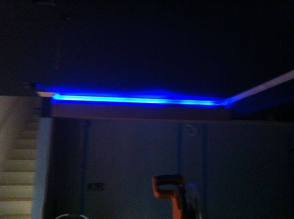

next will be installing the 3 inch lights into the trays and above the stage,
and the blue lights that i got from http://www.hitlights.com/led-strip-lights/indoor-led-strip-light.html
and of coarse i had to test just to get a slight preview i just tossed them up there to get idea and took a crappy pic with my iphone

everything, I did a sample piece with and without to convince Damelon for the need.
oh wow so put coat of sanding sealer on the whole tray then lightly sand then prime then paint

I had pretty good results using dark tinted drywall primer that I had sitting around. This was mainly on the face and not cut edges. I did have one location that I tested it on that had cut edges and it seemed to do reasonably well. I never went back to sand it because it won't be seen but I'm considering trying the drywall primer once I finish my soffit work. One note, I did give the drywall primer a really light sanding on the face surfaces after it dryed and came out nice and smooth.

Light tray looks awesome. Really like that [borrowed] design.
I would definitely coat the entire thing with sanding sealer. In my experience, the edges require a lot of paint to get them looking nice. On some of my edges I just took filler on my finger and rubbed it into the edge. Sand when dry.
Also pay attention to the seams where you have flat pieces butted together. I had pieces joined [what I thought was] perfectly flat, but when I painted them the seams were clearly visible. If I were doing it again I would put filler over the joint and feather it out 2 or 3 inches in either side.
Keep us posted on the Main Lobby progress. Of course what Mario can do is amazing, but I'd like to see what the average Joe can do with a little help from Cinemar support..

thanks yes it is borrowed but i really like the work big did, his along with Mario's work has been very inspiring
i will either puddy the seams or do like some have done when making speaker boxes out mdf and that is user automotive bondo
i will defiantly as big recommended i tested and it does look much better that way

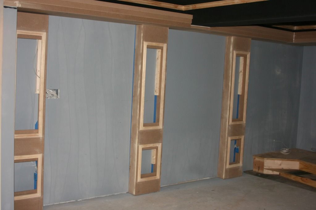

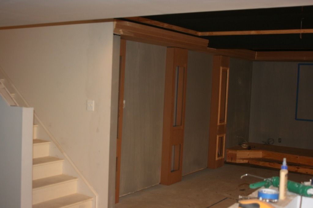

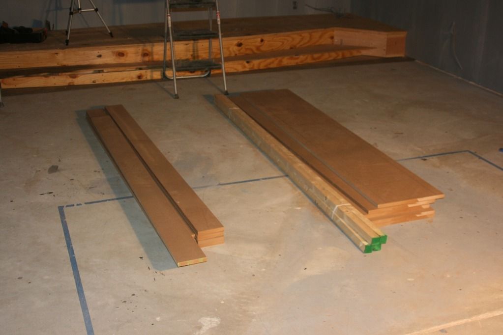

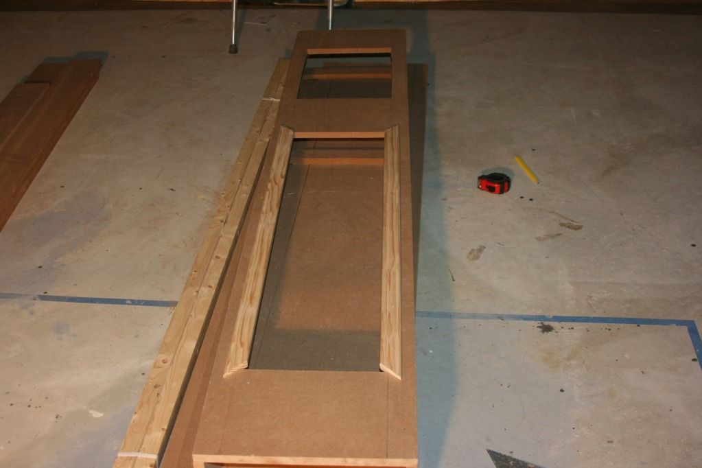

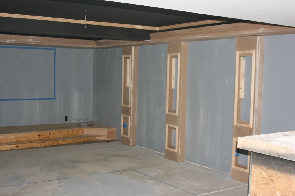

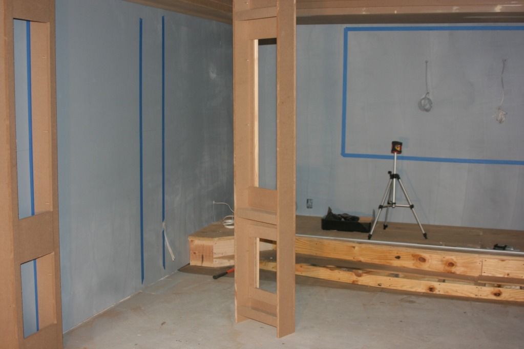

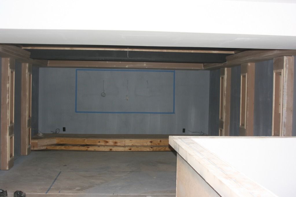

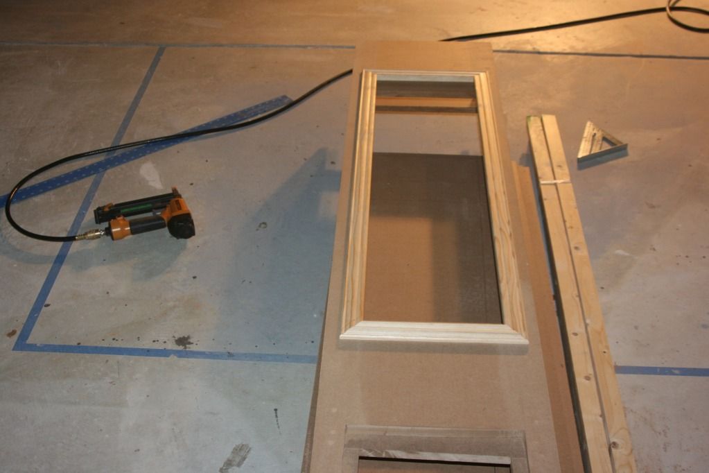

its all about columns .... started the weekend out by making my weekly trip to lowe's to pick some more mdf and had them cut 6 pices at 15 1/2 wide... also picked up a new jig saw, kregg jig, and straight edge eek.gif
pile of columns begging to be assembled

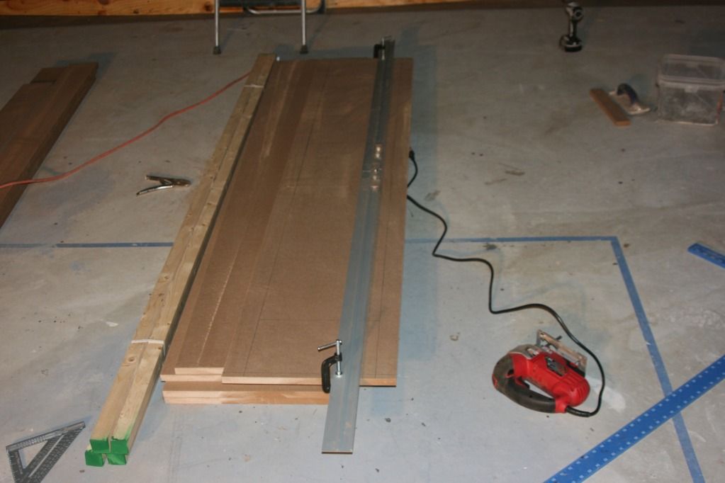

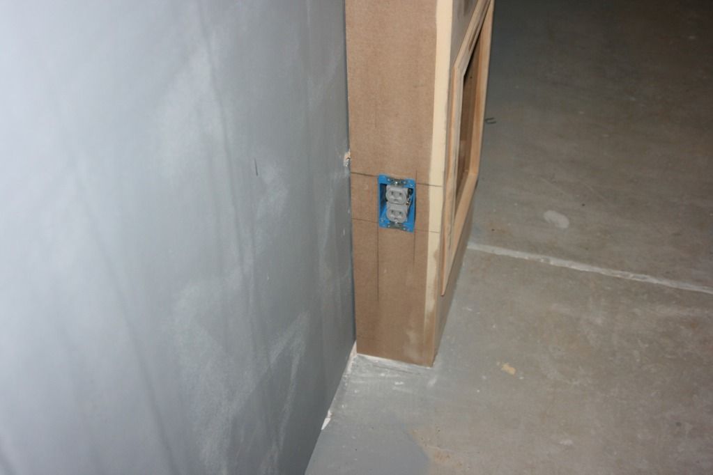

after laying out the design it was time to break out the new toys .... at this point i remembered the the drywall crew broke both my saw horses.... cool.gif
i was going to use my black and decker jig saw but i could not even get a straight a cut with the a straight edge... the new skill saw was is so much nicer and the laser line is accurate and works great
6 fronts cut
post #142 of 612 Old 10-07-2012, 05:41 PM - Thread Starter
CEO FALCON SCREENS
snickers1's Avatar
Posts: 921
Quoted: 81 Post(s)
Liked: 126

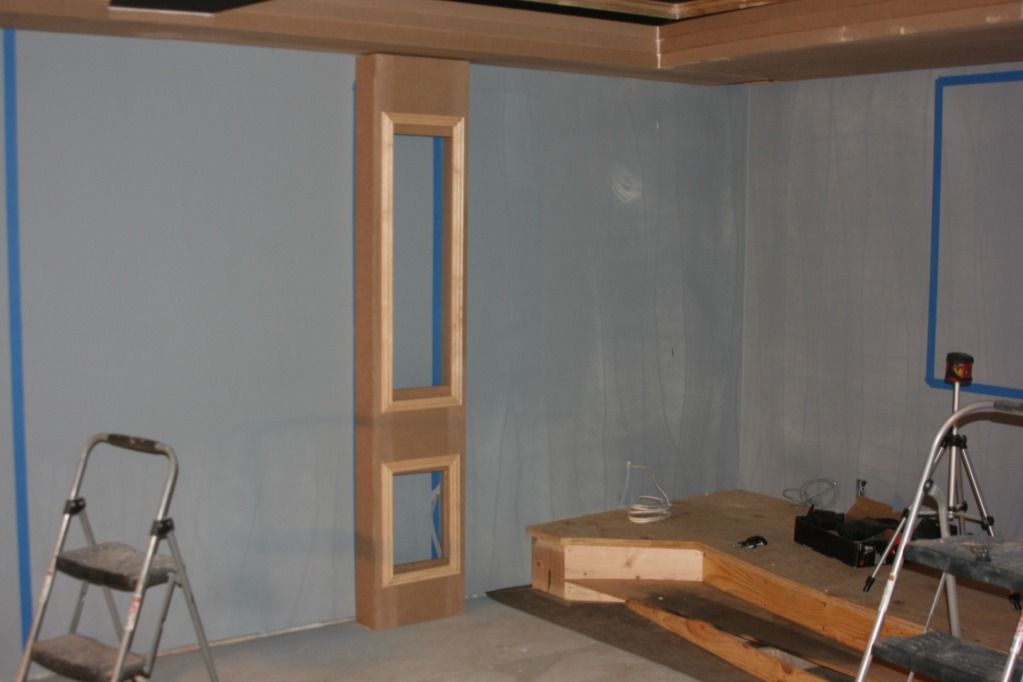

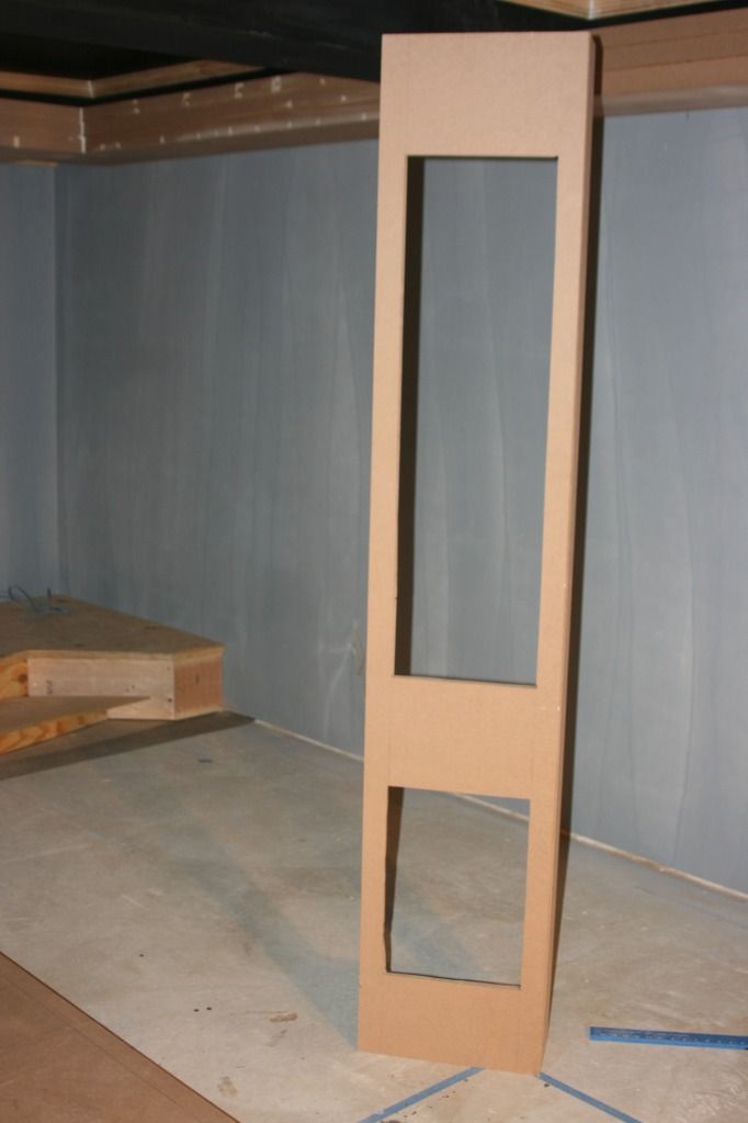

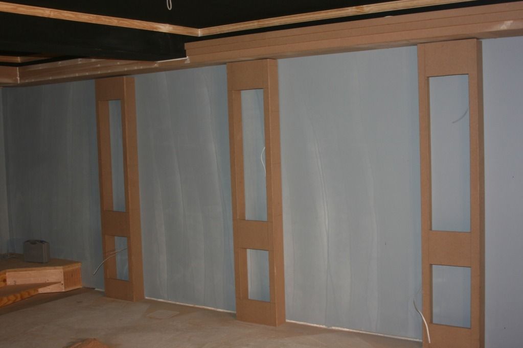

next came attaching the sides

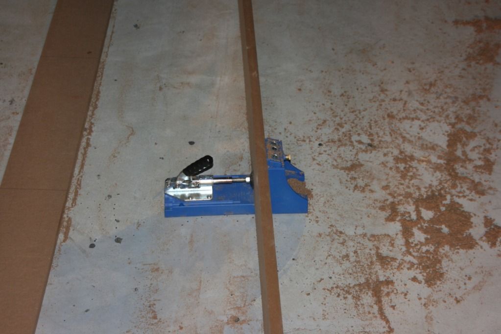

next new tool ...kregg jig ....... i miss my saw horses!!!!!!
next came the molding for the fronts ..... i found something that seems to work and look nice at lowe's
test fitting the molding to make sure everything is nice and square

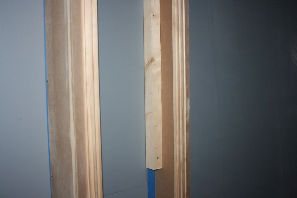

put 3 pieces of bracing in
one finished column
4AlexF likes this.

finished building the rest of the columns ...need to finish all the moldings still

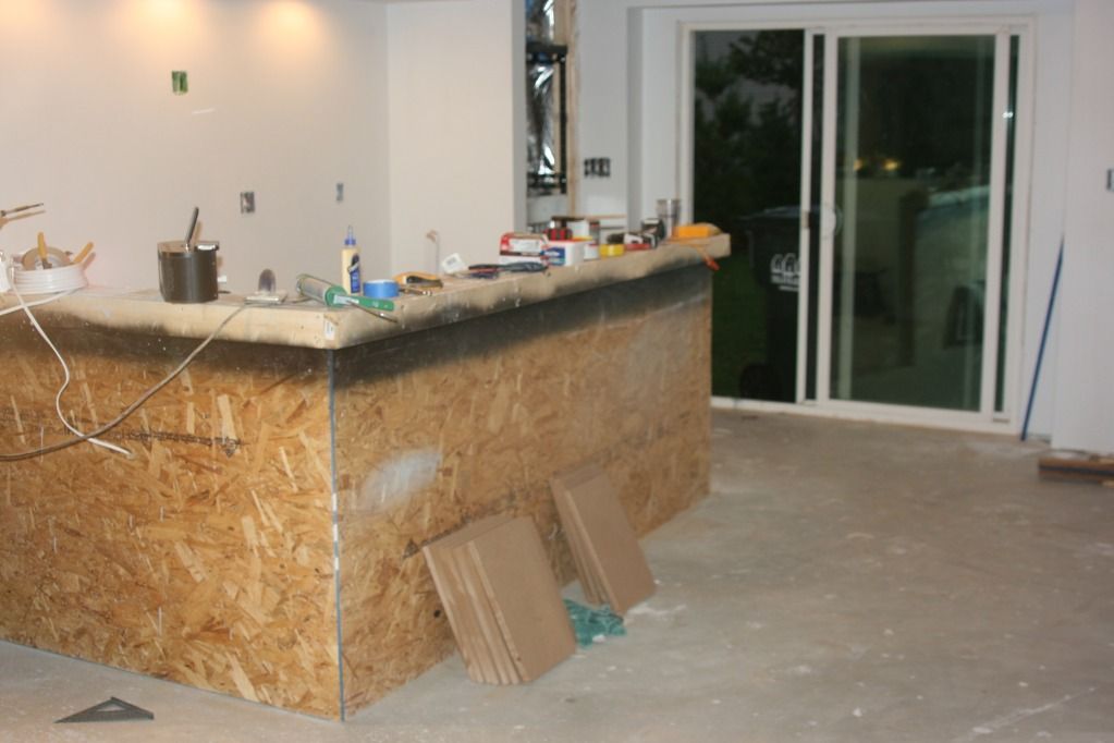

i think i found out why we build bars ............. to store our tools and materials LOL!!!

Thanks ... yes i really like the kregg jig ... works great ..... the light tray is pretty much the same as the one build in bacon race......
the only real different is i used crown molding above the light trays
i may need to rename my build ... something new ...... something blue....... "something borrowed" smile.gif

another weekend of columns ... got all the trim on them and in place
i secured them to the walls with 2x2's
to seal where the fronts meet the sides i was did one using car bondo just see how it would come out
it does seal the cracks up well but it a little harder to work with then just plane old wood filler ... it takes longer to cure ext... but it does work well
i also got them all wired up ...
