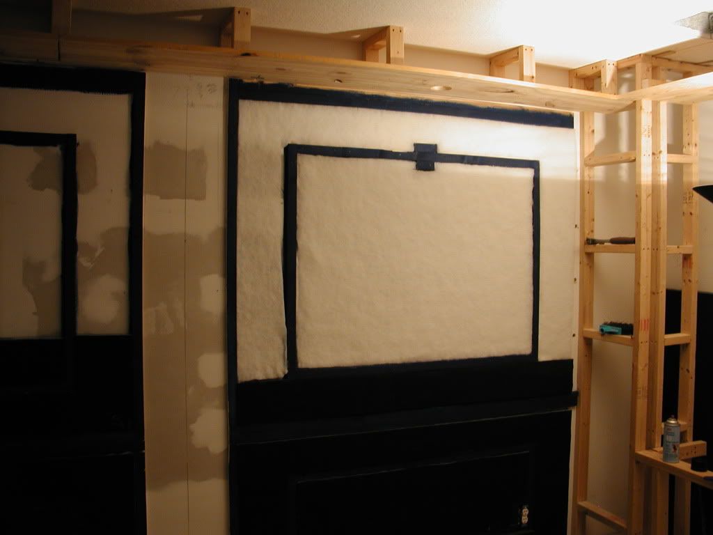

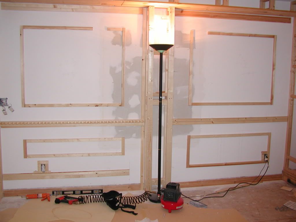

In this very busy picture you see one of my walls with most of the furring strips already in place. The blue arrows point to chair rail, baseboard and one set of verticle strips. The black arrows point to where the crown furring strips will go (there just not there yet in this pic). The pink arrows are where the strips will go that have the material already attached to them. The orange squiggle line is showing the framing for the collumn that at this point in the build has not been secured in place but in this pic it is just standing in its future spot. After attaching the strips with the material ( pink arrows), you pull the fabric across over to the strips where the collumn is at and then (with the column out of the way), you staple the material to the side of those stips.
"I don't know if Hal is homicidal, suicidal, neurotic, psychotic, or just plain broken."
dkroom is offline

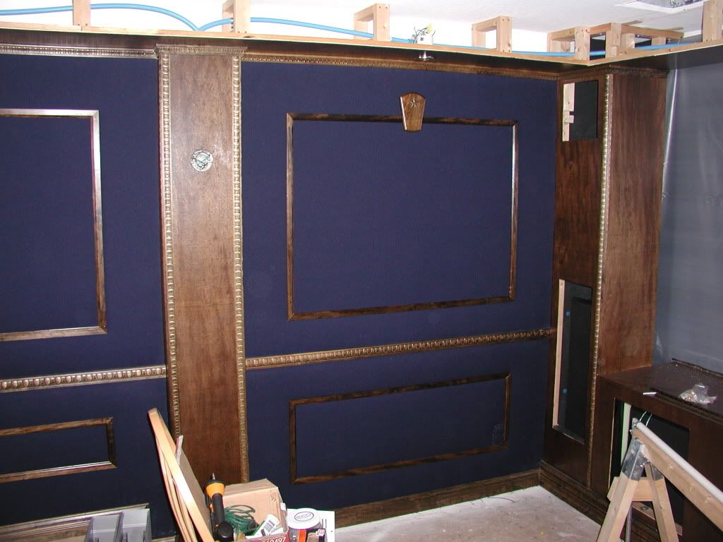

In this pic of the same wall, you can see the upper furring strips in place as well as the strips I placed for the backing of the "picture framing" moulding that will ride on top of the material. Note; it is important that the "picture frame" backing be exactly where you plan on placing the moulding later, otherwise you would have to undo alot of work to change this. Also I did not attach the material to this backing in any way. I let the "framing" pin the material down when I attached it later on. You'll notice that I also framed around a couple of electrical outlets. I did this so the plate that goes here later did not push the fabric in. I'm very glad I did that.
dkroom is offline

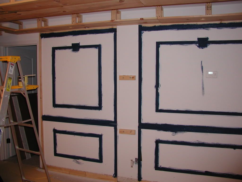

Here is another wall and you can see I painted the strips to closely match the GOM incase after stretching it the light colored wood might show through.
But then why diddn"t I tint or dye the batting? I don't know.

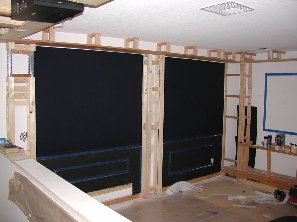

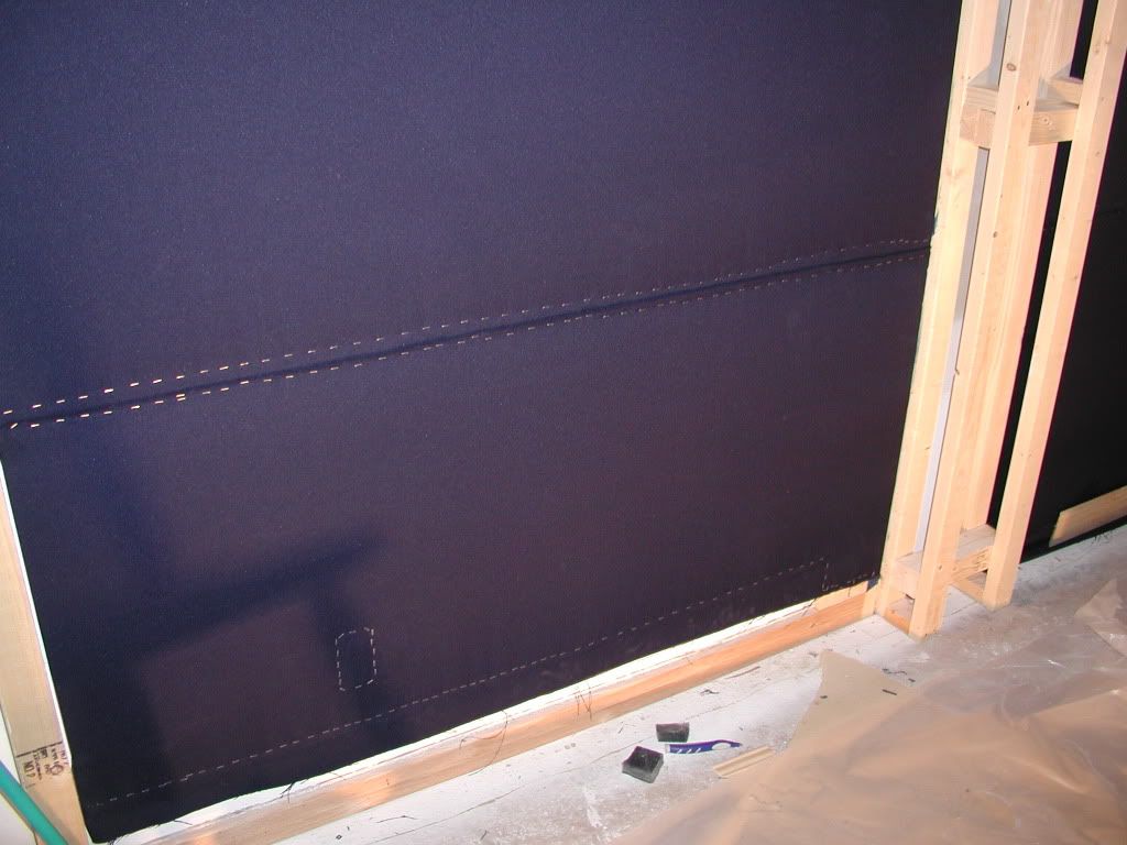

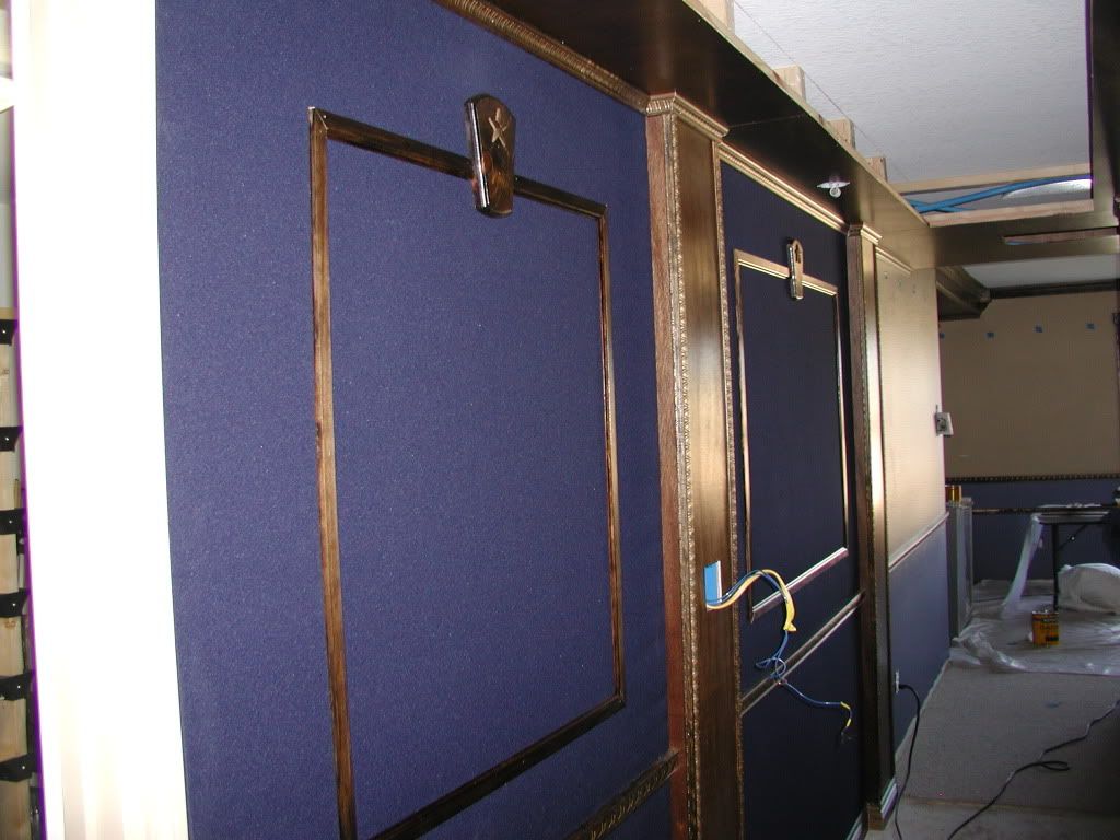

Just a few more pics. Some right when the cloth went on and a couple almost finished.
dkroom is offline

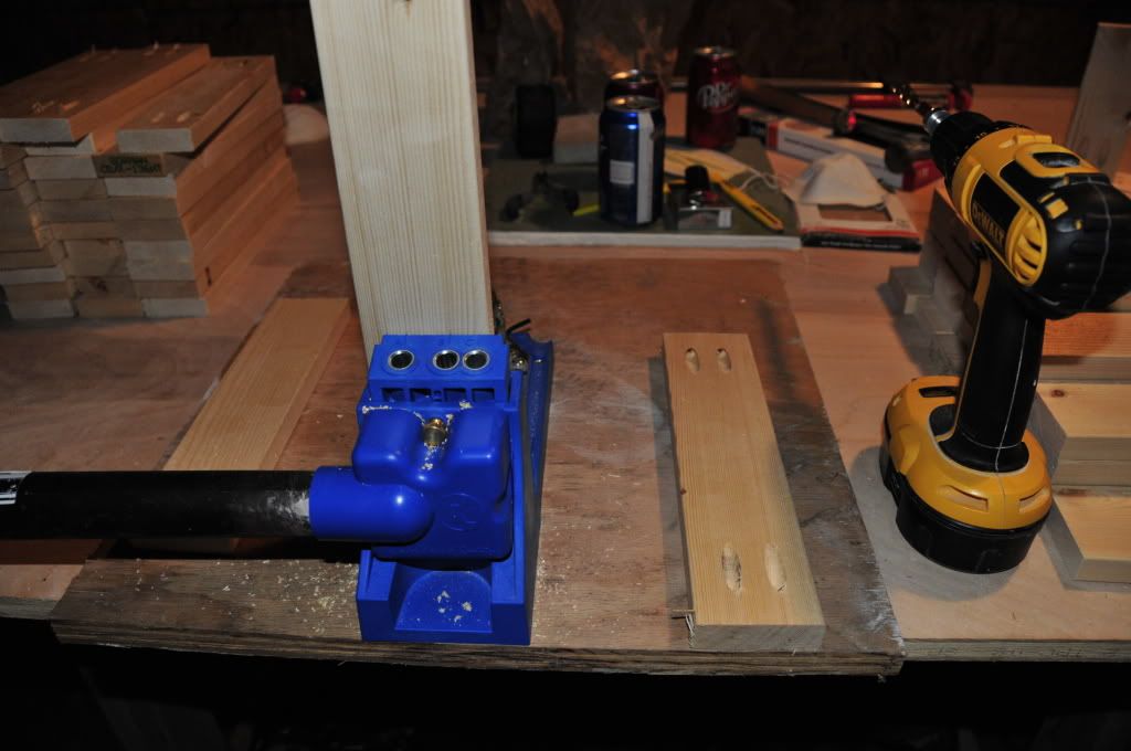

Heres what it looks like
You would have the wood turned the other way. I have it mounted to a small piece of ply and use a 2x4 on each side of it as a jig to keep the wood level way all you need to do is slide it to the next mark to drill (in your case OC of the stud spacing). There is a clamp on the other side of the wood sticking up in the air that holds the wood in place while drilling the holes. Oh and note the shop vac hooked up to it as it is extremely messy. I wouldnt attempt to use it without a vac hooked up.
IDK how in the world Big has broken the bits. I have drilled literally thousands of pockets without a single problem with the same two bits that came with my kit.
You really need to ask yourself if using the 1x4s are necassary though. If you can get away with the extra wood surface inside of the panels then the 2x2 will most def be stronger than the 3/4" end of a 1x4. But if you are needing 1x4s and would have them butted up against each other or something else then the only other way to put a 1x4 up that way would be with L brackets. You could even add some of them to the pocket holes and they wouldnt take away any space for whatever material will be on the inside.
