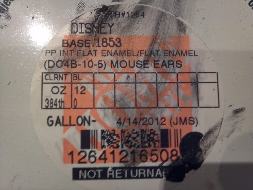

If you really want Mouse Ears then you can try showing the paint mixer this photo of the label on my recently bought gallon. They might be able to input the numbers for the colorant and get you the same color.

That formula is basically open the can of dark base and pour in the max amount of black possible.

This sample of black (forever) says
CLRNT BL
OZ 0
384th 288

How big is the sample? they put in 288/384th of an once of black colorant.

If I remember correctly the samples are 8 ounces. Since there's 128 ounces to a gallon, if 288/384th of an ounce goes into the sample then that means 12 ounces goes in a gallon.
Same as the Mouse Ears!

GUYS! Disney mouse ears is not rocket science. In the case of Home Depot it was basically add 3 parts of the black Behr colorant to 29 parts Behr Deep Base. That is the formula for a quart I have sitting here. Adjust accordingly for a gallon. There is nothing in it from Disney, no pixie dust or Magic Kingdom on the label. Disney may have packed up their color display and Home Depot may have removed the name Mouse Ears from the computer but just ask an experienced paint mixologist to give you the deep base with the max black colorant. Mouse ears was/is nothing more than marketing hype.

Mouse ears is 9.375% black from my sticker, You got around 12%. Should work just fine.

My Home Depot has the Mouse Ears Black in the computer but there are 2 choices:
- Mouse Ears Black Enamel (which I believe they said has the primer mixed in)
- Mouse Ears Black Flat Matte (no primer mixed in)
So from the photo posted earlier it looks like you are using the Enamel? Anyone know what the difference is and which is preferred?

Mouse ears was just 12 oz of black pigment in the dark base. I have a can as reference in my shop. If they type BLACK as the color name in any of the Behr ultra paints it will say 12 oz of black pigment. No pixie dust was involved in the making of Mouse Ears. ALL marketing hype. I've bought Flat Black, Black Enamel, Black Satin in the last month, all the same formula.
