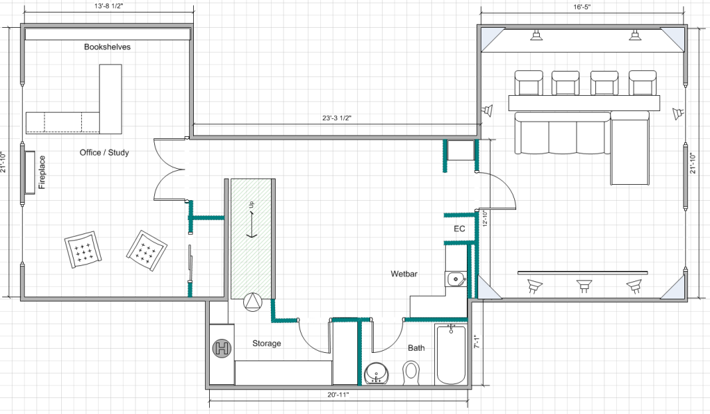

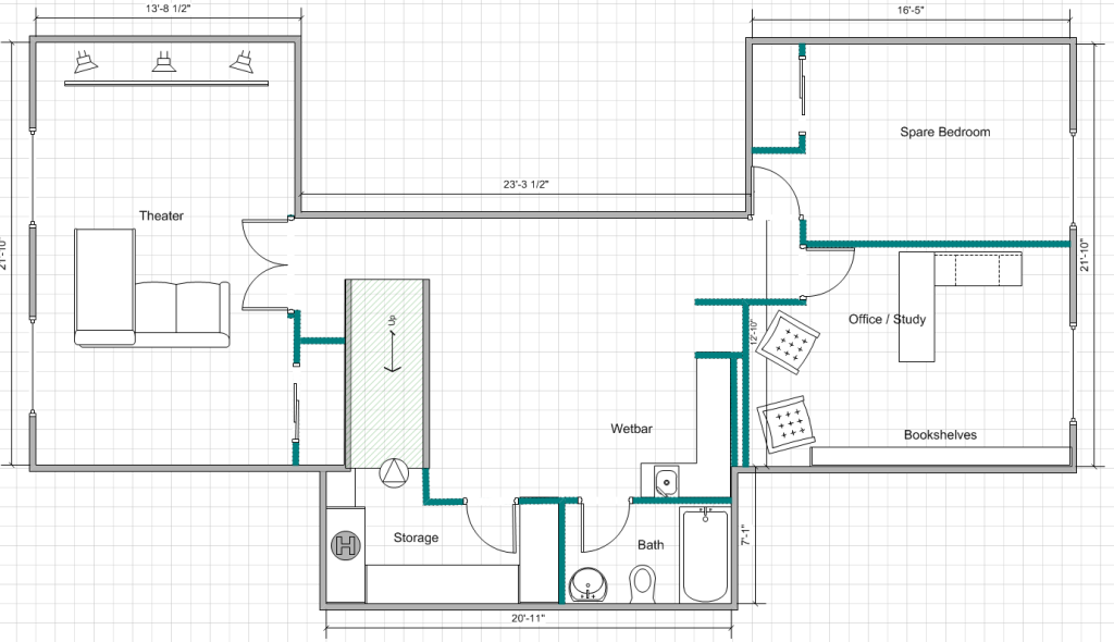

So I can't believe that I am considering this, but I have had this nagging thought lately that the theater might work better on the other side of the basement. This would allow us to put an extra bedroom in at the expense of 2ft width in the theater, as well as a smaller office. I floated the idea by the WAF thinking that she would shoot it down immediately given the additional time it would take. She did at first, but when I showed her a sample layout, she is all of a sudden on board. We are both unsure if it is really worth the extra effort.
You can see my build thread link in my sig. I'm finishing the basement all at once and the theater currently has all the whisper clips up and almost ready for insulation and hat channel. Everything is wired in and changing everything will obviously set me back quite a bit.
So I want to take a step back here and think about what will be the best solution. Please throw some ideas around and help me decide!
Original floorplan
New floorplan?
The house has 3 bedrooms upstairs (incl master), while it seems lately I've been noticing most other houses in the neighborhood have 4+, so I think my resale value subconscious is telling me not to waste the opportunity to add a 4th bedroom. We have 2 kids (with wife hinting at a third) so all bedrooms upstairs will be taken. We have guests maybe 3 weeks cumulative per year, if that. With the current plan, guests would stay in one of the kid's bedrooms or throw an air mattress in the office area and I'll work somewhere else for the duration of their stay. WAF likes the idea of having a home for some of her scrapbooking / teaching stuff.
The two rooms taking a hit would be office and theater. On the original, the office area is rather large, so while I would enjoy that, not a big deal to lose some. The theater, losing 2 ft probably means losing the 4th chair of a comfy couch (no theater seating planned atm). This also means less people could fit, but it's unclear how much party use the theater will get at this point. Heck, I don't even know if my wife will enjoy joining me down there yet. This uncertainty has become more apparent lately and so part of me feels that I should not assign the largest space to the theater.
I'm thinking that even if I swap the theater space I may keep the Equip Closet in the same location because there are other wires, including wires from upstairs terminated there. Having 2 Equip Closets seems counterproductive. I will have to figure out the current french door entry into the theater since I purposely avoided that in the original design. Also the closet is a bit out of place in the theater room if I don't use it for equipment. I thought about trying to use the closet area as a super tiny lobby into the theater, but the current closet framing is only 27 inches deep.
So many new thoughts swirling in my head now and I feel pressured to make a decision soon so as not to delay things further. What would you do? All thoughts appreciated. Brainstorm away!

They both have their merits. The big question is how long are you planning on staying in this house? If it is your 'forever' house then don't worry about resale - build it for you. if you expect to be moving on in 5 years or less, then the additional bedroom would be more attractive to buyers.
As for the theater side of things, the larger room is preferable. The double doors are a no-no for sound isolation, but the closet space could be used for the rack/DVD storage.

I'd say stick with your original floorplan. My theater is about 12ft wide and I wish I had a few more feet in width. Personally, I'd prefer a larger office/study. than a cramped office and a small bedroom too. And like Big says, technically, your office could qualify as a bedroom as far as resale is concerned.

You are actually adding two bedrooms with the new plan if you include the office space, which to me is significant. Adding a small closet where you currently have the chairs would be easy to do if you ever decide to sell. After adding the walls to the new theater location you are still left with about 13' in width. Mine is only 9'8" in width so 13' seems huge. I know moving what you already have installed is significant so I do not think anyone of us here can convince you to do this change, but we can just show you the pros and cons of doing so.

Thanks for the input. After clips/channels/DD I'd end up with approx 13'3" width. That is a bit short of ideal for the theater, which is why I chose the larger space in the first place. Also I should state that I am going for a hybrid theater / living room type space - i.e. something that can be used for stuff other then watching movies. You could argue that the larger space may be more beneficial for this.
Original:
Theater 16 x 21.5'
Office 13.5 x 21.75'
New:
Theater 13.25 x 21.5' (closer to 3 ft difference)
Office 11 x 16.5'
Spare Bedroom 10.5 x 13.5'

I'd say stay the course. The office/study could easily be split into two decent size bedrooms.

I'd stay the course with the current layout and split the large office into an office and bedroom. That space could easily accomodate both and while not being overly large rooms, they will certainly be sufficient.

Strikes me if you gave up the double entry doors for the office, and framed a door ninety degrees to the stairway, you could have the large office now, and have the option to easily create a fourth bedroom at a later date. The future bedroom doorway could be framed, then a few studs screwed in, and the door frame drywalled right over.
A small closet could be built in under the stairs, with a normal door.
If you took carefull measurements and some digital photos of the framed in doorway, a simple stud wall and drywall section of wall would give the fourth bedroom.

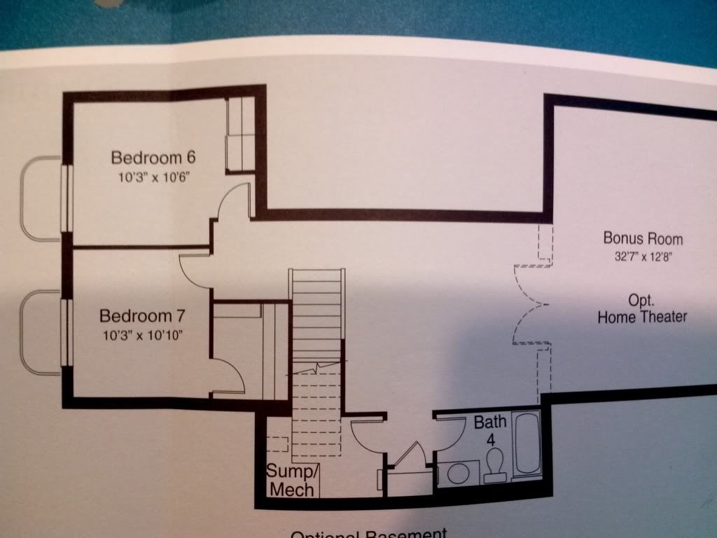

The builder actually had an option in the original plan that I managed to dig up to split that side into 2 bedrooms. With closets, both rooms ended up being about 10x10, which seems uncomfortably tight to me (i.e. good for sleeping and that's about it). I currently work from home so having a decent sized office is one of the priorities at the moment. However, I can see us possibly modifying the space in the future to fit in a couple bedrooms.

Tedd thanks for taking the time to modify those to illustrate your thoughts. I like your out of the box thinking. Having the option to expand the # of bedrooms in the future is probably where we want to be.
There are a few issues with your suggestion. One is the stairs open up right where the closet framing is today, so they would have to be closed to place the wall where you've drawn. Also the sump/sewage pumps take up most of the area under the stairs. I'm going to do some additional measurements however and see if I can pre-plan for this option in the future.
