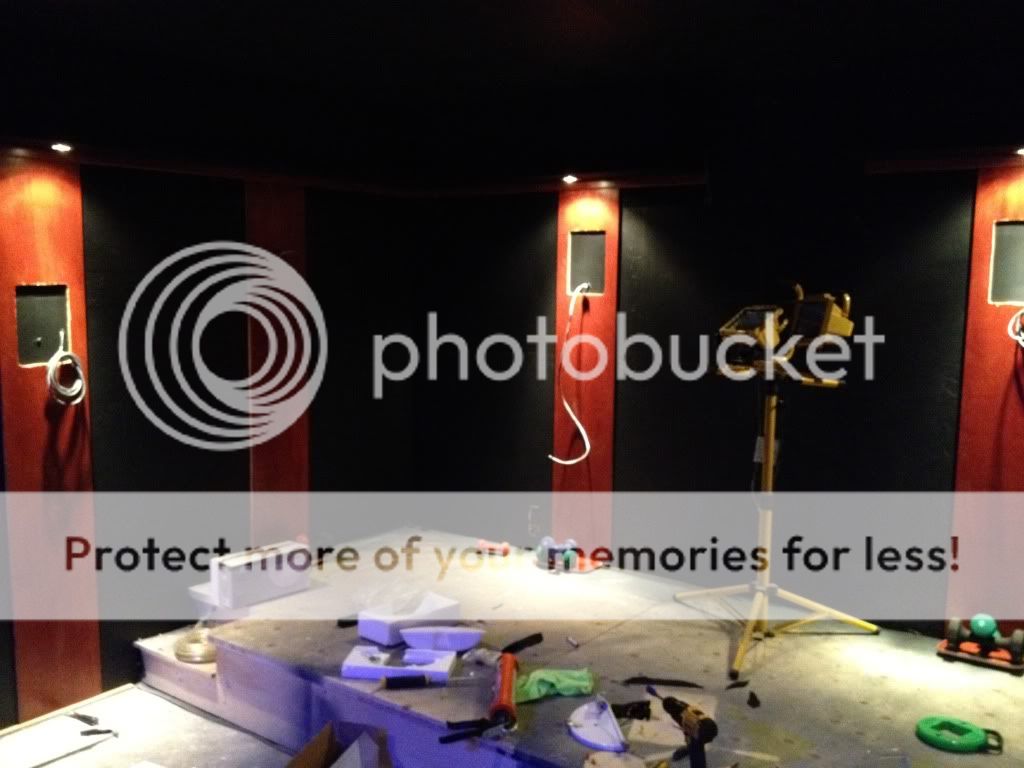

Could you share a little more info on your "columns". Are they just single sheets of plywood? Method of attachment?
Easy and super cheap!! They are the highest grade sanded 5/8 plywood sold at Home Depot. I used plain ole construction adhesive to glue them right onto the drywall. I pre-cut the holes for the speakers before attaching them. I had very limited space so I could not have large columns but I still wanted to have something interesting for my speakers and to break up the black of the walls. I really like how they turned out.
Mat1220 is offline
They look great and it looks like you were able to keep all the edges hidden. I saw that you used a cherry stain. Can you walk us through your staining process?
Pretty simple really. I bought a Stain and Polyurethane in one, Satin. Sanded my columns, stained, steal wool, stain, steal wool, stain.... probably about 4 or 5 coats until I got the color I wanted.
This was after only one coat... quite a few to go!
Then I simply pre cut the holes for my in wall speakers and attached the columns directly to the drywall using construction adhesive.
It's pretty amazing how just adding the columns really helped light up the room. The "all black everything" was just too much... My big 1000W industrial light had a hard time lighting it up!
I then cut the rest of the holes right through the drywall and installed the speakers.
