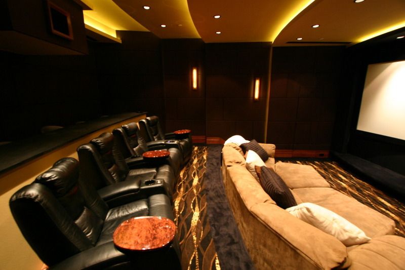

Beautiful theatre. What are your dimensions? Is there a link to where I can see additional photos? Thanks.
http://www.avsforum.com/avs-vb/showthread.php?t=1339780
