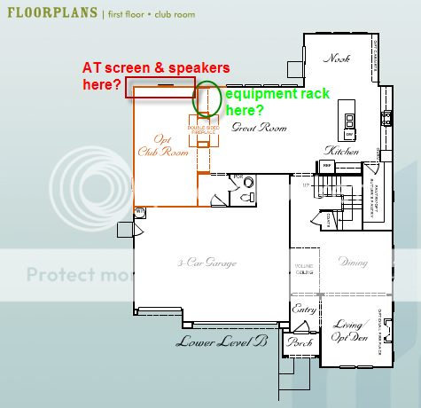

We had a new home built in mid Jan 2012. One of the key reasons we chose our house was that it has a rectangular room on the first floor that could be optioned as a "Club room" instead of a downstairs full bedroom + bath.
Room dimensions: 22' 5" length x 11' 11" width X 9' height.
It's a tract home so I could not alter the room dimensions, HVAC, the location of the two windows, etc. The color of the walls are a beige/tan for lack of the name of the exact color. And the ceiling is white. WAF has kept it white thus far. The builder did offer to wire the room for HDMI and speakers so I took advantage of that.
Our first theater was DIY 16:9. My goal this year was to build a CIH theater but this time around I was interested in partial DIY. I really wanted to get professional help with acoustic treatment design and baffle wall design & construction. My inspiration was Pocoloco's theater. Understated .. clean lines. I looked up several local CEDIA installers and interviewed them. Originally I told them I wanted to leverage a lot of my old equipment,
• Definitive Tech BP2000TL + CLR2000 center + matching BPX surrounds ( I later decided JTRs were the right speakers for me)
• Onkyo PR-SC885 SSP
• Sunfire 5x200w
Overall, I didn't have much success with the CEDIA guys. I lived too far for one CEDIA installer (~ 1 hr). 2nd CEDIA guy was very nice and spent a lot of time with me on the phone but wanted me to go with his turnkey solution. 3rd CEDIA guy seemed nice but again, I had to buy brands he carried + his terms were that he would collect a % of total cost of equipment as design fee on top of installation fee. Frustrated that I wasn't making progress, I almost considered going this route but after thinking about it for a few days I just didn't feel any of the brands carried by the CEDIA installers delivered on the value I was looking for. 4th CEDIA guy seemed knowledgeable about acoustics (THX certified fwiw), was willing to let me use my own gear and was willing to charge me for time and materials. But he never returned my follow up phone calls. I don't want to generalize but purely based on my experiences above, I think it's harder for an AVS'er who likes DIY but also wants help to find a good match with a CEDIA installer because of their business models. I also spoke to CinemaForte' and while the packages they offer are very nice, it was still out of my budget.

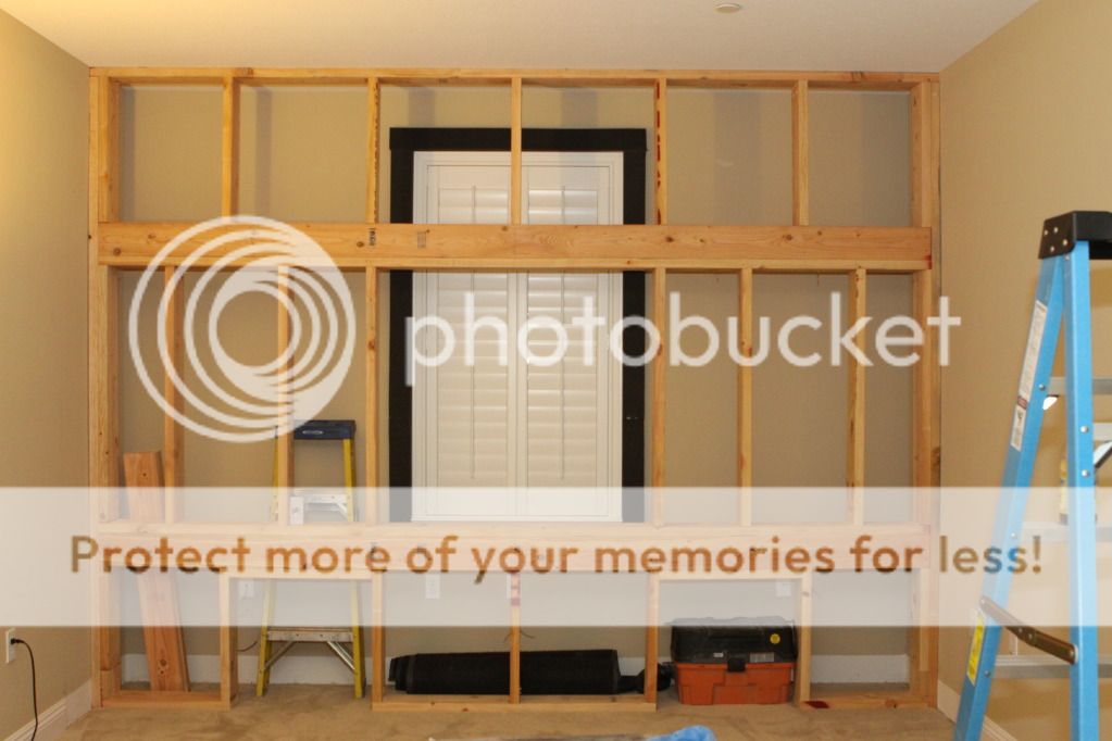

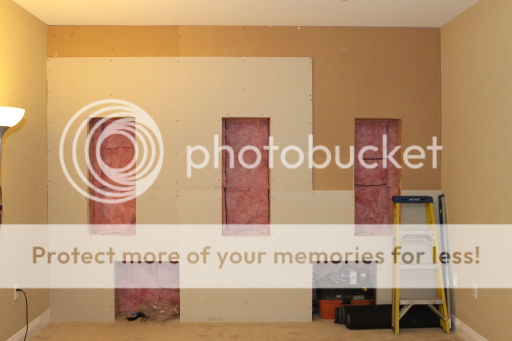

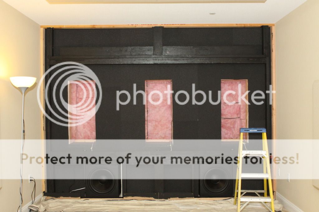

Build progress in pictures:

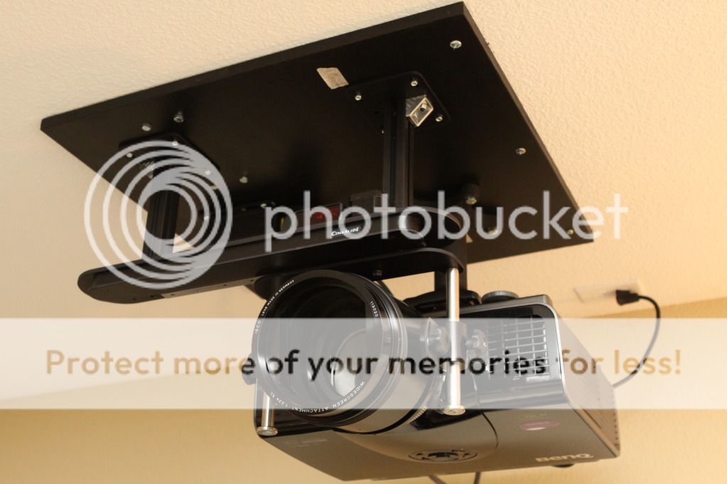

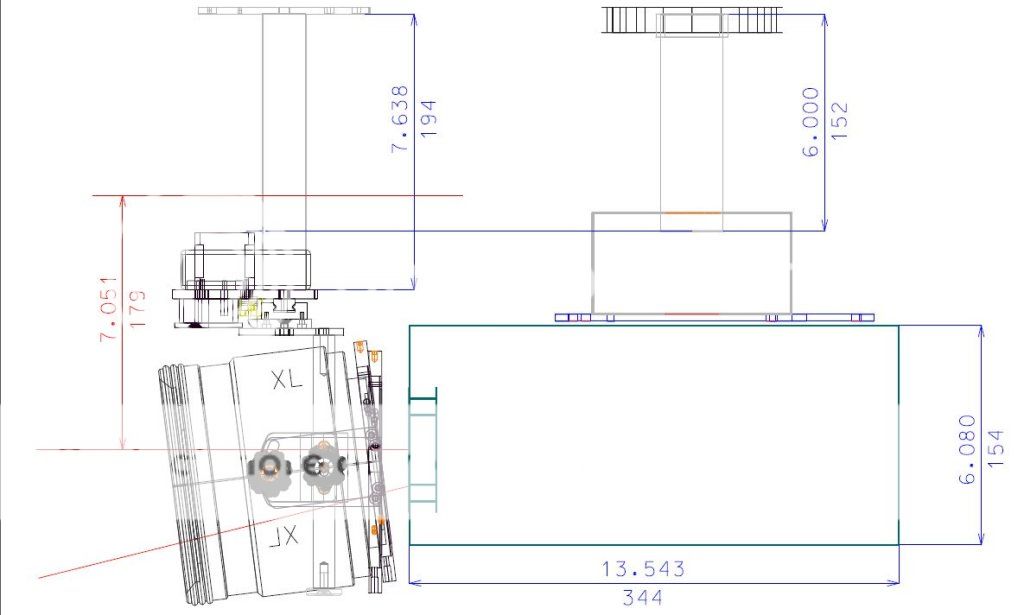

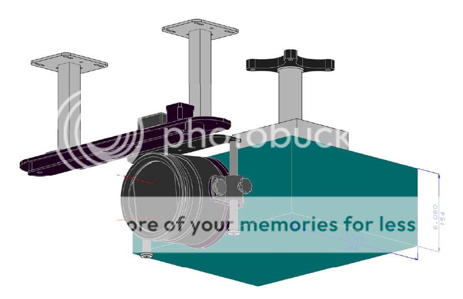

3D render of the ceiling mounted projector, anamorphic lens, and Cineslide solution from techht.
CAD side view of projector, anamorphic lens, and Cineslide from techht.

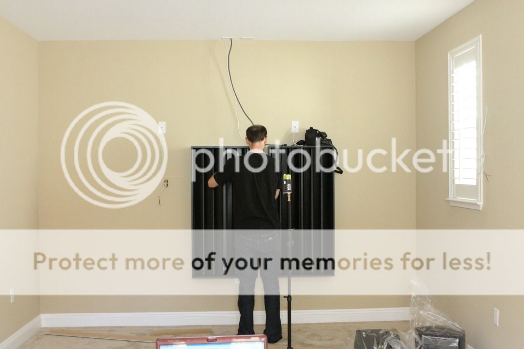

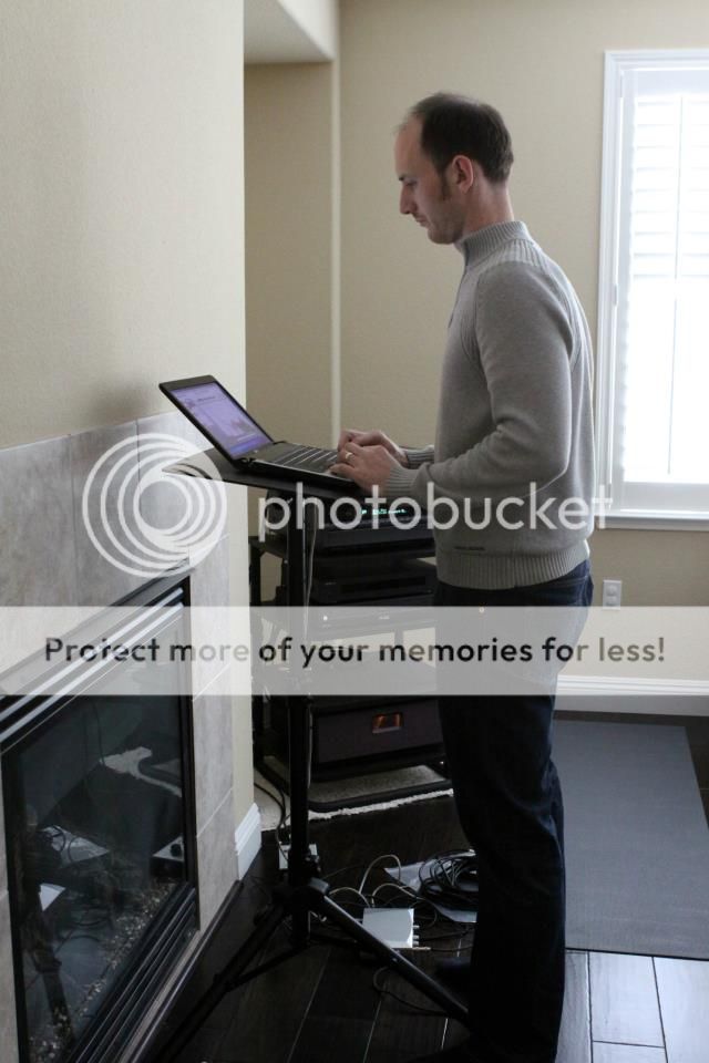

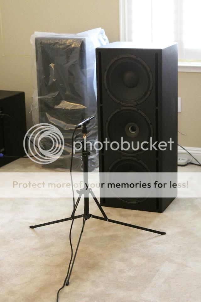

Nyal Mellor of Acoustic Frontiers taking measurements in order to design the acoustic treatments solution.

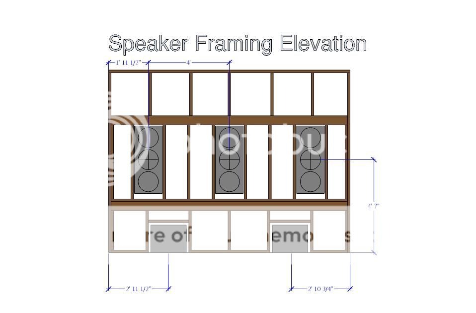

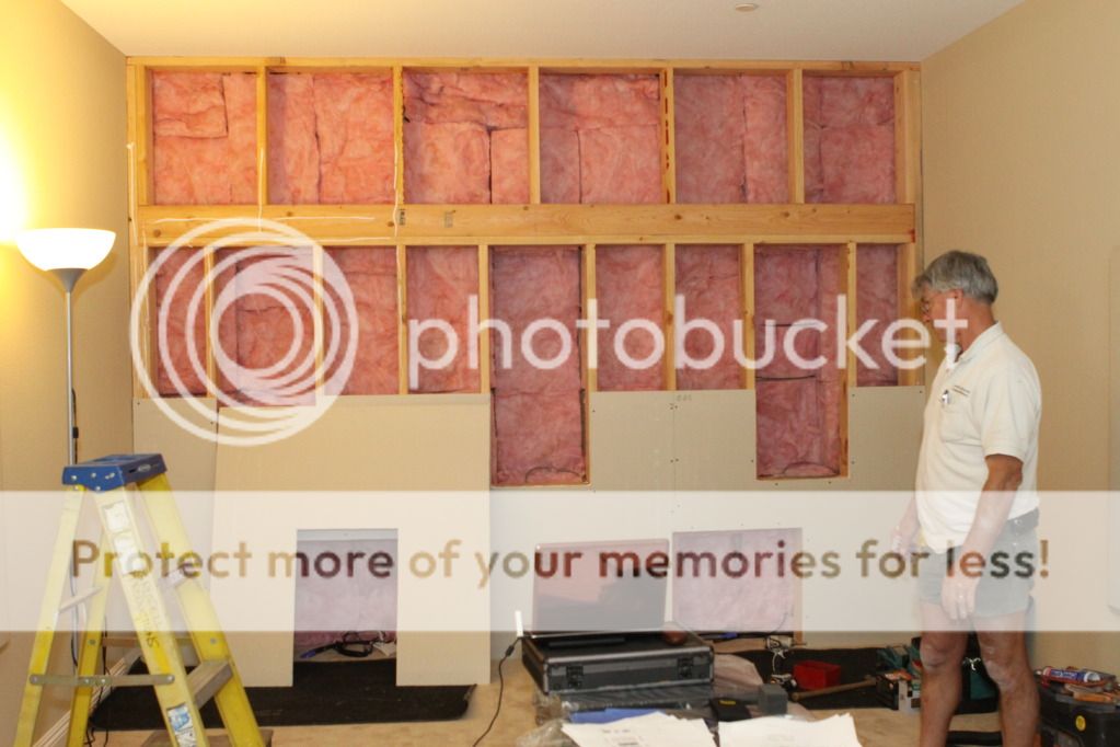

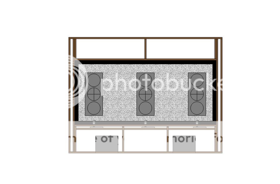

Baffle wall design from Acoustic Frontiers
Screen wall design from Acoustic Frontiers

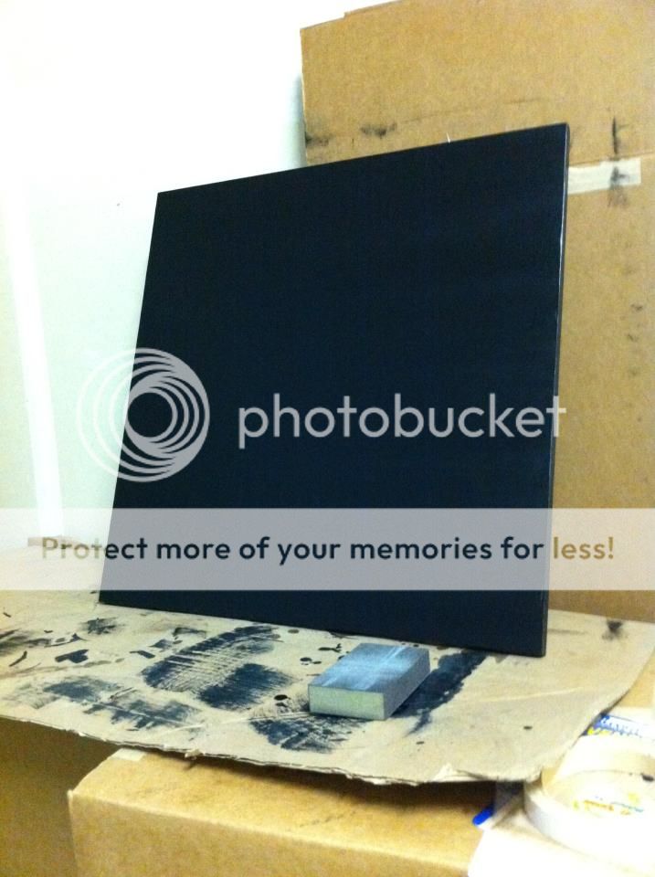

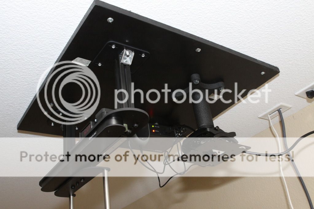

Before.. I used a 2' x 2' x 3/4" birch plywood from Lowes to mount the projector, anamorphic lens and Cineslide. I applied veneer edging and black satin finish.
and after.. I thought it would be a 30 min job but it took me several coats and repeated sanding to get to a richer finish and acceptable level of smoothness.

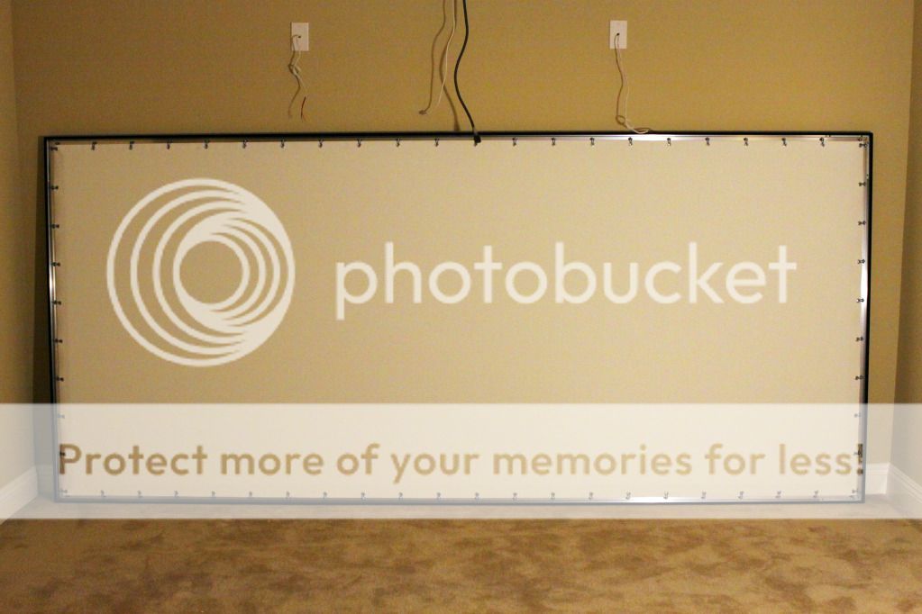

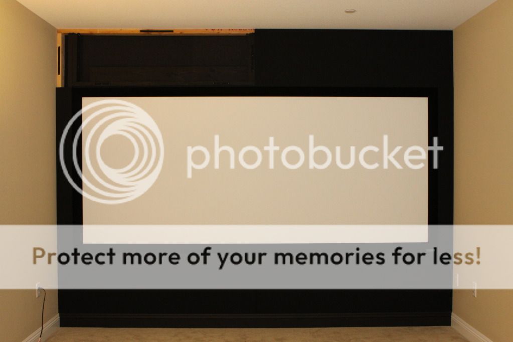

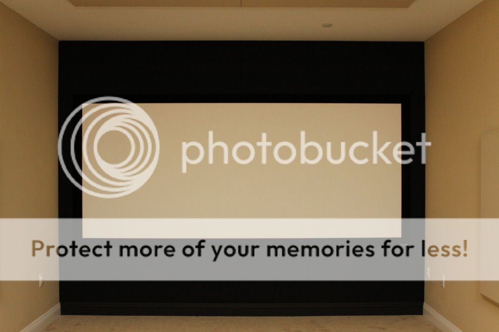

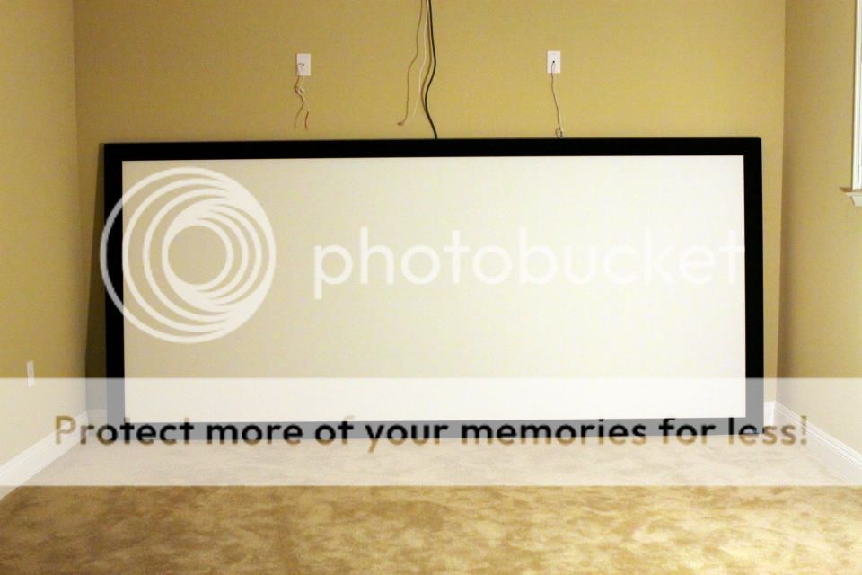

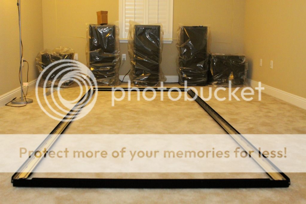

Unboxing of JTR LCR speakers and starting of the screen build.

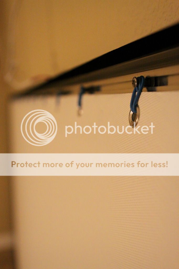

Grommets on the Seymour make it very easy to install.
Back of Seymour.
Front of Seymour .

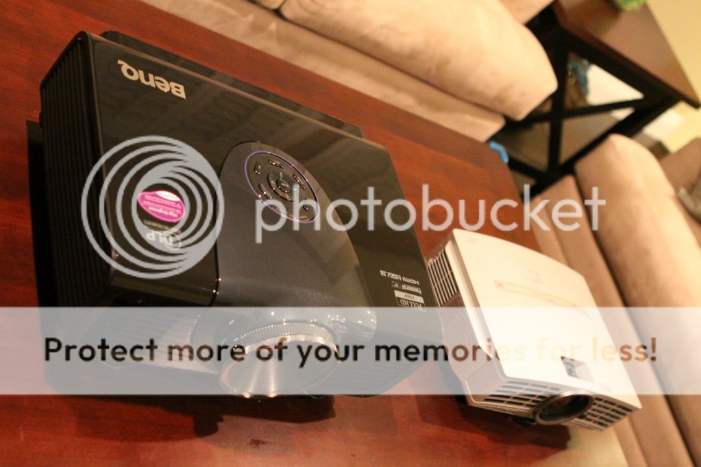

BenQ W6000 vs my older Mits HC3000. I now have a W7000 due to a sharpness defect I had on the W6000.

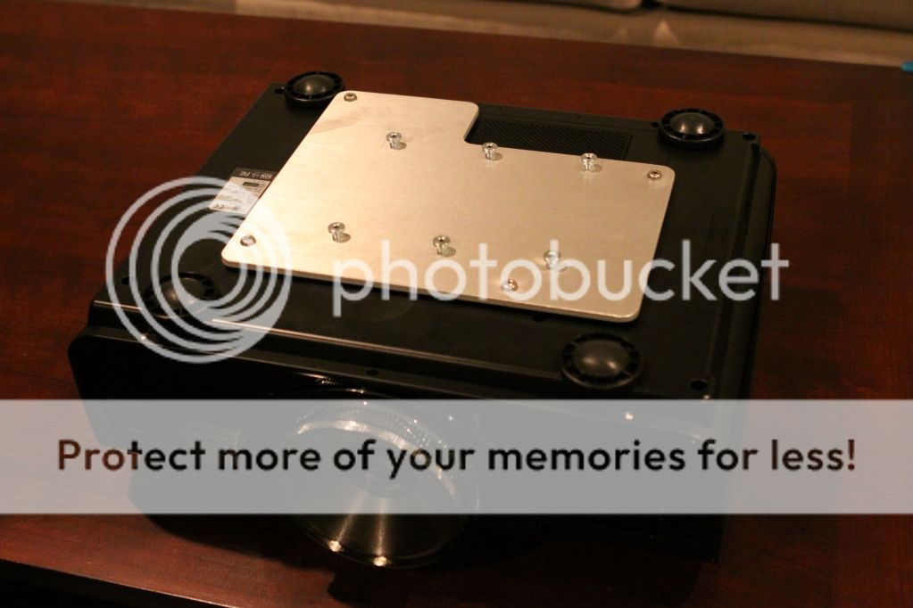

Custom plate for the BenQ & Chief mount made by Techht.

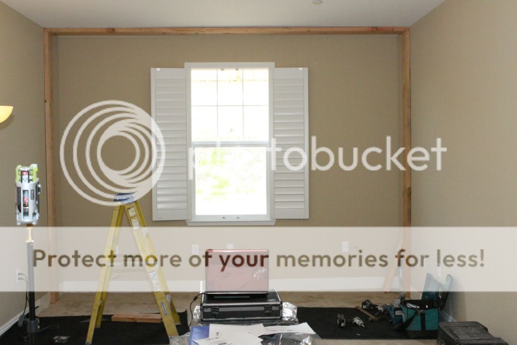

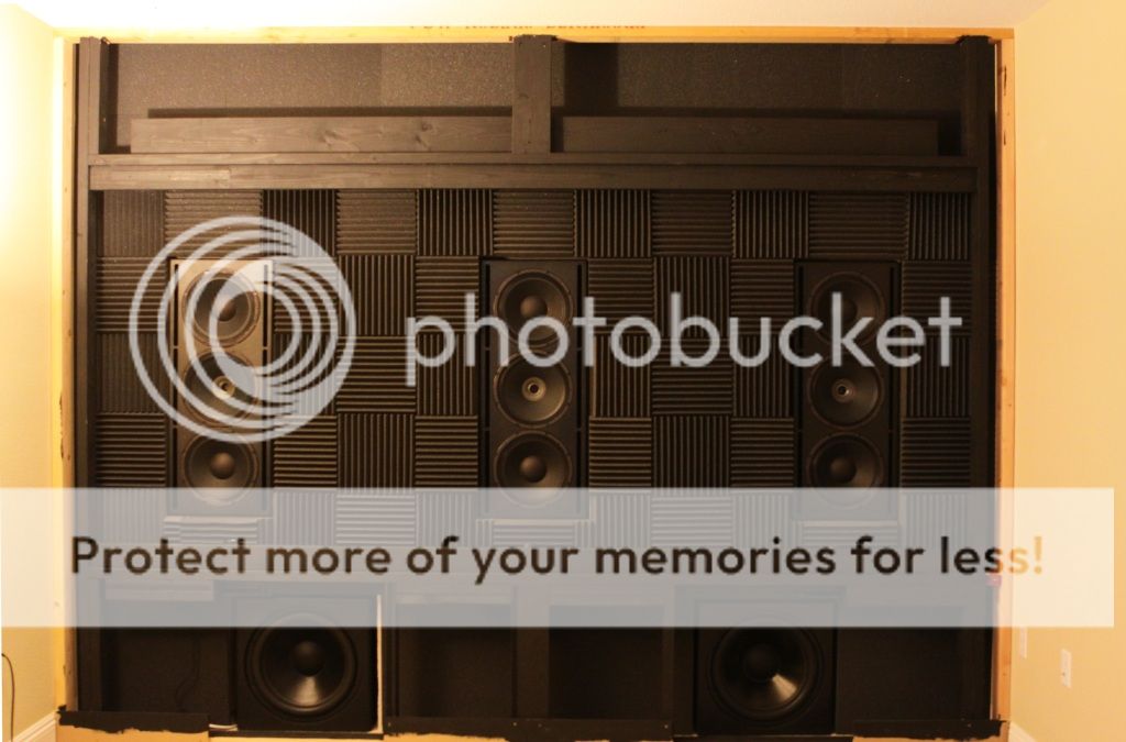

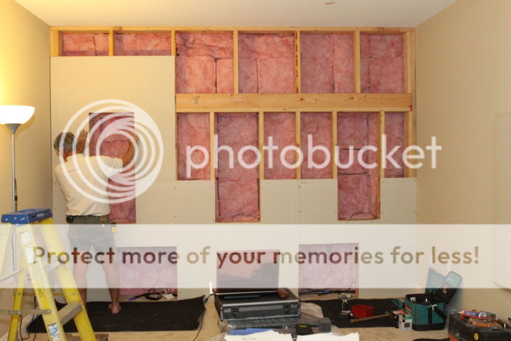

Start of the baffle wall
Close up showing the three layer constrained layer damping technique to minimize vibration.

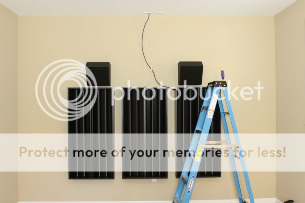

Installation of Flexifusers on the rear wall. They're a combination absorber / diffuser product to absorb some of the incoming sound from LCR and at the same time reflect other parts to the sides for envelopment and control of reflections.
3" control columns used to absorb off axis reflections from the S8s and prevent flutter echo.

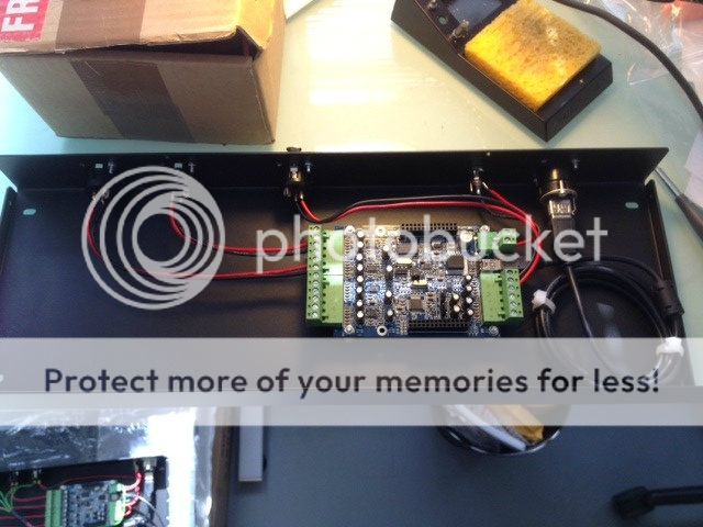

Eq box for the subs made by Acoustic Frontiers

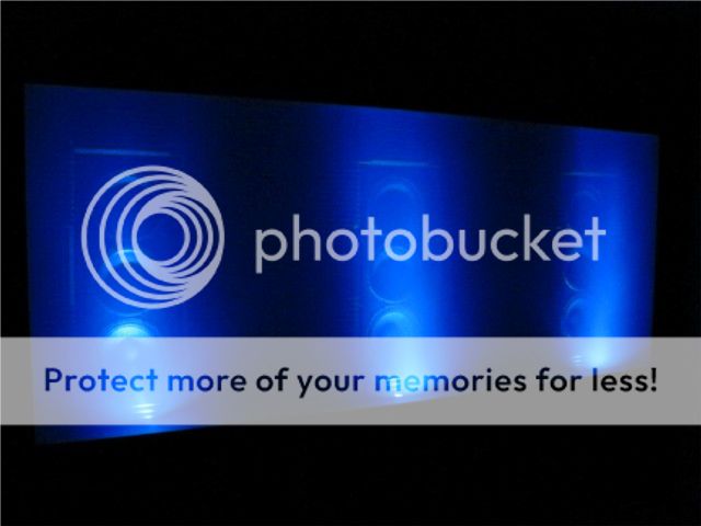

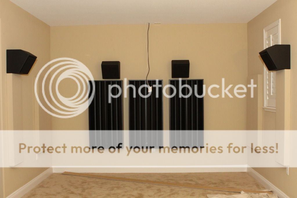

What lights are using to uplight the JTR's behind the screen? They look like projectors, maybe? Also, how far in front of the speakers are they? Nice build. Love the black absorption panels behind the screen. Shame you have to cover that and those beautiful JTR's with a silly screen. ;-)

I used Hampton Bay 8 ft. Black Linear Track Lighting Track (Model # EC751BK), Black Linear Live-End Power Feed with 15 ft. Cord (Model # EC707BK), three Black Pinhole Cylinder Track Lighting Fixture GU10-16 (Model # EC7210BK).. all items from Home Depot. And for the actual blue lights, I used three dimmable blue LEDs from an online retailer called Fusa Corp, item # 486867.
I don't remember the exact distance between the lighting fixtures and the speakers but they are inches and close to what you see in the design drawing.
Yah, I wish I could see more of the Auralex wedge pattern with the JTR speakers when the blue lighting is on. What we learned after we installed the blue LEDs was that they simply aren't as bright as we had hoped. It's actually hard to find dimmable colored LEDs. I don't know if there are brighter ones available.

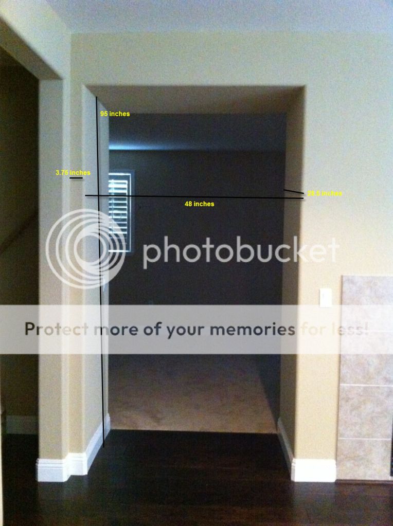

Can you show/tell us how you handled the entrance to the room too?

Nice job and thanks for the info on the behind-the-screen lights. I'll definitely be researching those.
Do you get much light spilling onto the light-colored side walls?

The theater turned out really well from a sound quality perspective! Whilst not the last word in refinement, tonal color or clarity the JTRs certainly are extremely dynamic. There is absolutely no issue in this theater with cleanly reproducing reference level. For the price there isn't much out there that is equivalent.
In the subwoofer range below 80Hz or so the use of dual sealed Captivator S in a width-mode canceling arrangement yielded the same seat-to-seat bass response width ways across the seating area. Funds did not allow for 4 subs, which would have been optimal, or bass trapping. We added a sub EQ to dial out a few low frequency resonances. The end result is a tight, punchy and basically bottomless dynamics with extension below 20Hz.
The JTR speakers require quite aggressive treatment off axis (particularly vertically) to tame them since they aren't the smoothest...hence the use of thick absorbers on the side walls and ceiling. One thing I always try to do if the possibility is there is measure the speakers vertically and laterally off axis before coming up with the acoustic treatment plan. The acoustic treatment for the mid and high frequencies (>250Hz) is there in my opinion to match the response at the listening positions to the speakers on-axis response. Some speakers need a lot, others don't need very much at all. Obviously there is a need to provide a basic level of sound absorption so that the room is not too live.
The use of the foam behind the screen with the cross-hatches doesn't do much acoustically. It was more there for dramatic effect with the behind the screens lighting turned up. There is a second layer of very high density foam behind the 'cosmetic' layer, which does the bulk of the work. The same foam is also used to decouple the JTRs from the baffle wall. BTW the baffle wall is basically bomb proof, 2x6 construction and three layers on the front. Mass is essential to cleanly reproduce the low mids. Too many skimp on the baffle wall construction!
The URC remote was programmed so that when the 'Watch Movie' button is pressed the rear lights go out but the behind the screen lights stay on, then they fade out to black just as the projector comes on. Pretty slick! Lessons learned with use of LEDs: they tend to turn off quite abruptly at the end of their range (they don't dim cleanly below say 30% output, tending to just switch off), they don't have much light output, and finding the exact one you want (in this case blue dimmable line level voltage) is difficult! Unfortunately for use behind the screen, and without allowing a boatload of clearance, there aren't many options. Halogens and other light sources would put out a lot more heat and would require increasing the spacing of the screen and baffle walls, losing room space.

The room entrance in it's original form is simply a "bull nose" or rounded edge opening. At the time of the theater design and build, I couldn't make up my mind if I had wanted a door or simply a thick, heavy stage curtain so the acoustic design and measurements were performed without a door. I have since decided on a solid core, 2 door solution but I am still waiting for the doors to arrive. For now the entrance looks like this,

Measurements - Frequency Response < 300Hz.
According to Nyal, targets (LCR + Subs playing together) were
  • Within +/- 10dB at 1/12th resolution
  • Within +/- 5dB at 1/3rd resolution
Measurements Decay Time < 300Hz
  • Spectrogram plot - Target: no resonances should extend beyond 250ms before decaying 30dB
  • Spectral Decay plot - Target: SPL should decay 20dB in first 150ms
Measurements - Frequency Response > 250Hz
  • Target : Each speaker within +/- 3 dB
  • Target: No Deviation > 3dB between speakers
Measurements - Decay Time > 300Hz
  • Target: Near constant +/- 25% decay times across 250Hz to4kHz (critical midrange). Actual values can be between 0.2 and 0.5s ; dedicated HT rooms trending lower and two channel rooms higher.
Measurements - Reflections
Targets
  • Be Down to -10dB by 40ms to prevent breakdown of the precedence effect
  • Show decrease in the amplitude of energy over 0 - 40 ms. Decay pattern may or may not be continous.
  • Be consistent over the spectrum from 250Hz to 4kHz.

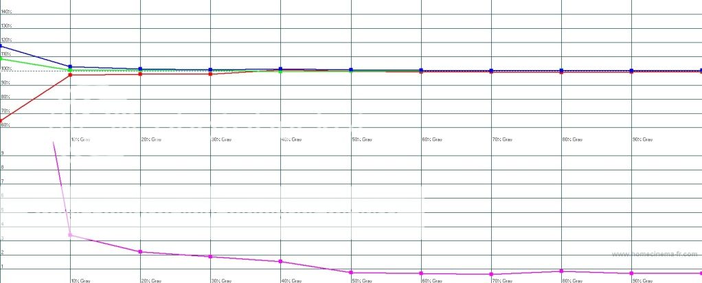

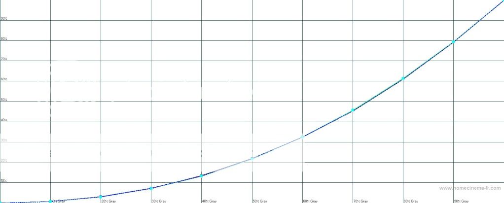

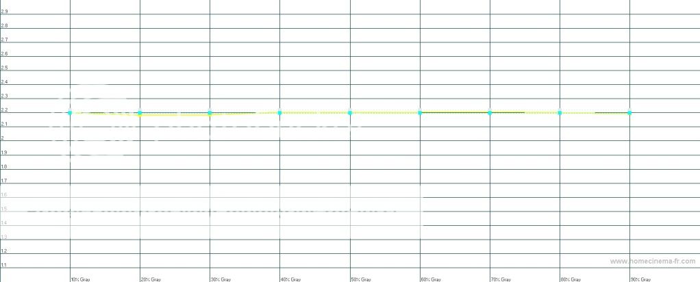

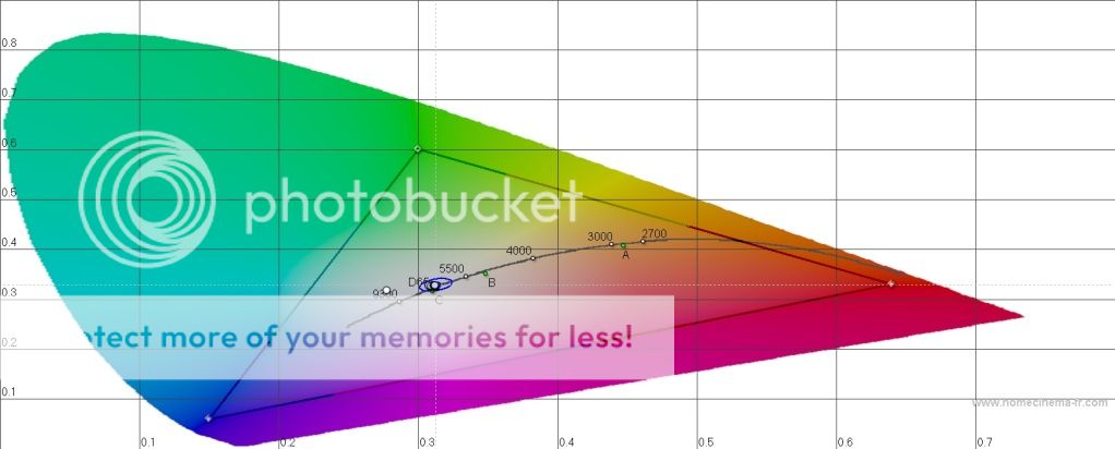

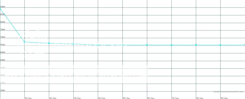

I performed basic Greyscale Calibration using an Eye One LT and DVE HD Basics.
RGB Levels:
Luminance:
Gamma:
Color Temp:
CIE:

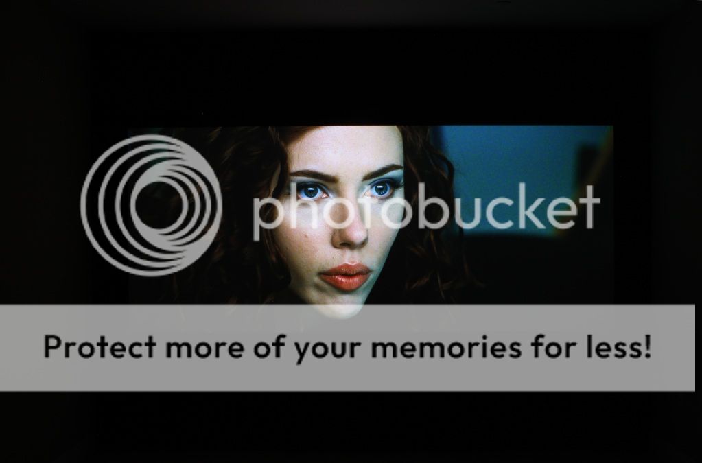

Screenshots.. I am using a Canon 50D with 24-70L. I set everything to full manual and adjusted the exposure to capture how I see it on the actual screen as best I could. But you guys know the disclaimer

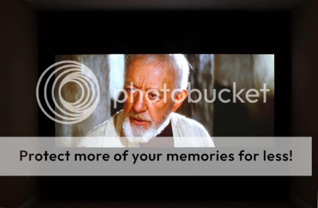

Spaceman, thank you. I just posted some screenshots above. The shot with Tony Stark in his race car. Is that the light spilling you are referring to?
If you meant the blue LED lights, then no, I don't think there is any blue that spills over to the side that I can remember. I'll double check though.

Very nice! That baffle wall is very impressive. The one thing I always wonder with baffle walls is what if you want toe-in, I guess its pretty much out of the question? Maybe speakers that benefit from aggressive toe-in (such as waveguide based) just aren't very good candidates for baffle walls.
Now all you need is to work on the WAF on the white ceiling.
Hard to buy "humble" with that speaker setup.
Thanks Brad. Very nice build you have there as well. I've never seen a baffle wall set up with speaker toe in. I also don't know if that would work or or not.
What i meant by humble is that the theater looks pretty bare bones in terms of decor. ie no wall to wall paneling, soffit, sconces, etc.

Yes, I was referring to light spilling onto the walls from bright scenes like this.
Originally Posted by quack724 View Post
When you start phase 2 of your theater, you might consider a darker color for the ceiling and at least a portion of the walls in the front of the room so more of your scenes look like this.
That's a fantastic picture either way. Hope you are enjoying your room.
Yes, I completely agree re: the need for darker color on walls & ceiling. The image with ScarJo is probably darker and more contrast-y in the screenshot than in real life due to my exposure settings.

Hi Quack
I really like what you have done and wonder if you might help and offer me some advice. I have since been told since I built my HT that it was a shame I had not placed foam on my baffle wall before I installed the screen. I never knew about this and have finally decided to remove the screen and add the foam. My problem is I'm having problems buying something black. I probably only have approx 10MM of space between the back of the screen and the rear wall so I have to get something fairly thin.
I have found a rough finish very dense black rubber underlay that comes on a roll, they use it under carpets. I can get this in 6mm and 10mm, do you know if this type of product will be ok for the job since it is not foam? I have been told when you add these fabrics to the wall behind the screen they should only be stapled and not glued, do you have anything to offer in way of help please?
You can see my behind screen wall in my signature.
