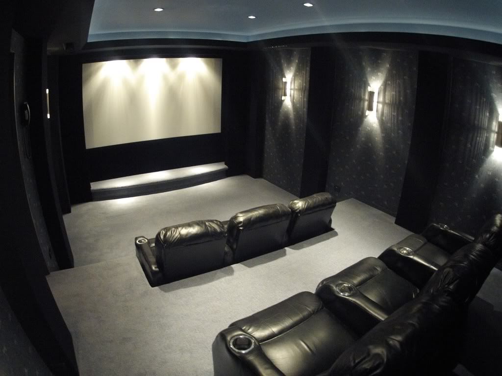

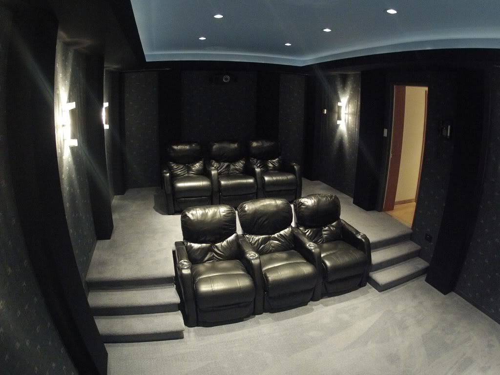

After about 100 hours each of Jeff and my time -- and 14,000 staples! -- here's the nearly-completed theater:
Some info about the theater:
- 14 feet wide by 23 feet long. The original space was supposed to be 16x24, but during the house construction the engineers decided the concrete foundation walls (surrounding the theater space on 3 and 1/2 sides) needed to be 14 inches thick, which reduced the space available.
- Theater equipment is housed in a 19" floor-to-ceiling rack in the equipment room adjacent to the theater. This room also includes a geothermal heat pump, Verizon FIOS termination gear and router, and patch panels for the house's coax and Cat5e wiring.
- Lighting for the theater is controlled via a keypad located near the door -- which signals the Lutron Homeworks whole-house lighting control system to turn on/off/dim various "scenes" within the theater.
Home theater equipment (almost all from 5 years ago!)
Seating
- 6 Berkline full-leather seats each with electric recliner, Mini-Buttkicker, and LED-cupholders
Speakers

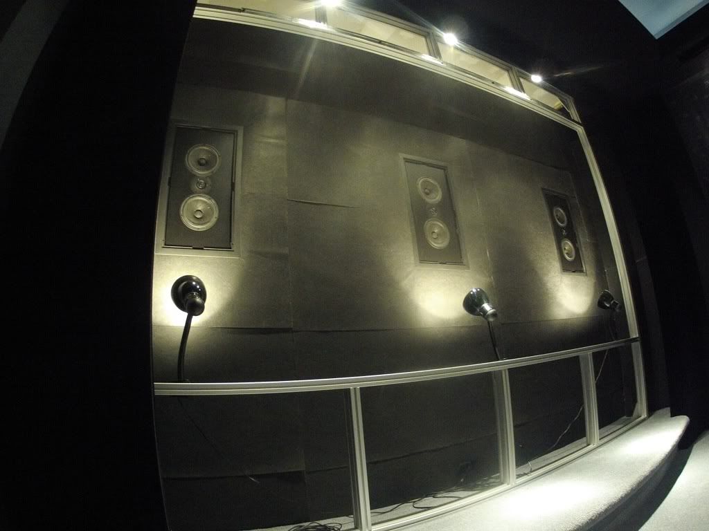

- Front L/C/R speakers: Triad Inwall Gold Monitors (behind acoustically-transparent screen)
- Side and rear speakers: Triad Inwall Gold/4 Surrounds (x4, located inside of columns)
- Side subwoofers: Triad Inwall Bronze/4 10" Subs (x2, located inside of columns)
- Main subwoofer: Velodyne DD-18 18" Sub (located in front corner next to screen and behind screen wall.
Screen: SMX acoustically-transparent 110" wide 16:9 132" diagonal
Projector: JVC RS-1 (now on its 3rd bulb and doing wonderfully!)
Surround/video processor: Anthem Statement D2 with Anthem Room Correction (ARC)
Amplifiers:
- B&K Reference 200.7 (7 channels x 200 wpc)
- Triad Rackamps (x 2, to drive 2 Triad subwoofers)
- Buttkicker BKA-1000-4 (to drive 6 Mini-Buttkickers in Berkline seats)
Blu-Ray Players:
- Oppo BDP-93 (relatively new)
- Samsung BD-UP5000 (plays HD-DVDs also, bought back when it wasn't clear that Blu-Ray was going to win).
TV/DVR
- Tivo HD

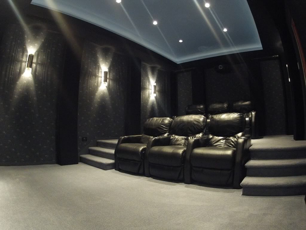

Some other items that may be of interest:
- The face of the soffits (covered entirely in black GOM) is at a 45-degree angle instead of the usual vertical trim. This made covering the soffits much more difficult due to the need to stretch the fabric at the corners.
- The use of Swizzle Stick fabric with straight line horizontal and vertical black elements made hanging the fabric extremely challenging. Any pulling or stretching of the fabric would make the lines no longer straight. (Good luck being the next person to convince Jeff to hang such fabric!!!)
- While all of the soffits and columns are covered in black GOM fabric, Jeff convinced me to spend a bit more $$ to cover everything in the front of the room with Fidelio black velvet. This included the panels above and below the screen, as well as the entire wall located about a foot in front of the screen. The result is that the entire front wall "disappears" and the screen really "pops" when watching video.
- The theater decor was chosen to create a clean modern contemporary design without chair rails or any wood mouldings. This made the theater consistent with the rest of our contemporary home which is a mid-century modern Deck House. The house has cedar wood decking on all the ceilings and beautiful mahogany trim around all the windows, doors, floor moldings, etc. While being modern, we wanted to create a theater space with some contrast -- hence extensive use of fabric wall coverings with no wood finishes showing.

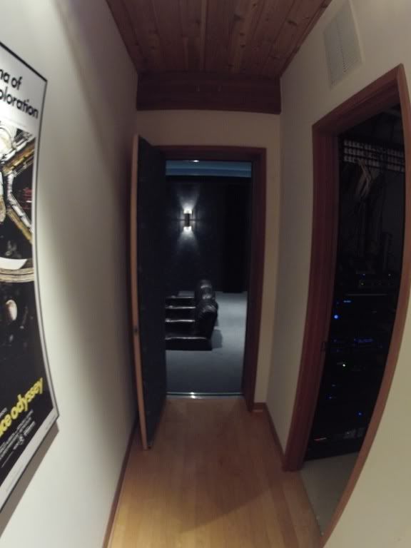

Here's the view from the hallway leading into the theater (you can see the equipment rack in the closet to the right). Also this picture does a better job of showing the light blue real color of the carpet installed in the theater:

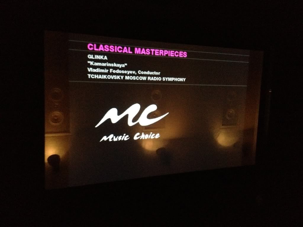

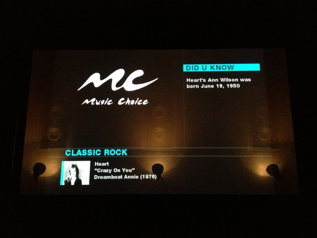

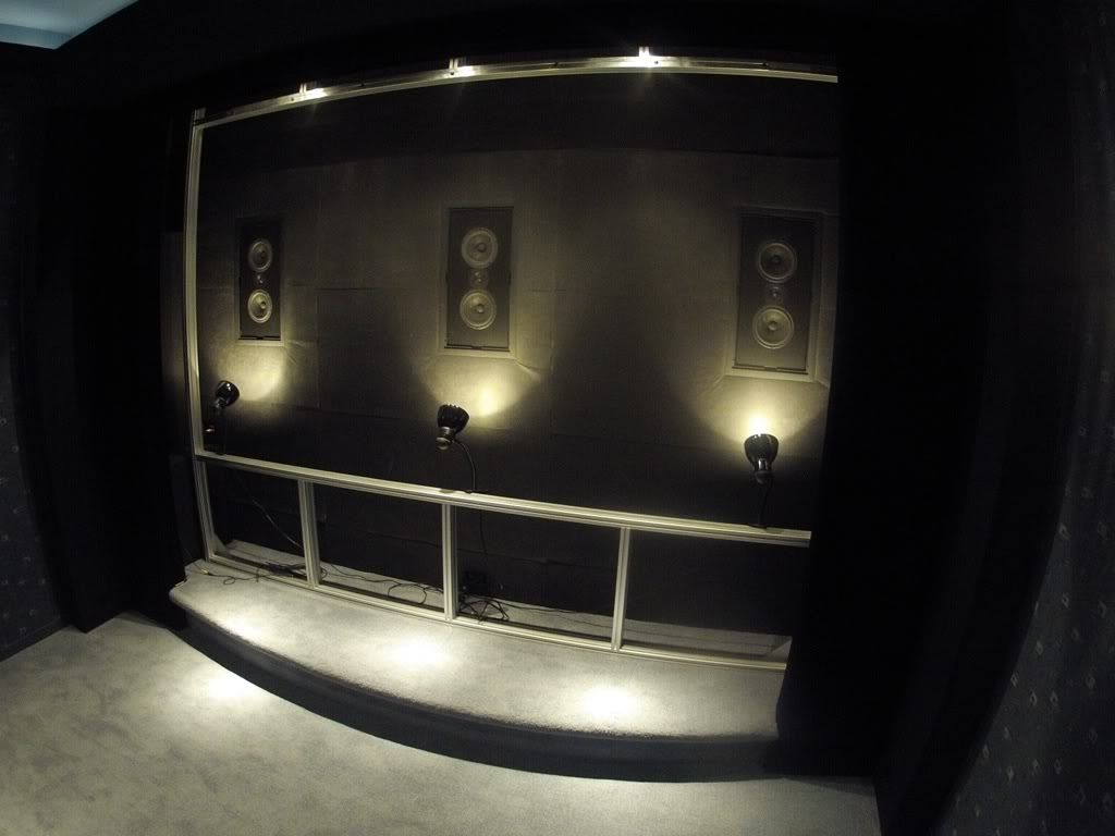

Just for fun I installed some lights clamped to the back of the screen for illuminating the Triad front speakers through the transparent SMX screen. These are on a separate dimming circuit. When listening to music it's possible to create a "3D" effect by leaving the projector turned on:

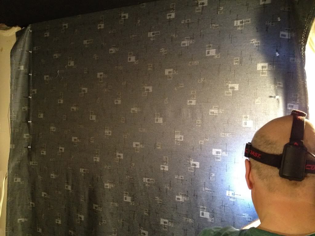

The Swizzle Stick pattern looks nice. I can see how it would be picky about installation details.

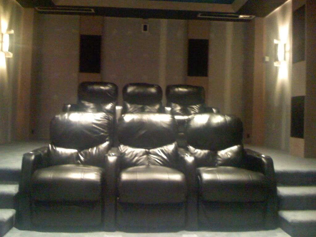

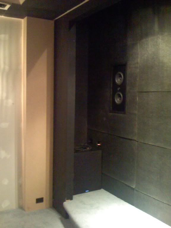

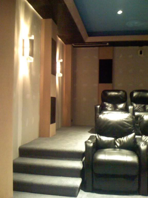

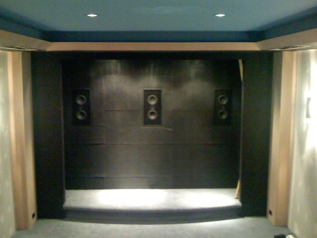

OK, here are some shots of the room from 5 years ago -- right before I hung the screen and projector and all work stopped -- and way before I got BIG (Jeff) involved to finish off the fabric and acoustic treatments. (My apologies for the poor quality -- these were taken with an early cellphone camera):
Triad surround speakers and subwoofers were just sitting on shelves in the columns, covered "temporarily" with their metal speaker grilles.
18" Velodyne Subwoofer lurking in the corner
As BIG said, for the past 5 years the room has had naked MDF columns and soffits, and drywall with taped seams showing. That was OK, since you couldn't see most of it once you turned out the lights and were awestruck by the great screen image. :-)

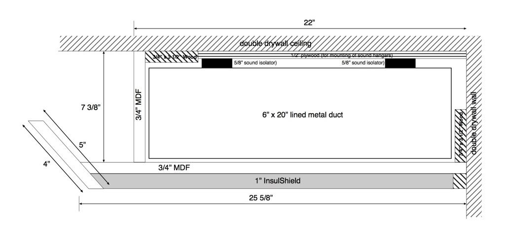

Here's a drawing of the soffit cross-section I drew and gave to the contractor. It clearly shows the 45-degree "front" as well as enclosed ductwork for HVAC:

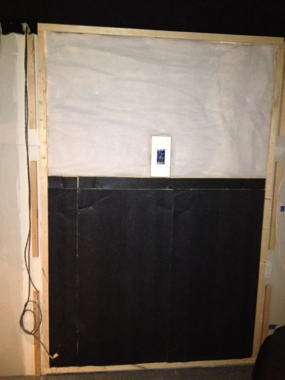

And what about the acoustical treatments? Are they behind the fabric - I assume so - though I notice GOM doesn't list swizzle stick among its acoustic fabrics. How has the sound worked out?
Fred
The acoustical treatments are mostly standard stuff for people who read this forum:
- 1" InsulShield rigid fiberglass on the bottom surface of all the soffits, and most of the wall spaces between columns up to ear height.
- 1" polyester batting above ear height to preserve some room reflections
- InsulShield on the front wall behind acoustically transparent screen, as well as more (bass traps) stuffed into the front corners behind the screen wall.
All columns containing speakers are covered in black GOM fabric that's acoustically transparent. The GOM Swizzle Stick fabric (with uncertain acoustic properties) is only used between columns.
I'm thrilled by the resulting change in sound quality after having very little acoustic absorption in place for 5 years. The biggest change is that you can now much more easily pinpoint exactly where sounds are coming from behind the screen, and you even get a sense of the acoustics of the space/room in which a movie or TV show was filmed.

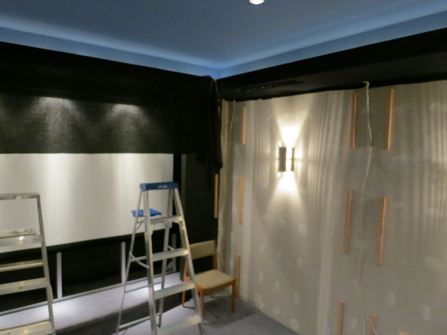

Here is a photo showing the treatments behind the fabric:
BIG agonizing over the installation of the Swizzle Stick fabric, inserting push pins to position the fabric -- to preserve the pattern and keep the "swizzle sticks" straight and level (and vertical). We even pattern matched each fabric panel to start at the same place at the top!

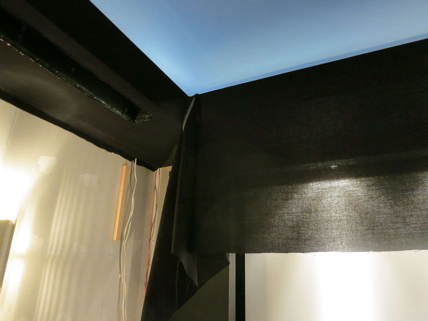

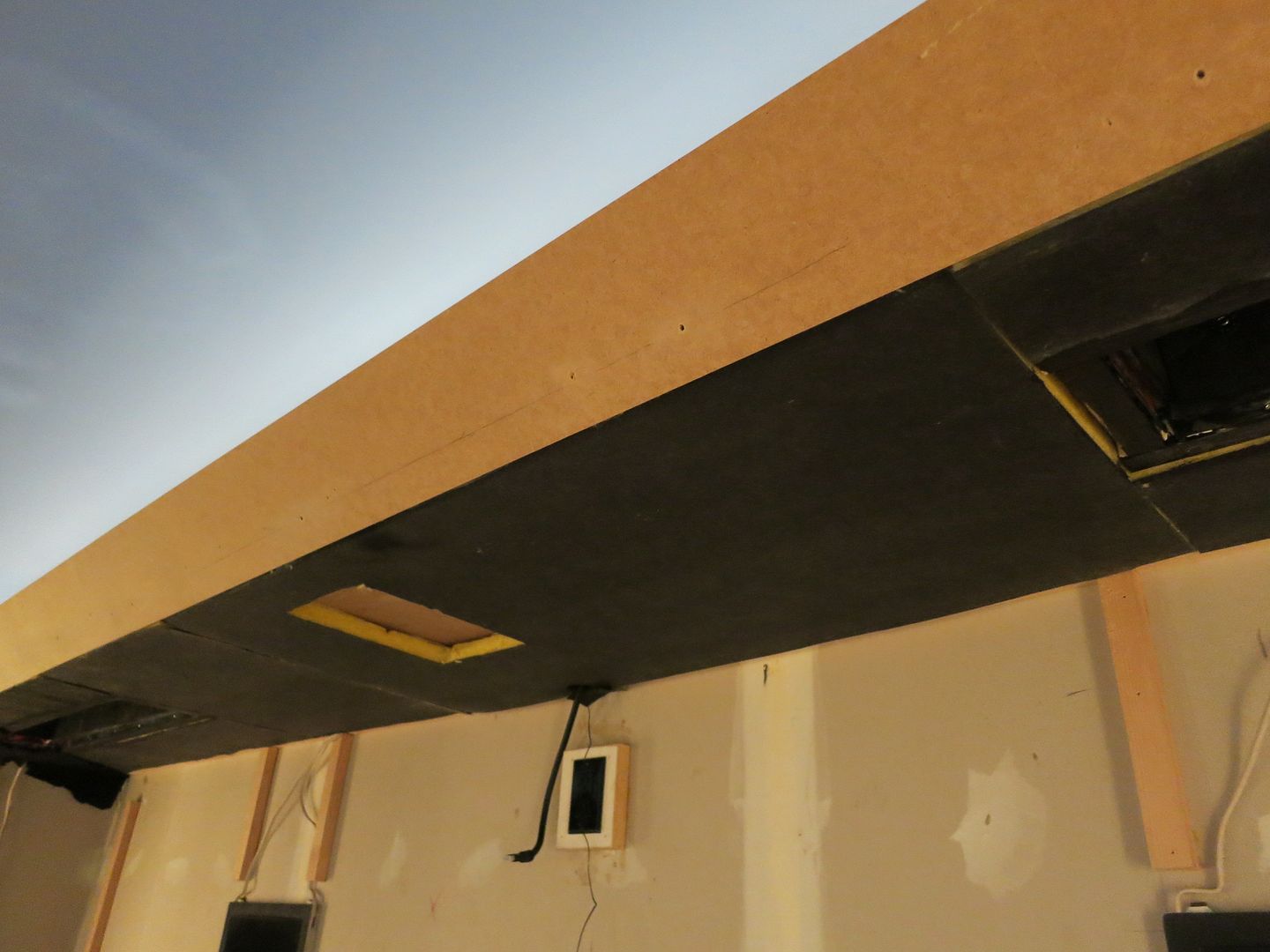

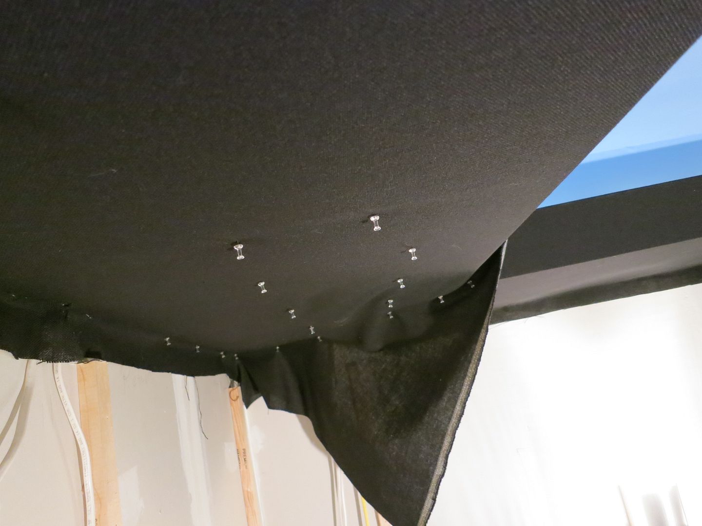

Some More Details - SOFFITS
First we have the naked soffits that UberA designed with Linacoustic on the bottoms.
I added one inch furring strips at the corners at a 45. Then we stapled the GOM to the backside of the top edge by feel (Checking with a hand mirror) and let it drape down.
Then starting in the middle stapled it to the underside along the last inch where it would be hidden by the wall panels.
when we reached the ends I used tacks to get it into the rough position where we wanted it then stapled.

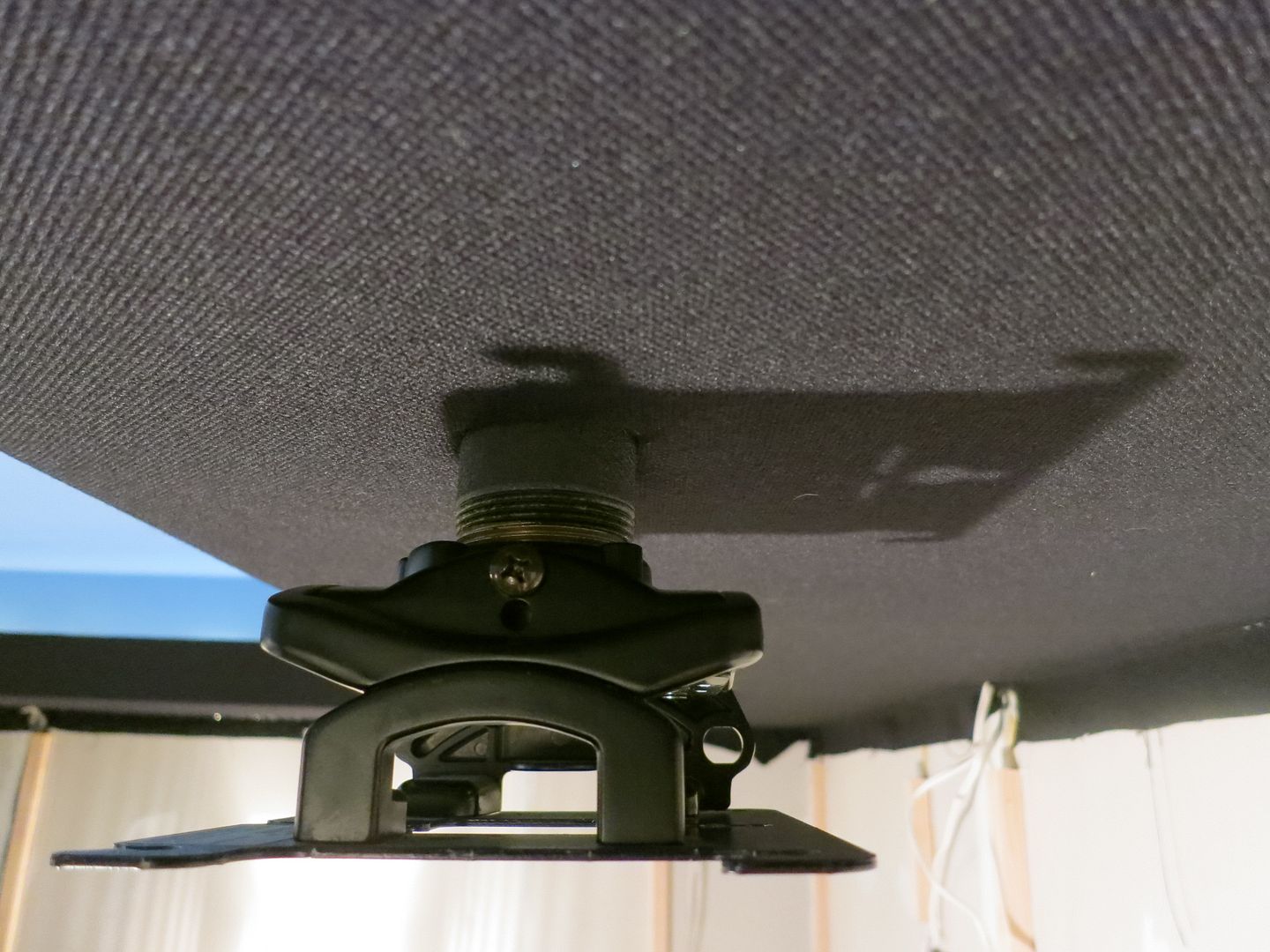

At the projector mount I cut a cross hatch in the fabric and pushed the down pole up into the bracket and it turned out pretty clean.
It was a real pain to get the fabric on the soffits tight without any ripples particularly at the room corners given the odd angles that the soffits met. We still need to cover the staples at the corners with strips of fabric mounted to something. We've been experimenting with various materials.

Is that a phone next to the door? I don't think I have seen that in a theater before.
Yeah, we're over 30 years old and still have one of those old fashioned things called a telephone land line. :-)
Seriously, the house is big enough that I needed to install a phone switch (PBX) with more than a dozen extensions -- each includes a speakerphone and hence can be used as part of a whole-house intercom system.
Since our indoor cellphone coverage sucks, putting a phone extension into the home theater still permits receipt of incoming phone calls. The soundproof door makes it difficult to hear what's happening in the rest of the house, including the ringing of phones in other rooms.
I forgot to wire a doorbell in the theater, however. I suppose I could hook up a networked streaming videocamera covering the front door that would show on the theater screen. ;-)

Here's a another element of the theater that's different from what I've seen on the forum.
5 years ago after I had hired a contractor to build the basic theater, including columns, riser, soffit, etc., I then had to figure out how to hang my SMX acoustically-transparent screen.
Since I had few woodworking tools (or skills -- I'm an EE/computer science grad), and I didn't trust a screenwall constructed of 2x4s to stay straight over time, I decided to order and construct a screen wall built of T-slot aluminum extrusions (http://www.automation4less.com/tslots1.htm).
I figured out exactly which pieces were needed (in which lengths), and ordered them to size. After they arrived it was like building with a giant erector set, bolting everything together. The resulting frame is complete overkill from a structural perspective, but it worked very nicely -- the Z-clip that came with my SMX screen bolted perfectly into slots of one of the upper cross-beams, making it easy to hang and remove the screen. (Pardon the curves in the photos caused by the wide-angle lens; the aluminum beams are perfectly straight
The fact that the frame was bolted together came in handy when the amplifier of my Velodyne DD-18 subwoofer died and I was forced to remove the sub from the corner for repair. While a bit of work, I was able to unbolt parts of the frame to get the sub out and then put it back in. I obviously wouldn't have been able to do that if I had created the frame out of wooden 2x4s.

Nice work on the false wall. Do you recall approximately much it cost for all the parts? I'm assuming it's rattle-proof as long as everything is bolted together tightly. How are your fabric frames attached (friction fit?)

Ah, interesting - so your false wall IS your screen frame (vs. having a screen frame that attaches to the false wall, like most have). I would have loved to make a frame out of the T slot material, but when I priced the parts out at 80/20, it worked out to about the same cost as a premade frame from Jamestown ($350). Granted the T-slot would have been more heavy duty for sure, but instant gratification won out.

UberA: you took the screen down AGAIN?
Sure, to stuff more rigid fiberglass into the front corners for more bass trapping in preparation for re-calibration with Anthem Room Correction (ARC) -- using the microphone and test tones. I hadn't re-run ARC since we totally changed the acoustics of the room.
BTW, ARC now shows the front speakers as flat +/- 3db between about 120 - 10,000 Hz *prior* to any equalization being applied -- so I'm really happy with the way the room now sounds.
I don't recall exactly, but the T-slot parts probably cost $400 or so 5 years ago. The frame is solid and very rattle-proof, and the Fidelio fabric-stretched-over-wood frames above and below the SMX screen are friction-fit (thanks to BIG's superior measurement and carpentry skills :-)

Very nice job, clean lines - looks great!
Love the ceiling, haven't seen "Milano Blue" used in ages, I thought it'd been stopped for some reason - how does it look with the projector on?

Well, the blue ceiling was painted 5 years ago, so I guess that was "ages" ago.
With the projector on and all lights (including rope lights) turned off, the ceiling not surprisingly looks like a darker blue. But now with the relatively dark fabric up on the walls, the soffits wrapped in black GOM fabric, and the entire front wrapped in Fidelio black velvet, it's possible to watch many movies/videos/programs with the soffit rope lighting on -- without washing out the blacks on the screen very much. This is useful if viewers/guests want to actually be sociable and see each other. It's also possible to dim the rope lights.
