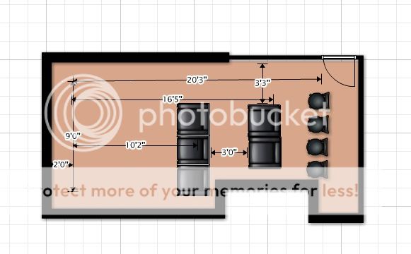

Anyway, here is a picture of the current layout. The room in the top left is the only finished room.
Edit: Newest plan:
It's also narrower than I'd like, but I'm not moving the cement block wall. The good news is that most of the walls of the proposed theater are cement block. The "H"s represent support beams, next to which there is a lot of ductwork, so that's why I'm not planning the theater on the right hand side of the basement.
I plan on a 9'-wide screen, probably 2.35:1, and two rows of theater recliners, seating 5. Also, I plan on having bar seating in the back, and an AT screen. I feel I have the length for it, even if the width is limited.
A few questions:
How do you propose I orient the room? I've been assuming that I'd have the screen on the wall to the left, but I prefer to walk in at the front of the theater than the rear. Also, where do you recommend I put the door?
I'm sure I'll have a ton more questions as we progress, and I've set myself a deadline of Superbowl 2013 biggrin.gif, so if I start falling behind I'll probably give BigmouthinDC a call.
Thanks for any input!

This is what I'm thinking.
Any thoughts, concerns, recommendations, changes, etc?

I think the room to the left of the stairs may be a better choice for the HT.
If that's out of the question I would flip-flop what you have. Center everything 5' from the cement block wall. Use the bump on the bottom as a walkway. Move the entry door closer to the stair so you enter the room between the new screen location and the first row of seating. Make the front row 2 seats and the second row 3 seats.

If the block wall is not load bearing, then I would take it down. It will come down a lot easier than you think. By doing this you can get a theater that is slightly wider than what you have now and it can be what ever depth that you want. More importantly, it will not have the bump in causing problems. Keep in mind that you are talking about spending a fair amount of money. I would not let that wall stop you from doing it right. After knocking off the top row, once you get one block out, the rest of the block can be pried loose easily so that you can carry them out whole. Shoot me an email if you have any questions.
Unfortunately it is load-bearing. We were going to move it anyway but my engineer told me not to as we're getting ready to add another story to the house, and want to leave the existing load-bearing walls where they are.
I voted for the room at the bottom of the stairs as well, but the wife vetoed it. Also, that room is already finished and has a bulkhead and I prefer to start with unfinished space.
Quick idea:
450
I really like that. And as I mentioned, I prefer to walk in at the front. Thanks! That also makes speaker placement easier.

Just note those seats are modeled after real theater seats. They are very narrow. If you are going to get real comfortable recliners, you will likely end up with a front row of 2 and a second row of 3.

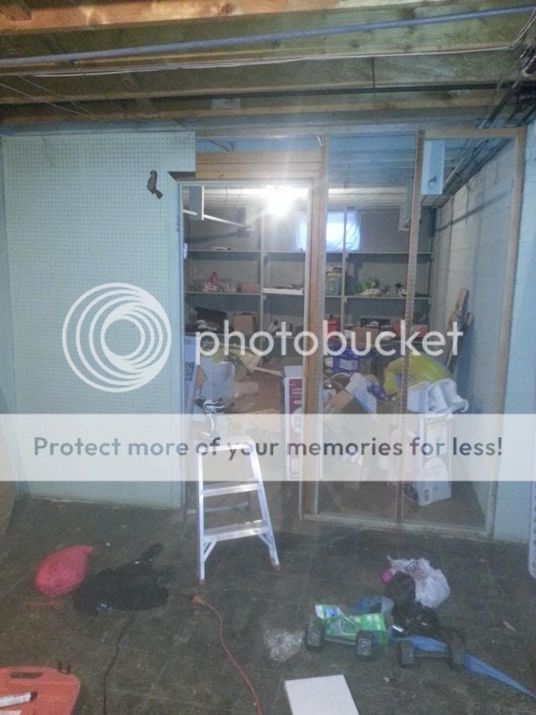

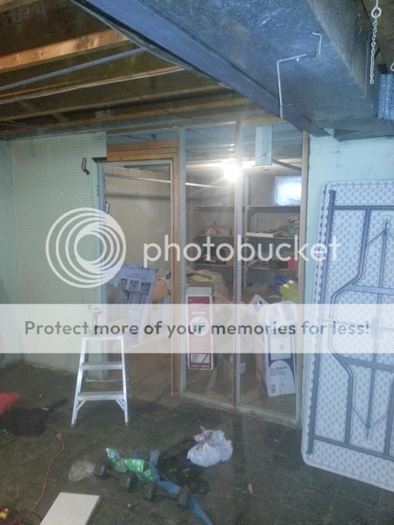

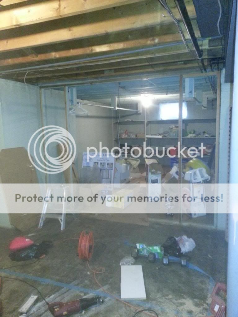

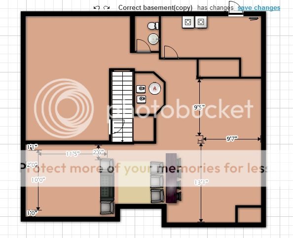

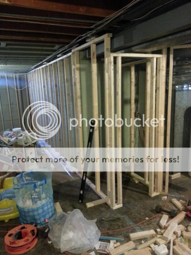

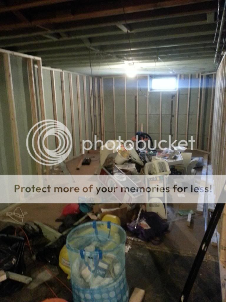

So this may no longer be the appropriate sub-forum for my build as it's no longer a designated room. The wife used her veto power. I thought I'd post an update anyway.
The new plans:
It's slightly off, but gives a general idea.
Demolition of the pesky wal. Looking towards the screen walll:
Framed. Looking towards the screen wall:
Small equipment closet on the right.
I just placed a large monoprice order for all my low-voltage stuff, and plan on wiring power and low-voltage within the next week or two. Then it's insulation, drywall, screen wall, riser, etc.
Any suggestions are more than welcome!

I just finished the wiring for the first five speakers, but I am a little stumped on where to place the rears. I am trying to avoid in-ceilings and floorstanding rears. I guess that pretty much leaves me with ceiling mounted bookshelves. The questions is, where should I place them. The sides will be above ear level next to the front row. Should the rears just focus on the front row? Or should they be behind the rear bar?
Any input is really helpful.
Aaron, It may be just that your pictures are not clear enough to give detail but did you place regular, bare 2 X 4s against cement in some places? I sure hope not as any wood touching cement should be treated or protected in some way. You may get a way with untreated lumber for a short period of time but it will come back to haunt you later.
Thank you for the concern. All bottom plates that abut exterior walls are treated. The only wall that is completely untreated in the right wall along the theater. It was an oversight and will be corrected before drywall goes up. Thanks again!
