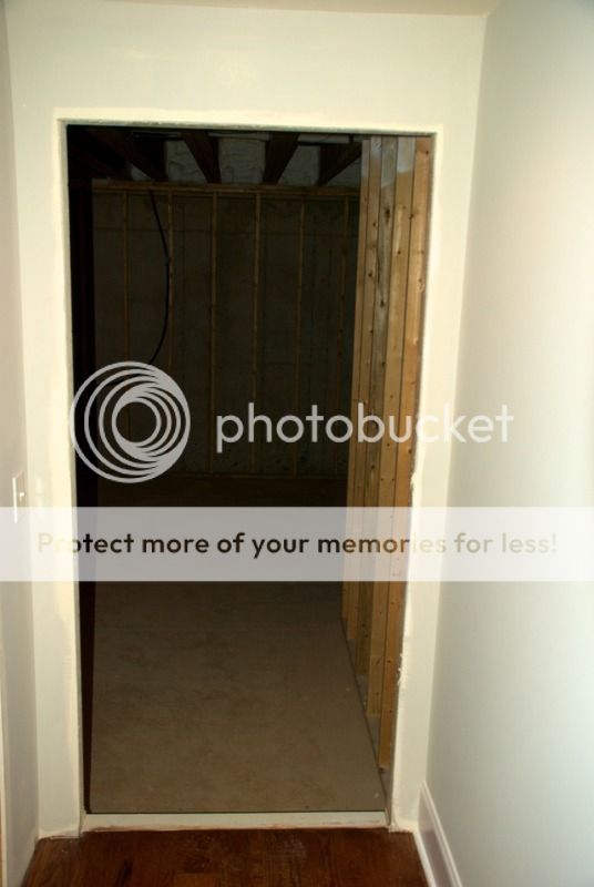

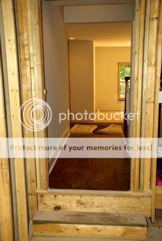

I'm almost ready to start construction on my theater, and one last detail is causing me some grief. I can't decide if I need to try to move my door, or try to make it work where it is. The issue is my door will be all the way in the back corner. Going into the theater I don't think this is a problem, but on the theater side I'm not sure if there will be room for clips+channel+DD+GG+acoustic treatments. The rough door opening is about 3-1/2" from the back wall, and is about 38" wide.
Before you say just move it, the walls in this hallway support a set of stairs and landing directly above it, so it may not be that simple. Also, the opening is currently centered in the hallway. So if I move the door, now it's no longer centered. The small room to the left of the doorway is intended to be my equipment closet, so I could definitely use part of that space for a door.
Here are my questions:
1) How much space is necessary between my door and wall to allow for sound isolation and treatments. I think I'm looking at about 2-1/2 to 2-5/8" for clips, channel, one layer of OSB, and one layer of drywall. But not sure about the thickness of the treatments on the back wall.
2) I'd like opinions on moving the door completely into the equipment closet, and possibly making an arched opening or cased opening going into the area with the door.
As promised, here are the pics of the doorway, and a Sketchup model showing the stairway and equipment closet in relation to the theater.
Outside Theater looking into the theater through the proposed door. The equipment closet is on the left.
Inside the theater looking out the doorway. The equipment closet is just past the doorway on the right in this picture

Can you also show us the theater layout so we have a better idea of the overall flow? I'd like to see how your riser is laid out in the back of the room (relative to your door location) and whether or not an alternate door location would interfere with your side surround speaker? Without seeing the rest of the space, I think I like the current location over moving it into that closet. Walking into the room behind your rear bar seems more inviting compared to walking into the side of the bar or into the side of your 2nd row of seats.

Sorry for the slow response. Here's a different view of the model showing the riser with the bar and seats. The column locations shown are just place holders. i haven't put much thought into where they need to go just yet. I like the idea of entering behind the bar as well. Unfortunately, I can't move the door over just 1' because of the load bearing posts. As I have it modeled now, there is only about 2' from the back edge of the bar to the load bearing post in that wall. There would be plenty of room for the door to open if I move it to the equipment closet, but I don't know that I like the way it would look or feel entering the theater.
I haven't decided on a door size yet. I would like a 36" door just to make it easy to move stuff in and out, but I could probably go with a 32" if I needed to. I suppose I could go with a 32" door, push it as far as I can away from the corner. Leaving enough space for molding on the outside of the door, that would put the rough opening at 12" from the framing in the corner.
