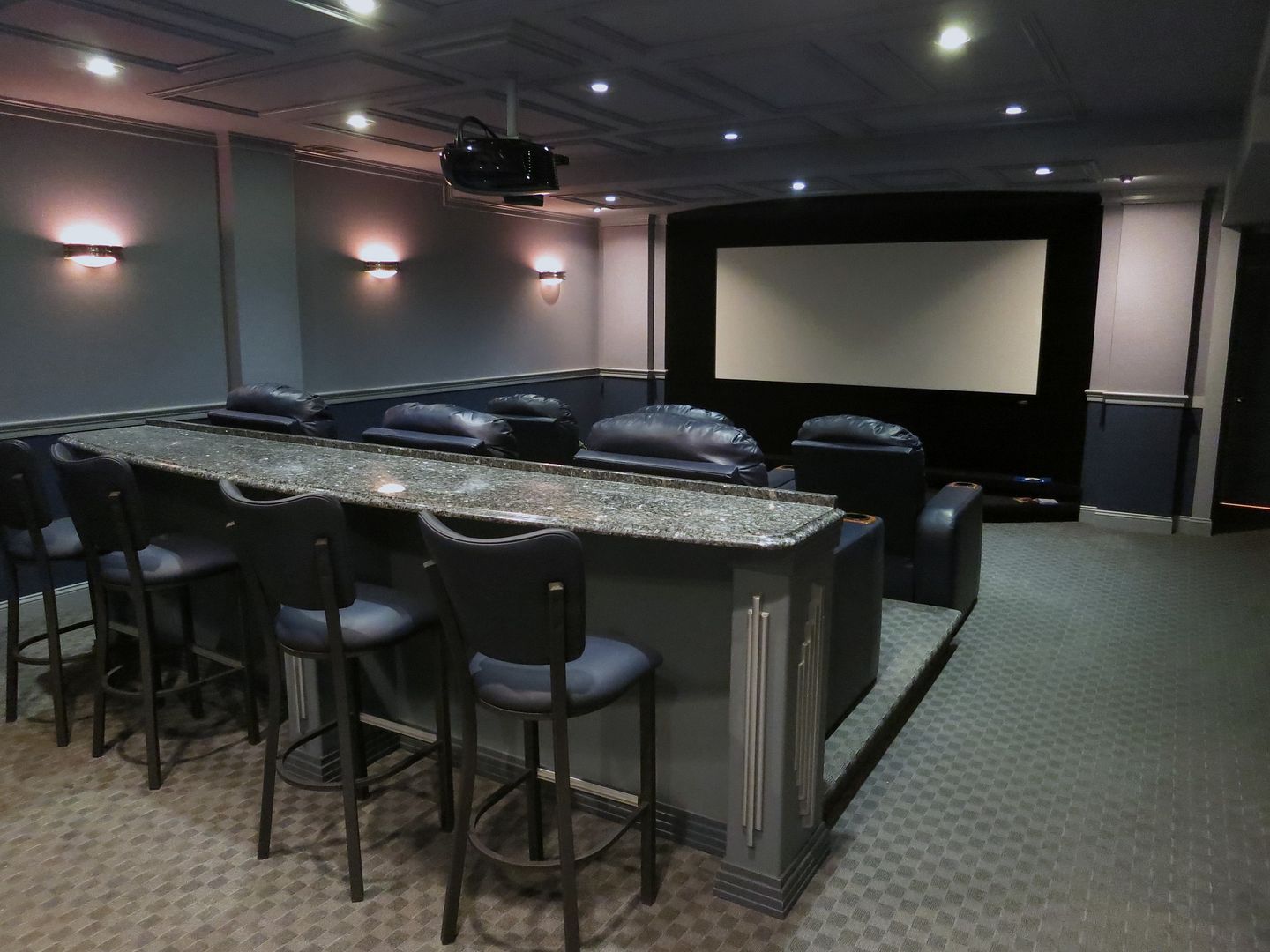

post #26 of 32 Old 01-26-2013, 06:13 AM
Pain Infliction's Avatar
Join Date: Jun 2010
Location: Houston Texas
Posts: 4,281
Mentioned: 12 Post(s)
Quoted: 978 Post(s)
Liked: 505
Nice job. I like the color scheme.

post #27 of 32 Old 01-26-2013, 09:26 AM
crakerhead's Avatar
Location: Richmond, VA
Posts: 491
Quoted: 13 Post(s)
i think it looks great. great height for the second row, too. accent pieces on walls look pretty cool
