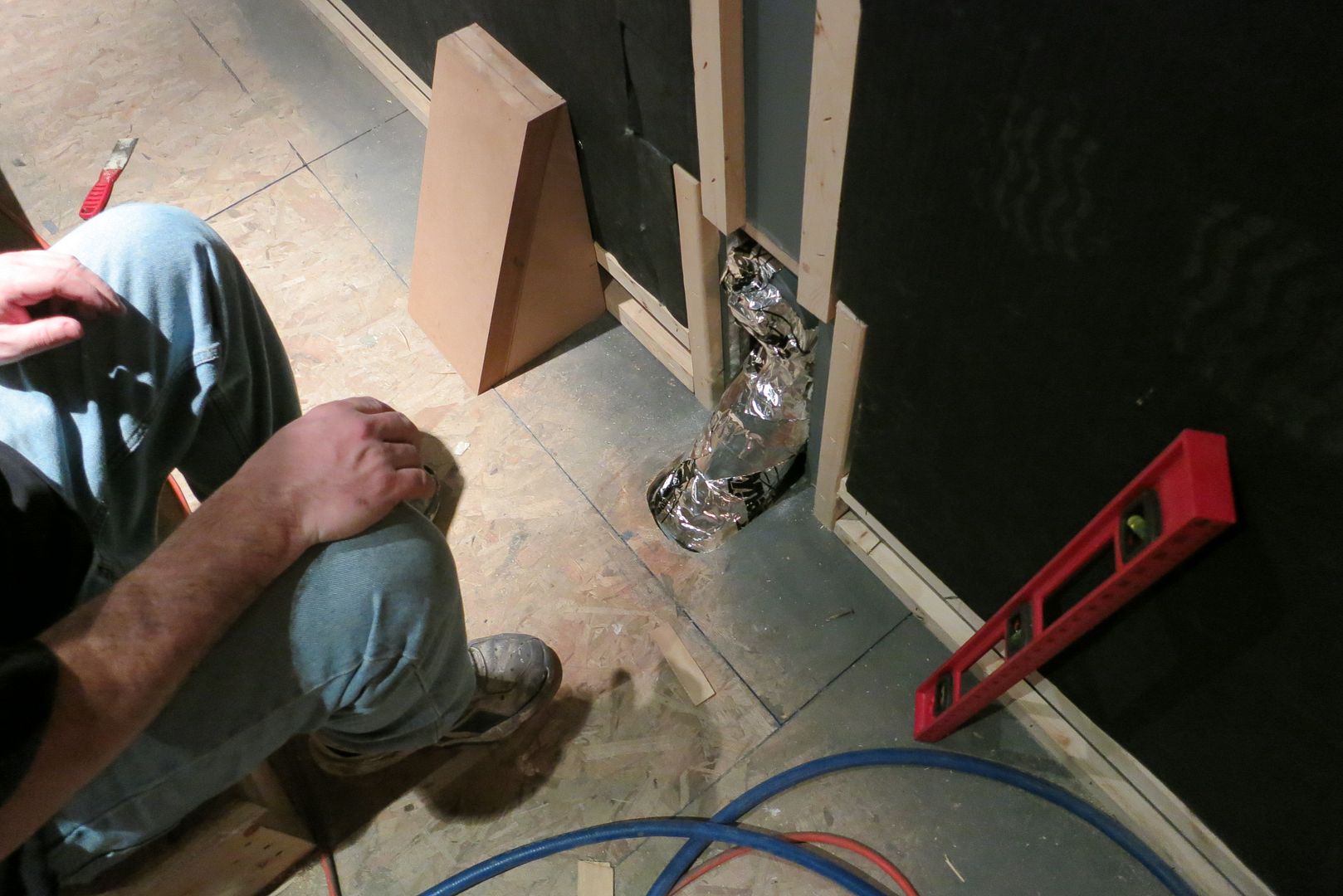

wrap the pipes with Dynamat extreme or the equivalent. Then fiberglass insulation and your damped wall/ceiling assembly.
It made a big difference in the audible drain pipe sounds in this theater before we covered it.

Thanks BIGmouth! I just ordered some off of Amazon. You've been a tremendous help to me today! Is this the same thing you use around duct work... not that I'm there yet... just looking at some different alterantives.

It does work on duct work but as you've discovered it is pricey so I choose my spots carefully where I think it will be of benefit. Ted will tell you he generally feels a damped decoupled ceiling will keep most sound from affecting ductwork.
