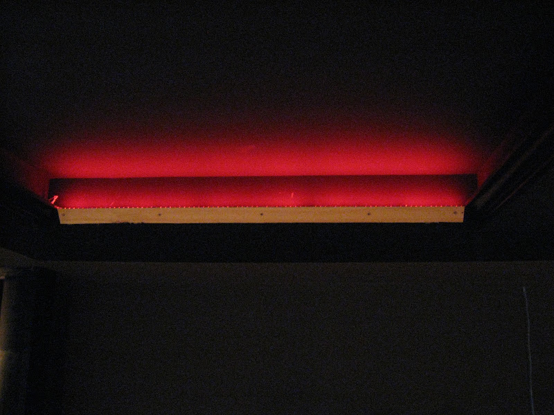

Haven't updated the thread in a bit, but I have been making decent progress. I got sidetracked replacing every single stitch of brake line in my truck. I started out with one leak, I'd touch another piece of the line, leak would form. Replace line, pump up brake pressure, another line blows. I am not kidding when I say every single piece is now replaced (one painful section at a time). So now I'm back on theater duty.
All of my step lights came in, and I got them all painted black. I am holding off on installing the covers until after the carpet is in. I also got all of the crown done and all of the LED strip installed. My power supply came in and I got it all hooked up:
I know some of you were curious about dimming the LEDs, so here's a video of the dimming (sorry, I'm no cinematographer.. there is probably some setting to make it look better):

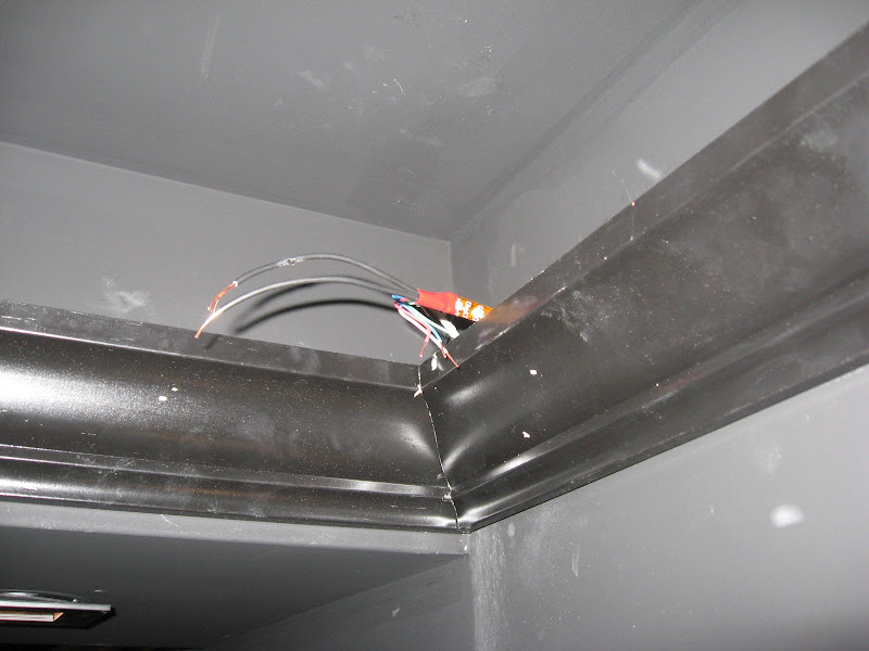

Here's some photos of the leads for the LED strips:
Sorry for the quality.. What I am trying to show is the two black leads soldered to the end of the strip where I cut it.
Finish it up with a piece of shrinktube (I only had red in that size, it wasn't an attempt at color coordination biggrin.gif )
The connections are pretty resilient. I had to do a little smashy-smashy to get the wires tucked behind the crown.

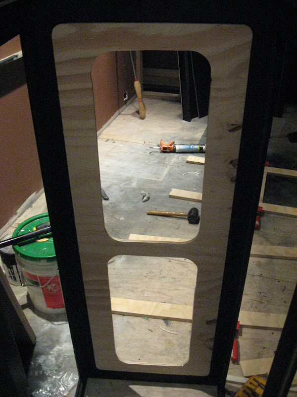

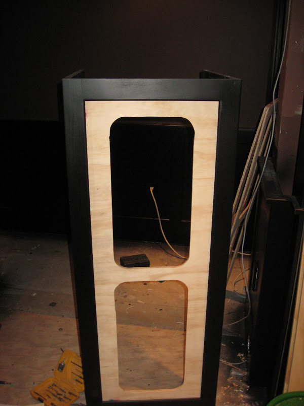

A lot of progress, but nothing really photo-interesting. I got all of the frames in the rear of the theater assembled and I also got all of the panels that will be inserted in the columns done:
Front view:
Rear view:
They'll be wrapped in fabric and held in from the rear with panel retainer clips.
