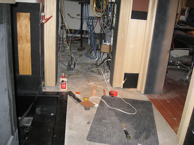

Good progress today, got the doors cased out and the second layer of plywood green glued.
Here's how my nosing worked out:
I installed the nosing first, which was 3/4" tall on the backside. I added a layer of 3/8 ply with GG.. This brought the lip to 3/8", which will hopefully work well with the carpet.
Here's how the casing is shaping up:
I made the door jamb an inch wider than the wall. The casing obviously attaches to the jamb on one side; on the other side it has an inch shim between it and the sheetrock.
Then I ripped a 1x6 into 2-5/8" strips. I routed a 3/4" wide by 1/8" deep groove in the strip, into which the casing fits. Now I can do my wall treatments (ATM thinking 2-1/2" deep frames-- 2" acoustic material with 1/2" airspace between wall and material) and the casing won't look silly.
I'm going to add some more detail.. I got some nose and cove molding, but I am going to need to add something else.

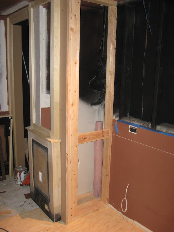

After trying a few different options, I decided on how I was going to wrap the trim around the radius corner bead:
I rounded the cap to match the drywall. This is in a traffic area, so I figured it would be best to eliminate a sharp corner at about waste height.
I also got the rear columns done (except for final glue-up on some parts):
Path light will be at the bottom. Central vac sticking out of the panel.
This side will be all fabric:
I'm thinking pink fluffy inside for a trap. Curious what would work better.. full of pink fluffy... 12" of pink fluffy with air gap behind.. or 6" pink fluffy+membrane+6" pink fluffy. We'll see how motivated I am.. it wouldn't be a big deal to try the different techniques and measure the response.
