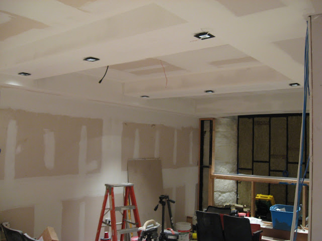

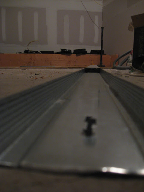

Thanks for the kind words, Fred. I have a lot of photos of construction, but I'll be darned if I know where they are. I just realized the 16gb card from my Nikon is MIA, I suspect there are some photos on there. The mightiest of plans and ideas succumbed to the reality of budget. I had to make some compromises in design and material.
I had planned on a much more intricate (read:wood) ceiling, but in the end drywall and spackle is a lot cheaper.
My soffits were made from left over framing material, which wasn't the greatest (actually, it was as crooked as a rattlesnake, but it was free):
About 15mins with the power planer and a straightedge and I had a flat surface. It was interesting to see the deflection in the joists due to the dead load above. The ceiling actually dips down a bit, but I made the soffits straight.
Front soffit was a lot easier!
Some people don't like metal, but I love it. Always straight. However, I always use 20ga. I refuse to use 25ga for anything. In a pinch I will pick up one or two 25ga on a Sunday if I need them.. I always regret it.

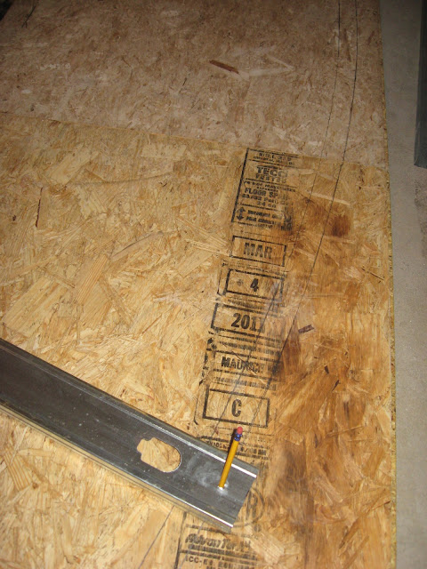

Making the stage..
I chose the classic stage design that many of us have chosen. Not sure who pioneered this design (Sunset Cinema?), but it's classy.
Scribed the lines:
Filled with sand (small openings stuffed with fiberglass):
Covered with Tyvek:
Deck:
Install the risers (3/8" ply):
Deck again:
I did the risers before the second layer of decking for a specific reason. No matter how good you are with a jig saw, the plywood never comes out perfect when you cut an arc.
The 3/8" plywood on the riser smooths out all the zigs and zags. After I installed the second layer of OSB I used a router with a flush trim bit to make a smooth arc.

It's 8:30p and I think I'm done spackling for the day.
Went through another 5 gallons. Everything has 2 coats and about 90% has a third.
I'll finish up the third coat tomorrow AM then off to big orange to get a new miter saw, some 3/4 MDF and some 3/4 birch plywood.
Hopefully I can get everything primed tomorrow.. or at least most of it.
Made a call to the supplier and it looks like my new CAC air handler and condenser will be here some time after Labor Day. Sure wish I had installed that first, it's got to be 90%+ humidity down there.
Tim
